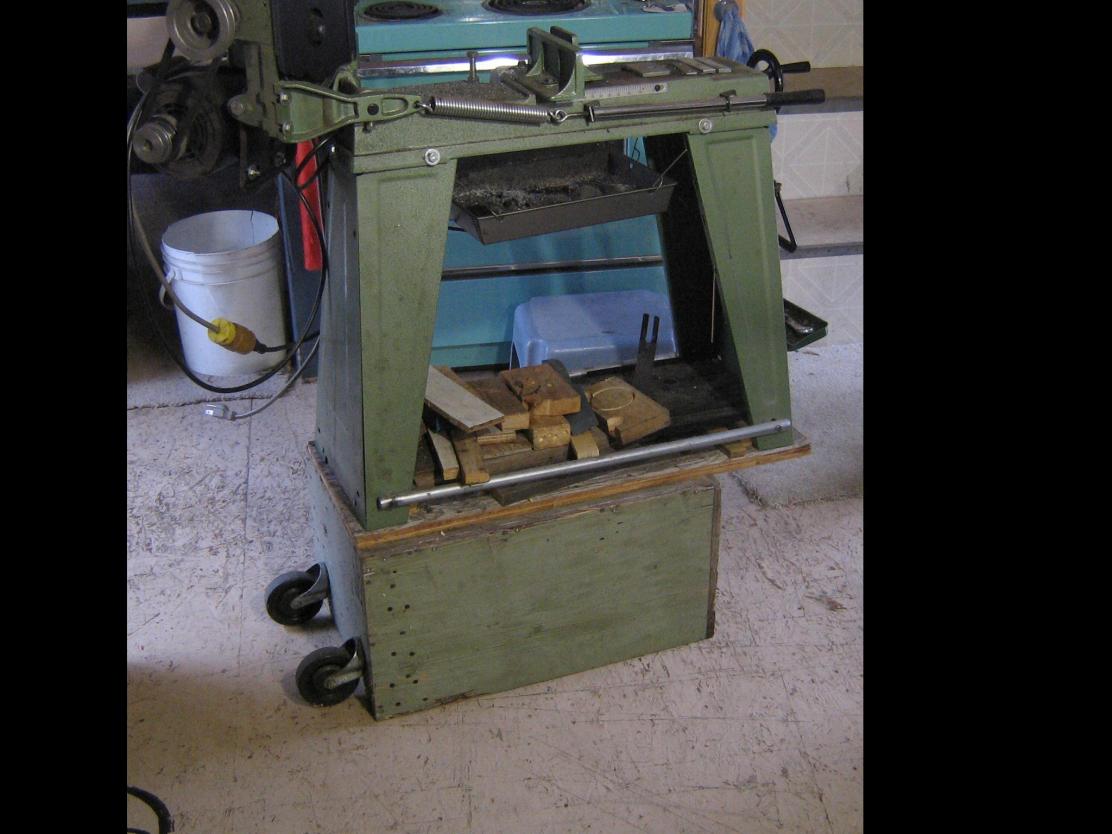

    Raised the working height from 24" to 37" by mounting the
    band saw on a 23" x 15" x 12" x ¾" plywood box.

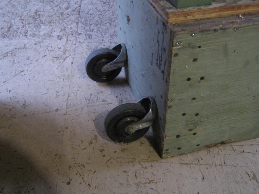

    Wheels from an old shopping cart add mobility.

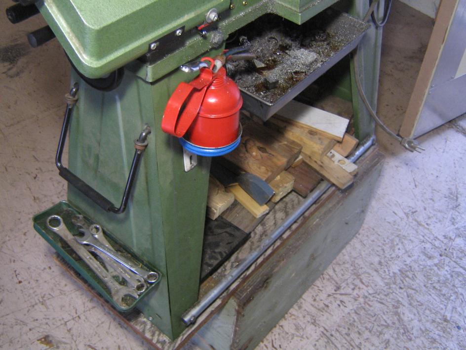

    An old cake pan catches metal filings.
    Mason jar lid mounted on a bracket holds the oilcan.
    Small metal tray holds a few wrenches.

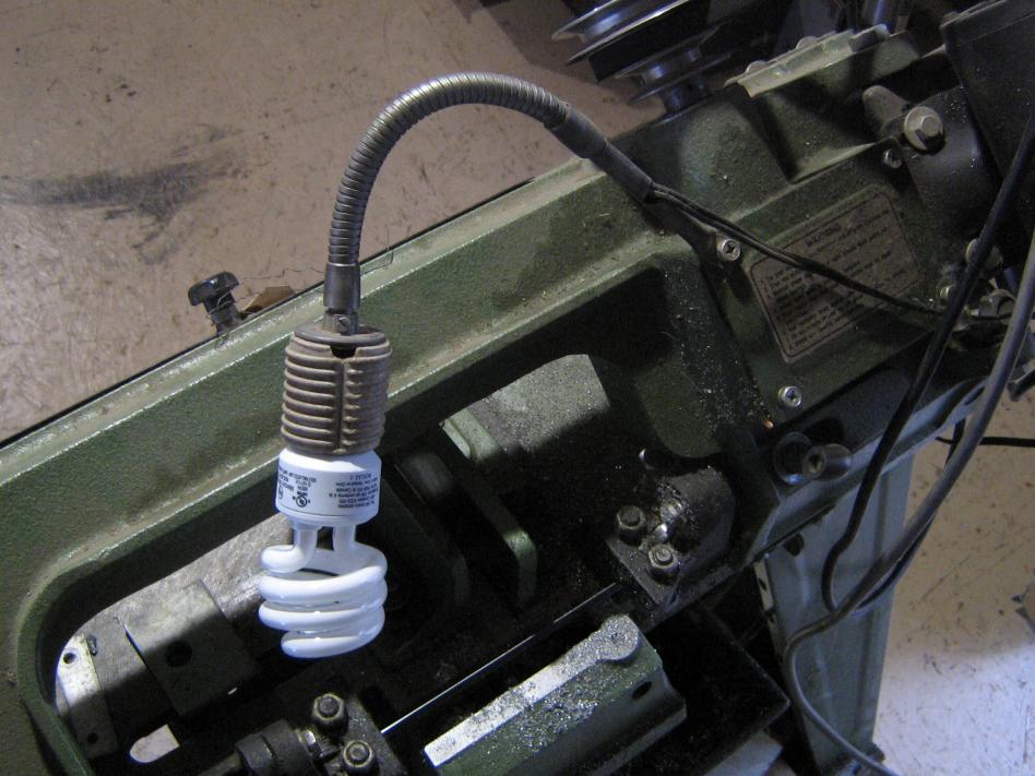

    Extra light provided by an old lamp with a flexable neck.

    PLEASE Put a guard around that light!!!
