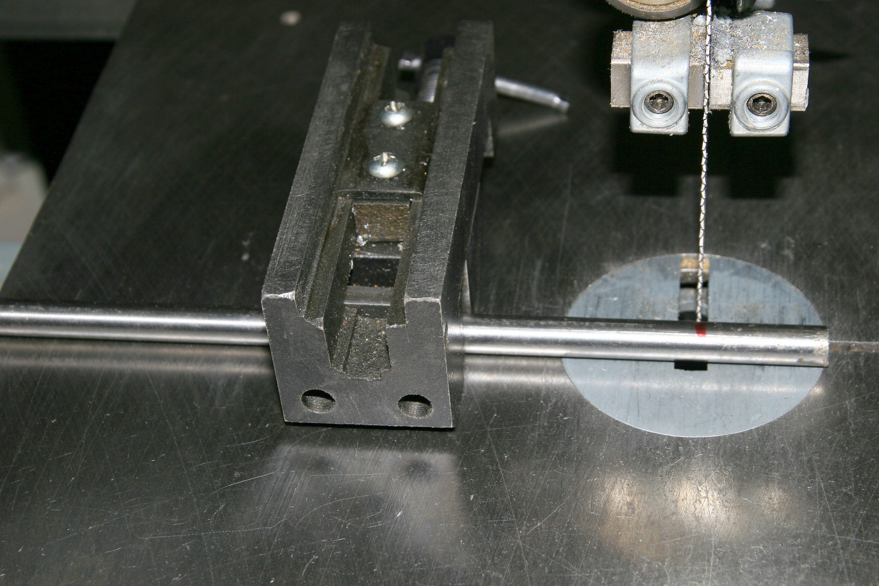

    Just a quick tip on cutting round on the vertical band saw.
    I use a small drill press vise to grip the rod against the band saw table.
    The vise is upside down and the rod is against the table.
    Smooth and safe cuts.
    Cheers, JR
