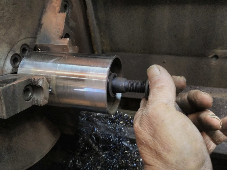

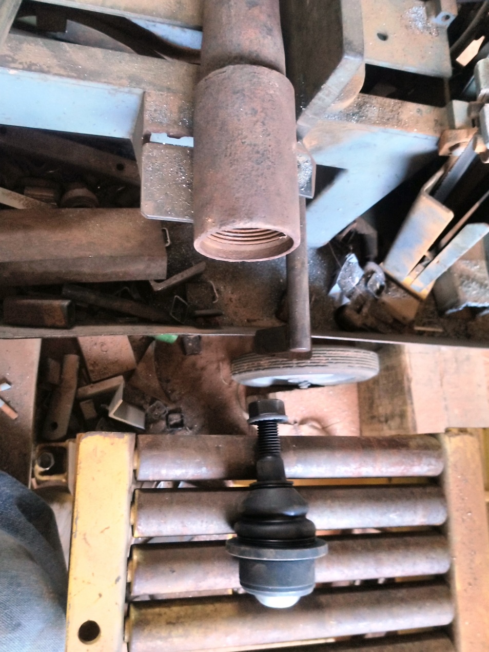

    I started out by cutting the coupling from a piece of 2 3/8" oil field tubing
    Ball joint removal and install tool for GM vehicles-img_20230501_155116bjt.jpg

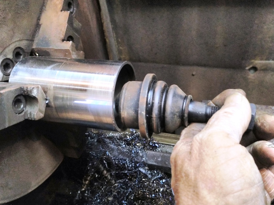

    Then machined the threads out of 1 end to fit over the flange of the ball joint.
    Ball joint removal and install tool for GM vehicles-img_20230501_162444bjt.jpg
    Ball joint removal and install tool for GM vehicles-img_20230501_162450bjt.jpg

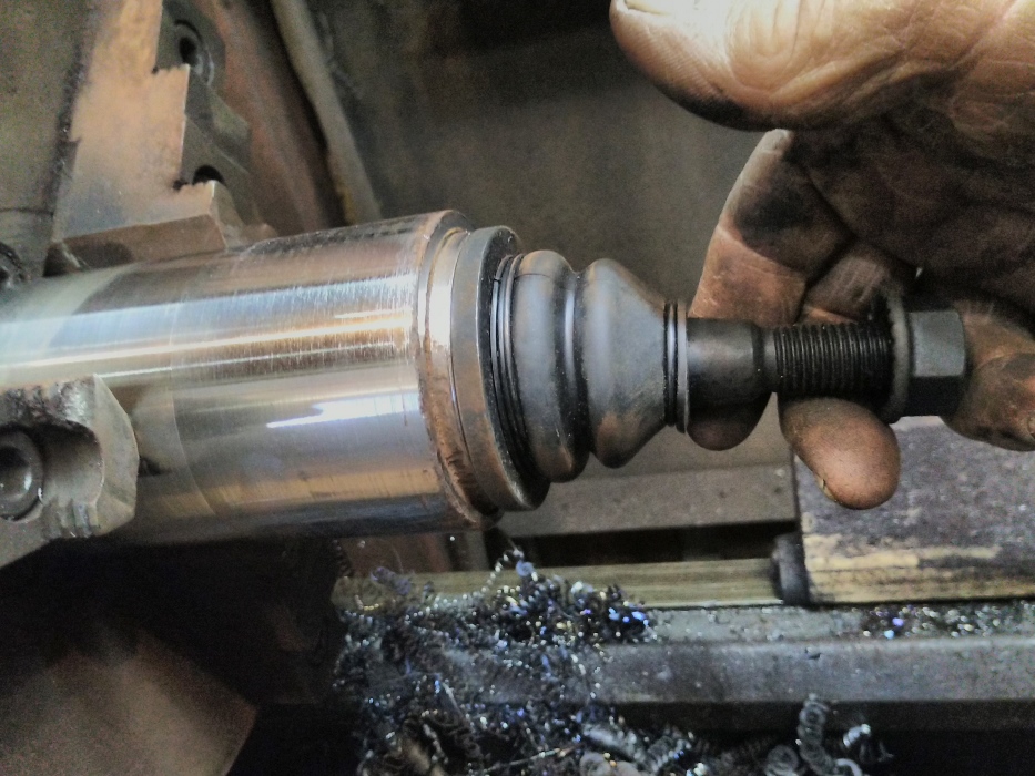

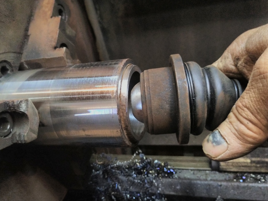

    Then machined the Id of the tubing stub to fit over the od rubber boot this is also the same diameter as the boss that presses into the control arm
    Ball joint removal and install tool for GM vehicles-img_20230501_162540bjt.jpg
    Ball joint removal and install tool for GM vehicles-img_20230501_162555bjt.jpg

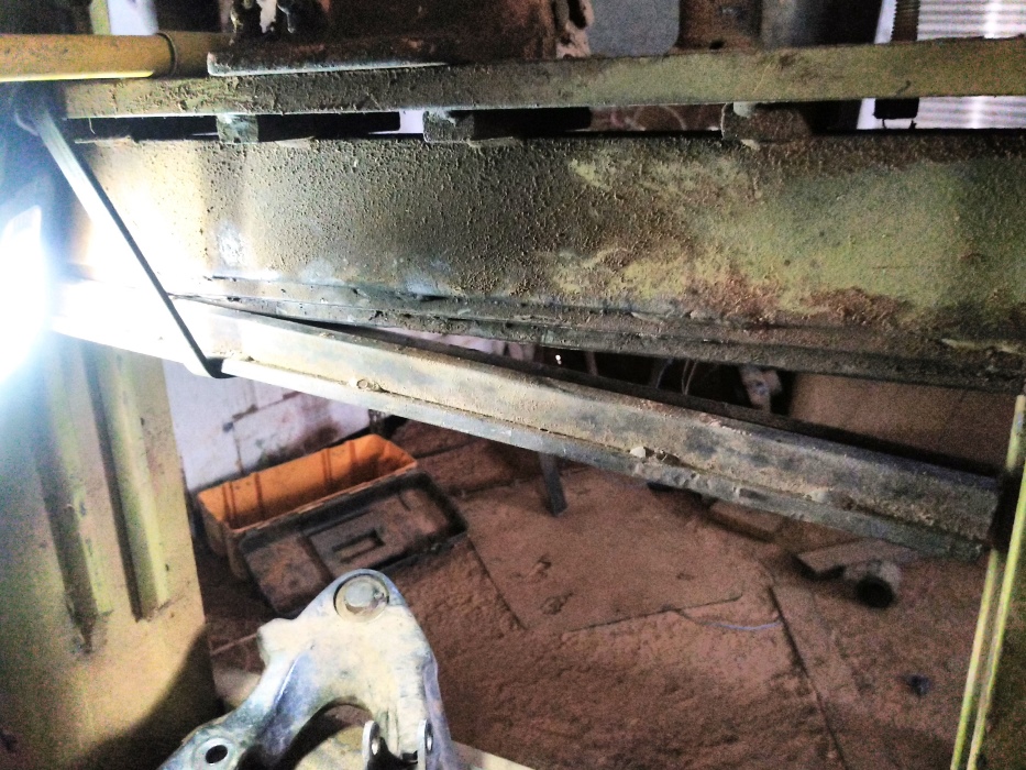

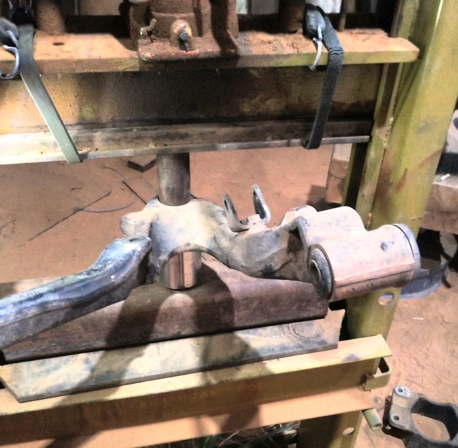

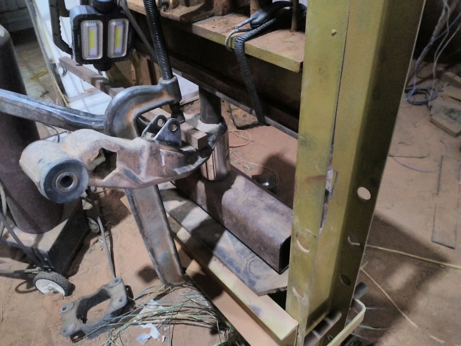

    Next comes the set up. since I have a metal break punch permanently mounted to my shop press I suspended the bottom die under the punch with rubber tarp straps so I would have a flat pressing surface
    Ball joint removal and install tool for GM vehicles-img_20230501_180204bjt.jpg
    After getting everything aligned up and ready to press the ball joint out
    Ball joint removal and install tool for GM vehicles-img_20230501_180451bjt.jpg

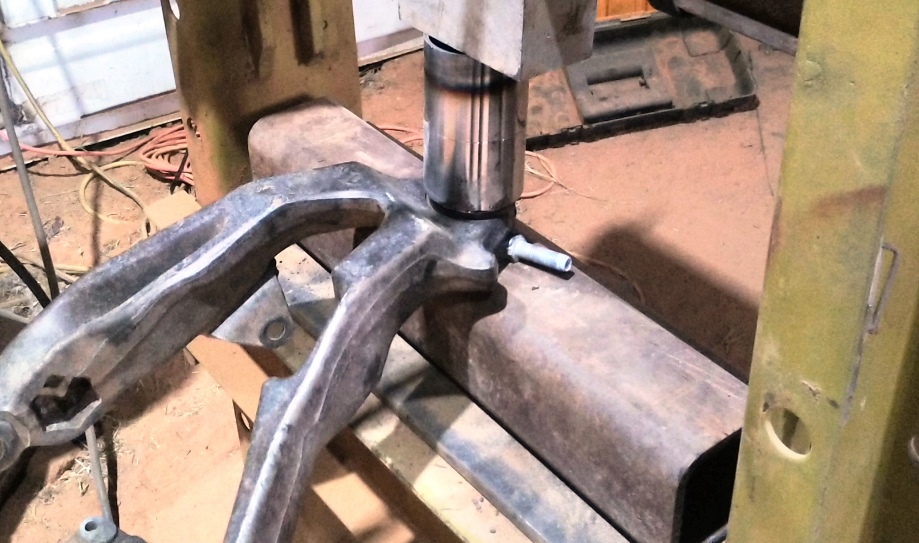

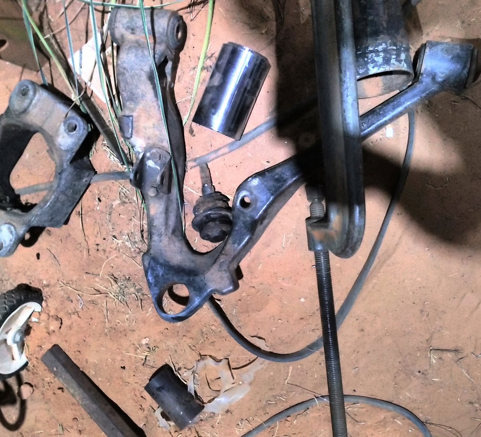

    I noticed that the arm did not have a flat surface around half of the ball joint flange
    Ball joint removal and install tool for GM vehicles-img_20230501_180502bjt.jpg

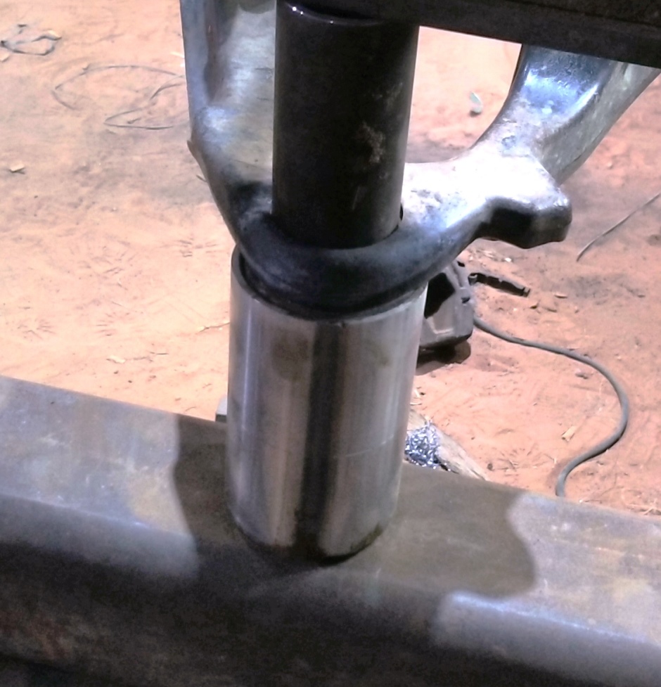

    I needed a way to keep the arm from cocking up on one side to do this I used my 16" heavy duty C clamp to hold it down
    Ball joint removal and install tool for GM vehicles-img_20230501_181435njts.jpg
    Maxed out the 8 ton hydraulic jack added just a little heat and this is the position everything wound up when the ball joint slipped out of the control arm
    Ball joint removal and install tool for GM vehicles-img_20230501_181931bjts.jpg
    pressing the new joint in place only required the tool and a simple 1/2" cylindrical spacer under the arm
