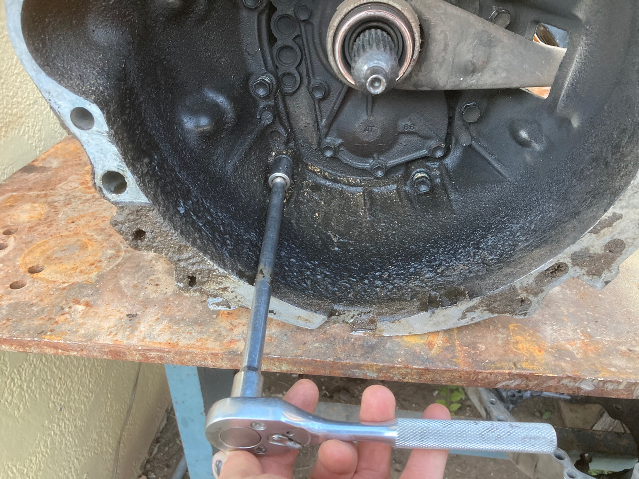

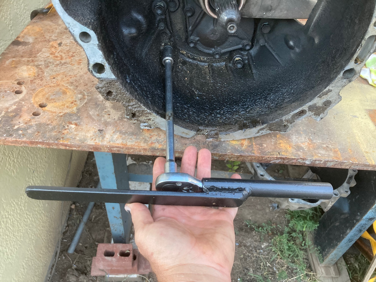

    This tool is pretty straightforward... I needed a way to apply torque to a ratchet using both hands to apply the torque rather than one hand supporting the head of the ratchet and only the free hand applying the force. It works well for my use.

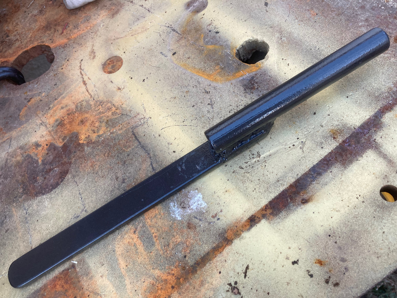

    This is made from a piece of 1/2" steel pipe and a piece of flat bar and fits the handles of several different makes of 3/8" ratchets.
    I realize one can buy a T-handle socket wrench, but I live in the sticks and "running down the street to the hardware store" wasn't an option. This utilizes common scrap, is inexpensive and works well.
    The transmission is strapped down to limit movement, a requirement.

    Hi Yes, a neat and simple idea as mdhatter3 said. But you are not lessening the force required, you are just splitting the same amount of effort between two hands (arms). Making the cheater bar "longer" by extending ALONG the handle end, reduces the effort required by ONE hand. Obviously with the need to hold the ratchet in place with the other hand. Using the shortest possible socket extension minimises the effort required to hold the ratchet in place, and minimises the "distorted" leverage that tries to pull the socket away from the bolt/nut.
    I think the longer bar is better. Perhaps, when in use) you could place the tube part of the tool the opposite way around and have the welded bar point away from the ratchet head. You'll get the extra leverage that way. This tool offers the best of both worlds, well done.

    Can you flip it around and use it as a cheater bar, too? This thing is perfect in its simplicity!
