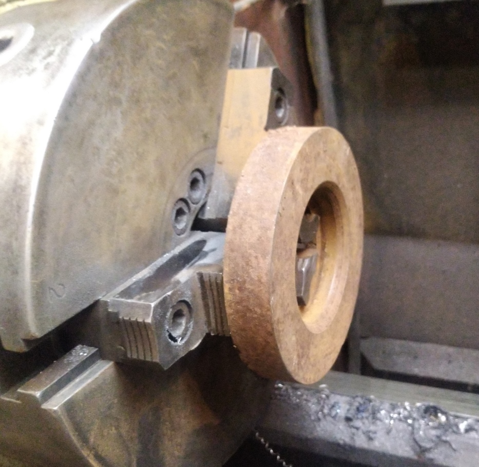

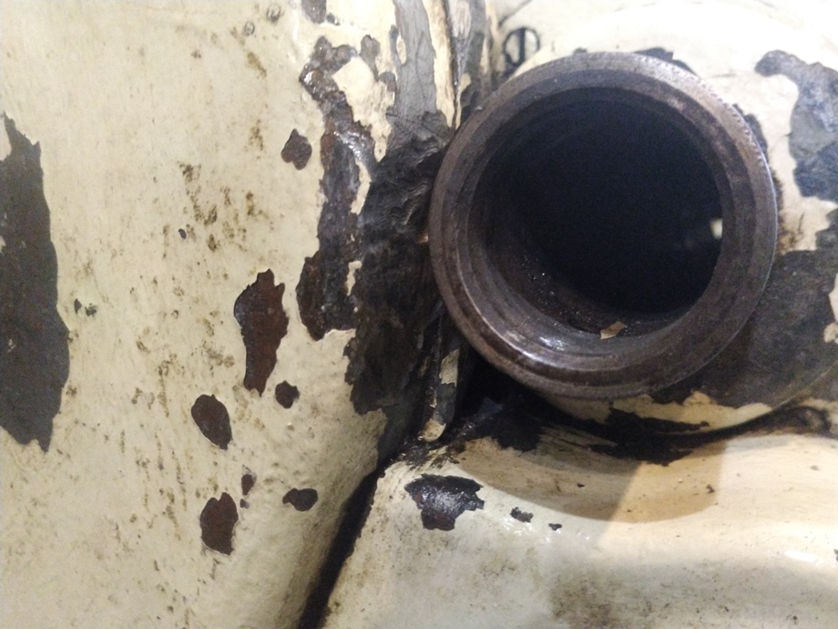

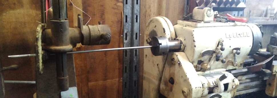

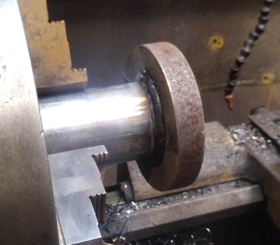

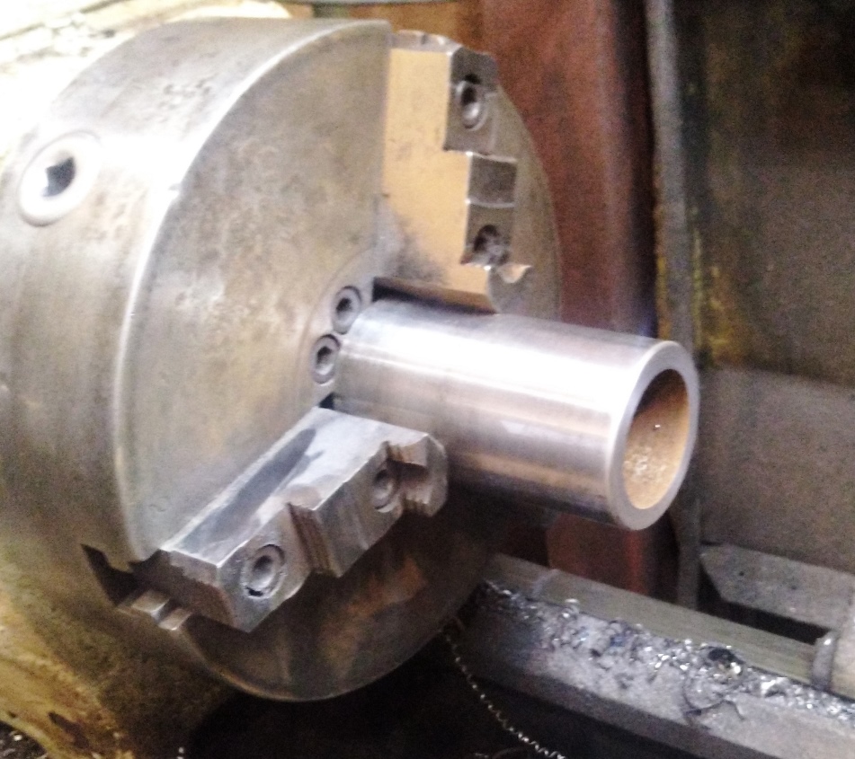

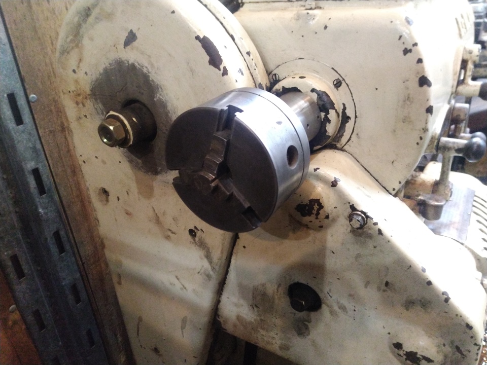

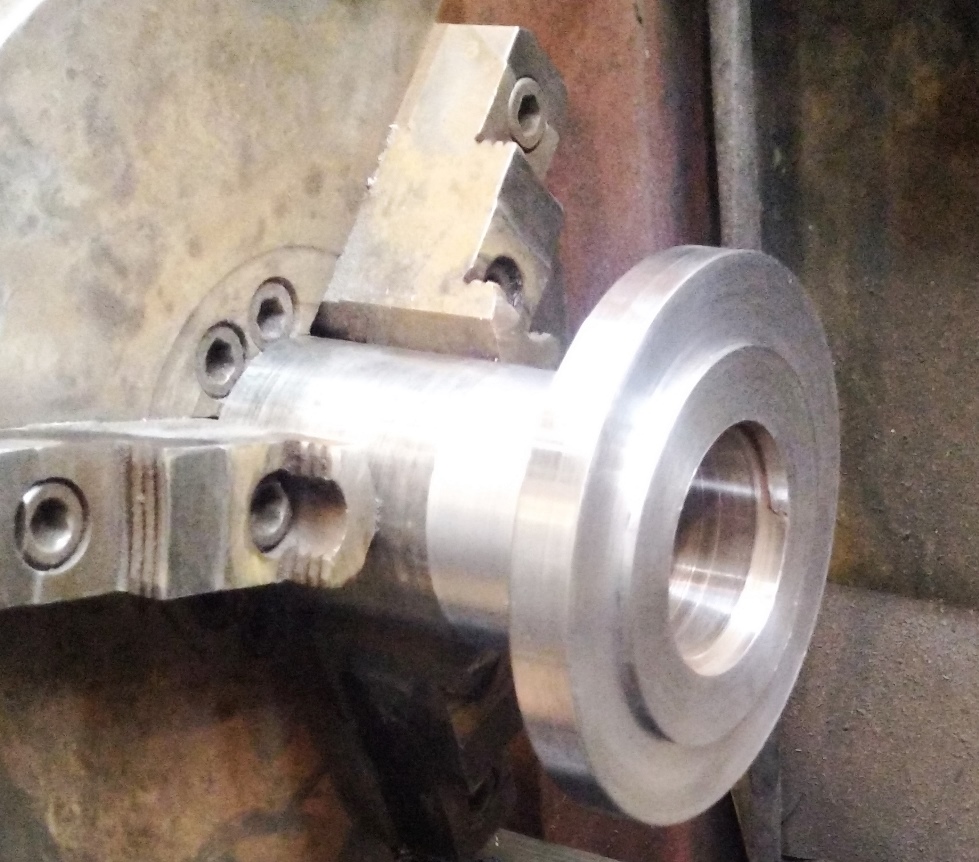

    lately I have been turning a few longer cylinders that reach all the way though my lathe spindle. I have been making do by clamping a bearing to an arbor press but that is really limiting and not particularly convenient or the best way to support these cylinders. also no guarantee of being concentric with the chuck either. I decided during this little cold snap that it might be a good time to come up with a way to mount a chuick on the back end of my spindle turning the lathe into a double chuck lathe of sorts, but why stop there since I sometimes have to use a 4 jaw on square stock Si I made the adapter to accept both a 3 jaw and a 4 jaw chuck.

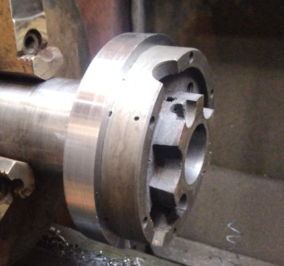

    press fit

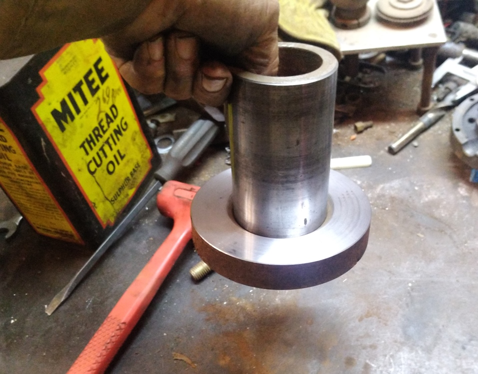

    tap fit
    tap fit for the modified 4 jaw

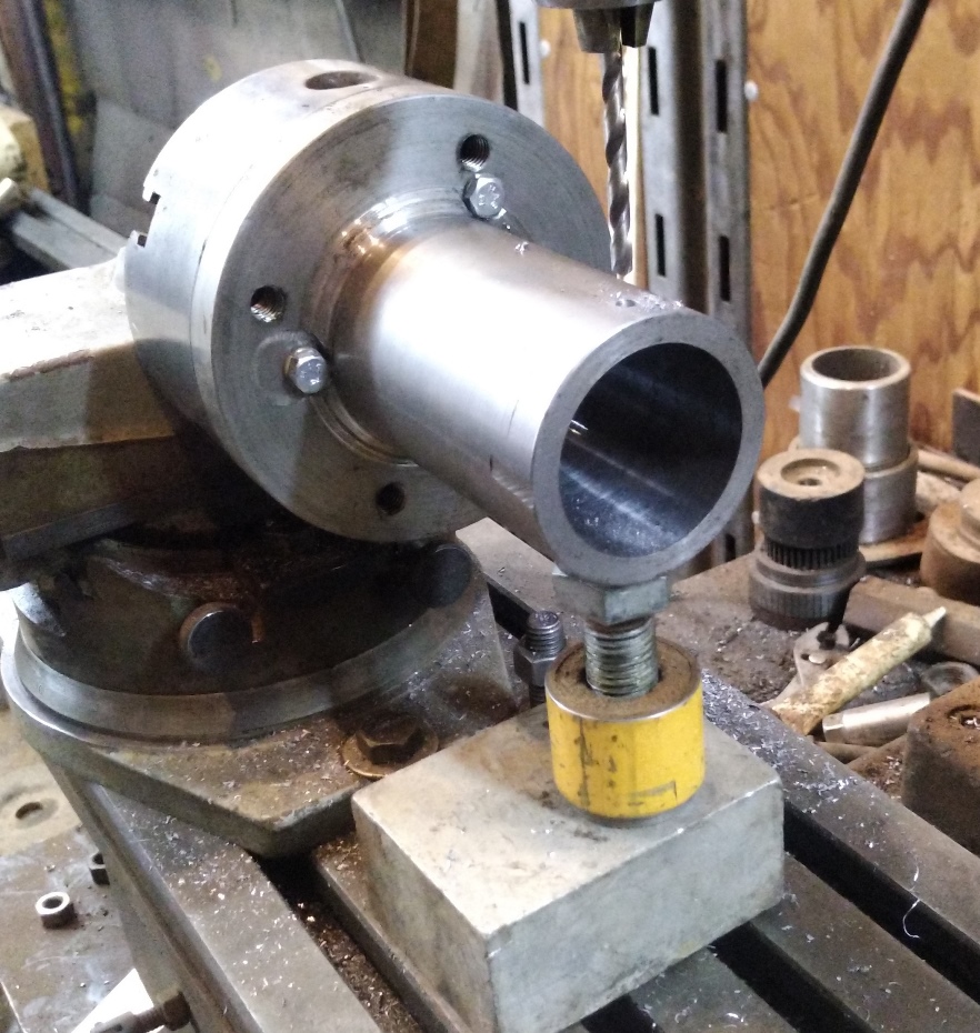

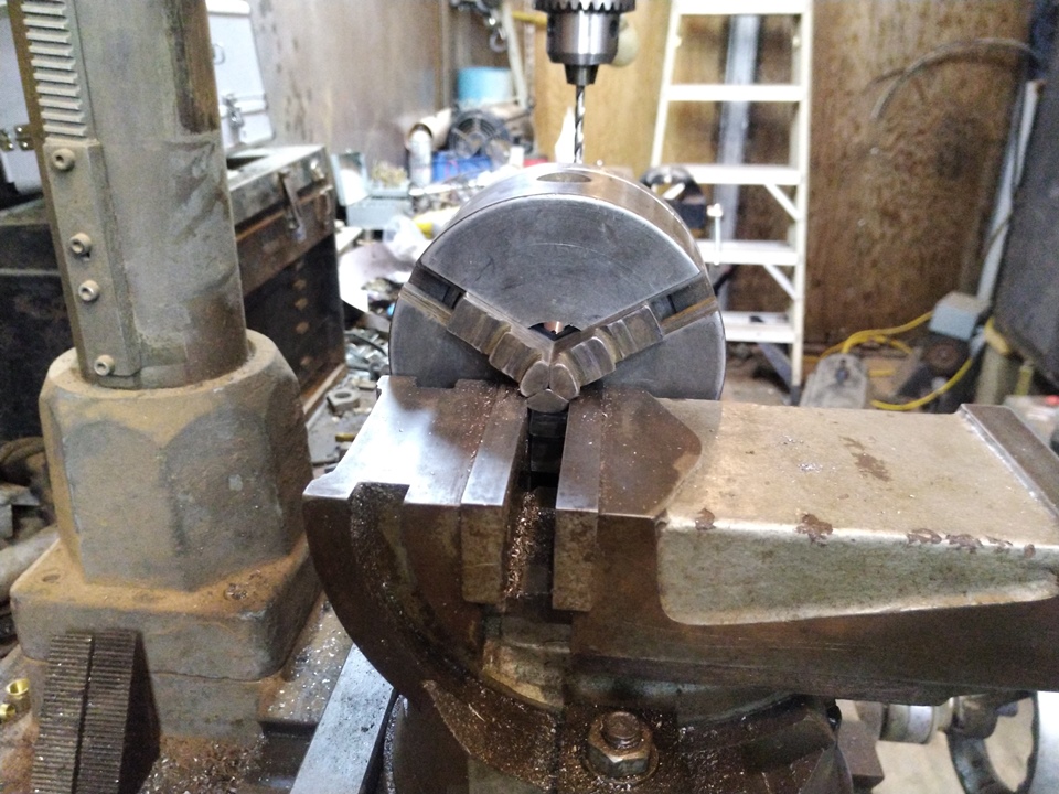

    What better way is there to locate holes 120° apart around the adapter
    that to clamp on a jaw and support the end with a machinist jack

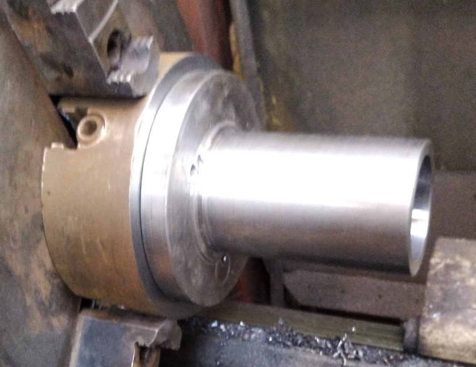

    Had to die grind with a small bur to gain clearance
    One reason I hardly ever do videos is for one I don't care for them 2 I find them a royal pain to do. but if I do upload a video they are usually short. This shows the runout of the adapter which is near zero the only movement I found in the indicator while running the lathe at full speed was when it passed a nick in the adapter that was caused when I was spot milling for the chuck mounting bolts.

    Having a chuck on both ends of the spindle is so much handier than a simple spider or needing to make a bushing for each diameter of cylinder or square and odd shaped stock. On my lathe my chucks are 36" apart this works out great when I have to thread the ends of a 72" long piece of 1/2" ss tubing Chuck it in both chucks add a bushing to my Arbor press steady does away with any risk of having the tubing bend from whipping
