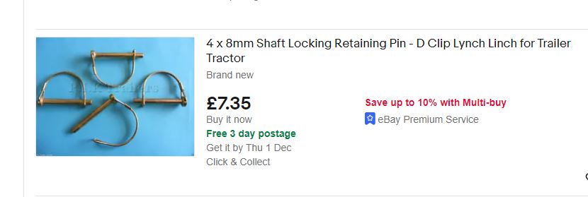

    the pins and securing clips beautifully made and finished. can you tell us more about those please

    Quote Originally Posted by sniffipn View Post
    Hi
    The pins, are called linch pins and are very cheap to purchase different lengths, diameters and are passivated. So unfortunately I didn’t make them. But they wouldn’t be difficult but cost against materials and time to me it makes more sense to purchase items like this.

    thanks
