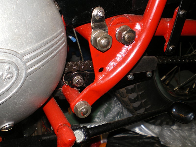

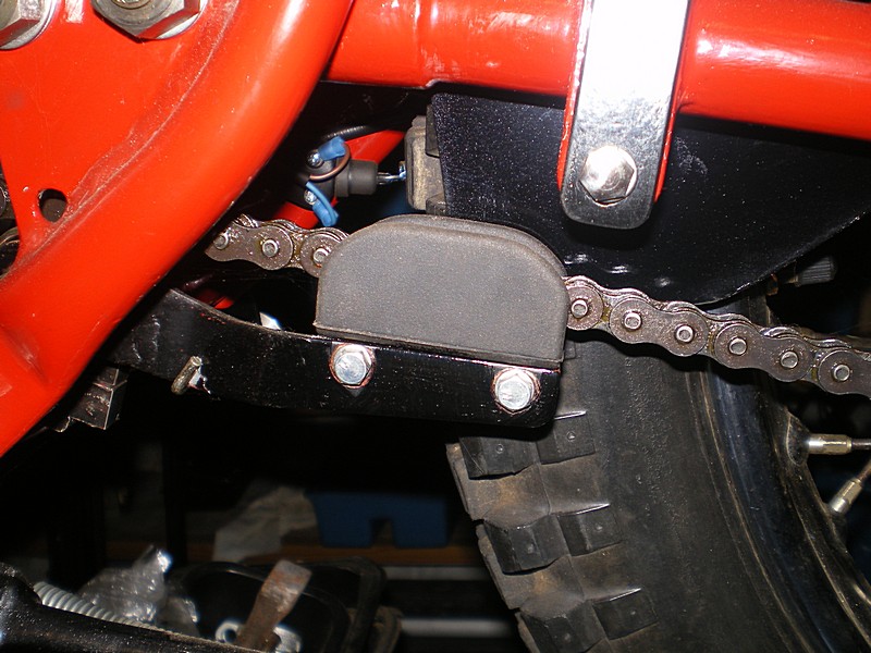

    Great resourcefulness but I have never seen one attached to a centre stand before and it really worries me. I do share Pjs concerns, the rpm of any roller or small sprocket in contact with a chain is likely to be excessive. Better to use a slipper guide instead which controls tension and guidance.
    If the stand grounds when cornering as is not uncommon this will surely dismount the chain at the worst possible moment.
    This is a cheap universal guide, frame mounted and modified to fit my 1953 DOT trials bike.
    Awesome idea with Motorcycle || Let's Learn Something-imgp0001.jpg Awesome idea with Motorcycle || Let's Learn Something-imgp0002.jpg
    Hate to see anyone have a bad ride.
