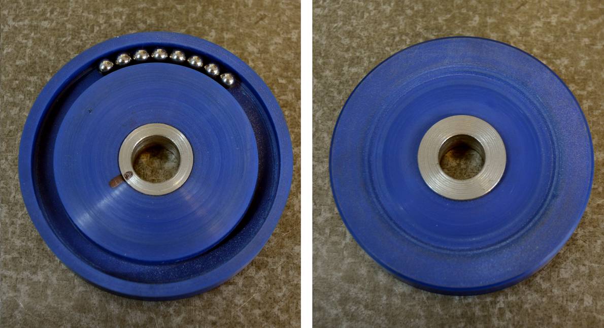

    Decades back I had access to mercury and I made similar devices using mercury instead of balls. Years later after some house moves , new grinders and the loss of the mercury source I tried the same with water. That only worked when I made them with impractically large diameters.
    This theme has prompted me to revisit this. A month or two ago I wanted some hard and heavy balls and I bought a box of 1/4" tungsten carbide balls. They were not expensive and should be better for this application. In fact when I finish writing this I'll be in the workshop making one from a Delrin case for low friction and carbide balls for their mass. Also their greater mass to size ratio should reduce any sticking problems. Lead balls might work but I doubt that they would retain their shape over time and start sticking. Delrin might suffer a similar fate over time from brinelling by the carbide balls. If so then I will change to metal cases.
    PS. I'll do this with a square groove about 1 mm wider than the ball diameter. The balls will only contact the holder on the outer part of the groove when in use so plenty of clearance on the inner wall will do no harm unless it is so big that the balls jam under one another.
    I'll report back.
    PPS. I have already changed my mind. I will go for steel cases and forget the Delrin.
    Last edited by tonyfoale; Jan 31, 2020 at 03:58 AM. Reason: Correcting brain fart.

    Attached Thumbnails Attached Thumbnails auto-balancing bench grinder arbors-wheelbalancer.jpg

    Quote Originally Posted by Hopefuldave View Post
    Thanks for the write-up gents!
    Tony: Where did you find "affordable" carbide balls? I've been looking and they'd cost more than the grinder I have... (which does a natty rumba across the bench).
    Also, the case looks pretty easy to 3D print, I may have a go at that!
    Dave H. (the other one)

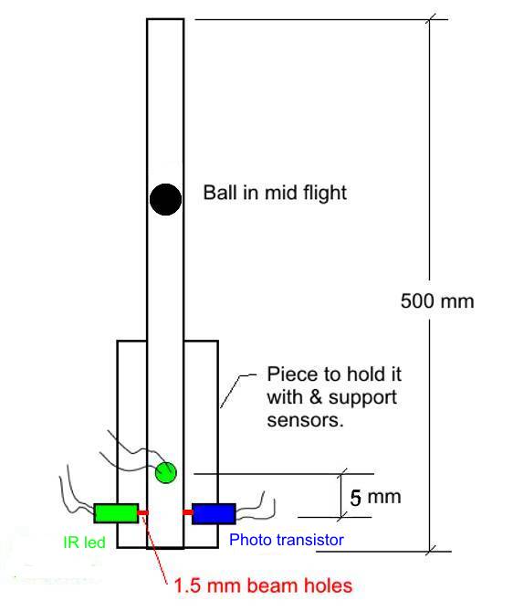

    Try https://www.acerracing.com they also have a presence on Amazon and eBay. Good luck. IIRC I bought a pack of 10 1/4" balls, I think that they were around US$15.
    I actually bought the balls to use in a Leeb style hardness tester that I built. However, I found that steel balls worked better in that application.
    auto-balancing bench grinder arbors-hardnessthingy04.jpg auto-balancing bench grinder arbors-simples-1.jpg Click pix for full size
