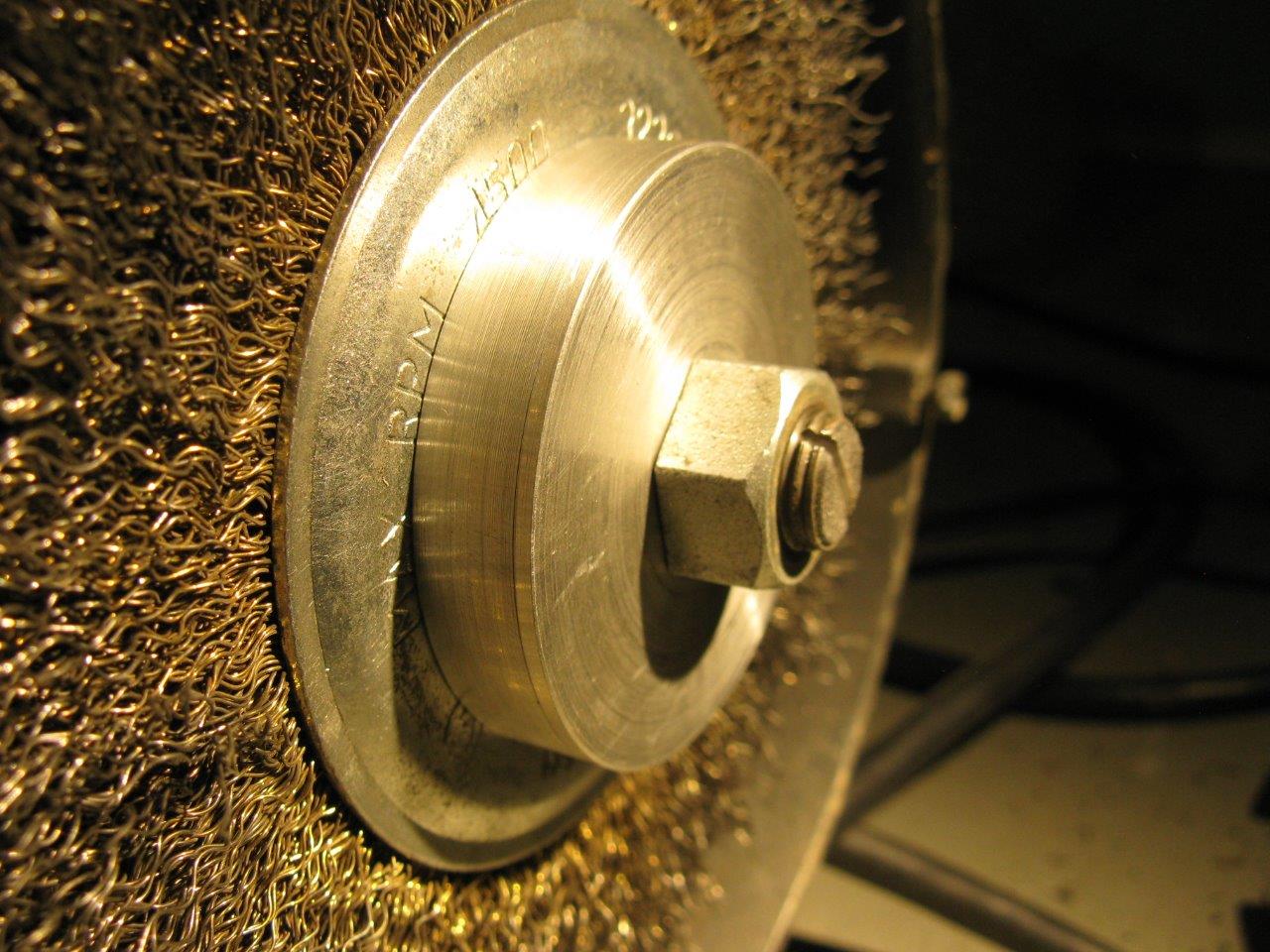

    still a bit of a work in progress, but I made these in the hope of balancing a wire wheel which is causing my grinder to vibrate.
    Idea is to have a groove in which some ball bearings are free to rotate and come to rest at the point of lowest effective mass on the wheel, thus balancing it. Well, that's the idea anyway, not quite there yet.

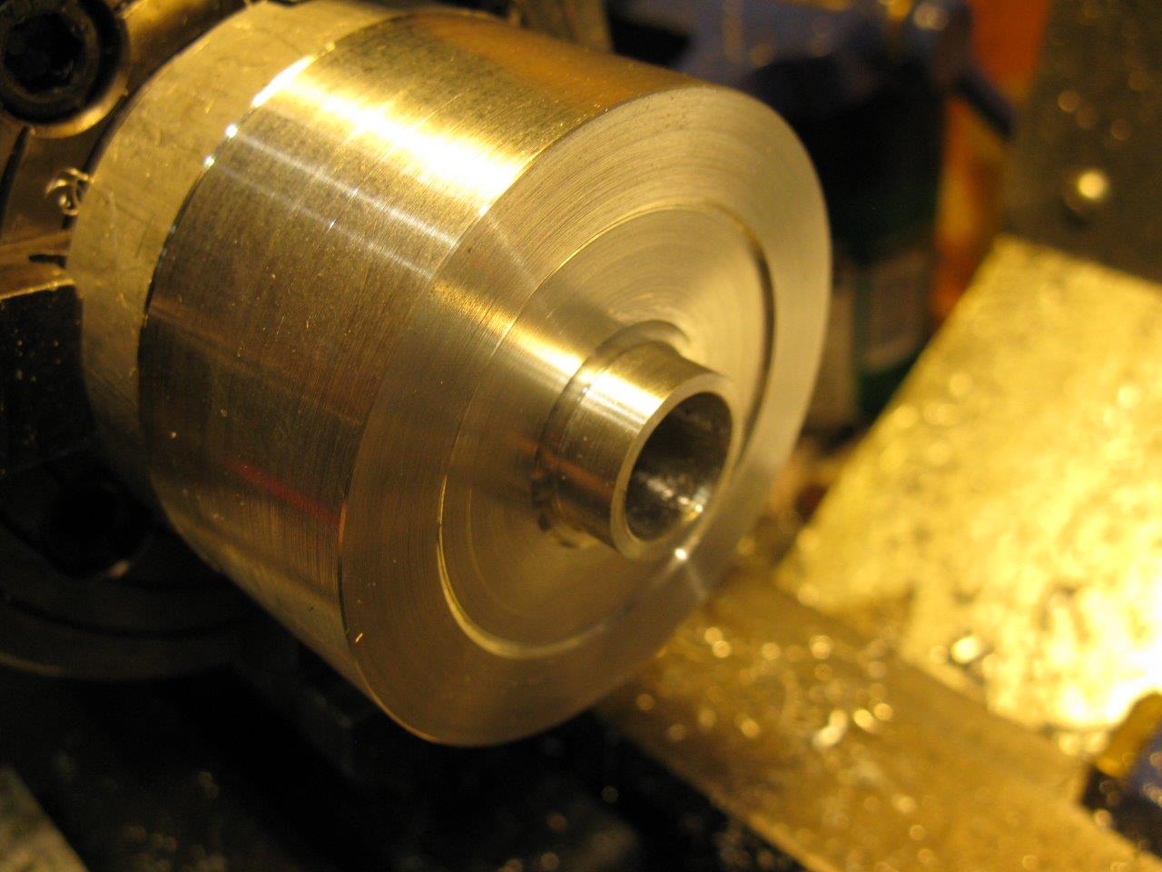

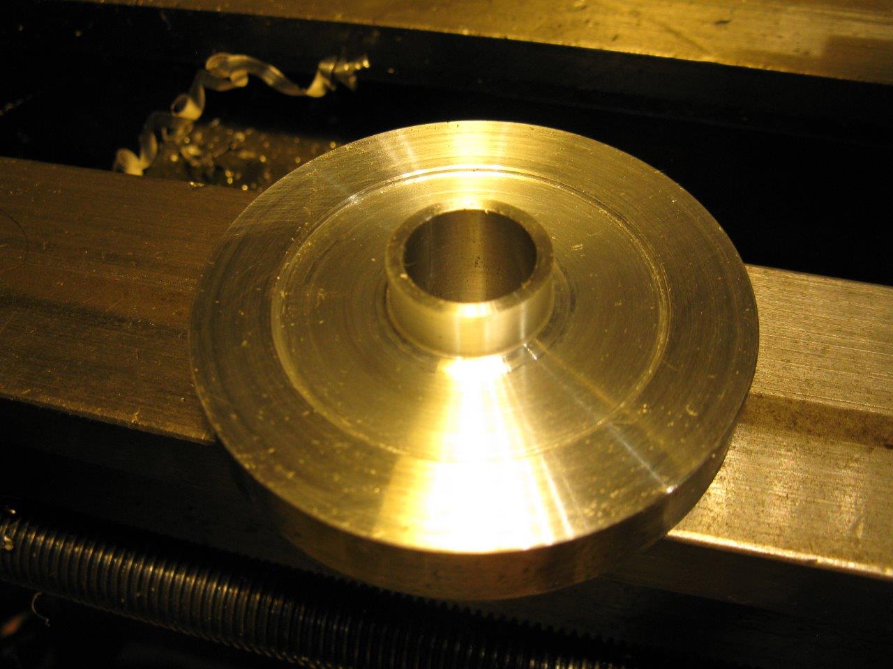

    blank turned and drilled

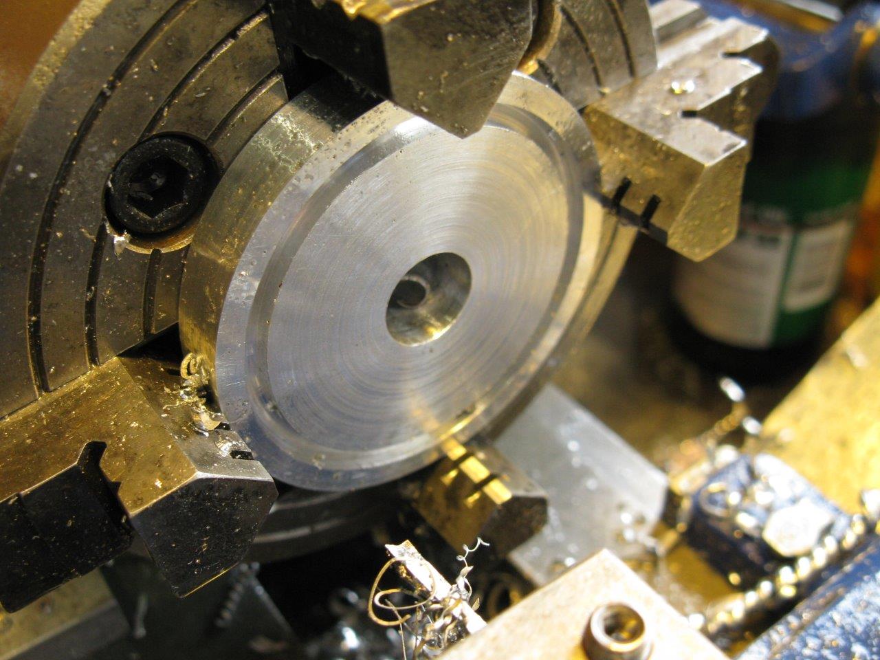

    reamed to 0.501 or so, slip fit on the arbor. Face relieved so that the arbor only contacts the wheel at its periphery. Not 100% sure why this is necessary, but that's how the original ones are made so..

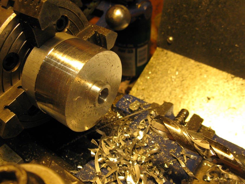

    first arbor parted off

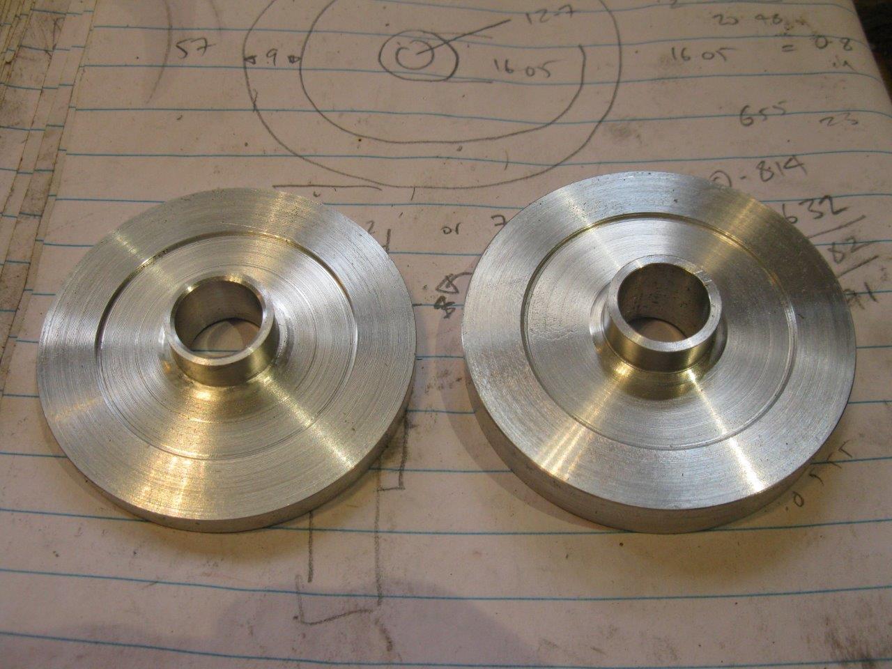

    one set done - the other set was already made from a previous grinder

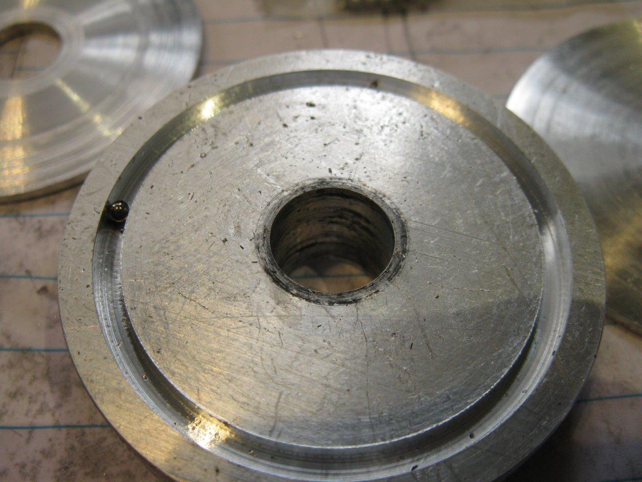

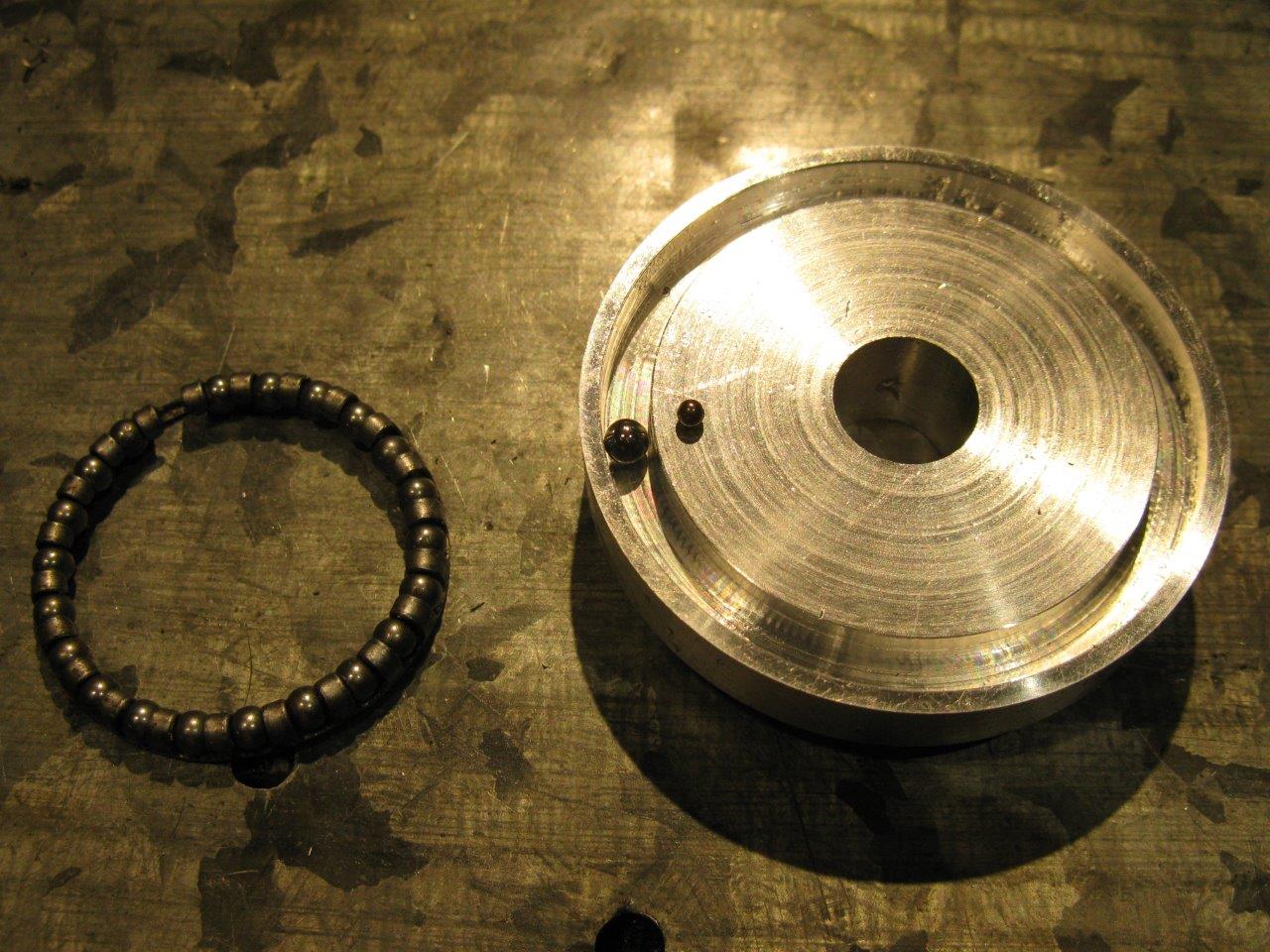

    mounted, centered and a groove trepanned for 3/32 balls (for my mtb pedals)

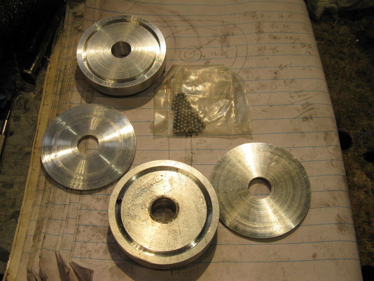

    both sides done, with the bearing covers also parted off from the same blank
    test fit
    balls loaded. After the 1st try, where nothing happened, I cleared out the grease. Still nothing, so I added more balls - 25 on the wire side.

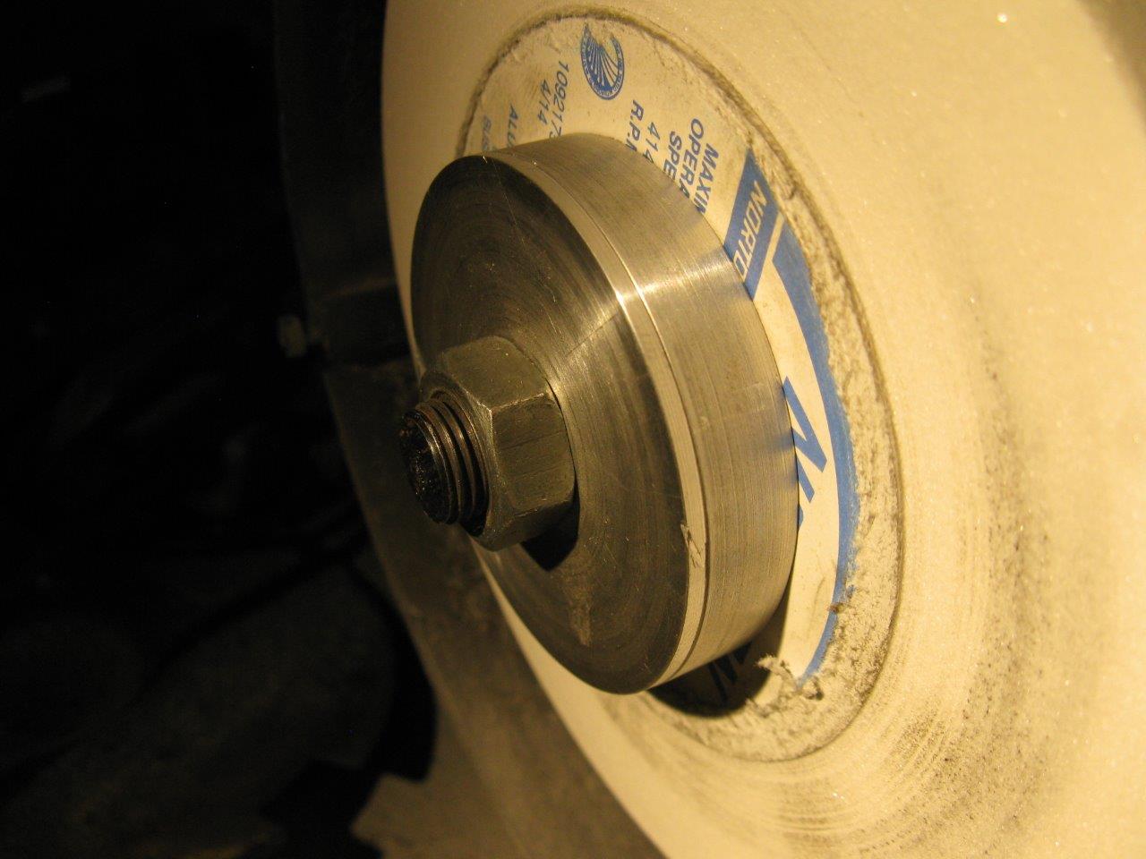

    stone side. This side really didn't need any balancing, ran really smoothly without any balls. Figured I'd add them anyway in case the balance changes over time with wear

    the arbors did help reduce vibration a bit, but not eliminate it completely. I'll be cutting the groove to 2x ball width to allow the balls to bunch up to see if that improves things. If not, I cut the groove deeper and use larger bearings for more mass. I'll report back with my findings!

    had a play last night, recutting the groove on the wire wheel side to fit 5/32 balls from an old bike headset bearing. After playing around with ball number, between 10 and 15 (1/4 and 1/3 full) seemed to work the best, although it didn't completely remove the vibrations. Probably about 2/3 less vibration with the balls in than not, compared with about 1/3 reduction with the 3/32 balls. 3/16in or even 1/4in balls would probably get that last 1/3 but I don't have any 3/16 balls and I don't have enough material in the arbor to safely cut the groove 1/4in deep. Good enough for me and now I can get onto the next project!
    edit - for 8in stones, I'd make the arbor with a larger diameter (mine are 2 or 2 1/2in, can't remember) and start with 1/4in balls. It's a fairly simple project, the machining didn't take long at all.

    So no oil or grease on the balls?
    I tried grease to begin with but it didn't let the balls move freely, which is key to it working properly. I thought about oil, but the balls move very freely in the groove and you can hear them move into position when the grinder starts up.
