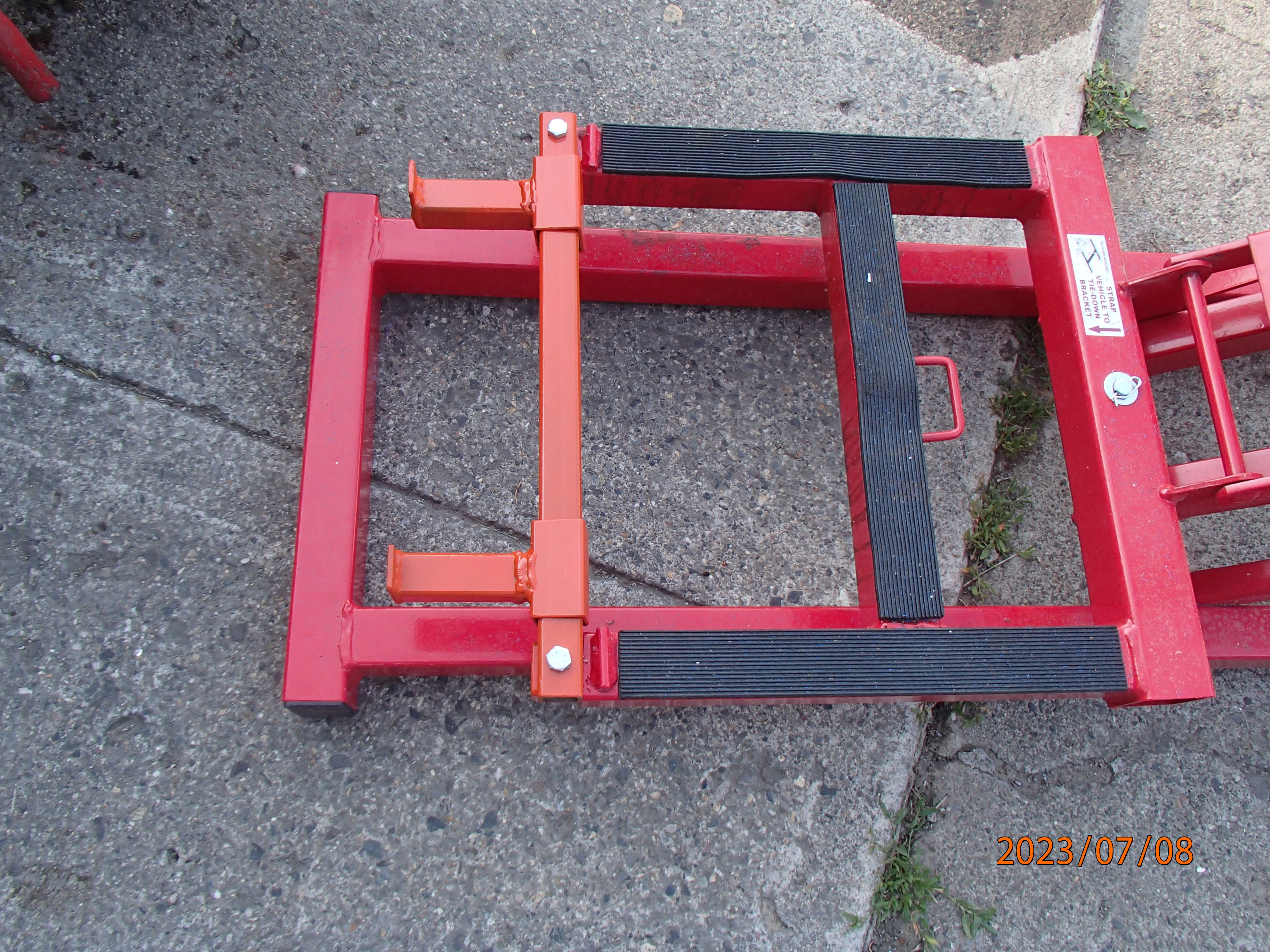

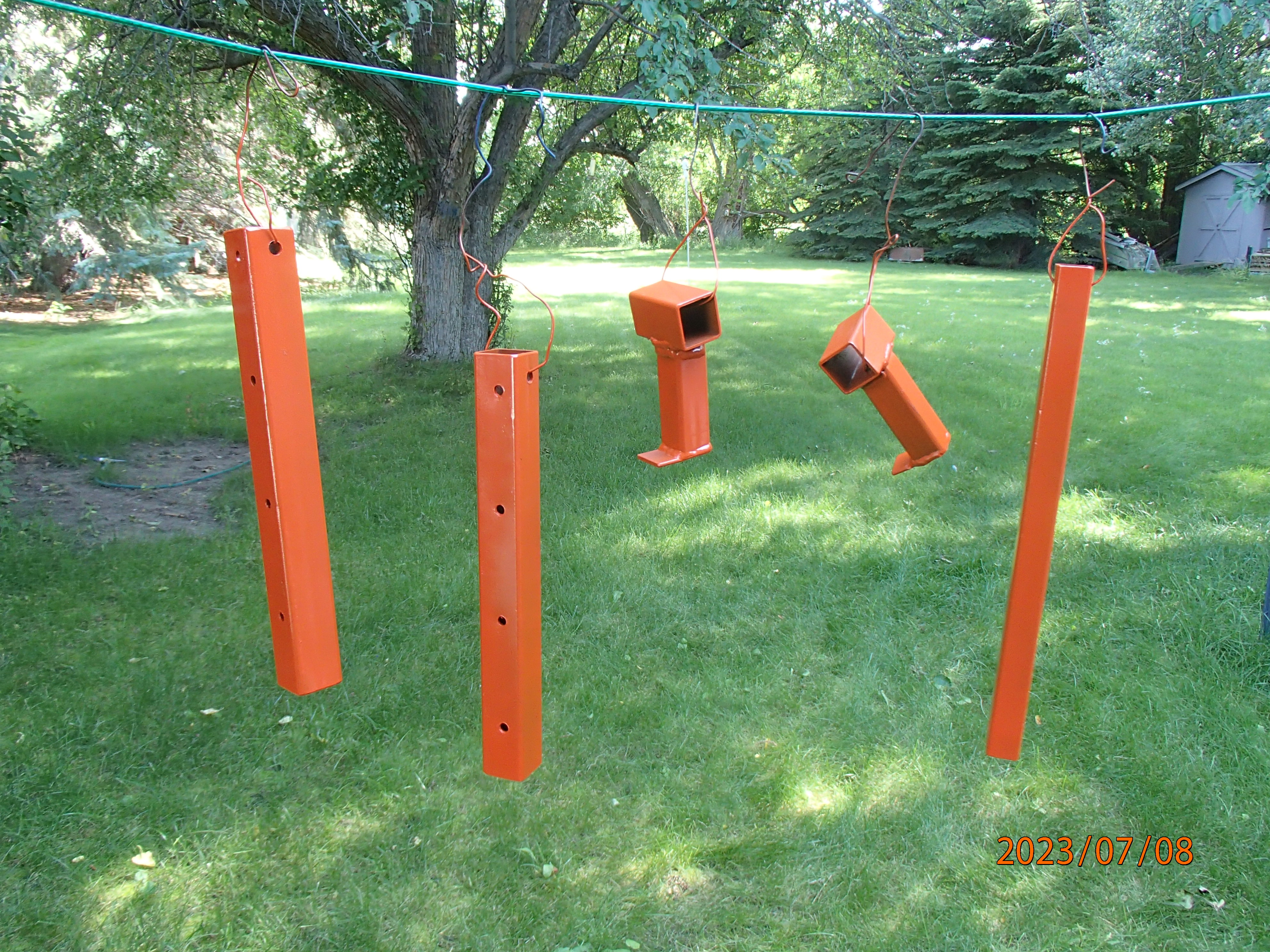

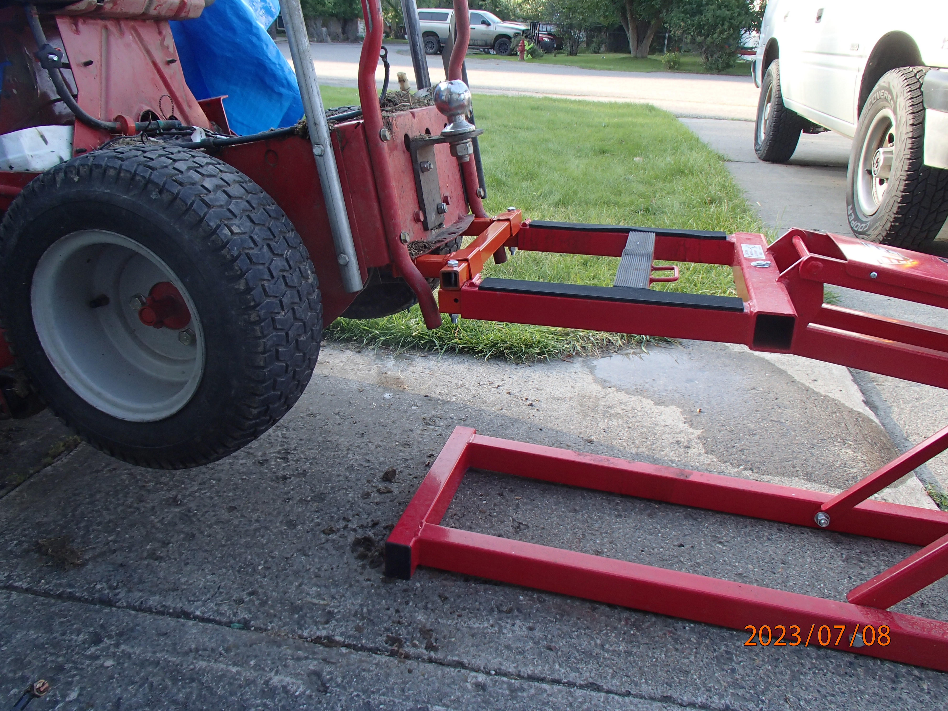

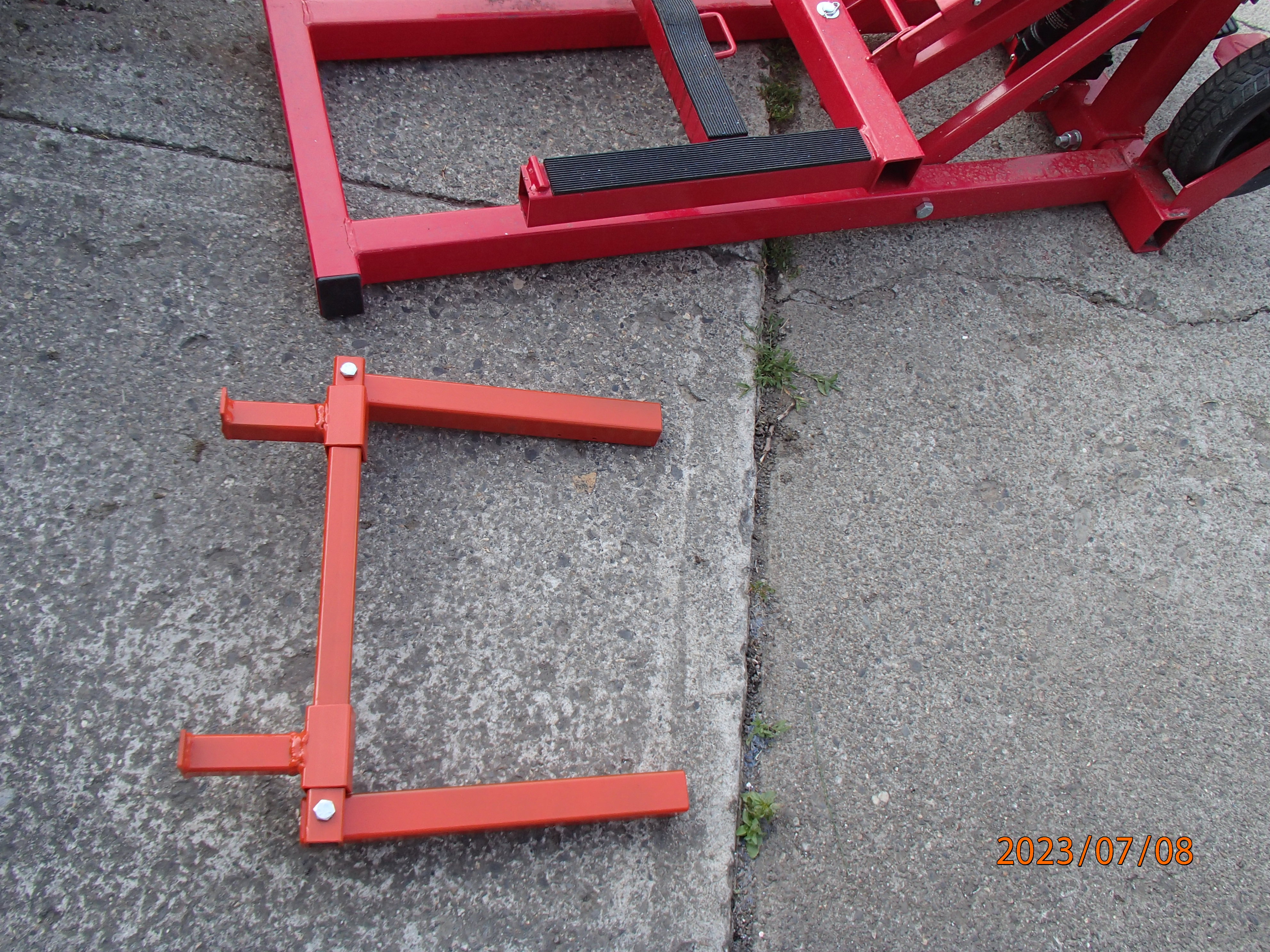

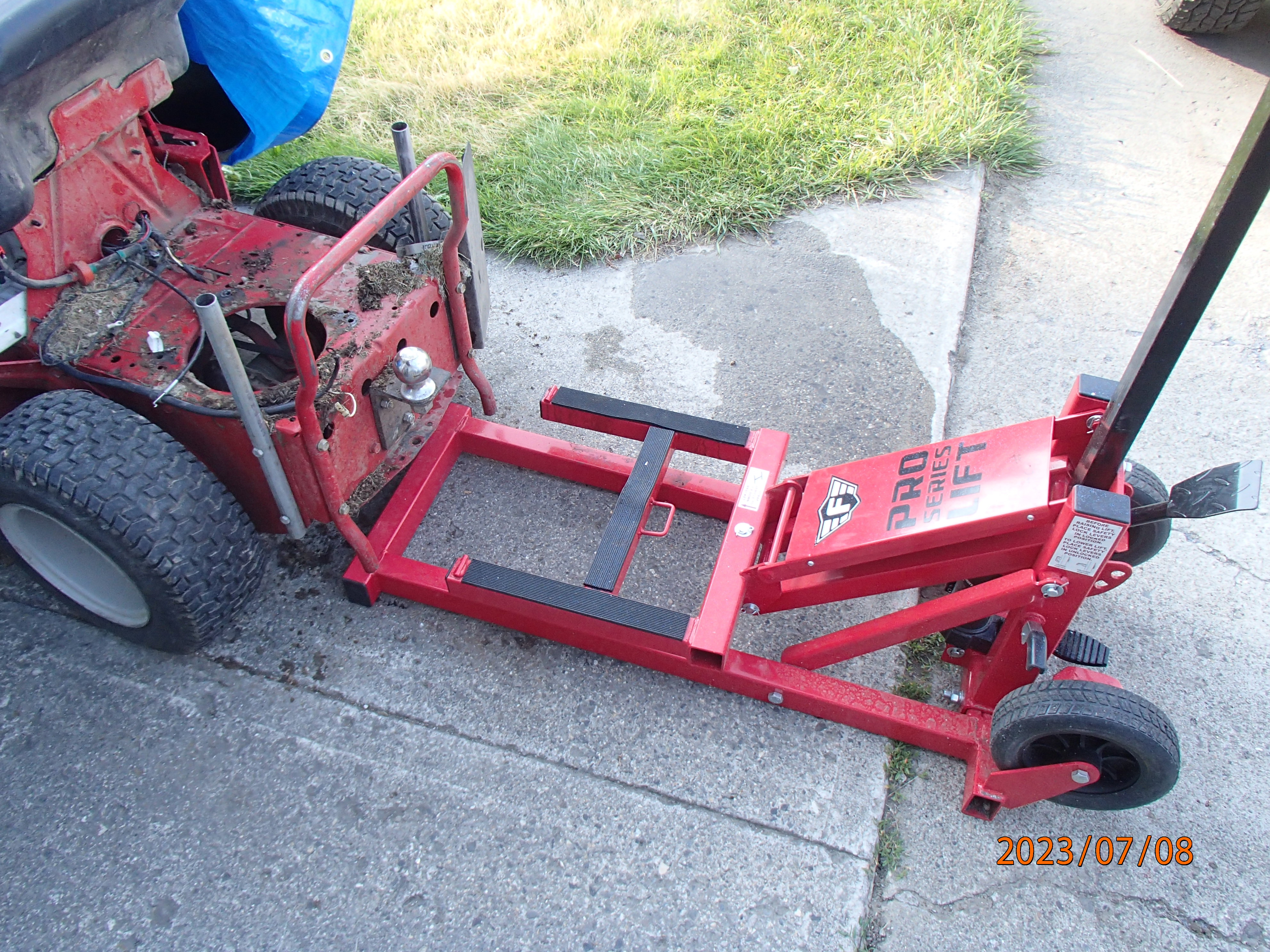

    A recent addition to my collection of tools is an ATV/mower lift from HF. I needed to remove the engine from my 24 year old Snapper, so approached the rear of the mower with the lift, but didn't like the fit-up. I had to remove the wheels in order to make room for wrenching, making lifting at the chassis a necessity. So, decided to make an accessory from scrap parts. I liked the result so much I, even, painted it. Nothing fancy, but functional.
