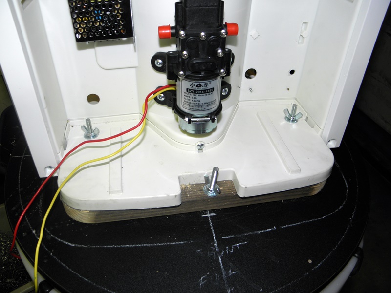

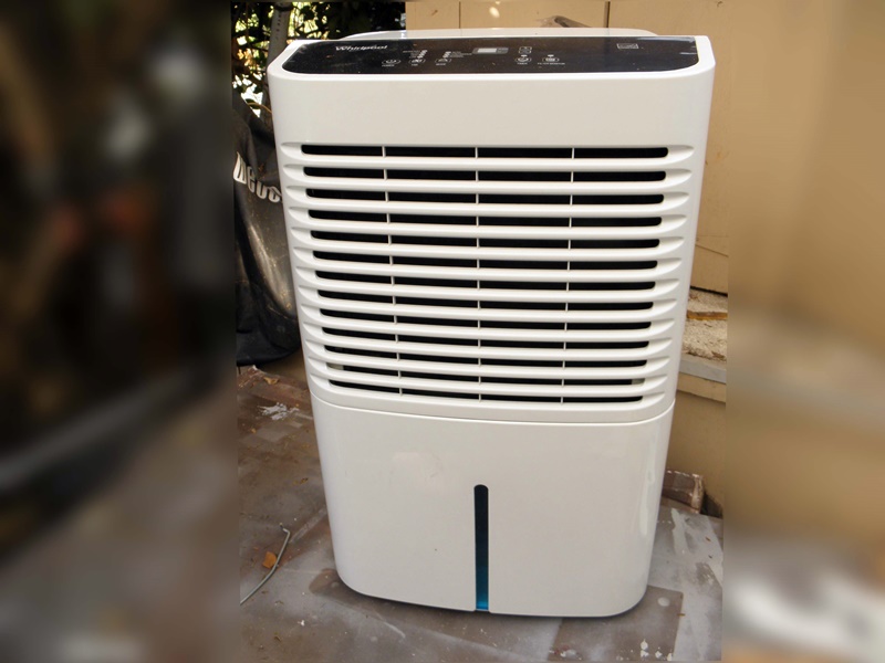

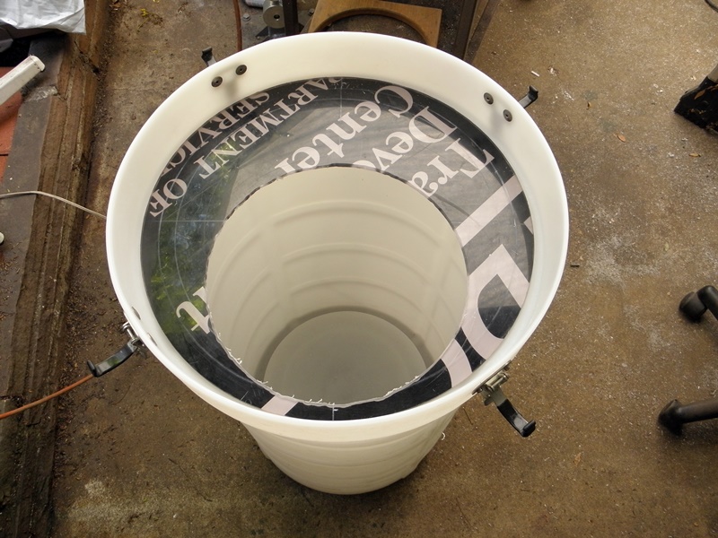

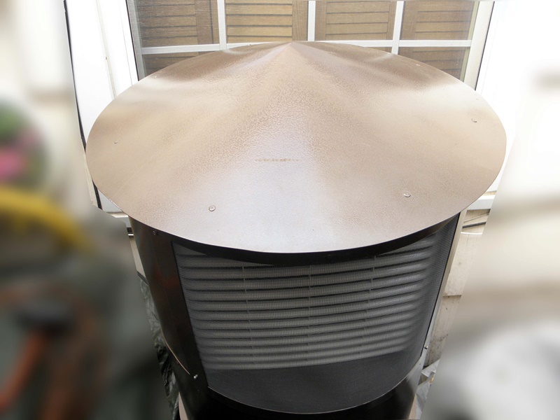

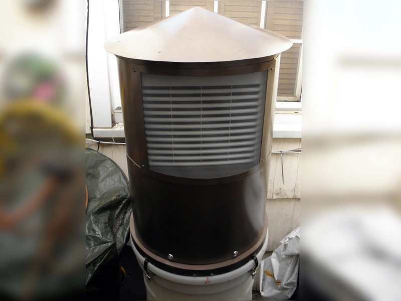

    I started with a 30 gallon food container $25.00 at the local container store.
    I made a round insert hole in a piece of plexi glass that holds a 5 gallon bucket. inside the bucket are the charcoal filters 2 of them.
    I bought two water level gauges so it will stop the unit from putting water in the tank when its full. i also use this for filtering tap water.
    there is some 3/4 inch white pvc that goes down the full length of the food container this tube allows the suction pump to suck the water and put it in the spigot for filling water jugs. there is a float switch inside the food container tank to stop the pump from over filling the tank. I purchased a dehumidifier and took out the small water tank and put a tube in to the food container tank so as the unit makes water it goes into thru filters and then into 30 gallon food container tank .
    in my area I get 5 to 10 gallons of water at night depending on the humidity near the ocean.
    these small dehumidifiers can be run on solar with ample storage battery's.
    I keep 500 gallons (10 x 55 gallon barrels) of emergency water here and can filter this water in this unit if need be.
    I do not use this unit at all it is for emergency only so it stays off until I really need water.
    These are the only photos of the unit I have. hope this helps go online to find others who have made these as units. Cap....:O)
