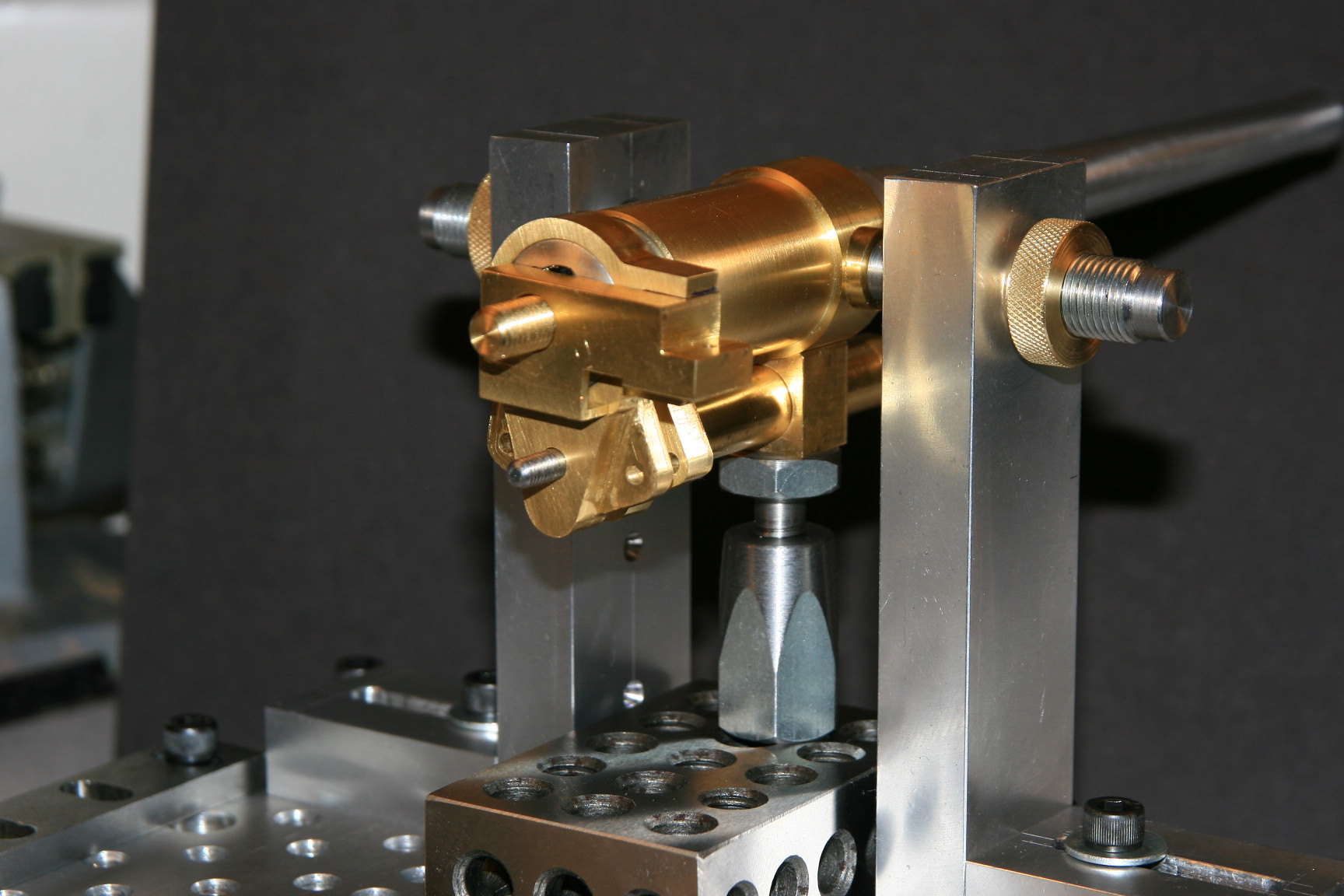

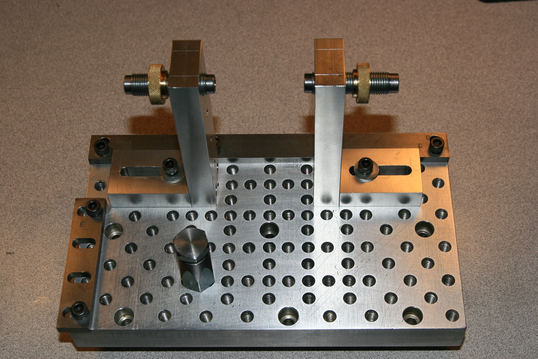

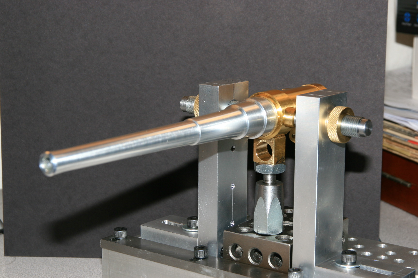

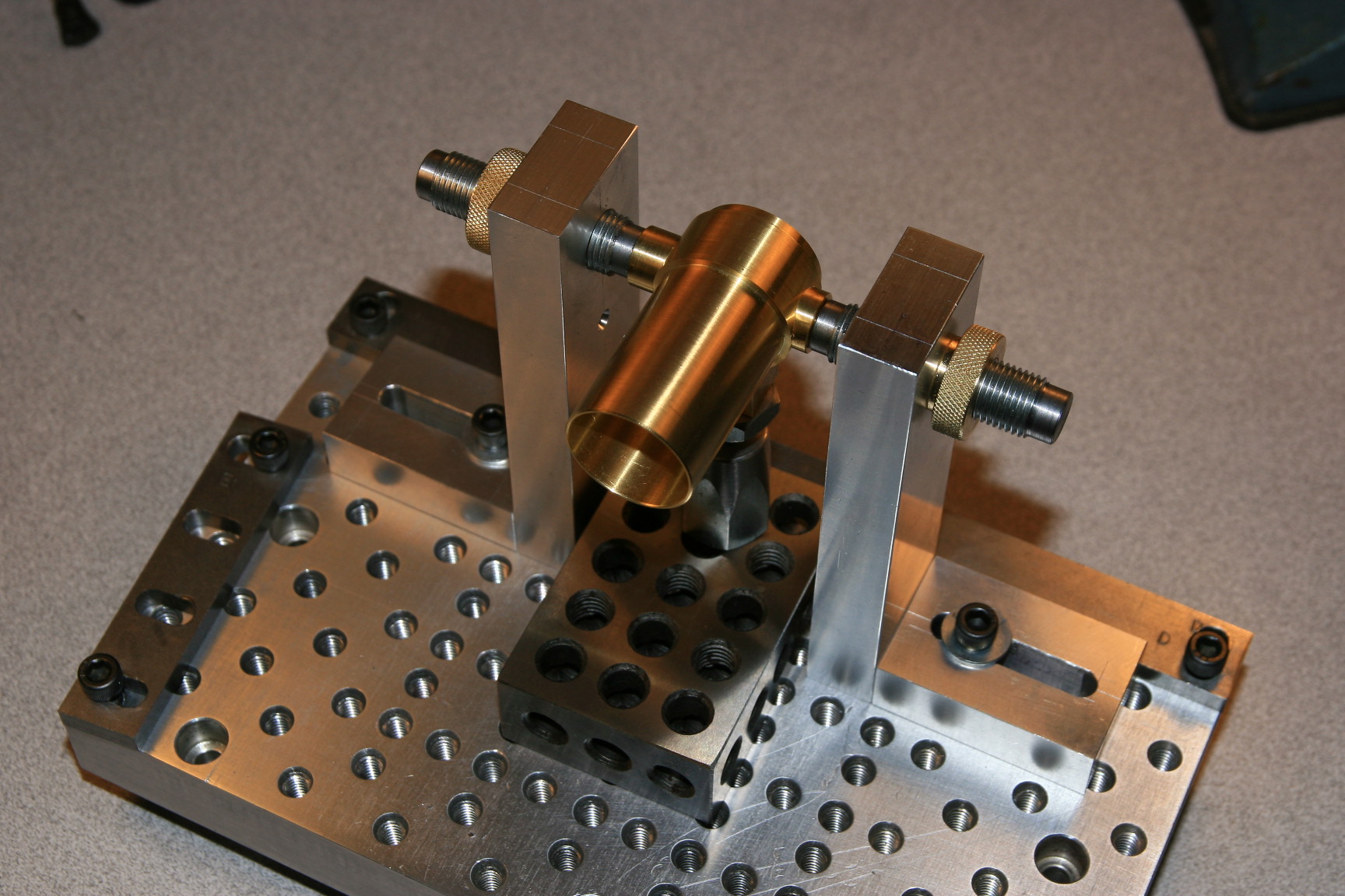

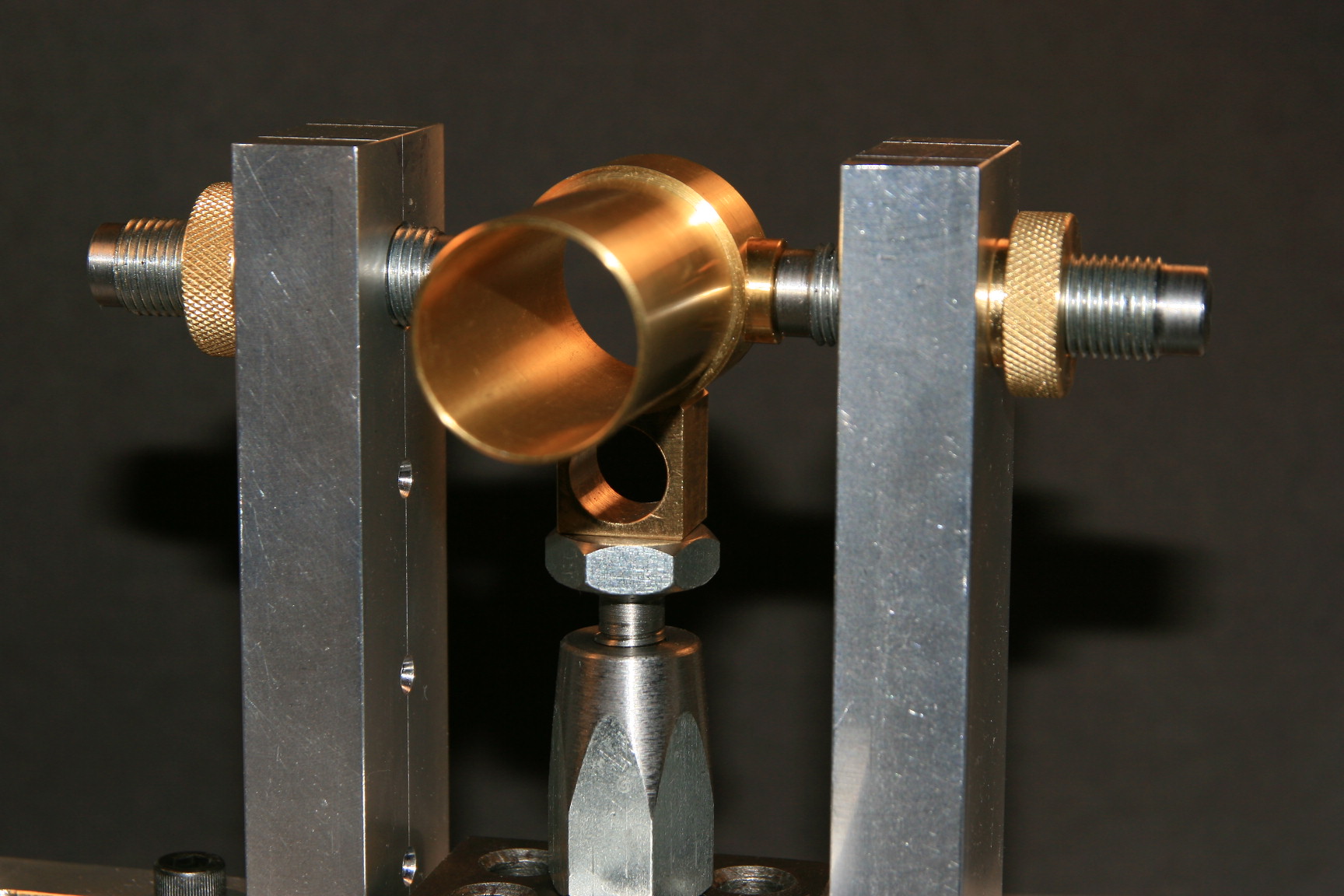

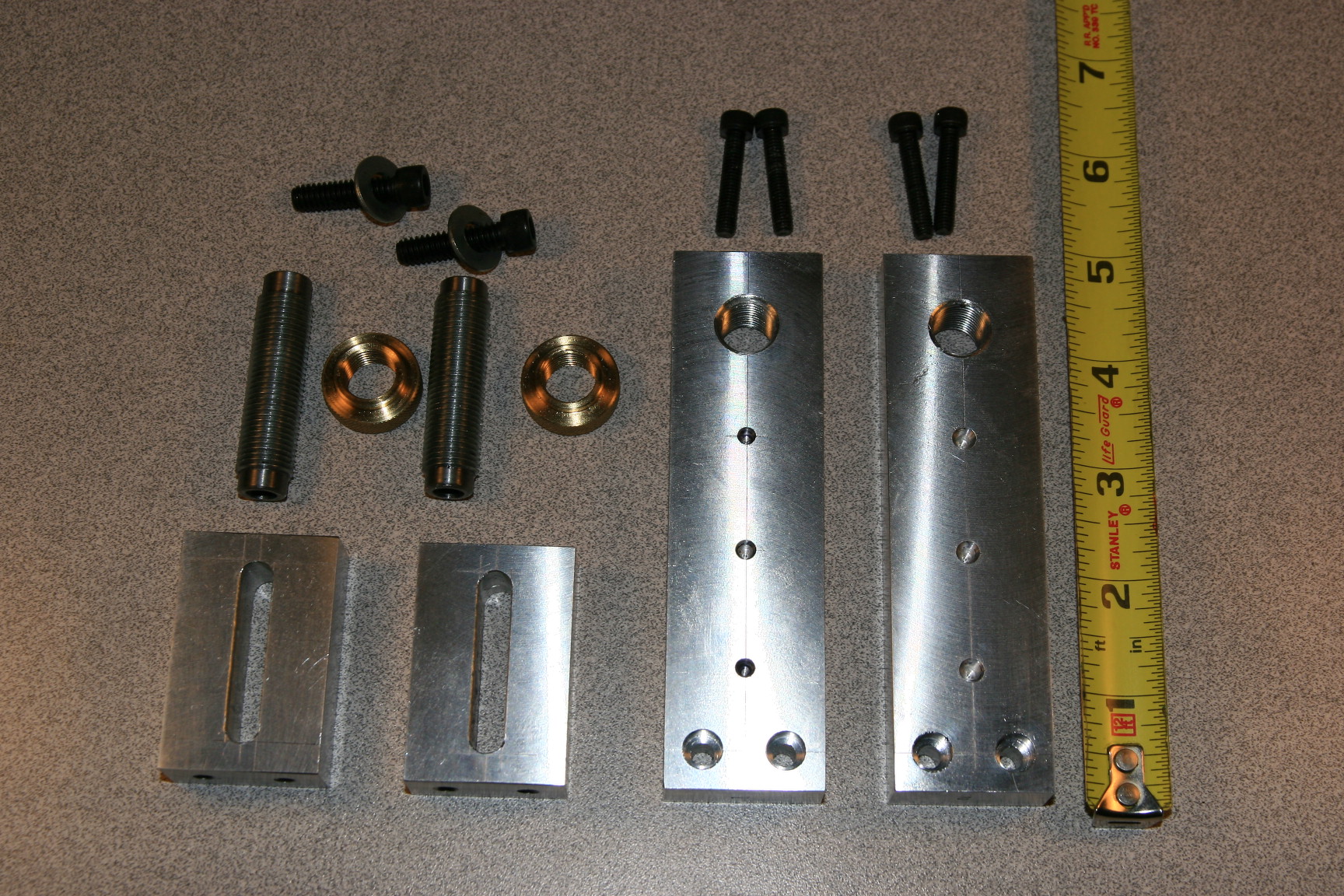

    So I started making parts..The barrel first of course and then moving on down from there. So I have enough of it finished to do a bit
    of assembly but no easy way to hold the parts in alignment. I had several work plates in the shop so I thought one of them would make a
    good base and was just right for what I wanted to do. The
    Here are the pictures of the fixture in use. It is the best way I could think of to hold 6 parts together to test for fit and function.

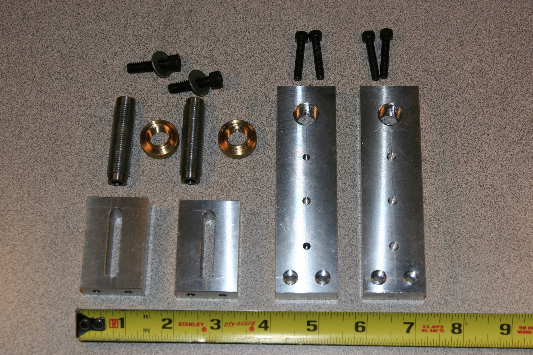

    The end result of the fixture and it's capabilities are just what I was looking for. Basically two angle plates with two modified spindles at the top.
    The two pins are made from 1/2-20 all-thread. One end of each is bored to match the trunnion pins. (other end left undrilled for future use).
    Two brass knobs with fine knurls..(I can't pass up a chance to knurl!)
    10-32 allen cap screws attach the vertical post to each base and a .260 slot in the base allows for coarse adjustment.
    5/8" x 1 1/4" aluminum bar stock for bases and posts. Extra holes spotted for future use and the layout lines are left in place.
    I made it larger than needed for future modification.
    Posts are 4 7/8" long and the bases are 1 1/4" x 2" long.
    Here's the pics:

    I'm flattered that my post inspired you. Looks like you are well on your way to making a great model.
    The setup jig is a good idea. In retrospect, I wish I had had one (or built one) when I was making my version.
    Be sure to show us more progress photos as you continue and, of course, the finished product when it's ready.
