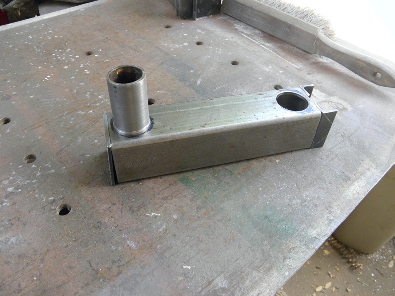

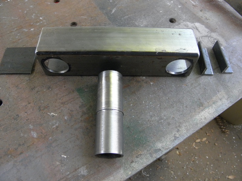

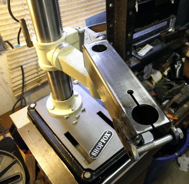

    Articulating Drill Press table extension. This drill press has an extending/rotating head on it, and is the reason for the table extension. Made from 2 inch square tubing 1/4x1 1/4 inch tubing cut to size on the band saw and lathe. Shop Fox drill press.
    The slit I made is hard to tighten, but it works I will increase the slit for less tension before I paint it.
    I did not use the angle brackets as shown I made two 1/4 inch rectangle and rounded on each end, which I welded to the square tubing
    on either side to hold the 3/8 threaded bolt to be changed out later for a wiggly giggly handle.

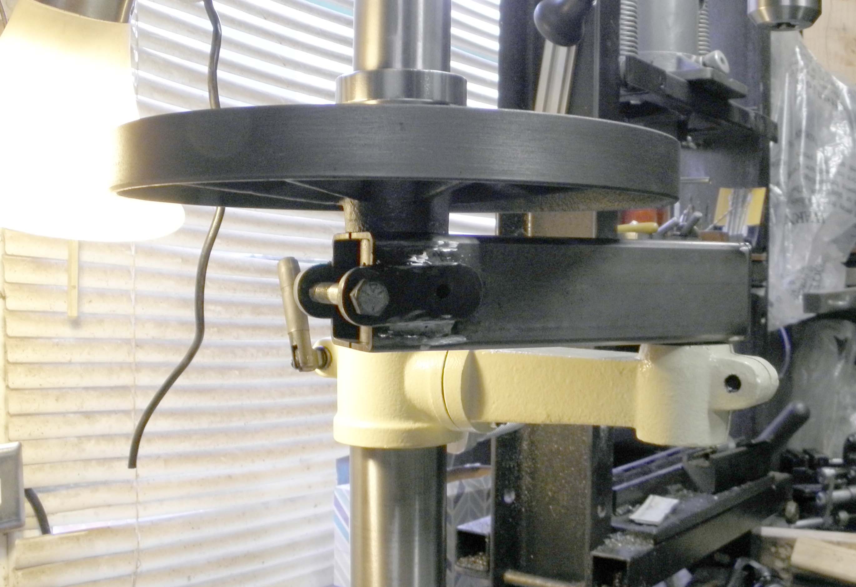

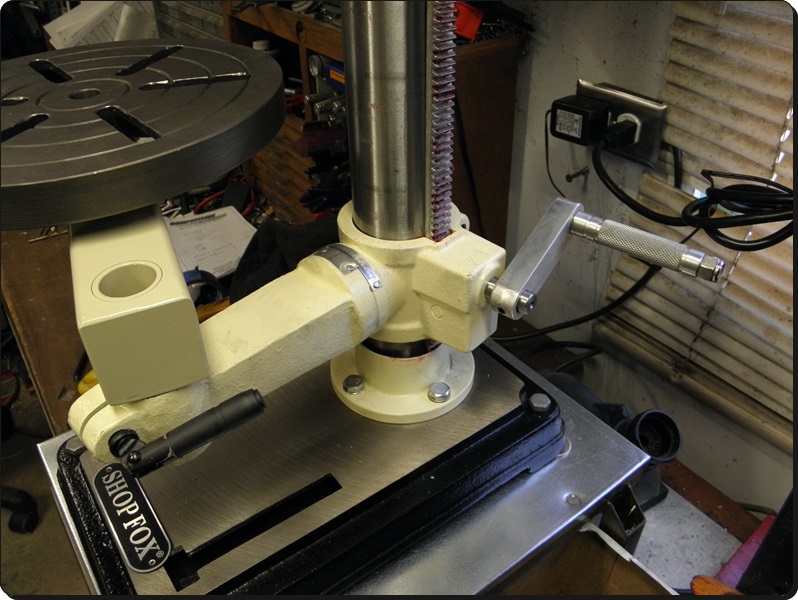

    Great idea!
    I’m not seeing how the middle joint locks to prevent movement. How is that done?
  8. #7
    Jul 2014
    San DIEGO, California
    1,097
    496
    Captainleeward's Tools
    Hi Bloom-Chicago the middle joint has a locking handle but it is on the other side in these photos. also you can be my friend check it out.
    here you can see the handle. :O)
