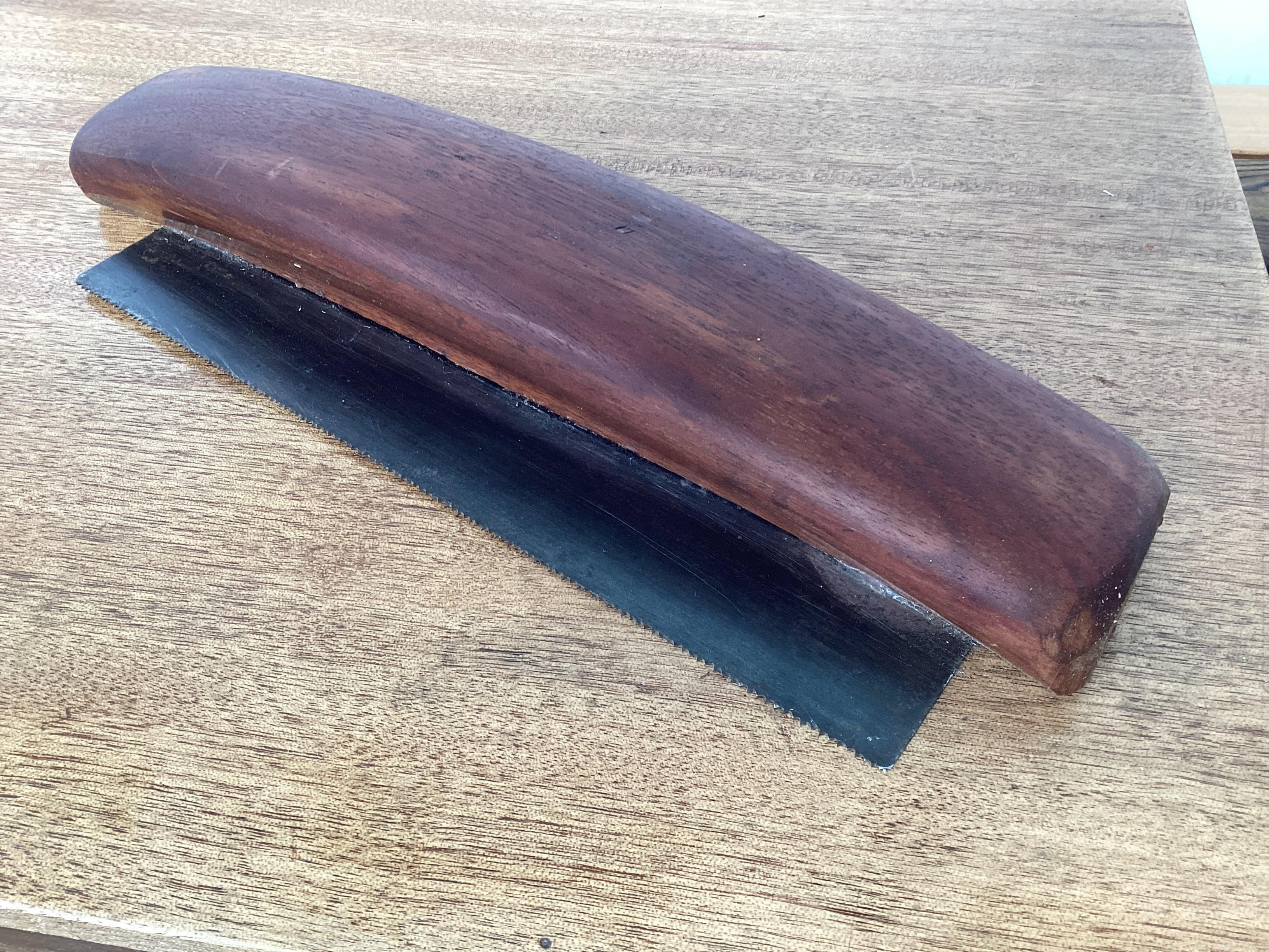

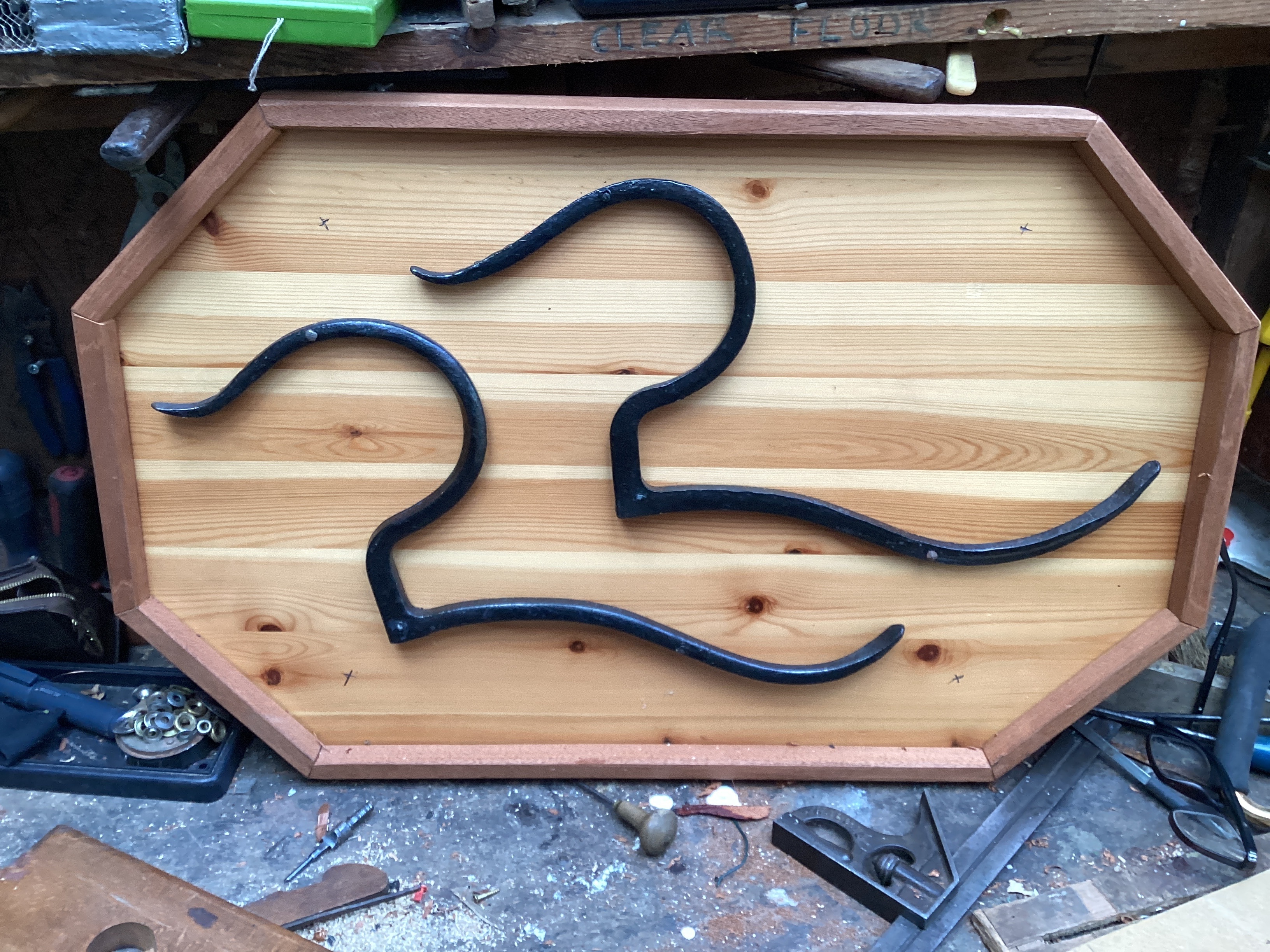

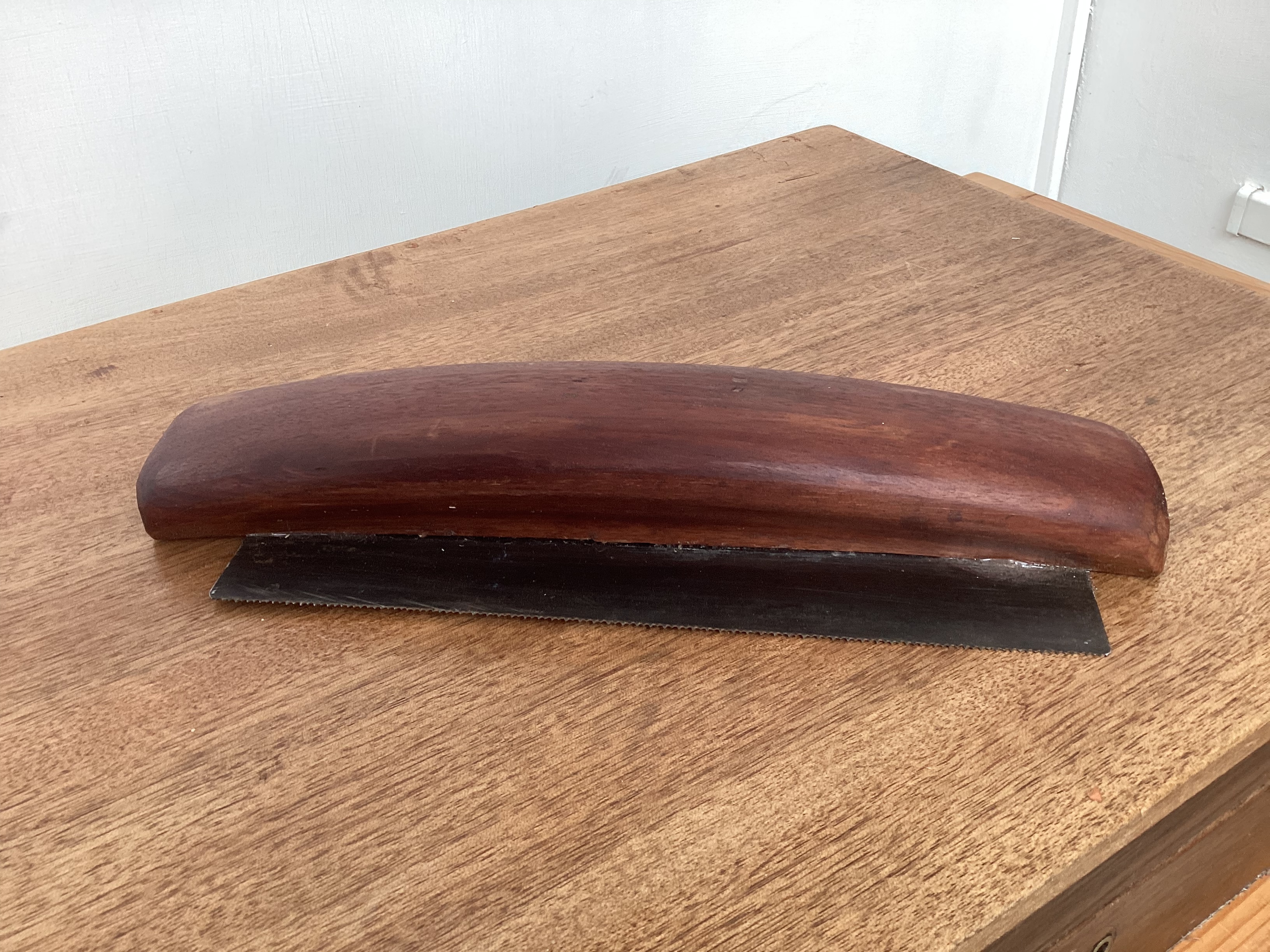

    Without having ever seen an armchair saw, let alone actually used one, having only seen a picture of one, apparently used by French cabinet makers, I thought it would be nice to have an example. Cutting the shoulders of tenons on chairs I have found well nigh impossible in the past. The opportunity arose when, only days after desiring one, but lacking the moulding, which in the image on Pinterest, was an ogee, I went into work and found an antique bed head broken in half (and it had been sold, too) with the veneer all splintered. It was given to me to make any use of it, or just to burn. Some has been cut into strips to make a new door sign.Armchair saw-image.jpg
    (The numbers - two ducks- were formed from the tines of an old garden fork)

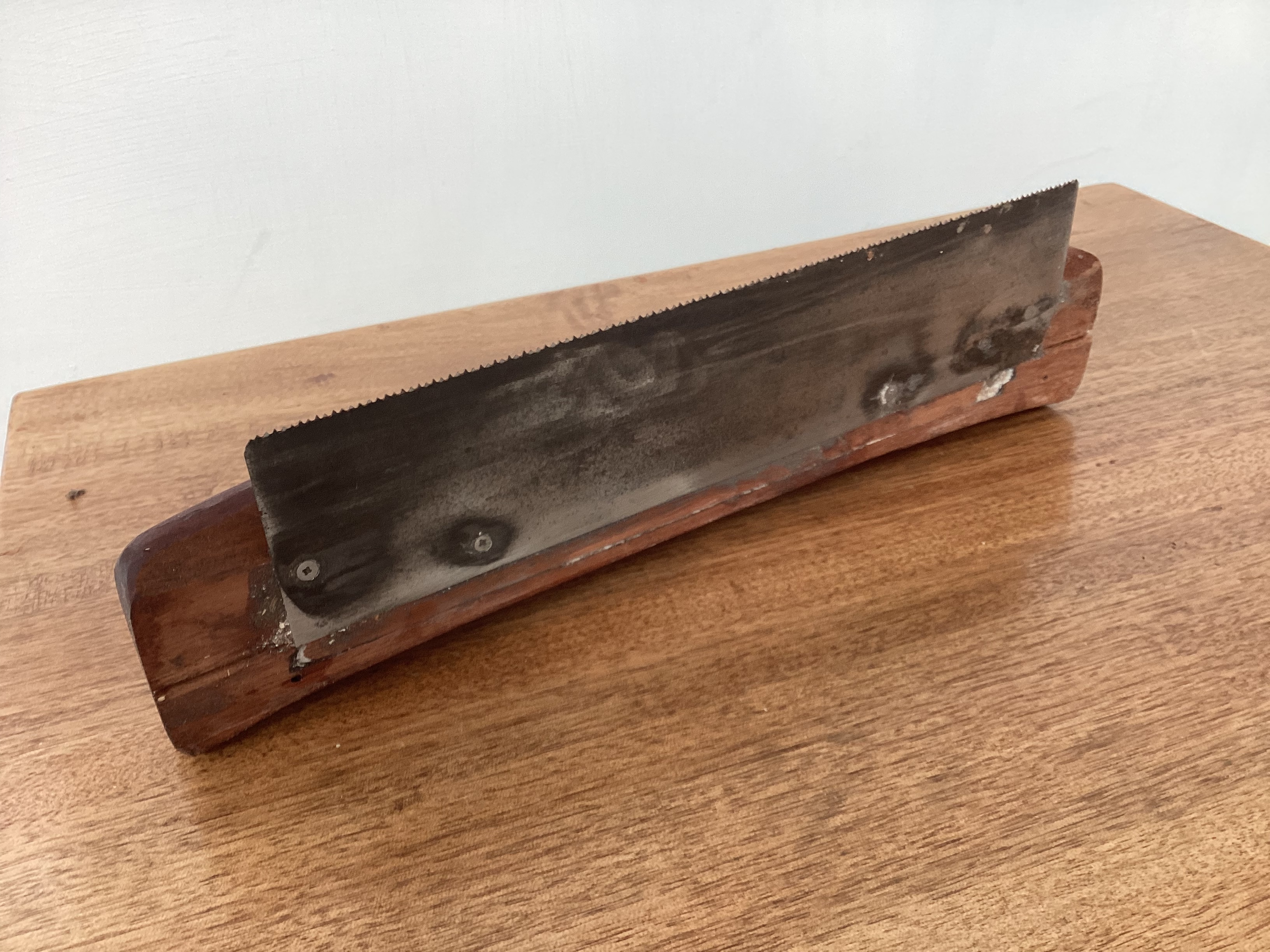

    The moulding at the top is the one used for the saw. The blade is salvaged from an old 10” tenon saw, which had a broken handle, but a brass back. I modified a masonry bit to drill 4 holes in the blade, after forming a shallow rebate for the blade. Having inserted the screws, the heads were sanded flush.

    Interesting idea, armrest saw. Do you use it in the pull motion ala "Japanese tenon saw" or push per Continental motion?
    I have a couple Japanese versions, they cut fantastic, but they are so dang long, especially paring down dowels.
    Phillip, your idea fixes all that.

    Marv, one is very much like that, including double edge, though not of superior Japanese manufacture.
    The drawback is still the protruding handle, and fingers of course. Phillip's creation averts that in close quarters.

    There's not much set on the teeth. The previous owner had not given any forward rake to the teeth, so although I am pushing, could as well pull! This design is just fortuitous, and could also be used by a left-hander. It’s actually on backwards, since the original rivet holes are at the far end! I have tried it, but it was made out of interest, and will probably never cut a tenon’s shoulder. I have been given a Japanese saw, it’s hanging up within reach, but I never think to use it. It seems to me that the user, when sharpening such a saw, must go along the blade 4 times with the file, or perhaps a second file, I don’t know.
