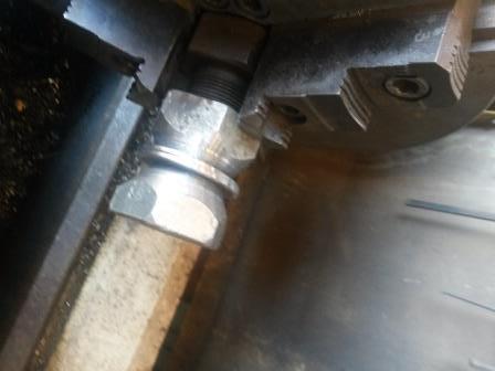

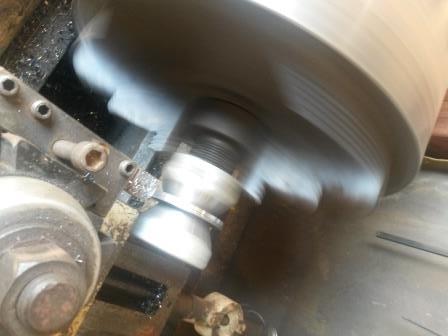

    I occasionally need to reduce the OD of shim washers. ordinarily If the inside Diameter is large enough I could simply chuck on the ID with a small 4 inch diameter 3 jaw chuck in the clutches of the 14 inch diameter chuck on my smaller Leblond lathe. However with so much of my stuff packed away for our move I couldn't lay my hands on the little used 4" chuck.
    I needed to turn the OD of a couple of .062" thick 1.625" ID shim washers.

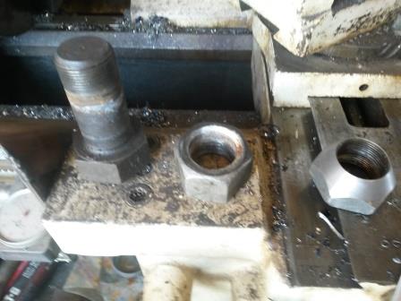

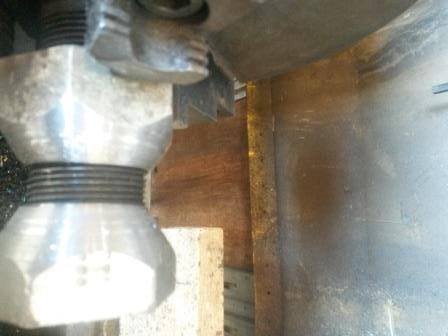

    I had a 1 1/2" bolt laying around with 2 nuts so I tapered one side of each nut then chucked the bolt with 1 of the nuts screwed on leaving enough so the washers and outer nut could be screwed in place. This worked just fine since I didn't need a perfect concentric ID to OD

    Thanks for the posting your method for reducing the washer OD. I have made several threaded mandrels for this type of work but these only fit a specific washer IDs. Using your design will allow the mandrels fit a much wide range of IDs just by adding the tapered nuts.

    Paul using a mandrel like this when only doing 1 washer at a time of any ID that can be confined on the taper you can use a piece of tubing against the face and the outer nut to hold it . As long as the tube has been machined true to both ends a decent concentric ID to OD can be expected
