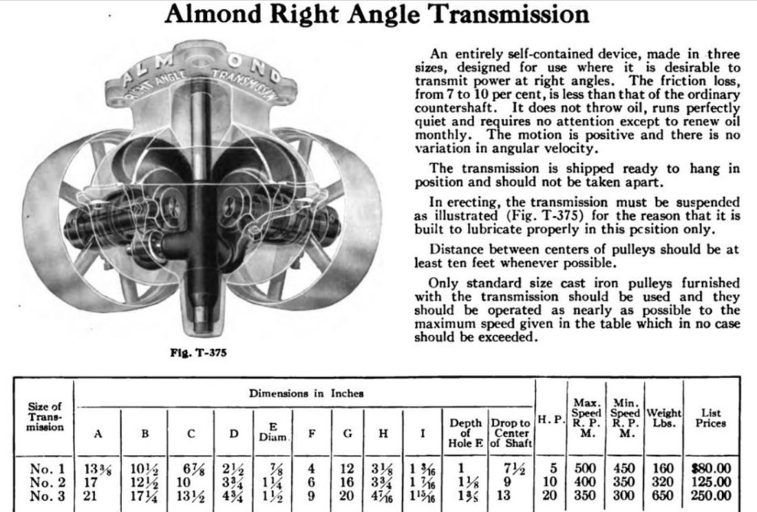

    That is actually an Almond gear-less right angle drive.

    Very cool. Is that sump supposed to be (more) full of oil? Looks like those ball joints are supposed to get an oil bath on every rotation.

    I learned from the video, we are looking at the device upside down, with the bottom cover off. The vertical shaft the mechanism slides on, is supposed to be supported on both ends. With the cover on, the shaft would be more fully supported and the whole mechanism would be running in oil.

    Ah yes. Good call. I should have watched the video to the end.

    If you click on the specs above, all will be revealed...

    I would be happier with outboard supports for the shafts to lessen sideload on the drive but the principle is brilliant!
