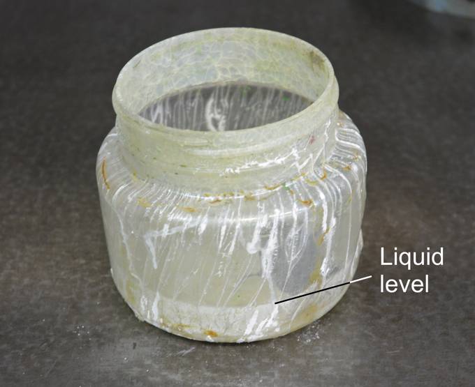

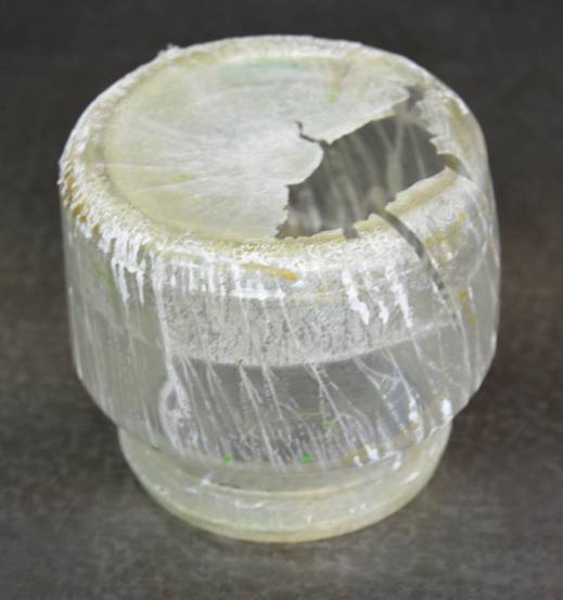

    I suspect that like me other machinists keep some caustic soda for things like removing stuck aluminium from carbide milling cutters etc. it really works well.
    I had some stored in a plastic jar that started life as a container for honey, jam, coffee or something in that line. A month or so back I wanted to use it, the first time in months. This is what I found.
    Another warning.-causticbottle02.jpg Another warning.-causticbottle01.jpg Click on thumbnails for full size images.
    We tend to think of plastic as capable of holding most liquids save for organic solvents, I did but I was wrong.
    Glass can be dangerous in a workshop but I keep my caustic soda in it now.

    Is this a good time to mention material science, The great thing about plastic recycling at home and 3D printing is that we can now identify different plastics.
    PET plastic Polyethylene terephthalate don't ask - is really crap for keeping acid or strong alkaline such as Caustic soda in (Sodium hydroxide https://en.wikipedia.org/wiki/Sodium_hydroxide). isn't sodium salt.
    Polypropylene is the baby for chemical jars where your average ABS and PLA 3D printer stuff are not so good. However you can smooth 3D prints by putting them in a container with superglue, the fumes decay the surface smoothing your part also superglue vapour is damn good for lifting latent fingerprints if you watch CSI.

    As a chemist, it is my duty to inform you that literally every aspect of your description of sodium hydroxide is incorrect.
    Sodium hydroxide, commonly known as lye, is an inorganic compound which is a white solid at room temperature. As a strong base it completely ionizes in water, so claiming that it is found in sea water is misleading at best; sodium ions are certainly present in large quantities (3.1-3.8% of seawater by mass), but the concentration of hydroxide ions is orders of magnitude lower, and evaporating seawater would only give trace quantities of sodium hydroxide.
    For anyone interested, high-density polyethylene (HDPE) is the recommended storage medium for strong alkali, both in solid and liquid form. Concentrated alkali solutions will slowly etch glass, and over significant periods of time (years) can cause the failure of glass bottles.

    Thick HDPE and polypropylene (PP) are the best plastics for storing NaOH, whereas it will attack polyethylene terephthalate (PET/PETE), polystyrene (PS), and polycarbonate (PC) fairly quickly. Another thing to note is solutions should be kept in an airtight bottle -- not due to any fumes (of which there are essentially none over a pure NaOH solution, as it isn't volatile), but to prevent the solution from absorbing carbon dioxide from the air. CO2 reacts with the NaOH to give Na2CO3 (washing soda), which is what all of that white crust/powder is on the dead plastic jar. Washing soda is a weak base and is still somewhat corrosive to aluminum, but the strength of your NaOH solution will degrade over time if you leave the bottle open to the atmosphere.
