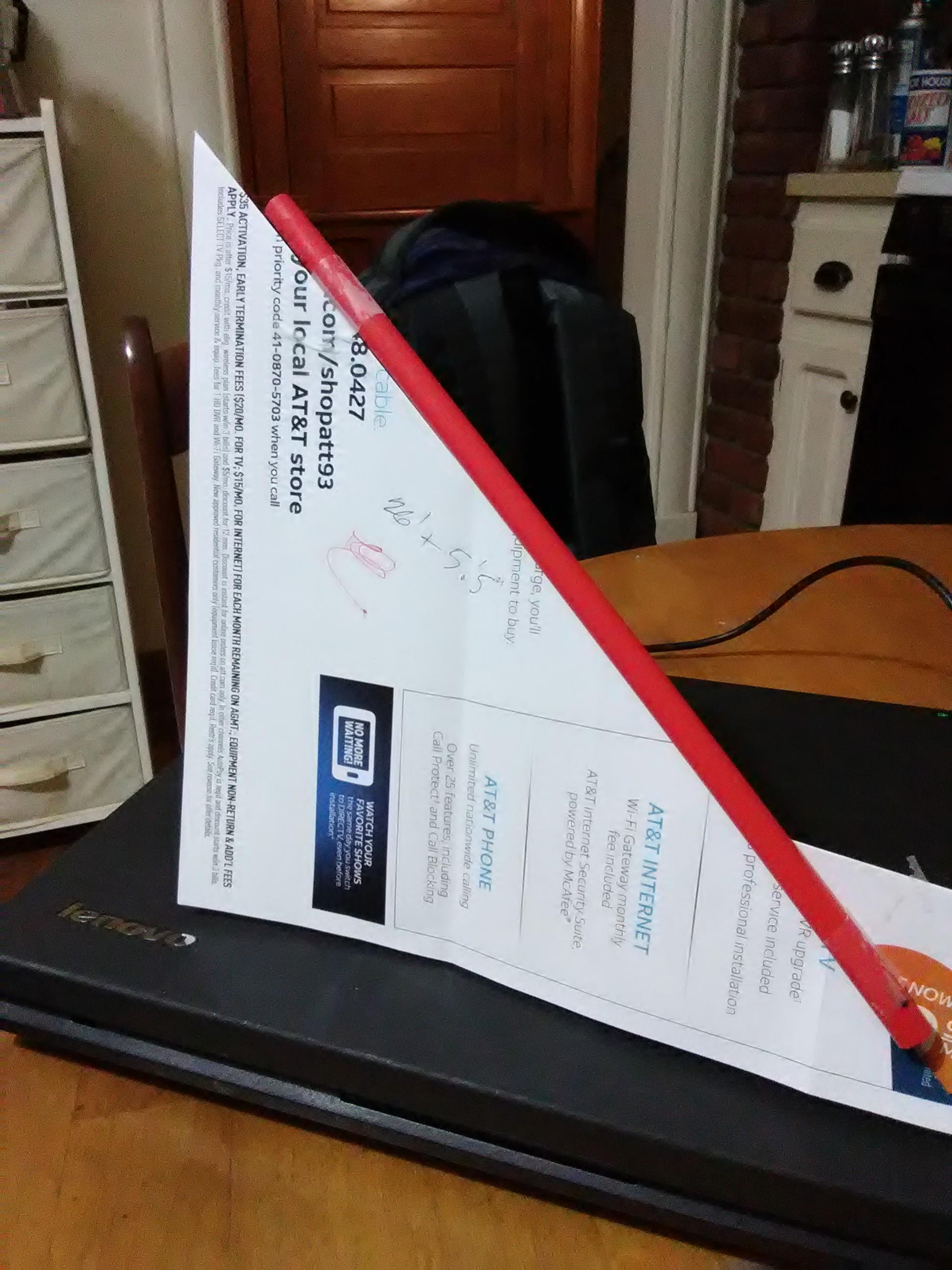

    My driveway has a mercury-halogen flood light attached to freestanding garage. While they might work best high above area to be illuminated, whoever installed mine, [pre 2005 on property built 1902...] got a leetle-beet carried away. We call that a lottle; like a little, but a lot, lol.
    Bulb has burned out after a few years constantly on, seems a timer or light sensitive switch is in order, but I digress. Trying to gauge height by tape measure's a joke, best tapes only stand out 11'. From second story [9'5" ceilings plus grade] window ledge, still had to crane my neck to see the lamp fixture. Yikes this isn't a driveway light, it needs an aircraft warning light of its own; a lighthouse 1200 miles from nearest coastline, maybe signal to extra-terrestrials? ET didn't need a phone, a convenient beacon is in my side yard!
    I know of, or personally, almost everyone who's lived in this house since being built, one must be a clone hiding his purpose here....
    Anyway, my efforts after dark were a failure too, wall texture and angle wouldn't disclose mark from my laser level.
    Next day, disposing junk mail I hit upon this solution. By folding over top edge of paper to adjacent side, an accurate square results. Folding two opposing corners creates an accurate 45°. Next, tape plastic drinking straw to the 45° edge.
    Another use for thee bane of civilized world, junk mail.-height.jpg as usual, click the pic for a less microscopic illustration.
    Step forward or back, until intended object appears through the straw, while holding corresponding paper edge parallel [or perpendicular if you prefer] to the ground.
    Mark the spot on the ground at your toes. Step back additionally the height of your eye from ground level. That new point is intersection of 45° from whatever object viewed to figuratively horizontal plane. Measure distance from that second mark to a spot as close to directly under [plumb] the object sighted in the straw.
    My light turns out to be about 31 feet up, in 1" rigid conduit!
    That bit of geometry will help ordering a scaffold and suction cup tipped bulb wand. I have 15' feet of scaffold, 4 jackscrews, and a 12' wand, have to trust ability to reach up and maneuver a $25.00 bulb.....hmmmm
    Or be an OSHA poster boy with step ladder on the uppermost scaffold planks?

    Forget that I don't like heights scaffolding or not lol. I think I would rather fit a new light and it would work out to be a lot cheaper option. Leave the old light as a mark of respect to the guy who fitted it in the first place Good luck on the repair.

    Brilliant TM51 and hilarious as usual! Great use of math, old school Enginerding as well as recycling. My son and I used to fly (shoot) rockets and had a floating angle gauge like yours but we were hitting 2-3k feet then. As long as they went straight up (questionable sometimes) a known distance from the launch pad it gave a clue to heights.
    Personally I think I might cut it down and put a hinge on it with a pulley system or some such...And change to some type of high powered moon beam'er LED.
