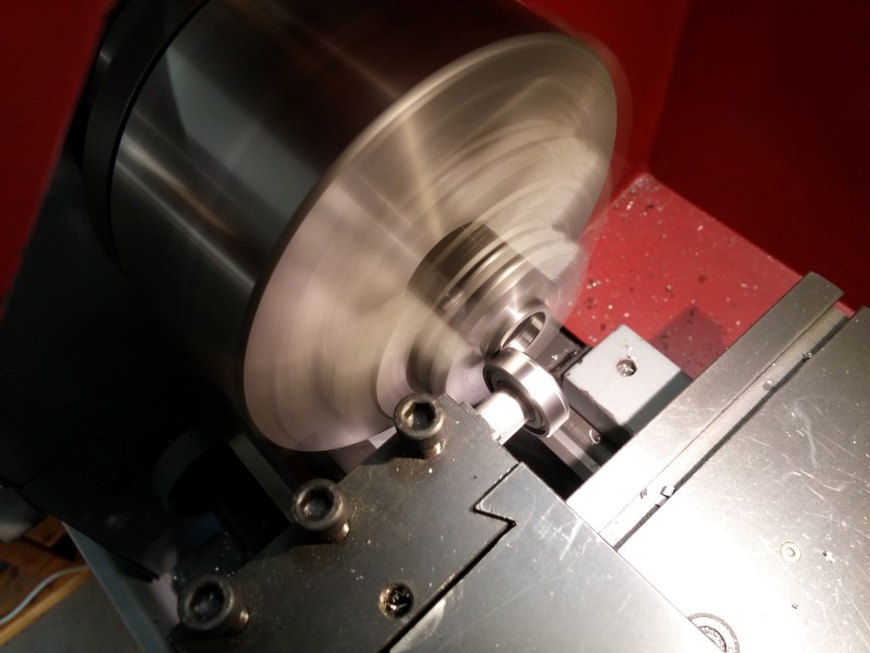

    Hi,
    this week end , I was turning a new Titanium ring and, in the middle of the work, just after separating the ring from the stock, I had to rechuck my ring in order to dress the cut face.
    And suddenly, the light came, I remembered the recent post from Canobi : lathe "work truing" tool and realized that it was exactly what I needed right now.

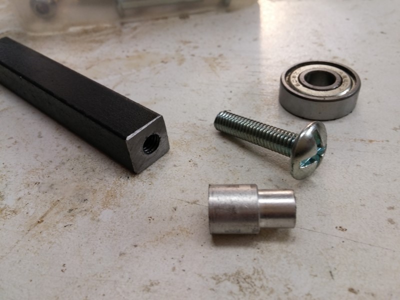

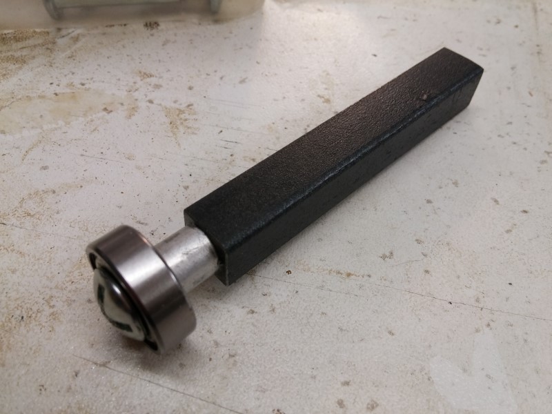

    So I quickly made my simple version of it out of what I happened to have in the scrap box :
    A roller-blade ball bearing, a spacer also from the same roller blade, a screw, a piece of square section stock.
    OK, the hole is not well centered, but who cares ?
    Here we go !
    Of course, I tightened the chuck after truing the workpiece.
    Thanks Mr Canobi , useful tool, I should have done that earlier (as always)

    I must also make this wonderful tool. Truing would be much easier and faster than use of dial indicator and rubber hammer.

    there truing tools are the kind of things you don't think about needing until you see one many times I have trued parts in my lathe by simply keeping a piece of brass clamped in a QC holder never thought about the simplistic design of using a bearing LOL, the sacrificial brass has worked for years but now I think I'll make one just because

    It's yet another way to skin a cat and a good one too. Would be faster than looking for a spacer to put behind the work piece in the chuck unless that particular spacer can come out of hiding and mount itself in the chuck and then not forget to remove itself before the chuck starts spinning....
