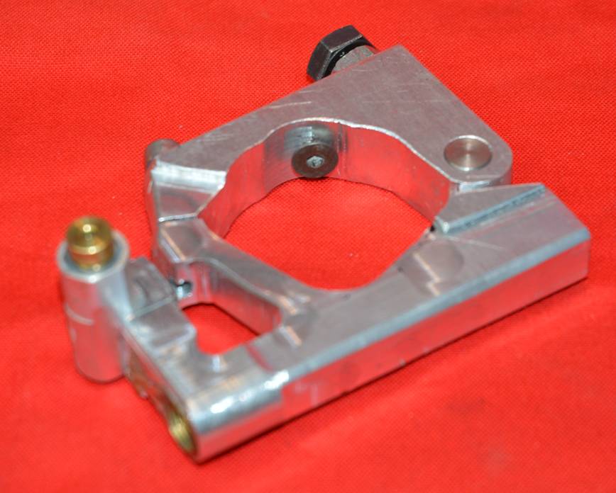

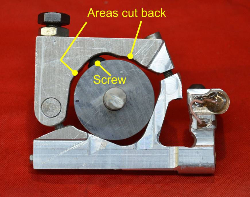

    Well I am a bit disappointed that nobody spotted my "deliberate" mistake with the clamp. As displayed in my original post and as I first made it, there were 4 points of contact, but of course that never works correctly. Only 3 points will be gripping properly, the fourth will be either not even be touching or gripping with minimal force. I am usually very conscious of these things and I don't understand how I made that mistake. It just isn't like me. In practice it worked fine but the purist in me wouldn't let it drop until I fixed it
    Late update to show how I fixed the four point mounting.
    Attachment 29326 Click image for full size.
    I cut back two of the original four contact points and added a flat head screw for a third point. I am much happier with it since I did that.
    Attachment 29327

    Sorry tony, but i can't open your links, with Safari or Firefox, the link is : http://www.homemadetools.net/forum/a...chmentid=29326

    Quote Originally Posted by Okapi View Post
    Strange. When I viewed the post after writing it the pix showed fine. Now they say invalid link. I will try adding them to this post
    Please let me know what happens now.

    The direct links you put are good and on your post it's ok now, I don't know what happened before, for the pictures on the net the using my own website as hostage make me that sometimes too and need to reload the pictures, then ???
