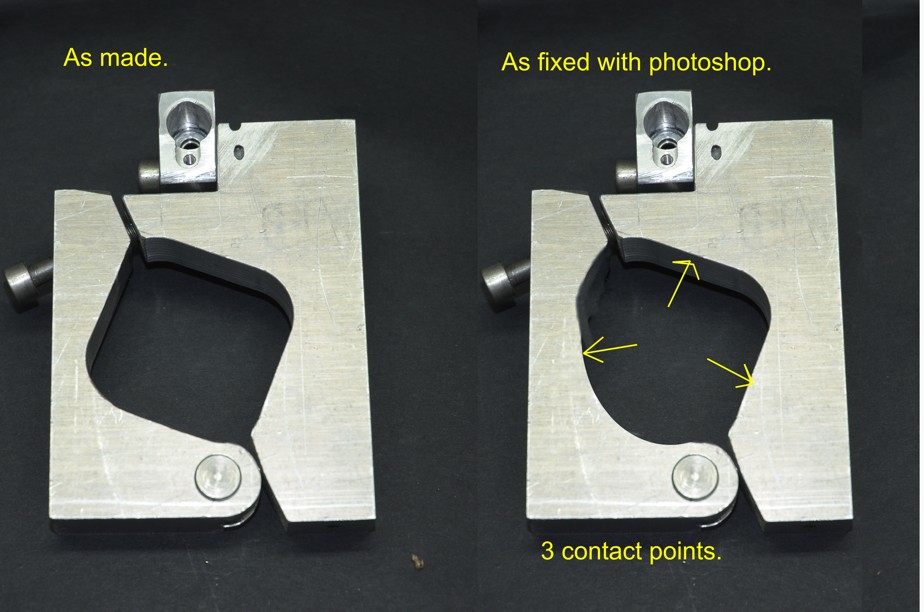

    Mistake fixed
    Quote Originally Posted by Gog32 View Post
    Tony,
    Your ingenious clamping arrangement is an improvement over the original.
    Well I am a bit disappointed that nobody spotted my "deliberate" mistake with the clamp. As displayed in my original post and as I first made it, there were 4 points of contact, but of course that never works correctly. Only 3 points will be gripping properly, the fourth will be either not even be touching or gripping with minimal force. I am usually very conscious of these things and I don't understand how I made that mistake. It just isn't like me. In practice it worked fine but the purist in me wouldn't let it drop until I fixed it
    Here are a couple of comparison pix. This was courtesy of Photoshop but I plan to use JB weld to achieve the same thing.

    Well I am a bit disappointed that nobody spotted my "deliberate" mistake with the clamp. As displayed in my original post and as I first made it, there were 4 points of contact, but of course that never works correctly. Only 3 points will be gripping properly, the fourth will be either not even touching or gripping with minimal force. I am usually very conscious of these things and I don't understand how I made that mistake. It just isn't like me. In practice it worked fine but the purist in me wouldn't let it drop until I fixed it
    Here are a couple of comparison pix. This was courtesy of Photoshop but I used JB weld to achieve the same thing.

    Actually Tony I did wonder about the 4 point contact on the original post but did not want criticize. I also thought about the fix and I would have probably put a through bolt to give the third contact. Never mind you fixed it, like I said before posting mistakes and fixes can be useful to others.
    To criticise when justified is fine by me. I did think about using a bolt as you mention but the JB weld seemed like a nicer solution. Either would work, I did also think of welding but I knew that would pull the ends in.
