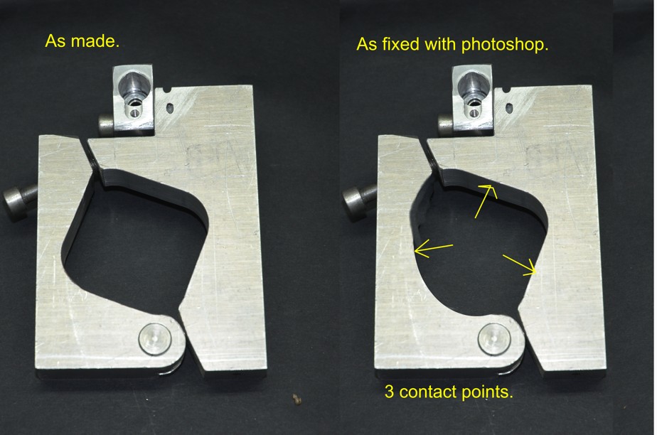

    All due credit must go to Dan Gelbart for the base idea. I just took that and added my own take on it.
    I am sure that it took me much longer to make than yours which is so elegant in its simplicity.
    In case anyone wants to make one like mine I'll admit to a design mistake. I made the internal clamp shape, 4 sided. Of course it will only clamp up tight on three points and so it is not as firmly located as it would be with a 3 sided clamp with the contact points more evenly spaced. I am surprised that I made that mistake because normally I look for the self aligning way of doing things and more often than not I use 3 supports. Isn't hindsight wonderful?
  5. #14
    Nov 2016
    Spain
    1,632
    739
    Thanked 2,745 Times in 735 Posts
    tonyfoale's Tools
    In case anyone wants to make one like mine I'll admit to a design mistake. I made the internal clamp shape, 4 sided. Of course it will only clamp up tight on three points and so it is not as firmly located as it would be with a 3 sided clamp with the contact points more evenly spaced..... Isn't hindsight wonderful?
    Isn't Photoshop great, you can fix your mistakes in a few seconds.
    A bit of milling and some JB weld (or real weld) should fix it with minimal work.

    I was thinking you may do something like this to fix it, I think its great to see mistakes as they can be as valuable as successes.
    By the way since your post on shear tools I have started using them again and have achieved a new level of finish and accuracy especially combined with the tangential top slide use.
    Olderdan
    Alan,
    Mistakes are a darn nuisance but they happen and may help learning. In this case it is not really much hassle in practice, because it was made to fit the spindle nose, it is more a case that I know it is not optimal. I have lived with it for the couple of years since I made it but this discussion may prompt me to fix it.
