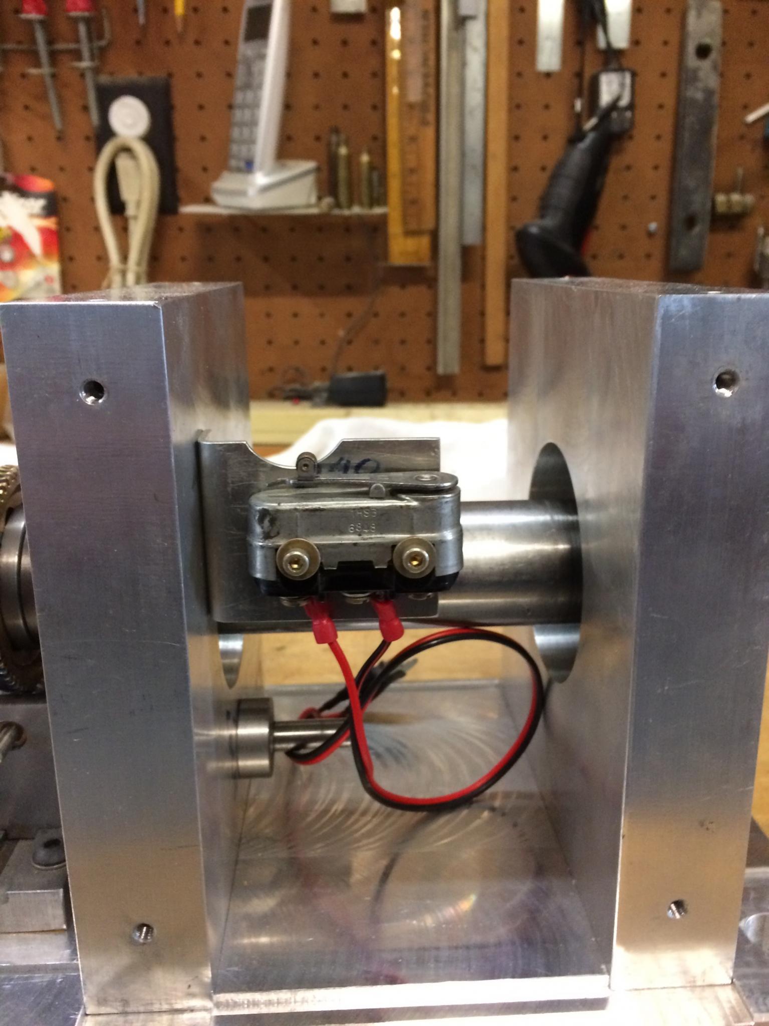

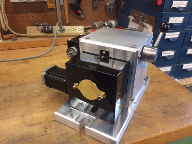

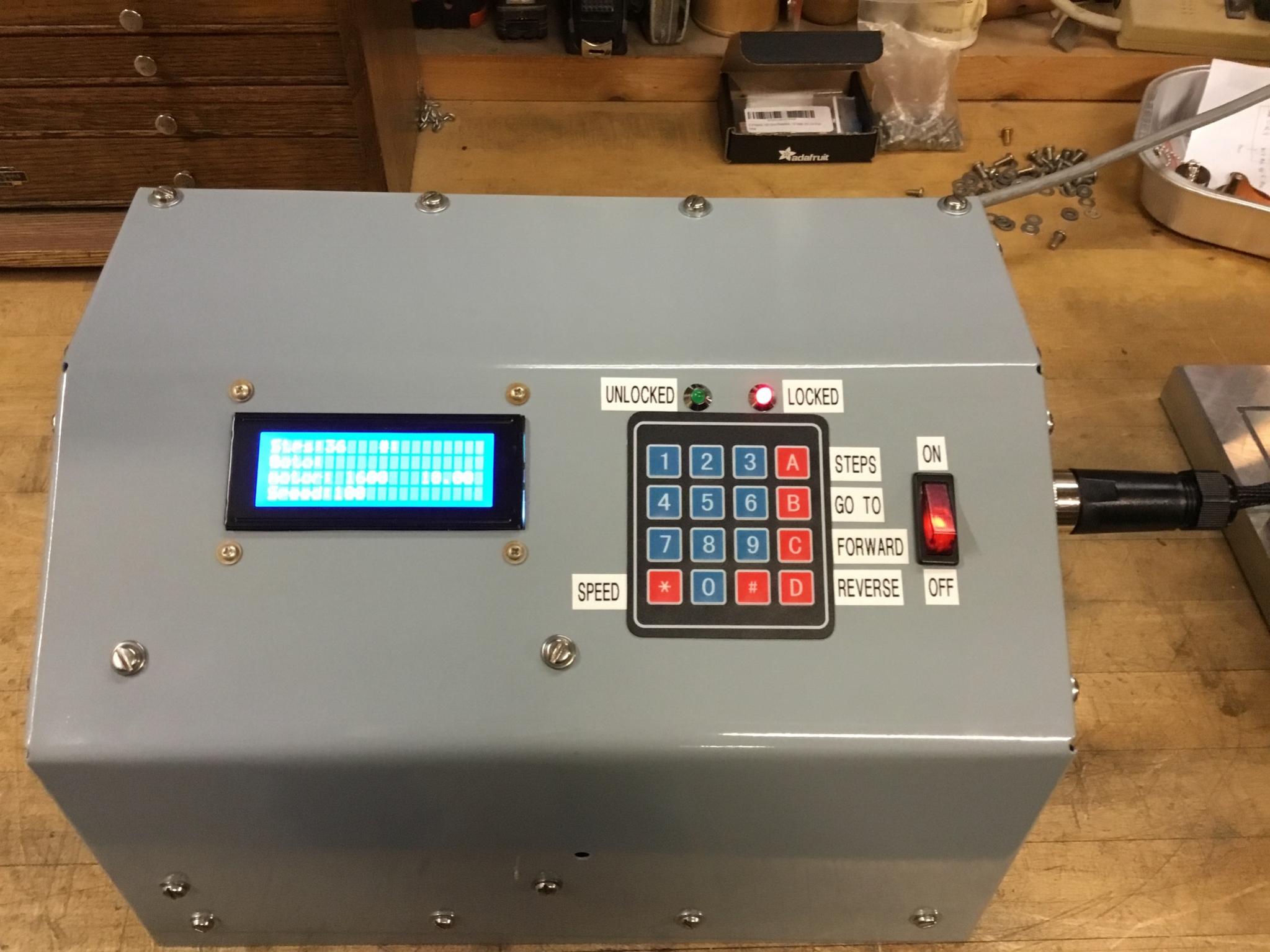

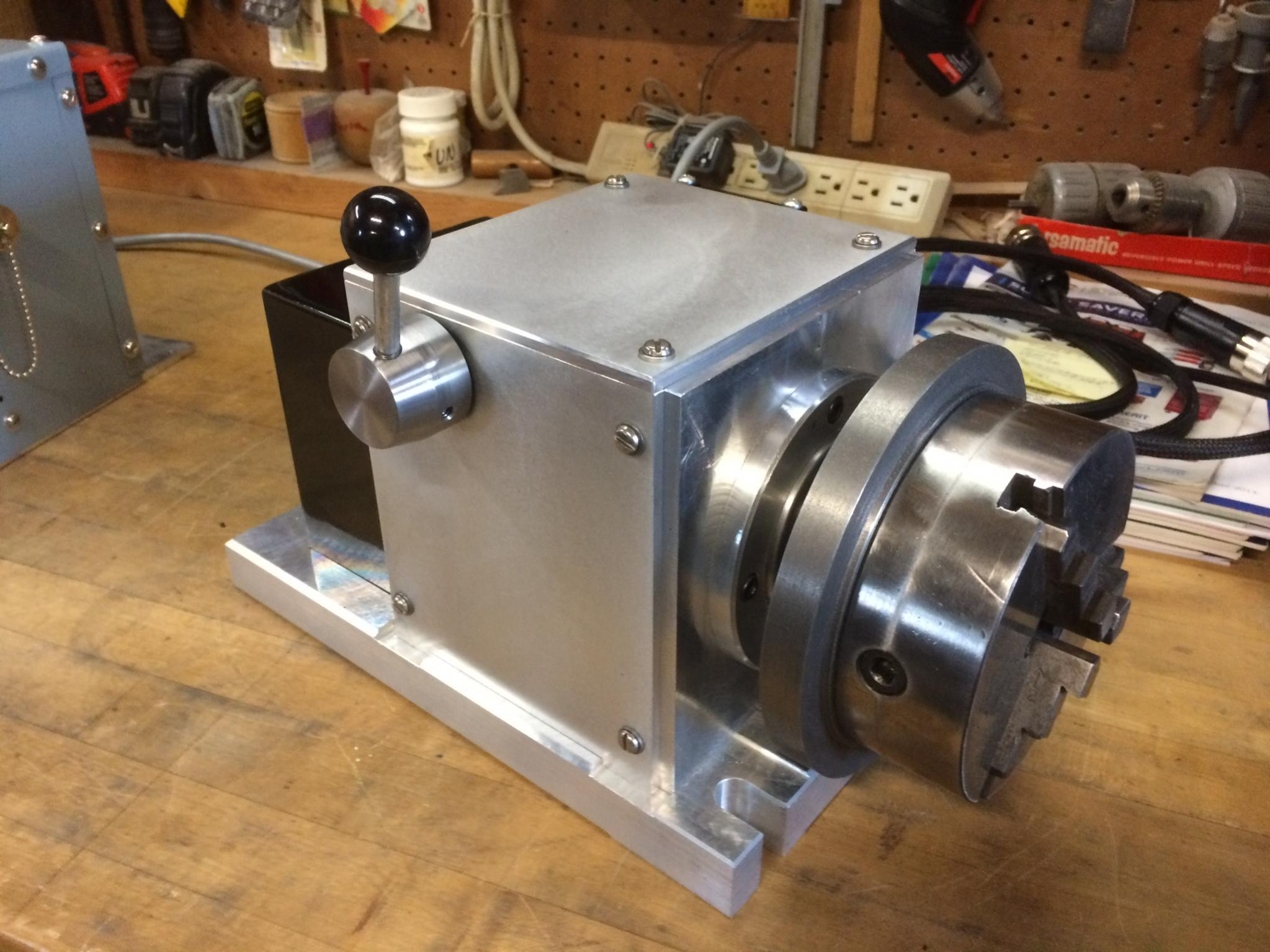

    So I needed a dividing head and at my advanced age I have trouble concentrating. I knew I would lose count or forget where I was entirely and thats why this was born.
    It is powered by an Arduino,driver, stepper motor and a 60:1 worm.
    My son is a talented programer and a God send for this project as I don't know hot from neutral. There is an interlock switch which tells the program and LEDS that the spindle is locked so I can't advance even if I don't pay attention to the lights. I bypassed the dip swiches in the driver so the program can choose an appropriate fraction of steps for what I have chosen. I can also go forward, backward,go to an inputted step and choose a speed. Hopefully soon a feature to select angles as an option to steps will be added.
    The head uses an Atlas spindle mounted in an AL. structure with tapered roller bearings. I rebuilt the chuck ( company went out of business in 1948) and reground the jaws to insure concentricity. I do not have sophisticated measuring equipment so checking accuracy is iffy at best, but an initial go shows it to be quite accurate, certainly within .001/.002.
    I am not a photographer or the son of one so please don't think badly of me for the pic quality.
    Dick

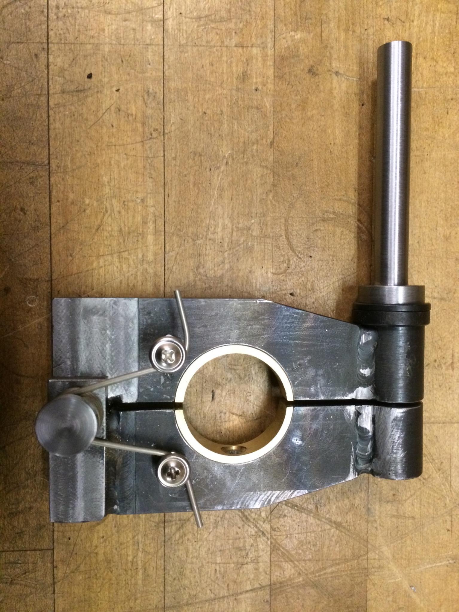

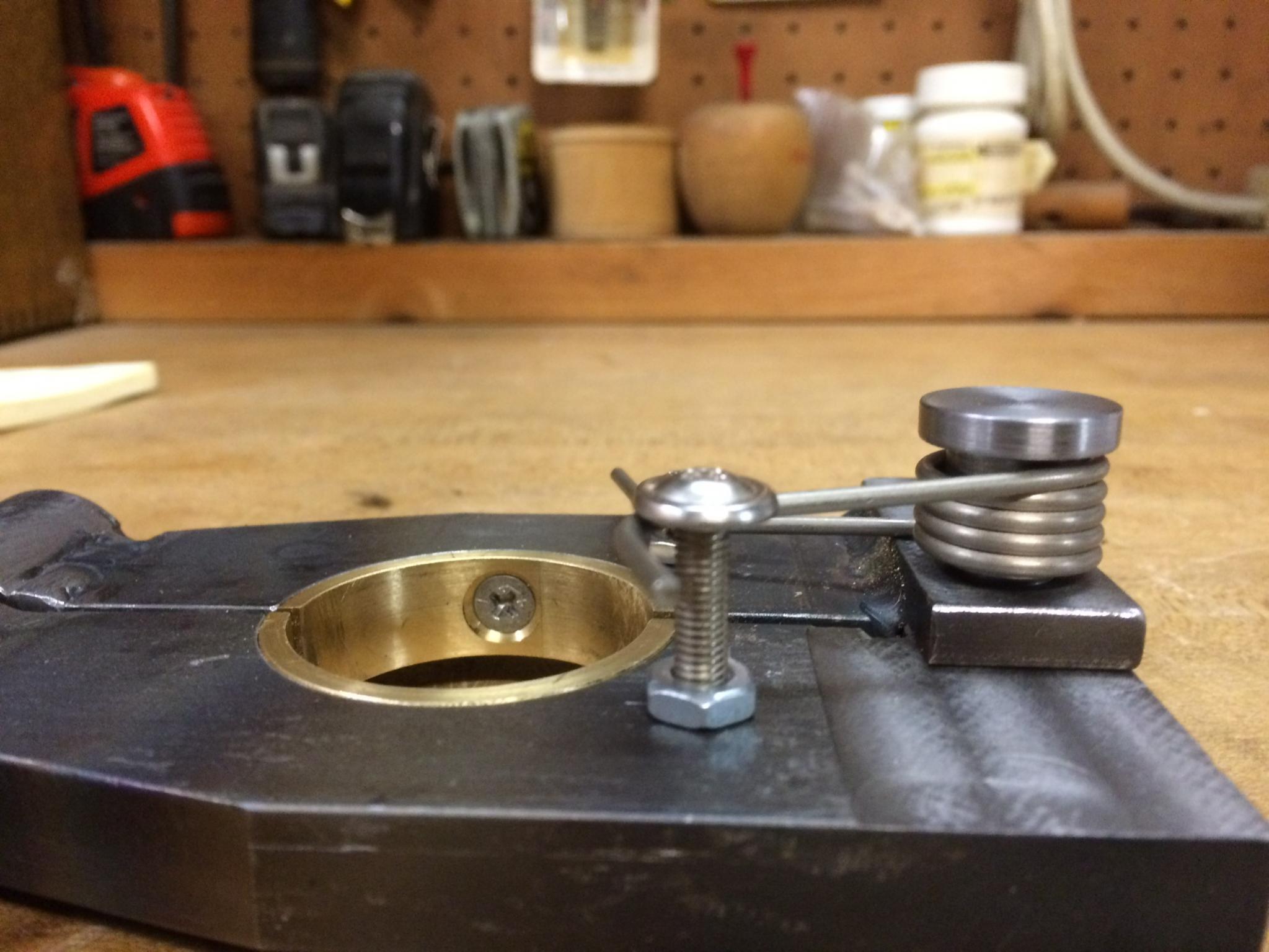

    Very nice sir! Can you describe the locking mechanism?

    Another digital dividing head-lock-1.jpgAnother digital dividing head-lock-2.jpg

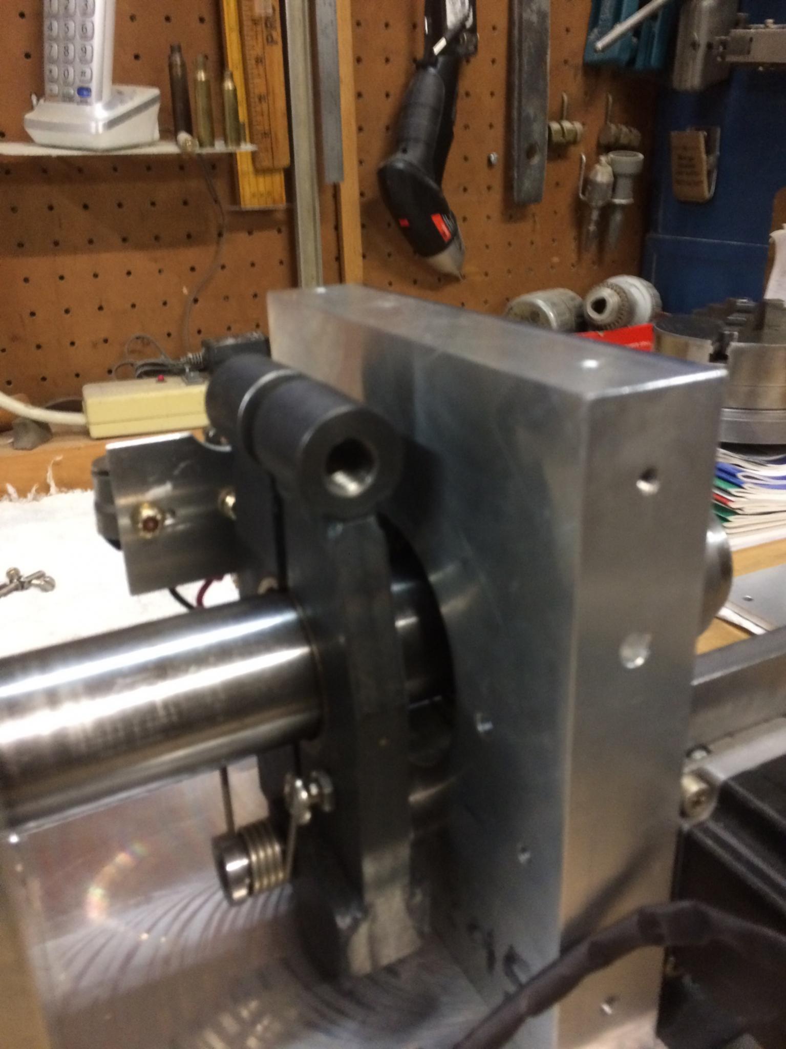

    Hope this helps. The lock is basically a clamp pivoting below the spindle using a 1/2-13 shaft as a clamp and brass inserts to clamp. There is also an eccentric collar on the shaft retained with a set screw to activate the switch that is not in the pics.
    dick

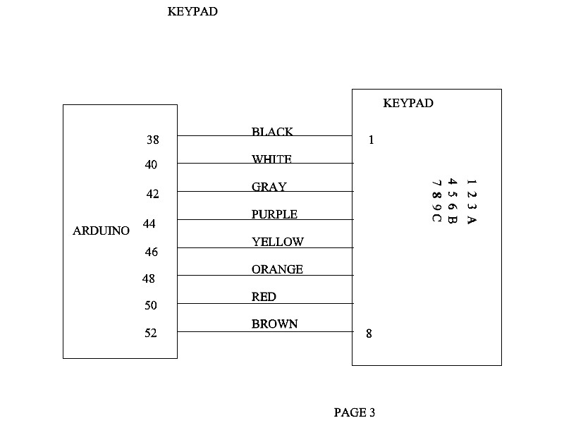

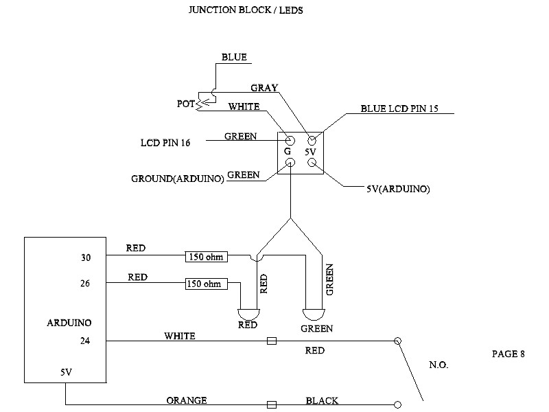

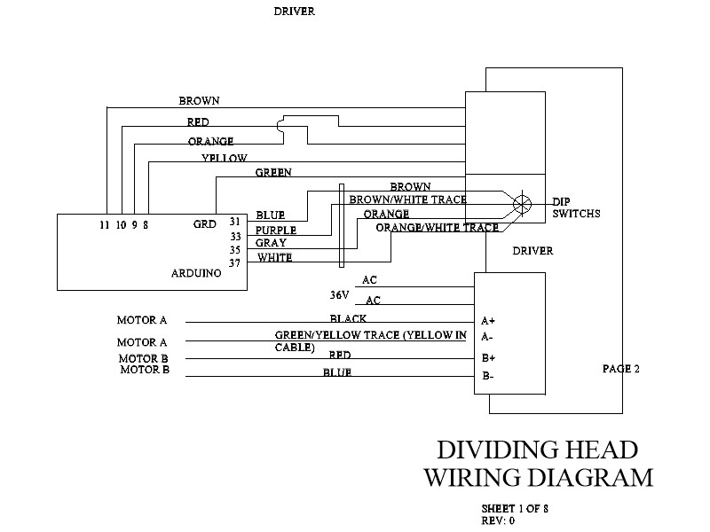

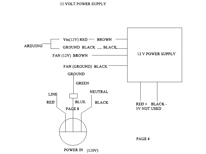

    Eaglewood's Tools

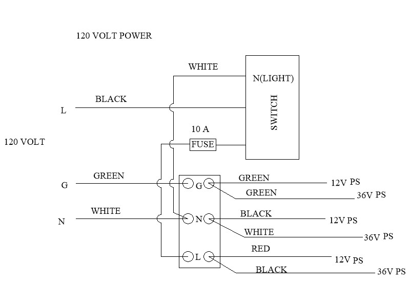

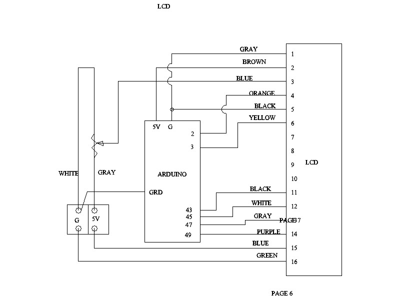

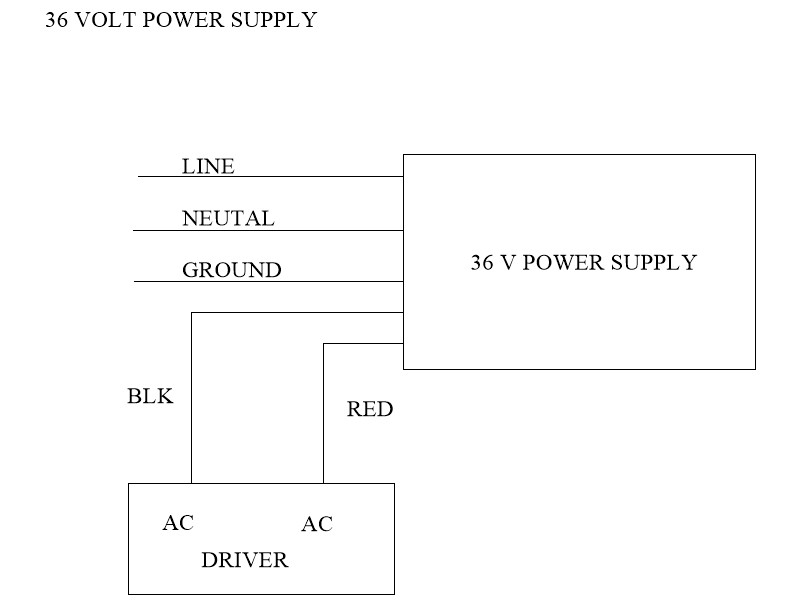

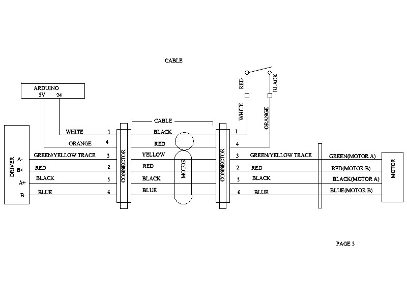

    Another digital dividing head-dividing-head-schematic.jpgAnother digital dividing head-dividing-head-schematic-2.jpgAnother digital dividing head-dividing-head-schematic-3.jpgAnother digital dividing head-dividing-head-schematic-4.jpgAnother digital dividing head-dividing-head-schematic-5.jpgAnother digital dividing head-dividing-head-schematic-6.jpgAnother digital dividing head-dividing-head-schematic-7.jpgAnother digital dividing head-dividing-head-schematic-8.jpg
    The 8 page wiring diagram.
