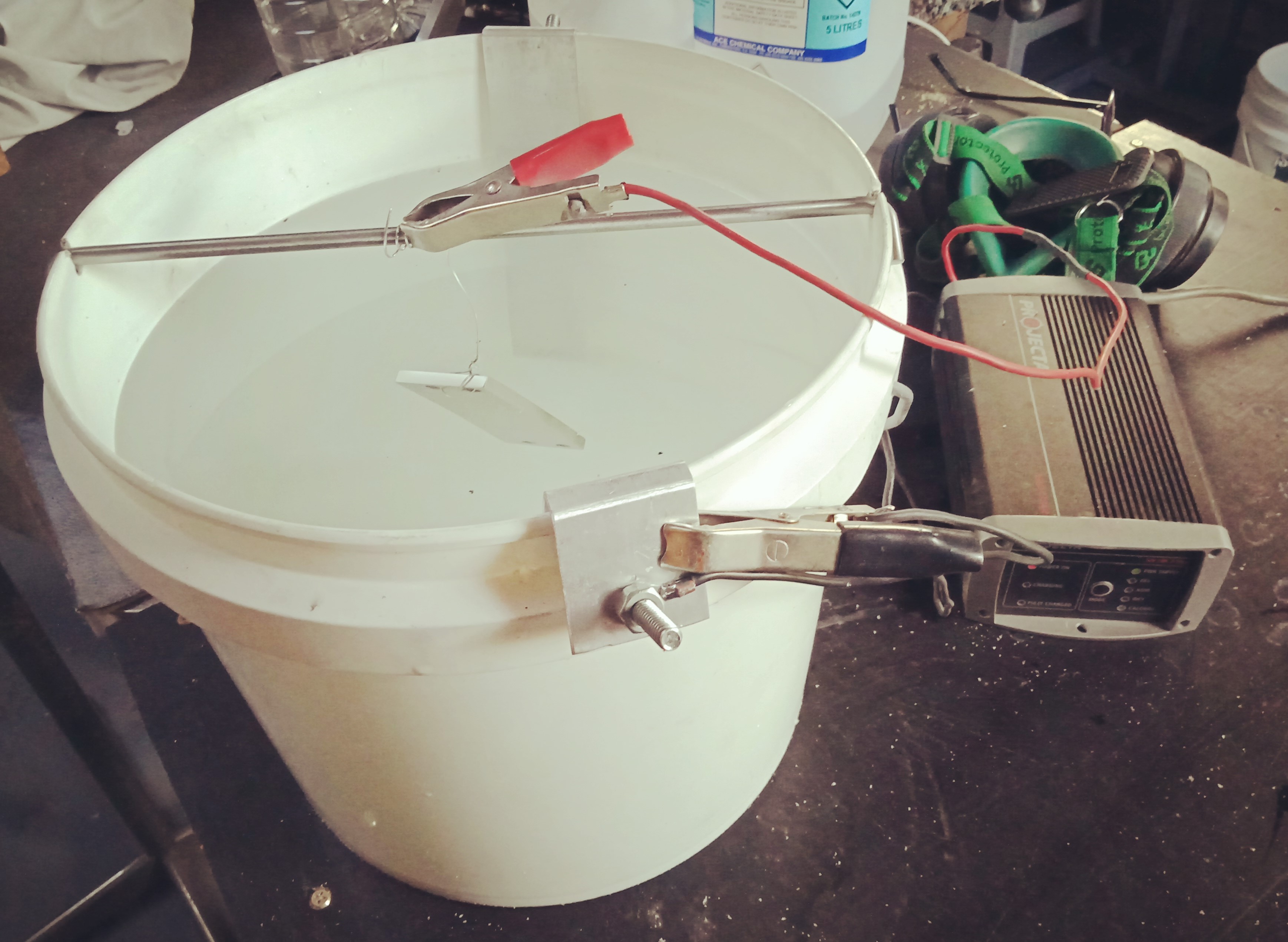

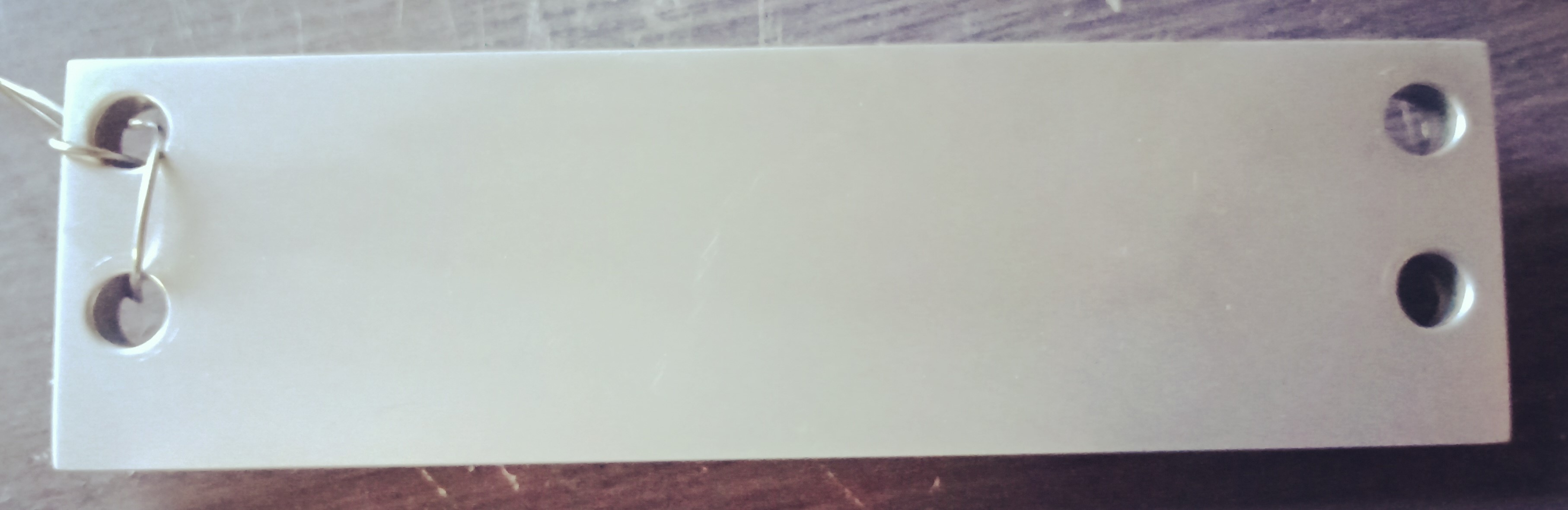

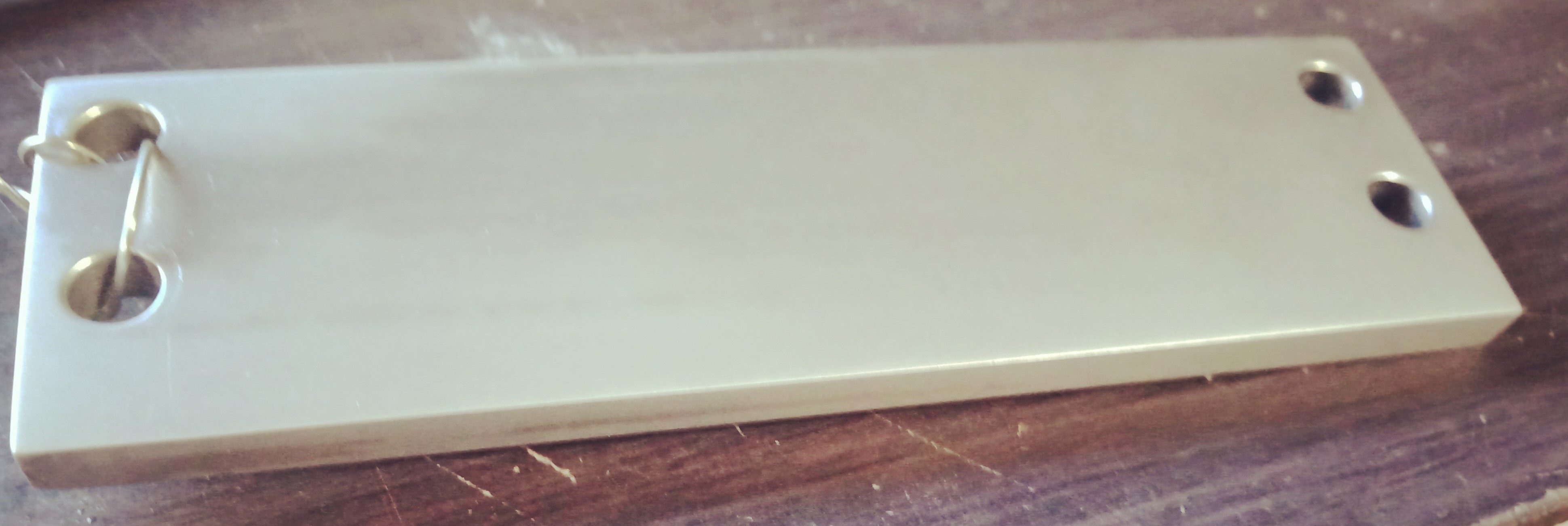

    A bit of anodising done today. One side was mirror polished, the other garnet blasted. I skipped the etching process to see if I could retain the shine, or at least some shine, no go. Nevertheless, it does provide a good finish for parts made of aluminium that don't need to be polished. My anodising setup is pretty basic: 10 litre plastic tub. Diluted sulfuric acid. Aluminium cathodes, aluminium wire and 10 amp battery charger. Before doing anymore I'll upgrade to lead cathodes, an ammeter and some titanium wire. I can also try a thinner anodise coating, if nothing else, it will give a lighter grey colour.
    For the shiny parts, I investigated bright dipping, but the process is far to toxic and dangerous for me, and there are very few places that do it commercially, due to that.. So ,I'll give electro polishing a go instead. Not sure if oxidising is a problem after this procedure, information is a little sketchy in this area.

    A few questions, if you don't mind. I have read to use lye to clean the parts but when I tried the aluminum turned black. Is that because of the alloy?
    I did get a quart of desmut solution a while back but have not had a chance to use it yet.
    Did you have any trouble with the battery charger shutting down, because it wasn't charging a battery?

    I've never heard of using lye. Using a caustic solution is not necessary, just make sure you clean the aluminium in acetone and soap and water several times before dunking in the anodising bath. The cleaning is the most important process. Do not touch with bare hands! My battery charger has a power supply mode so switching off and on isn't a problem. You can modify a battery charger to stop it switching, I did that years ago with a small one I wanted to use as a transformer, google it.
