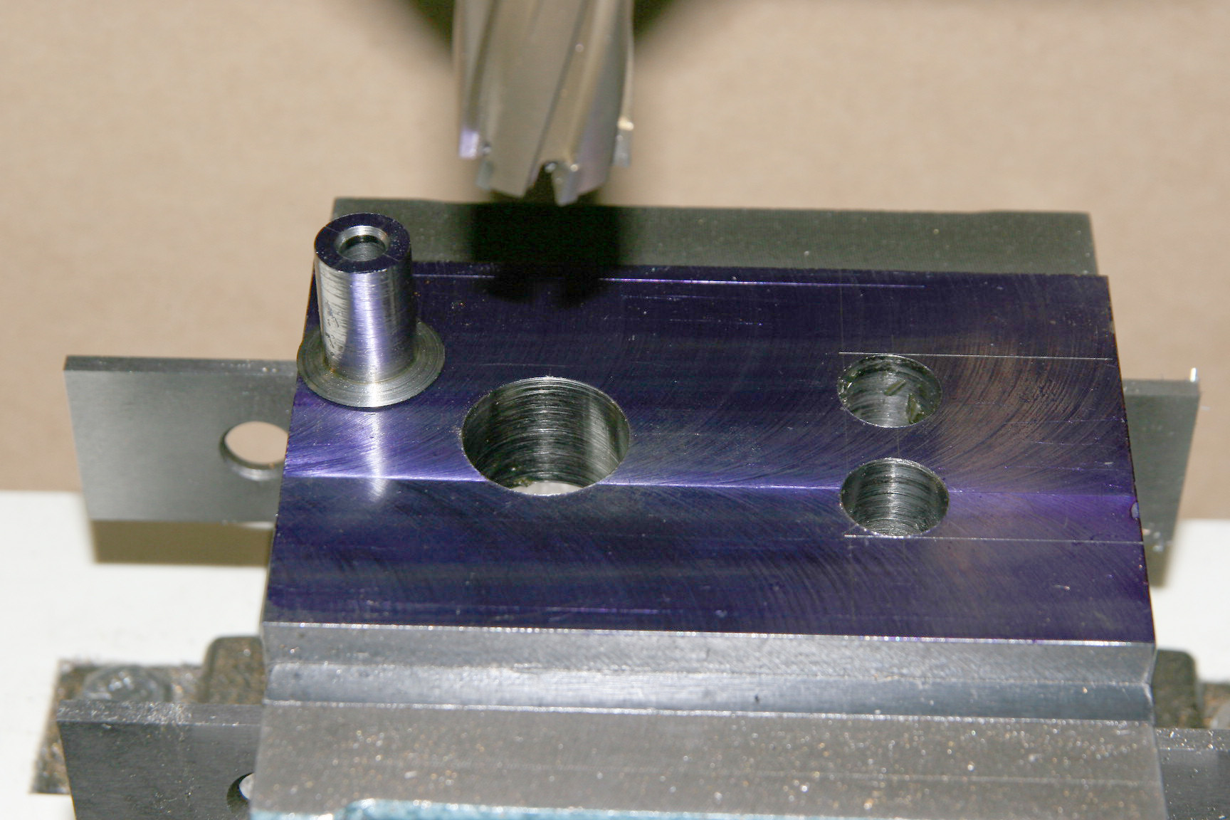

    I bought this 20mm by 50mm long carbide tipped annular cutter for cutting brass round from flat.
    The cutter was a steel on ebay for about 12 bucks. Nice thing about the annular cutter is the
    reduced power required to drill a hole and the nice chunk of material you get instead of just chips.

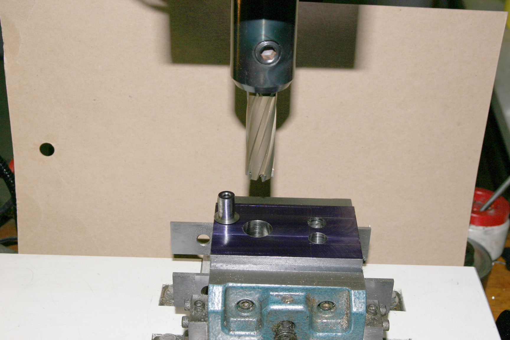

    Worked great just by holding it in a 3/4" r8 collet for brass. But I knew better than to try that with steel and
    it should be locked into the holder for cutting any material.

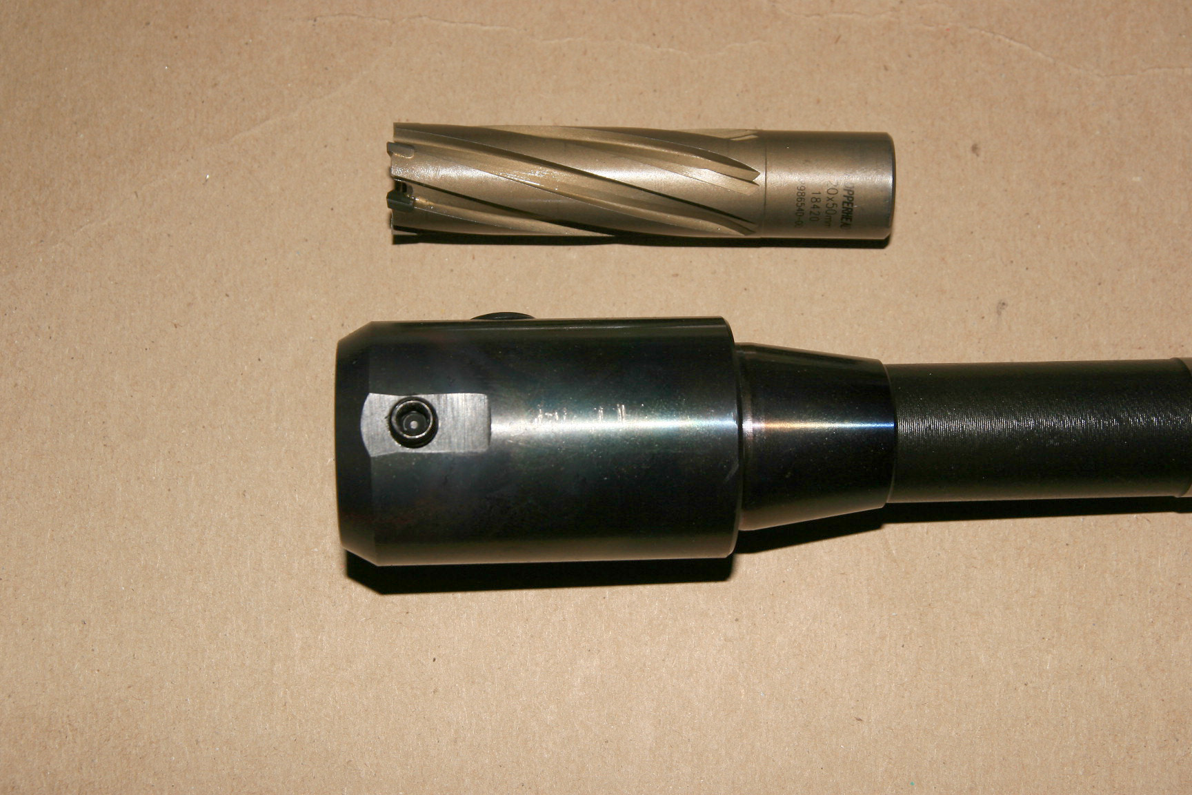

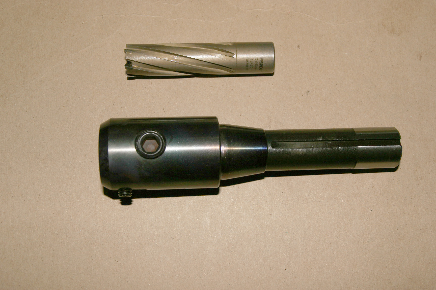

    Not willing to order up an arbor for the cutter I tried the fit into my r8 3/4" end mill holder.
    It fit like a glove but the flats would not enter far enough to engage with the set screw.
    Ok, the annular cutter has two flats at 90 degrees (not shown in the picture). It also has a ridge
    that prevents it from slipping upward into the holder. The set screw in the end mill holder would
    not engage the flats on the annular cutter.
    That left only one thing to do. I heated it as hot as I could get it (just short of cherry red) in the
    area where I wanted to drill a hole for my new "annular cutter set screw". The flat was ground on the
    outside of the holder first. Just did that by hand on the bench grinder.
    After it cooled, I checked and it was soft enough to drill with a HSS drill bit.
    So you can see the results. A two purpose R8 arbor. Saved some money and
    got my new arbor in a couple of hours instead of 5 days for shipping.

    Attached Thumbnails Attached Thumbnails Annular Cutter Arbor From R8 3/4" End Mill Holder-img_2091.jpg   Annular Cutter Arbor From R8 3/4" End Mill Holder-img_2092.jpg   Annular Cutter Arbor From R8 3/4" End Mill Holder-img_2093.jpg   Annular Cutter Arbor From R8 3/4" End Mill Holder-img_2094.jpg

    I’ve also done this in my small machine shop. I inherited about 50 annular cutters from my late father who was an ironworker. Did you try to drill your hole with a carbide end mill? I would figure a carbide would’ve gone right through that three-quarter holder like butter? My end mill holders don’t seem to be that hard that they wouldn’t yield to a carbide end mill. My Bridgeport is a 1 hp three-phase that I’m running on a solid-state inverter so I’m only getting about 2/3 of a horsepower out of it. Any annular cutter bigger than 1 inch I have to be real careful with or I’ll stall my motor. Someday I’ll update to a 2 hp single phase. Maybe before I diet not.

    I did not have any carbide center cutting end mills on hand so I just used a torch and the HSS drill bit.
    It cut ok but not like 1018!
    Then there is the issue of the tap...All of mine are HSS!
    Actually I have been looking to purchase a small set of carbide drill bits.
    One of these days I will have a set.
    Cheers, JR
