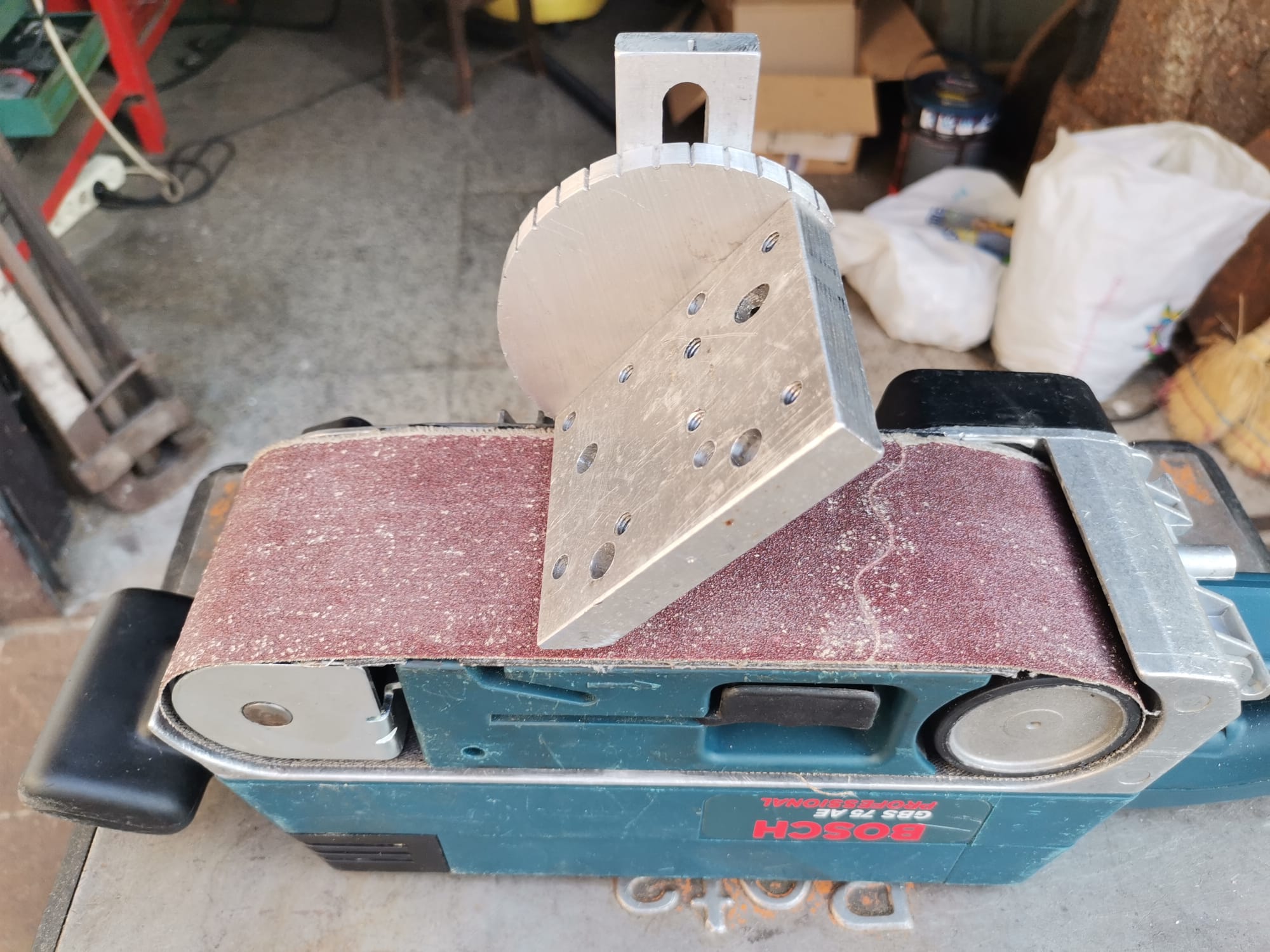

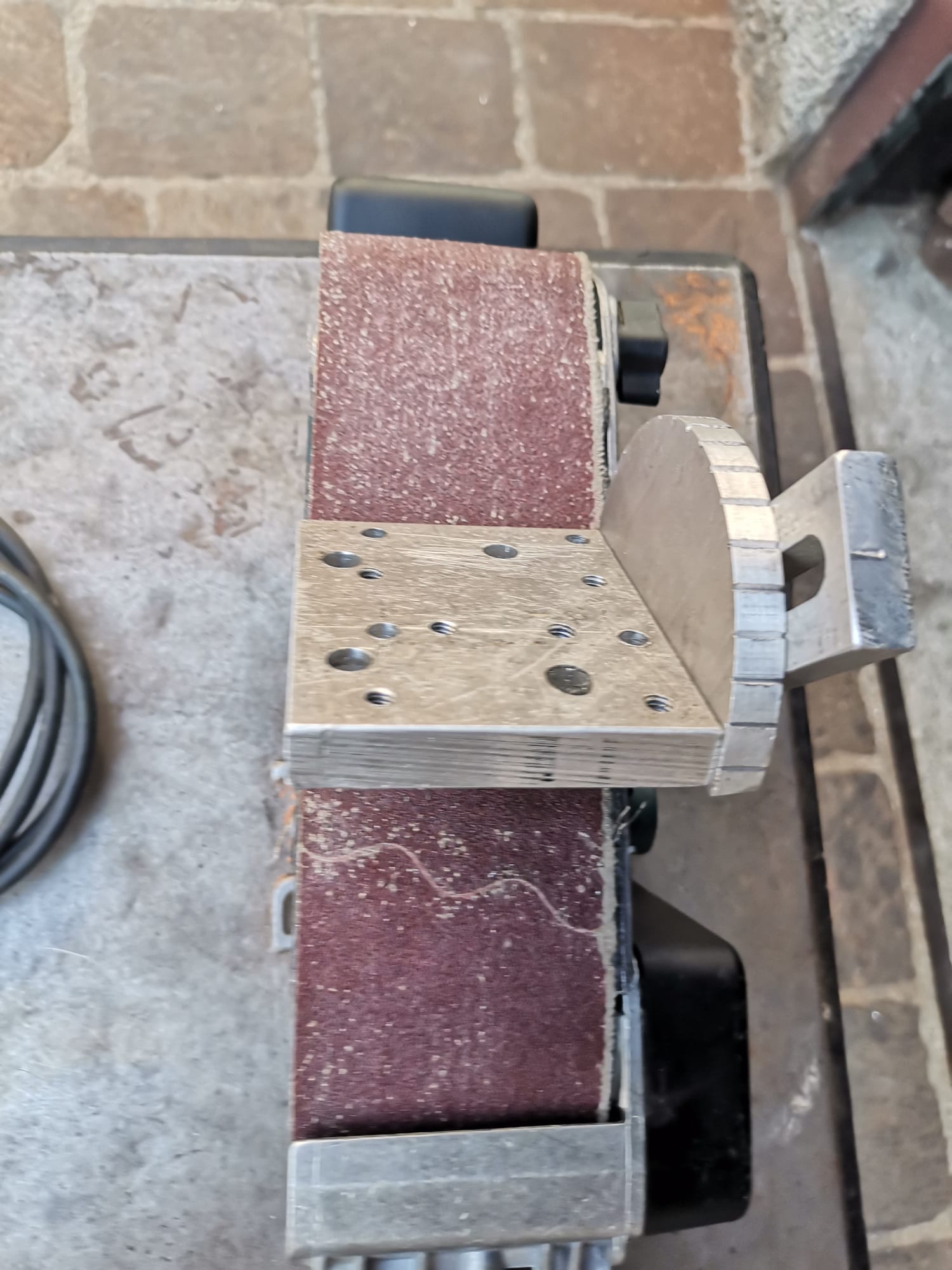

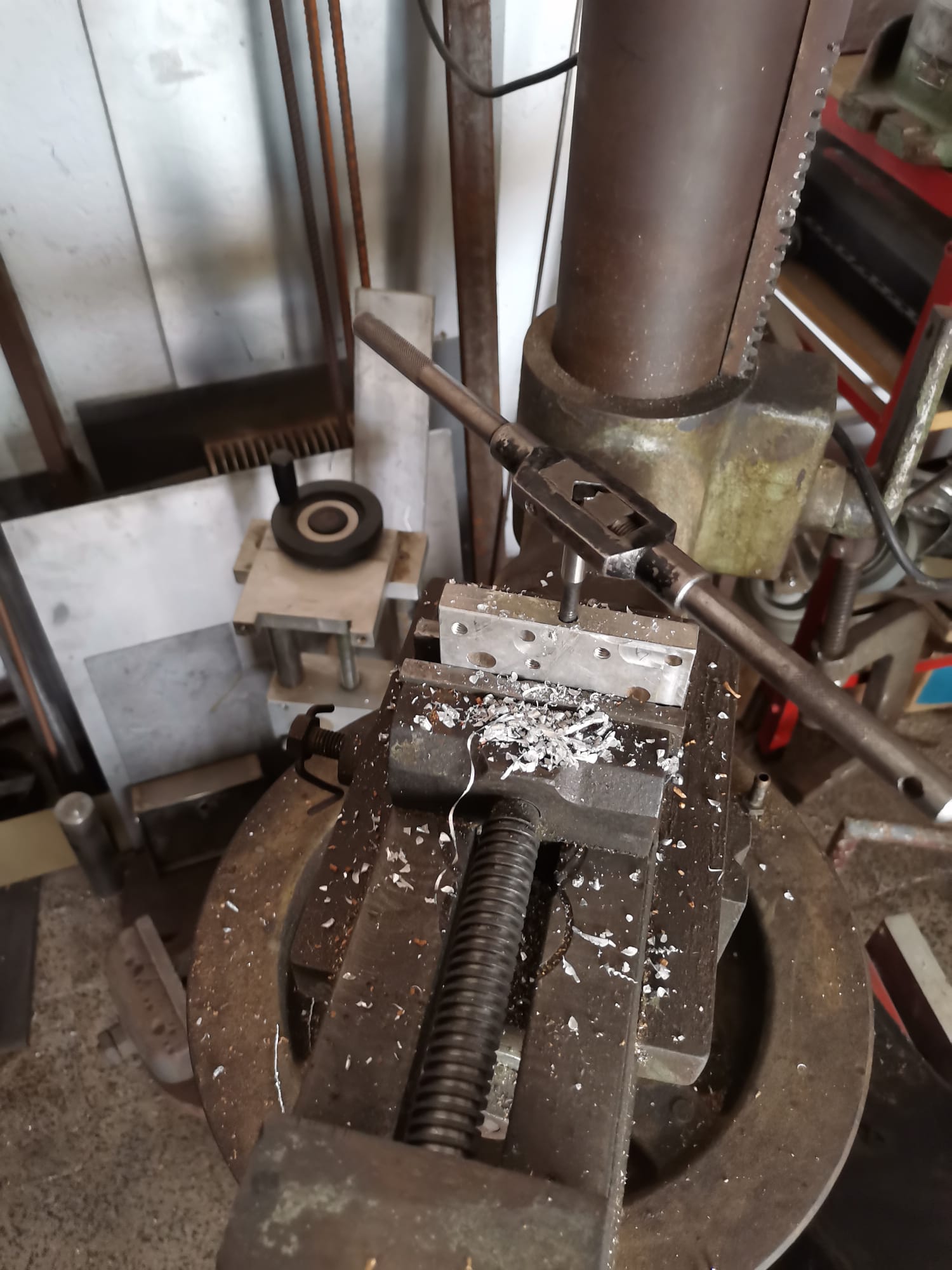

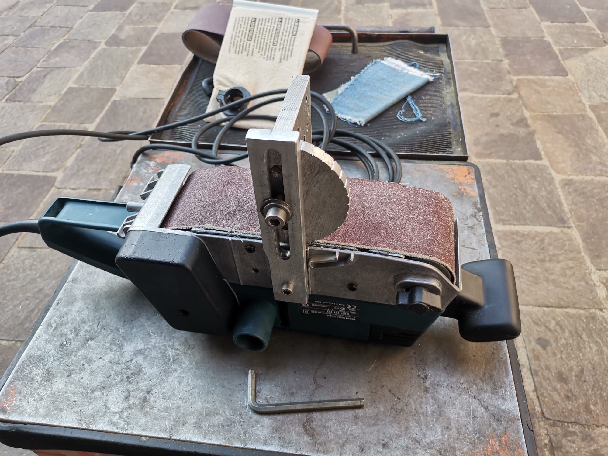

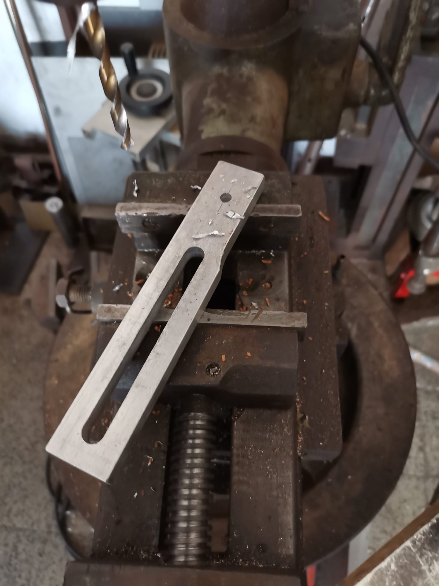

    Just finished the tool for my new the belt sander (Bosch Gbs 75ae).
    I built it with metal scraps, waste from other projects or damaged parts. Pretty useful to sharpen bits and tools which don't require particular precision or shape parts.
    I will build soon a sort of ruler to set the angle on the plate

    Clearly you have followed the K.I.S.S. principle. It looks very robust, nice job and you can still sand a board.

    Thank you! Few parts but pretty strong. The good thing to keep the scraps, they are always useful for something!
    I tried also to make the rest easy to detach, a single hex screw locks the vertical frame (held in place by the bosch rail)
    Apart from the noise, I'm satisfied with this used sander

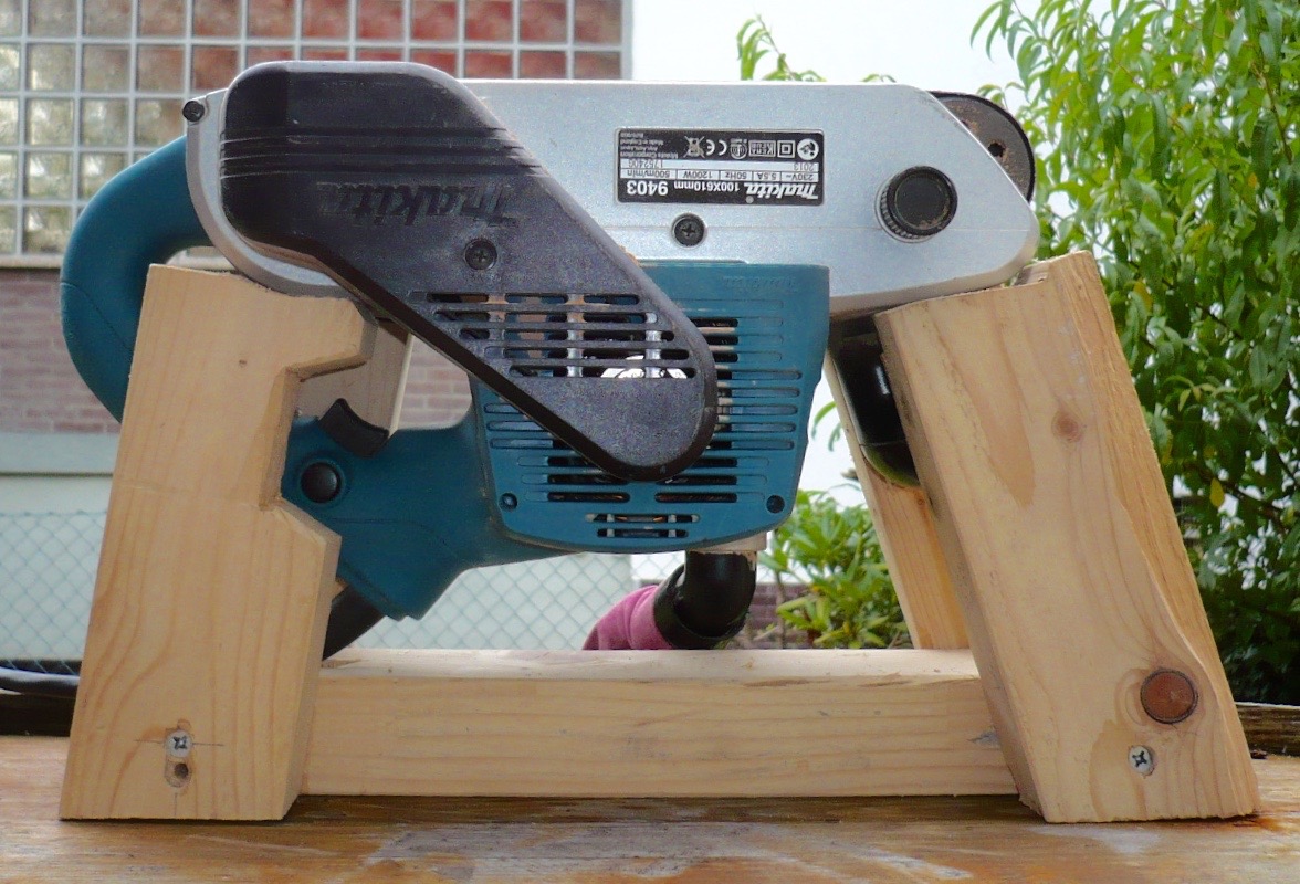

    Makita has to be stabilized on the back:
    Weight and friction keep it from wandering.

    I found in used market a 9403 model at good price, powerful tool! I was searching for a flat top model, possible to use on normal bench without particular stand. I found mine pretty stable without any clamp for most of work, probably better to lock for shaping parts. I found also a good Metabo with dedicated stand, unluckily too far from my city.
    Anyway, these tools are really awsome!
