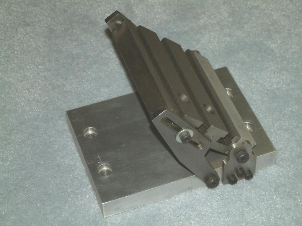

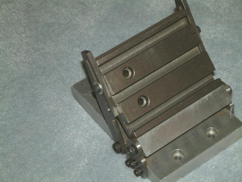

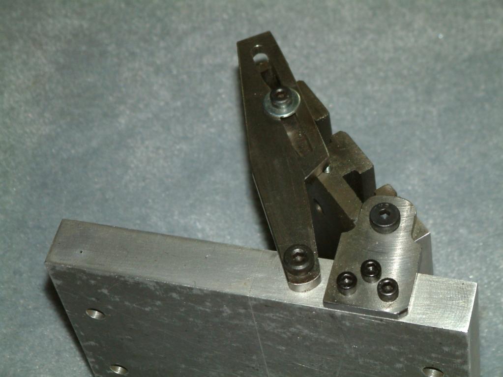

    Having the need for an angle plate for my mini mill I built this one from a cast iron
    table purchased from Littlemachineship. It was trimmed to length on the band saw.
    I added an aluminum spacer to one edge. The base is also aluminum.
    All 6 of the pivot points are made using shoulder allen bolts.
    Works great and easy to make using the ready made cast iron table.
    Cheers, JR
