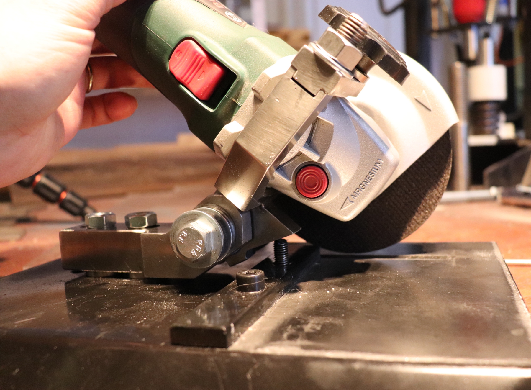

    Made this kind of mount for angle grinder.
    My friend asked tool post grinder. I decided to build one with other uses too.
    Pictures about the design comes little later.. forgot to resize them.
    Material is stainless 316 and nylon.
    Stand is made from mild steel.

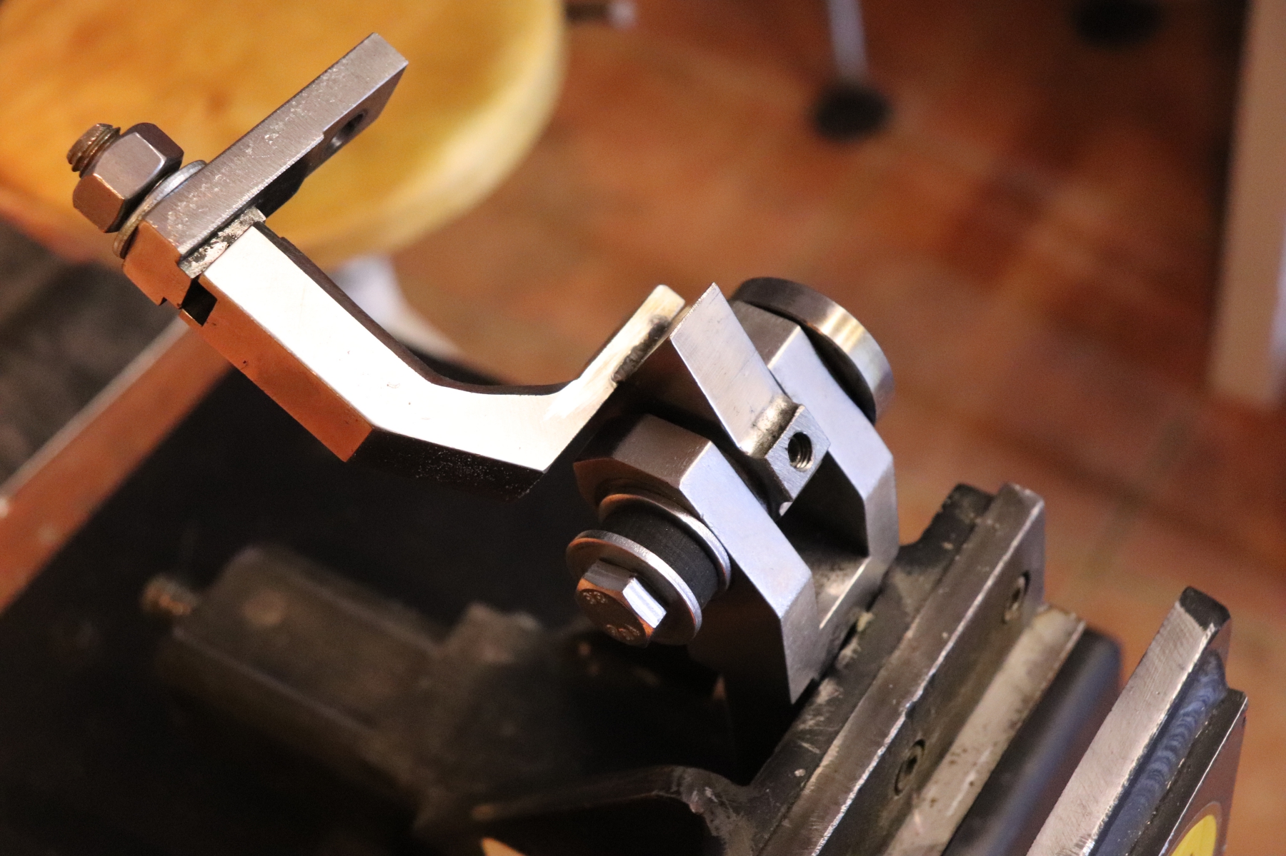

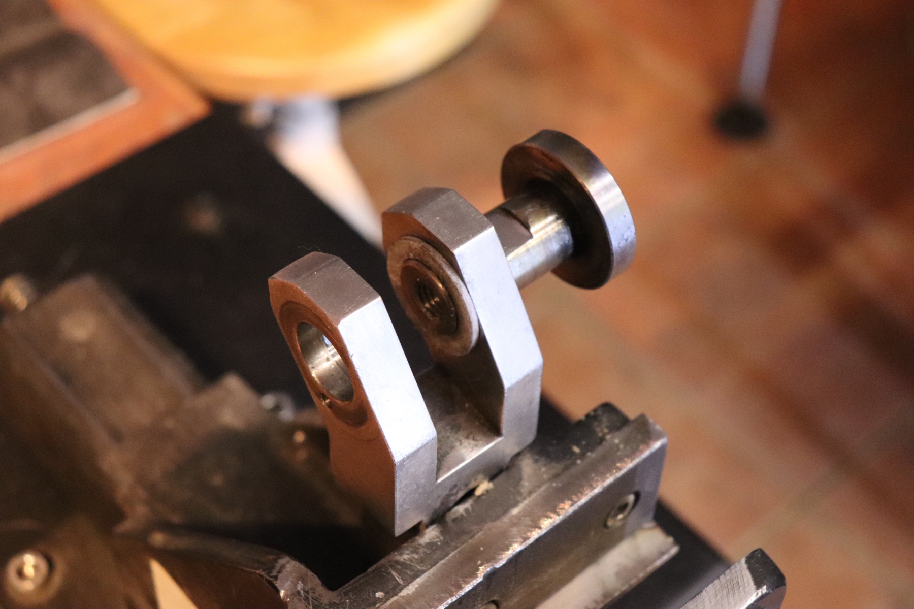

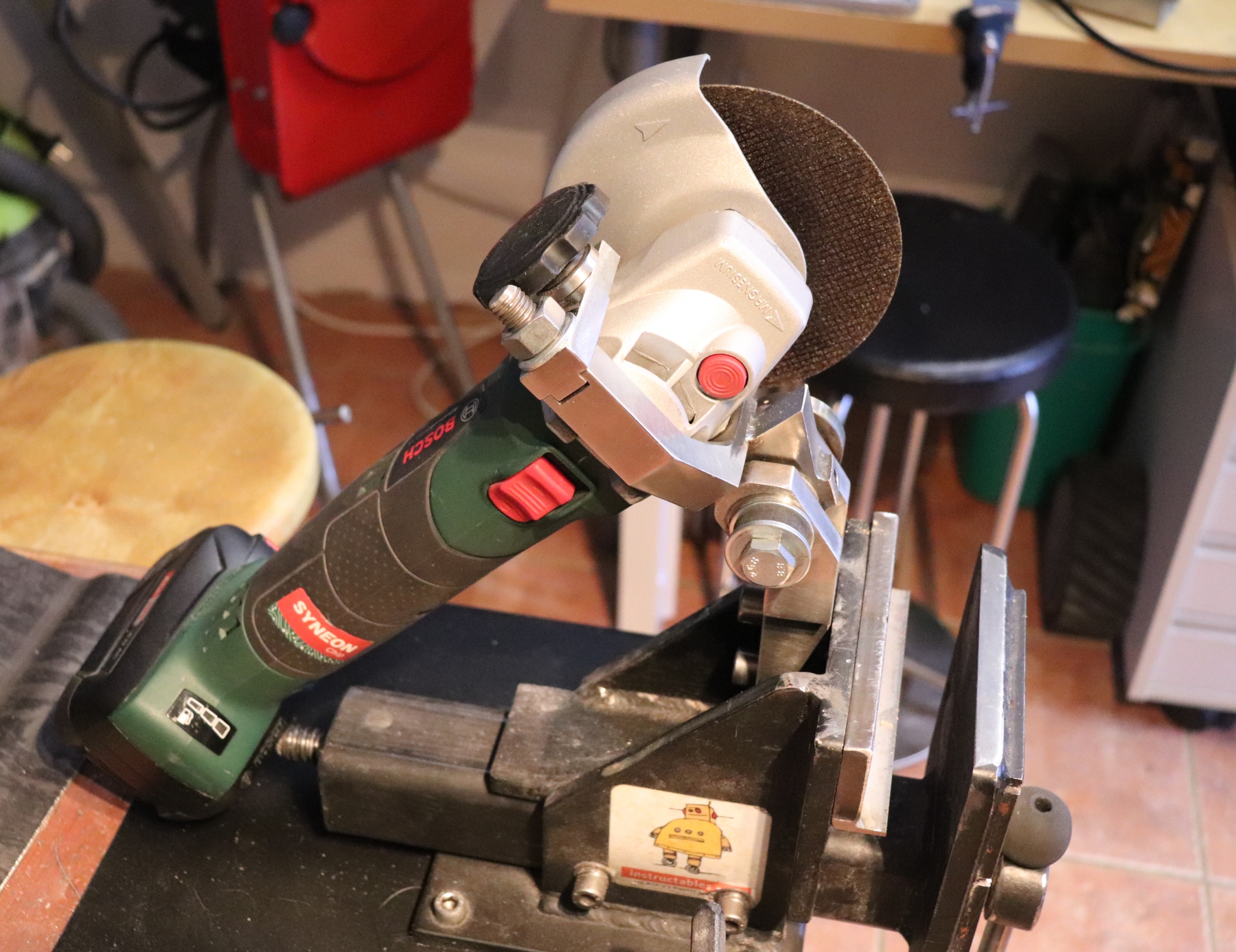

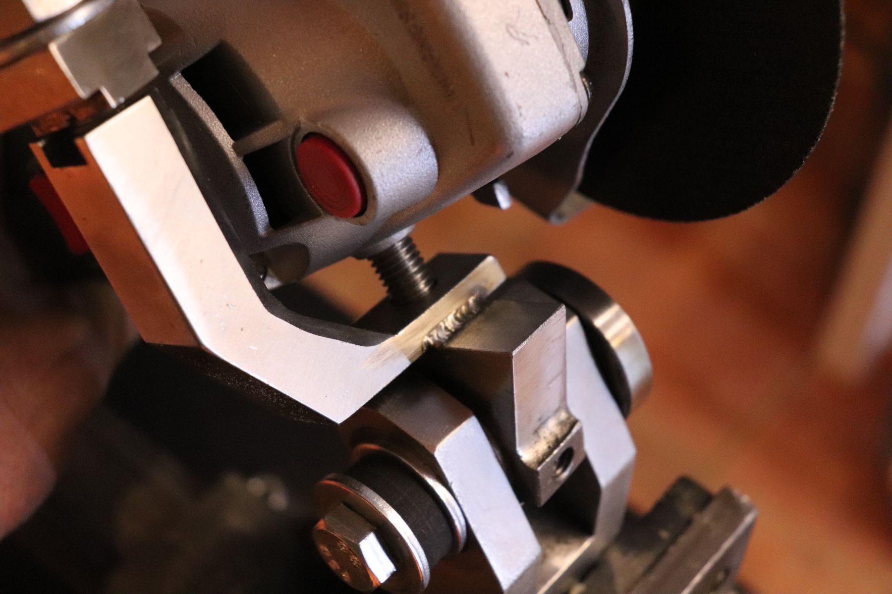

    Here is the pictures and some explanation. Feel free to ask if there is any questions.
    Can be mounted to vise.
    Angle grinder tool post grinder / vise mount / stand-1.jpg
    Angle grinder tool post grinder / vise mount / stand-2.jpg

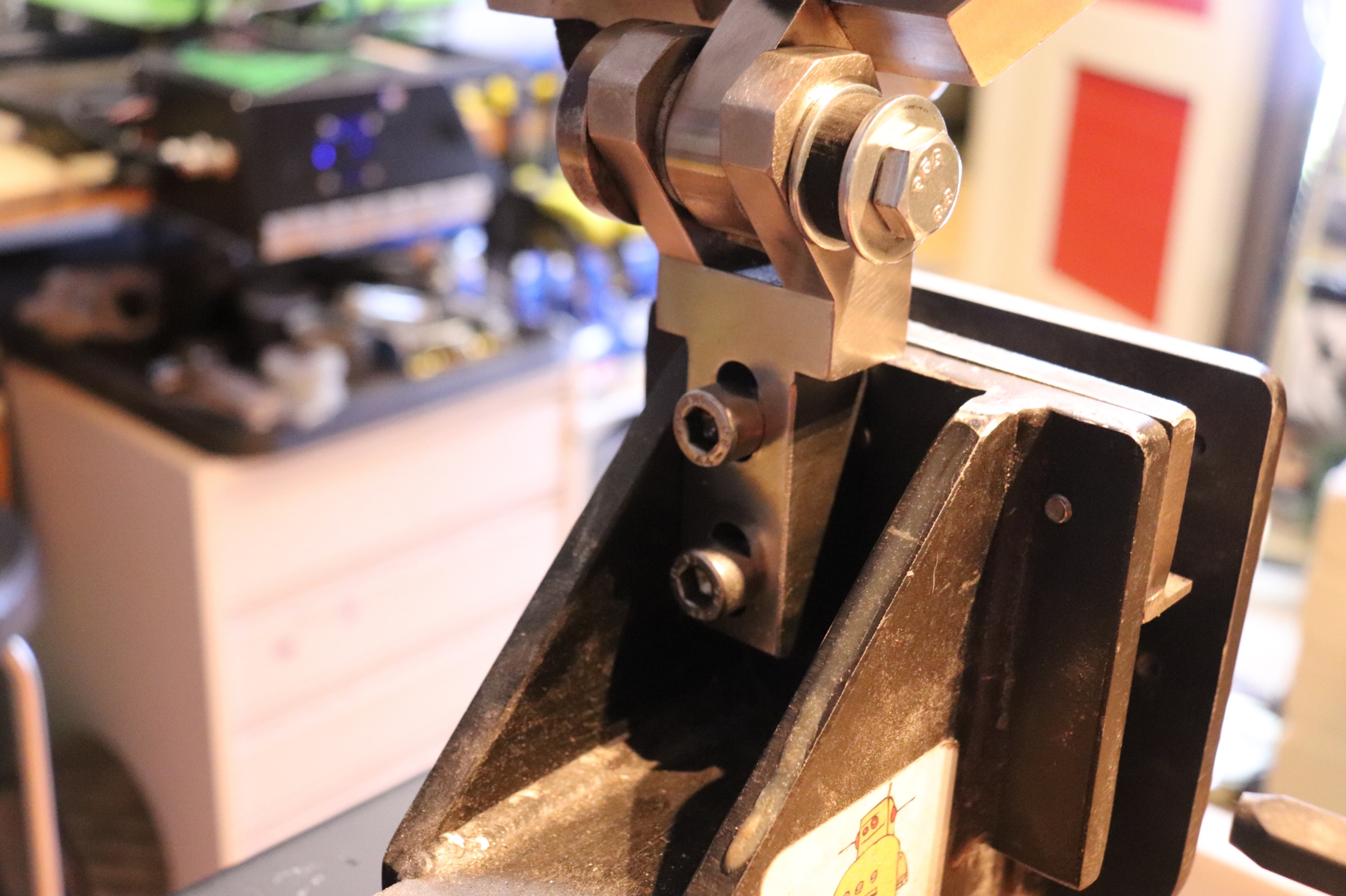

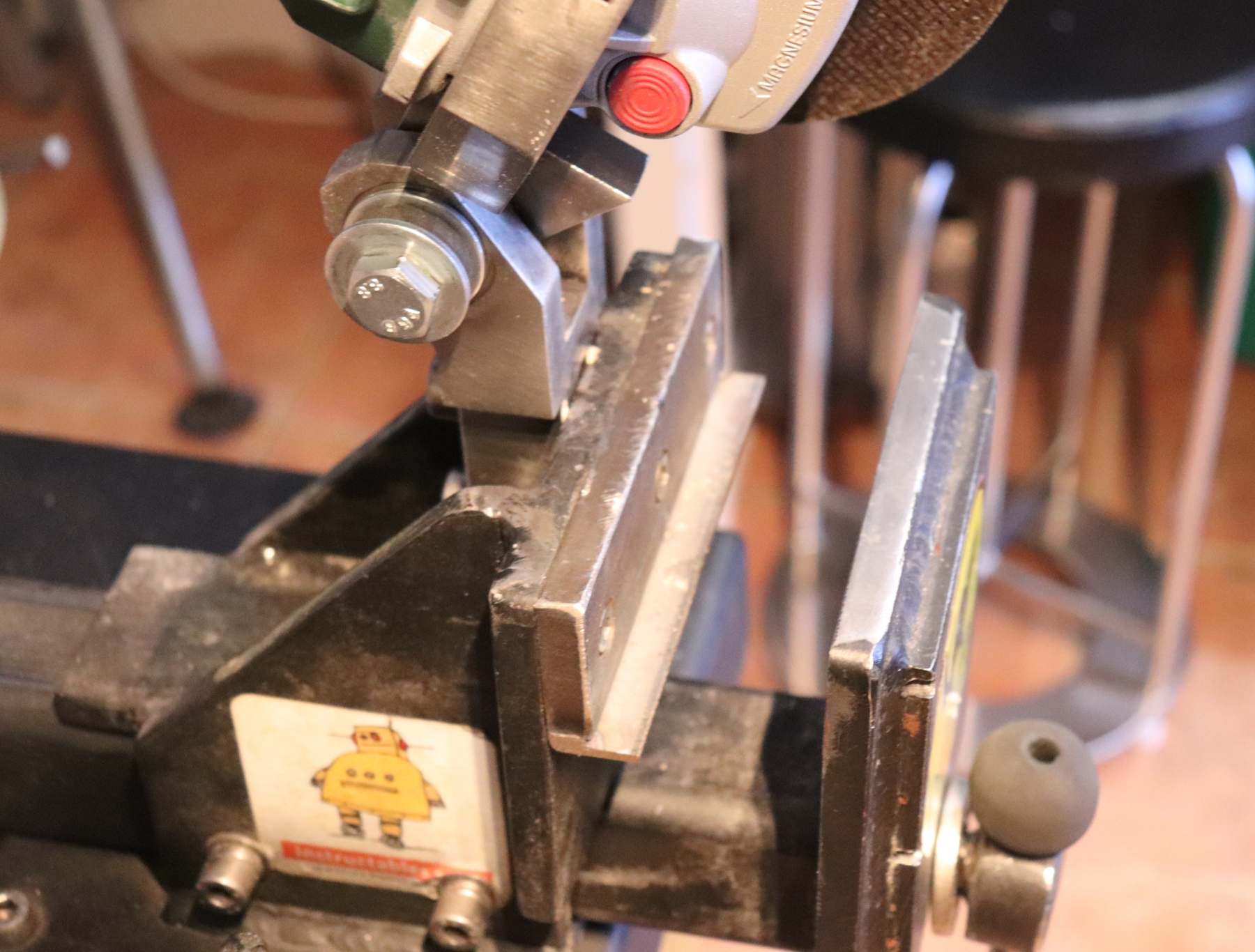

    Mount is assembled to vise with two M10 screws.
    "Arm", that's the part where this mounting tool is mounted to different objects.
    Is shaped to fit to the vise, that it leans to the body of the vise, which guides, and keeps it straight. This gives straight cuts.

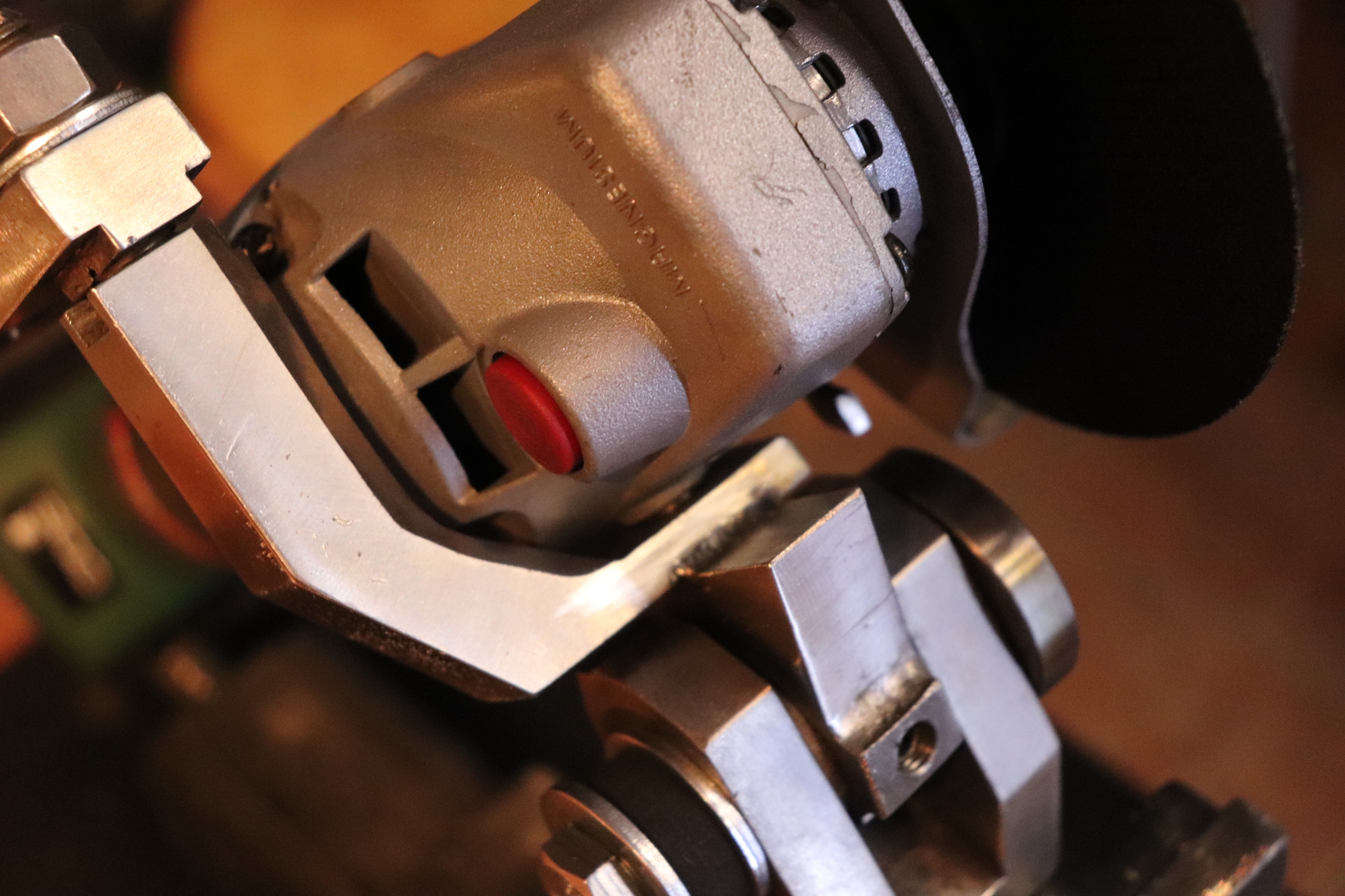

    Angle grinder tool post grinder / vise mount / stand-3.jpg

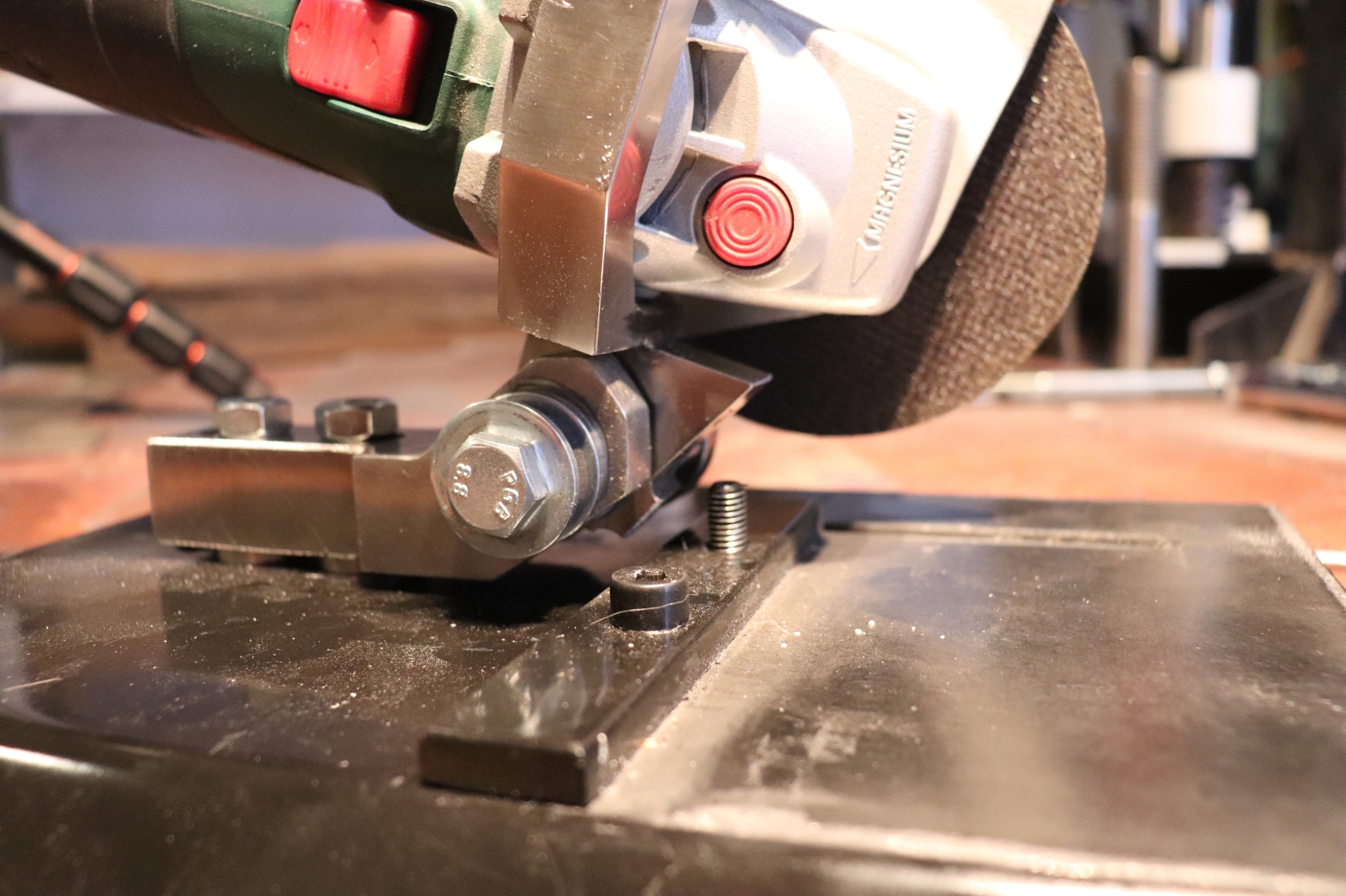

    Grinder mount:
    Is milled from one piece, then cut to half and turned 90 degrees and weld back together, to save time and material.

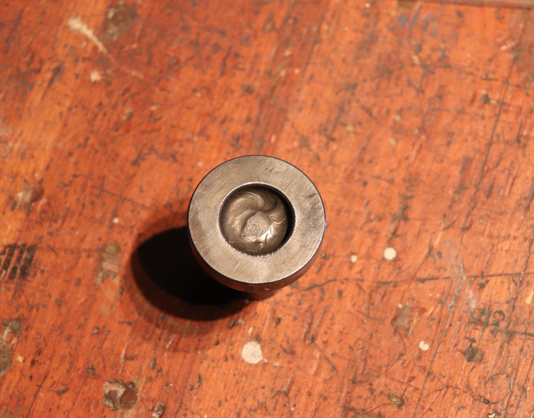

    Angle grinder tool post grinder / vise mount / stand-4.jpg

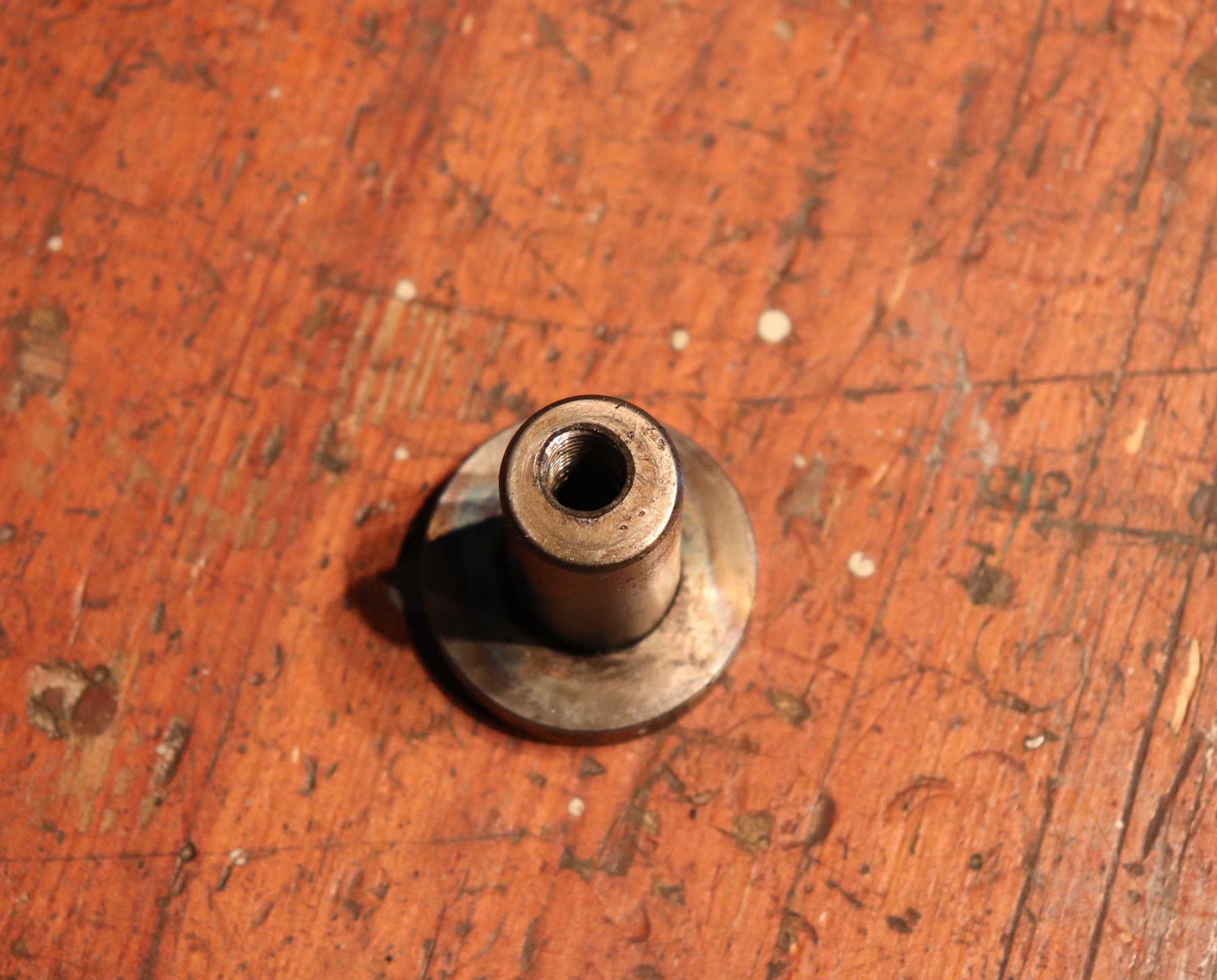

    Axle, that connects "arm" and "grinder mount" together.
    Weld washer on other end, again to save material.

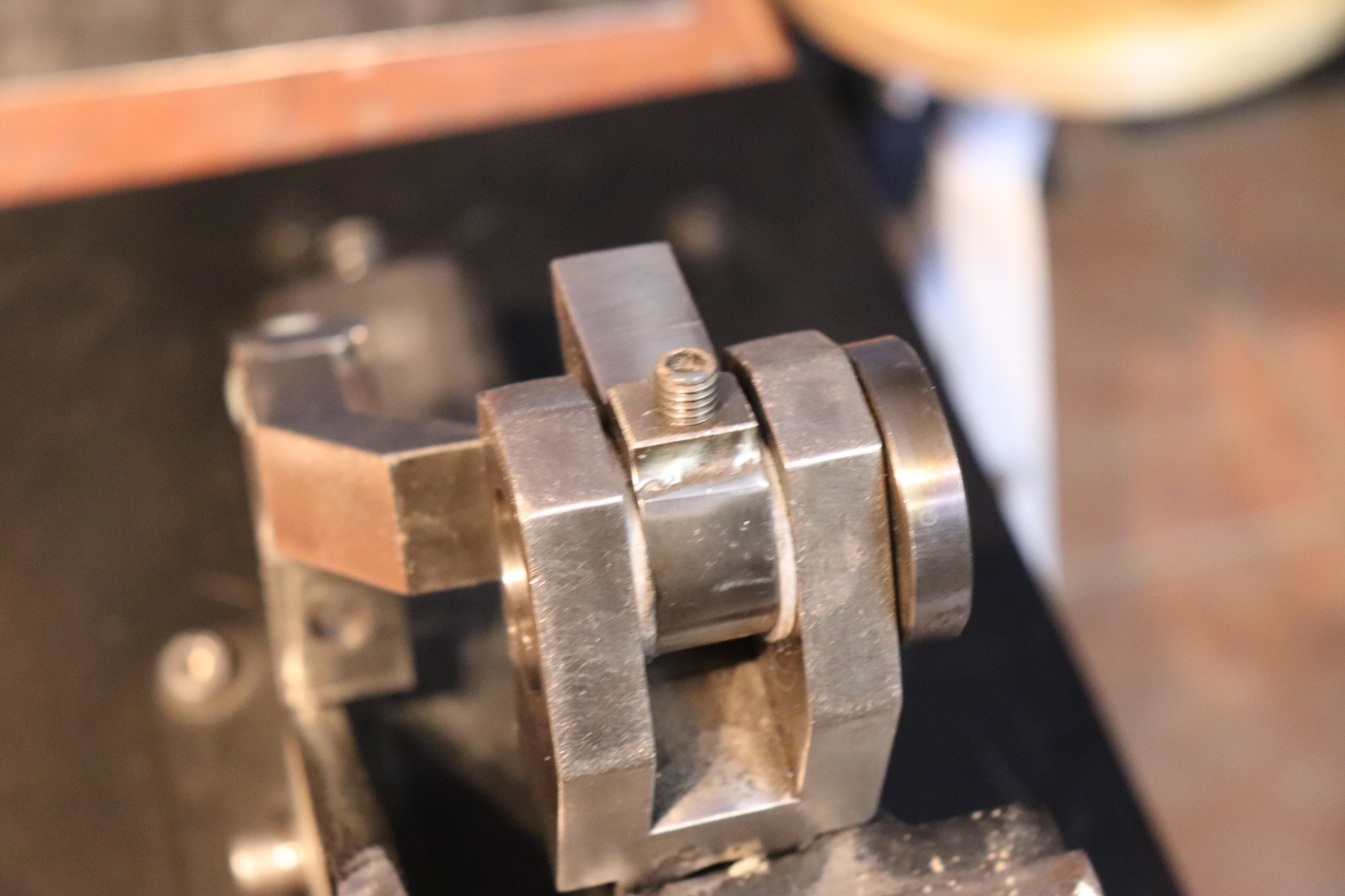

    Angle grinder tool post grinder / vise mount / stand-5.jpg
    M10 thread on other end of the axle.
    Thread is where the "friction lock" connects, and its intentionally off centered.
    Off centering makes steel and rubber washers that are bolted to it, make circular movement.
    If thread would be centered, result instead of producing friction to the arms movement, locking bolt would just tighten or loosen, depending which direction arm is moving.

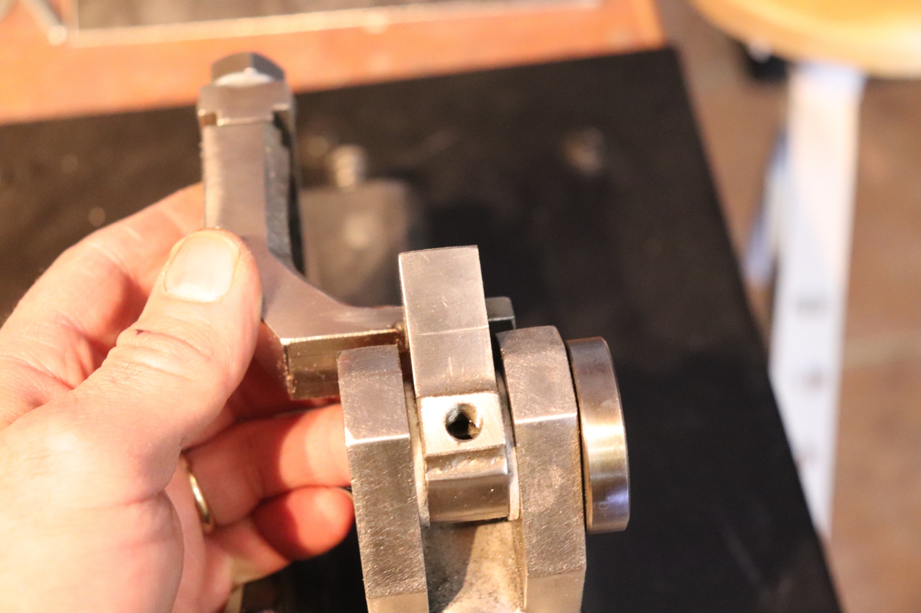

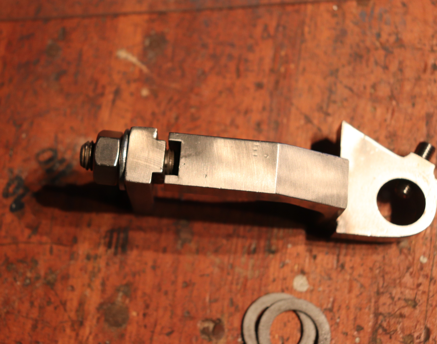

    Angle grinder tool post grinder / vise mount / stand-6.jpg
    At the side of the axle is filed slot for the locking screw that locks axle and the grinder mount together.

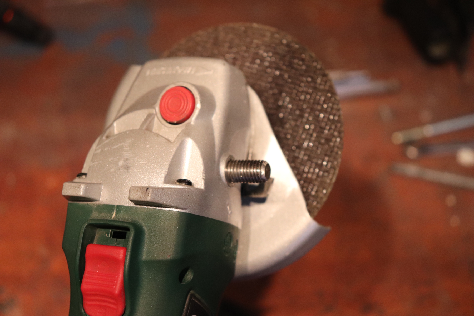

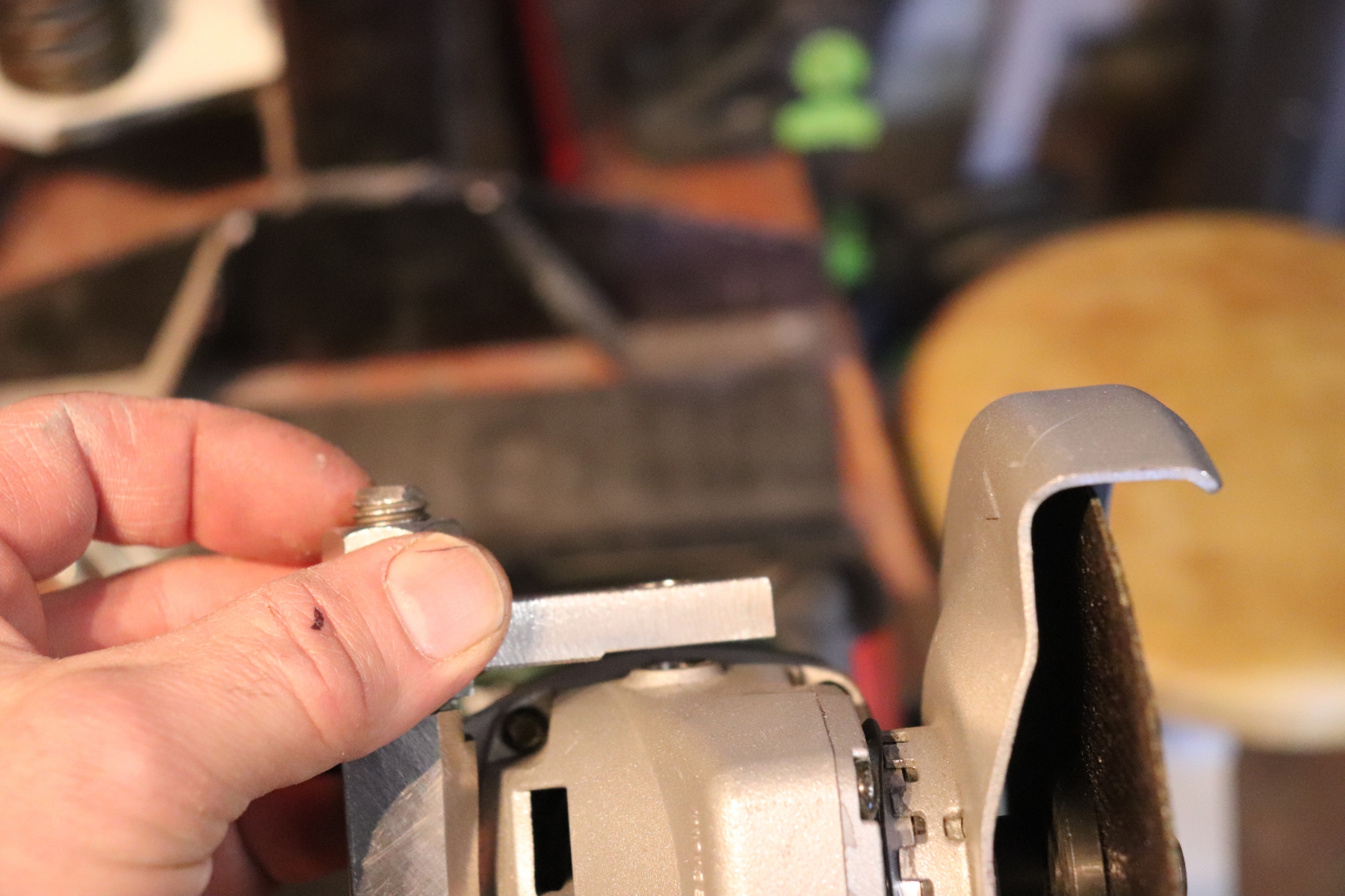

    Both sides of the angle grinder is M10 threads for the handle.
    Piece of M10 threaded rod is screwed to the other side.
    Angle grinder tool post grinder / vise mount / stand-11.jpg
    Angle grinder tool post grinder / vise mount / stand-12.jpg
    Angle grinder tool post grinder / vise mount / stand-13.jpg
    Filed slot to get tight fit.

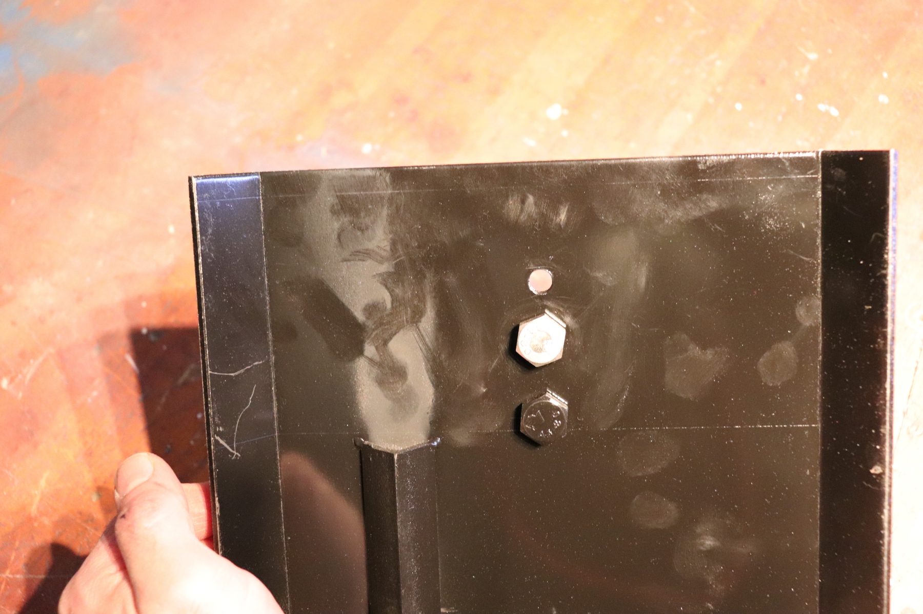

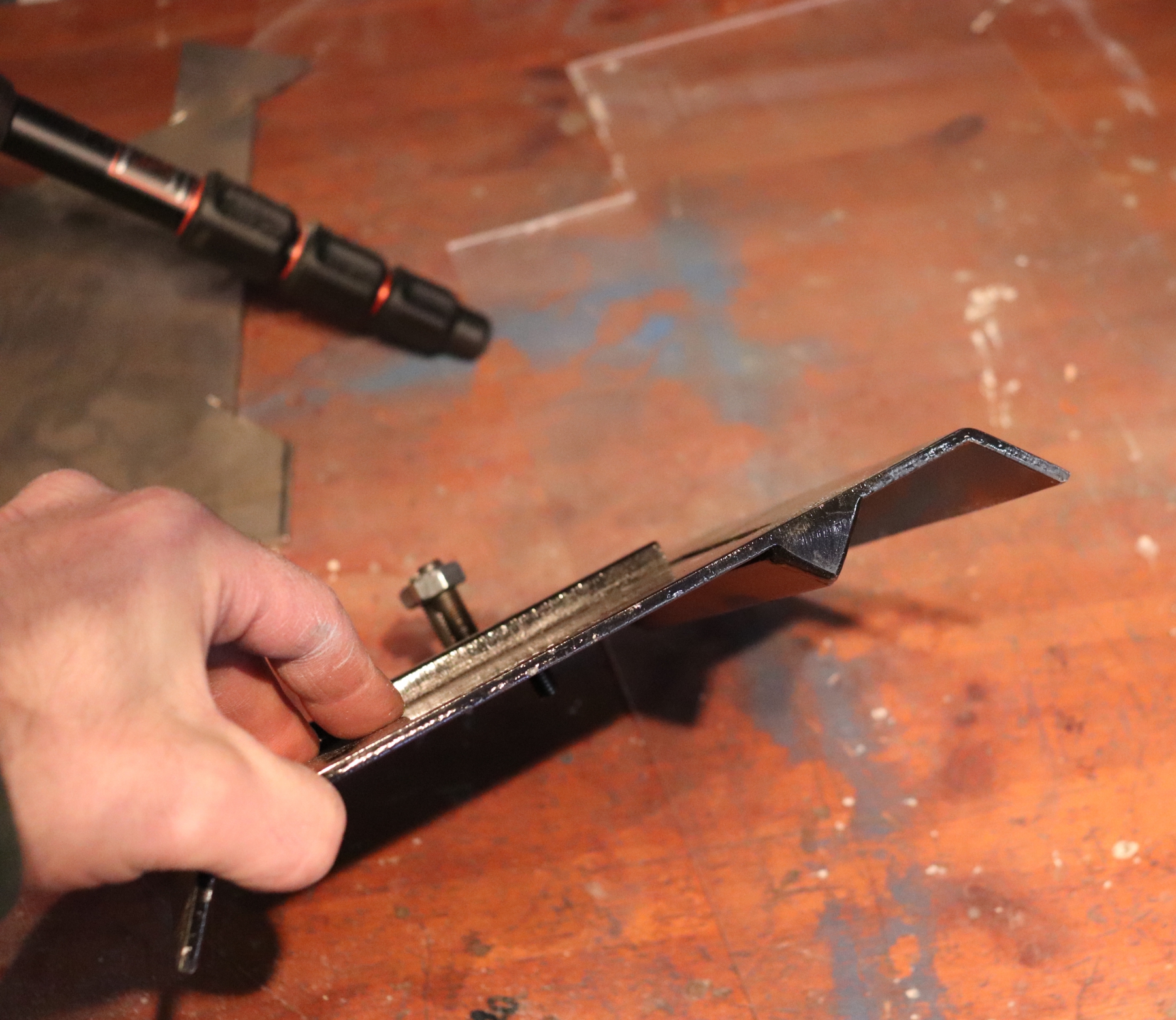

    And a little shelf on the vise jaw, to guide for to be cut objects straight.
    Angle grinder tool post grinder / vise mount / stand-15.jpg
    Stand:
    Bend edges as feet's. Weld angle iron on the bottom side, guides sparks behind the stand. (most of.. or atleast some of the.. )
    Angle grinder tool post grinder / vise mount / stand-16.jpg
    Angle grinder tool post grinder / vise mount / stand-17.jpg

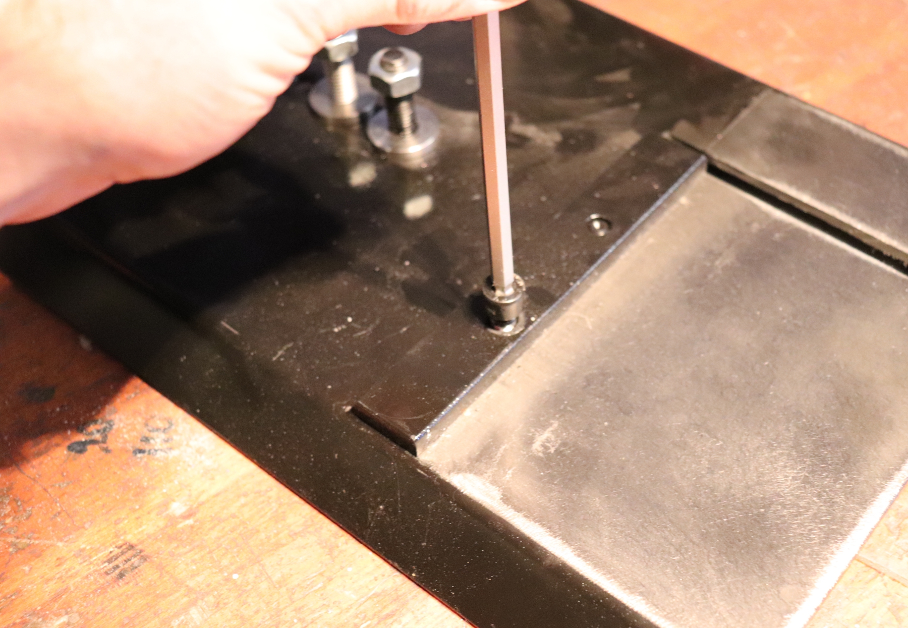

    Edge guide is locked to the stand with this M8 bolt.
    Angle grinder tool post grinder / vise mount / stand-18.jpg
    Other bolt comes from the bottom side, and when it keeps other end of the edge guide on straight line,
    it also works as a depth stop.
    Angle grinder tool post grinder / vise mount / stand-19.jpg
    Angle grinder tool post grinder / vise mount / stand-20.jpg

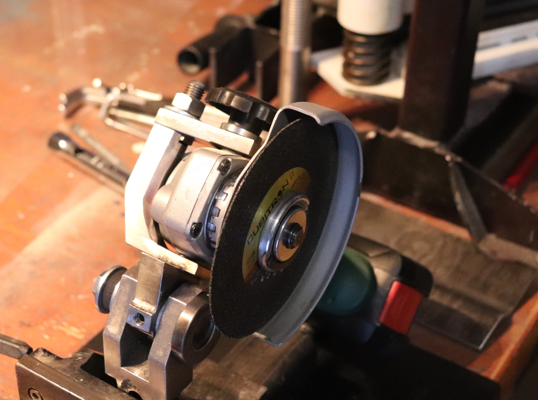

    This can also be used as a tool post grinder on lathe. Originally i made one to my friend, then noticed that it could be useful for me too.
    Video shows the using.
    Thanks.
