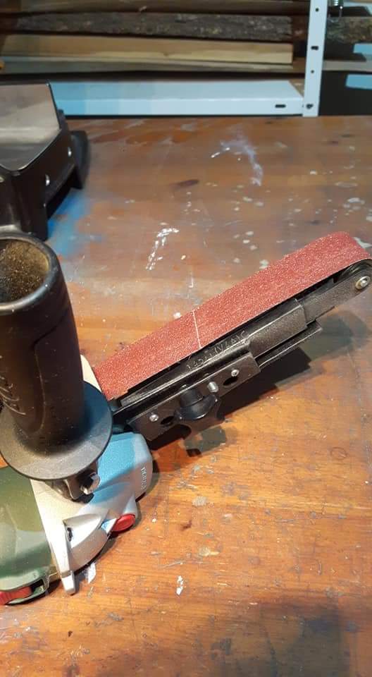

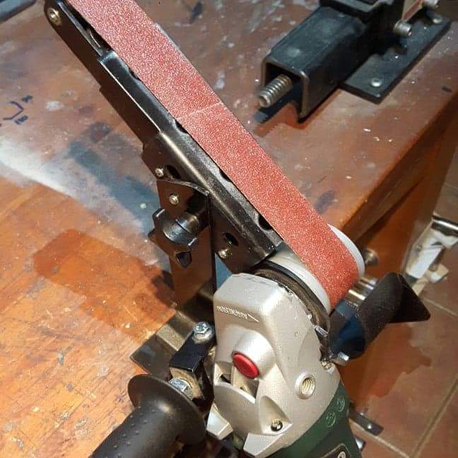

    I forget do you also have a mounting saddle for it
    Thanks Frank. Yes, i have table mount for it.
    I tought i have posted a pic from it... but didn't find it.
    I'll post it "again" later.

    Here's the missing pictures.
    And link to the video from using with table mount:
    ( last "picture" from the post)
    https://www.instagram.com/p/Bmf0jv-g...=13gxq5kylqeud

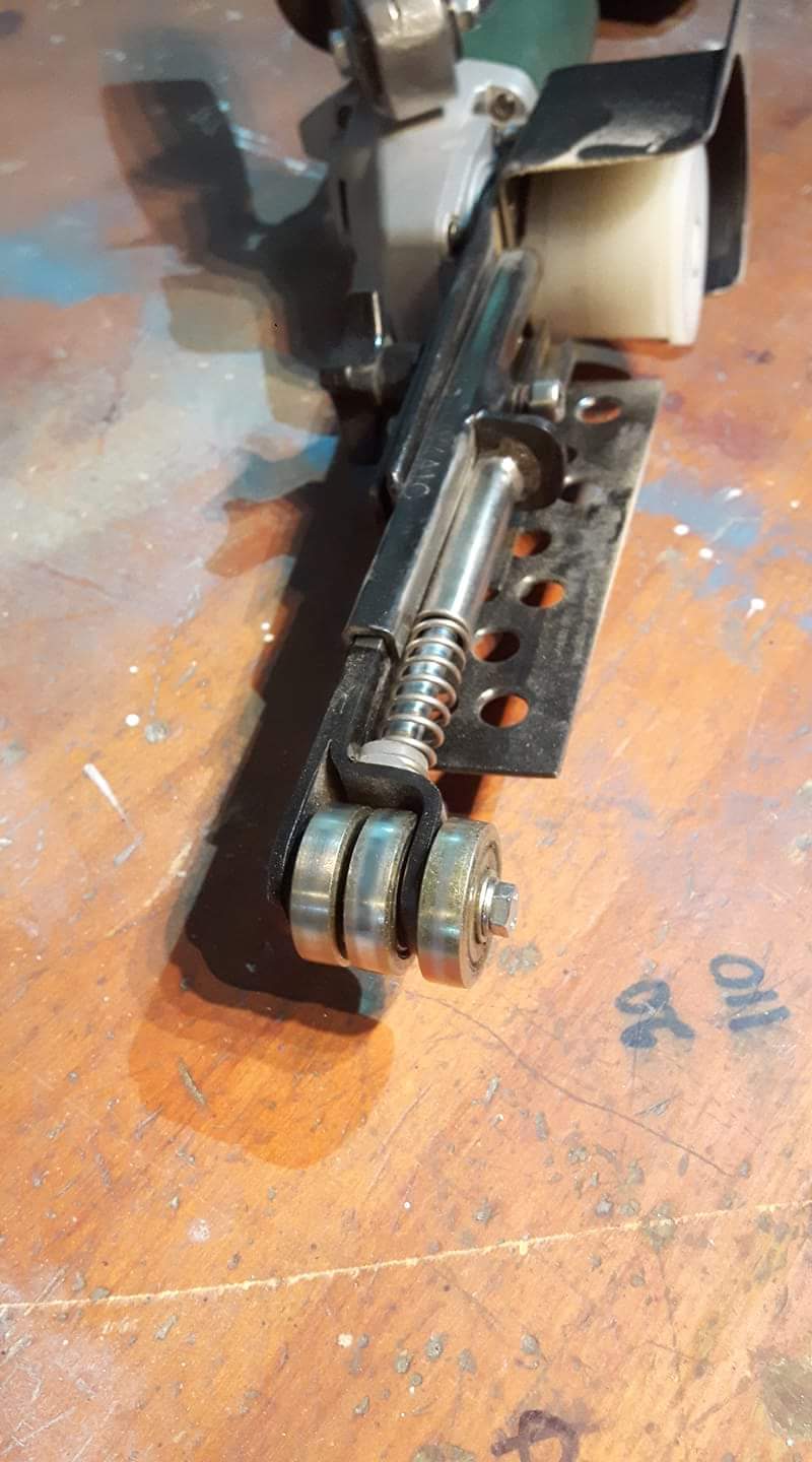

    This is the last update..
    I mentioned earlier that i used three bearings first.
    Centerpoint of the new pulley was little more out than it was with the skateboard wheel.
    Returned back to three bearings. Mounting is made same way than earlier, just shortened one rivet nut to get right sized axle.
    Now its ready.
    I have to say that im really satisfied to this.
    " Greatest angle grinder power file ever told.. " Lol
