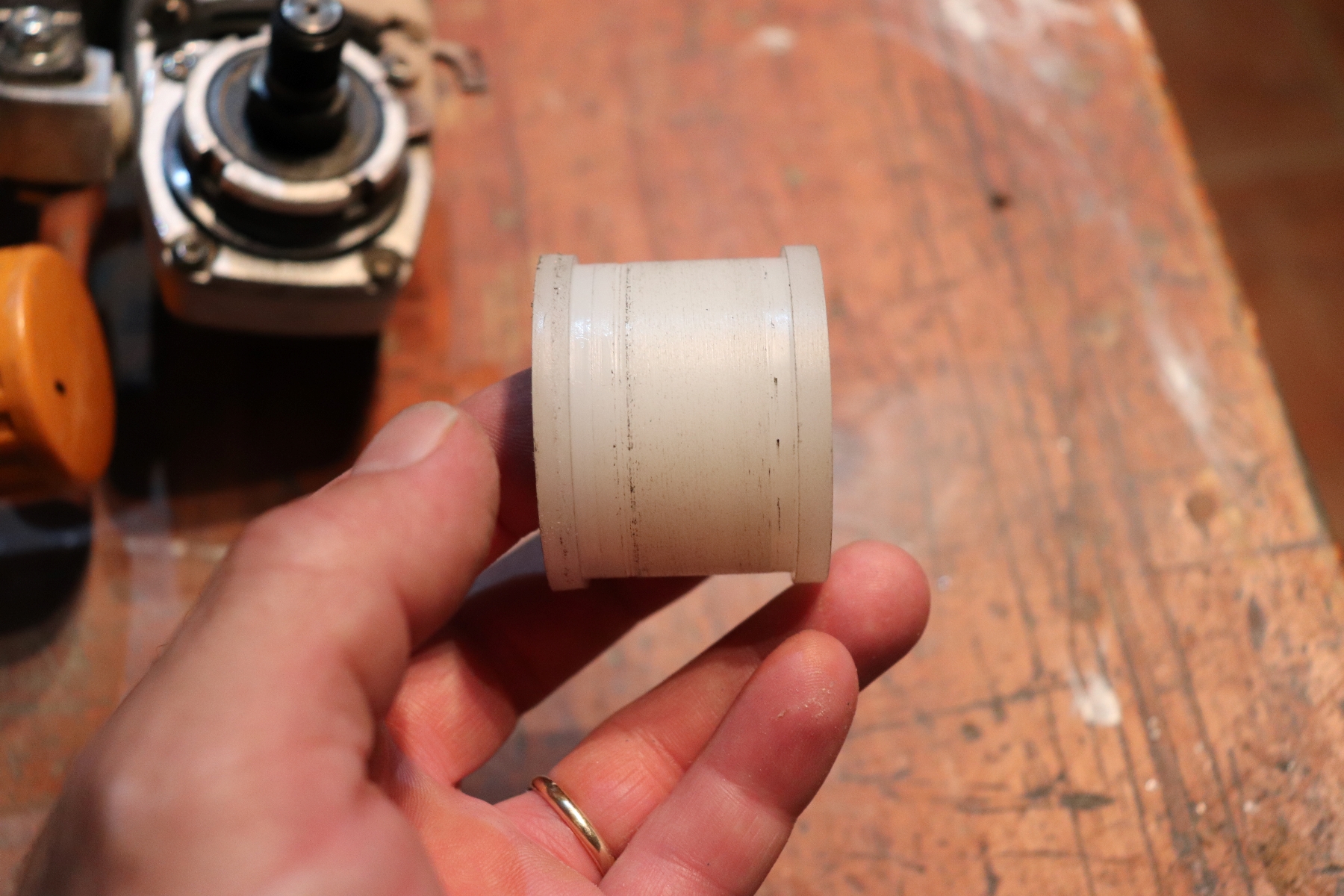

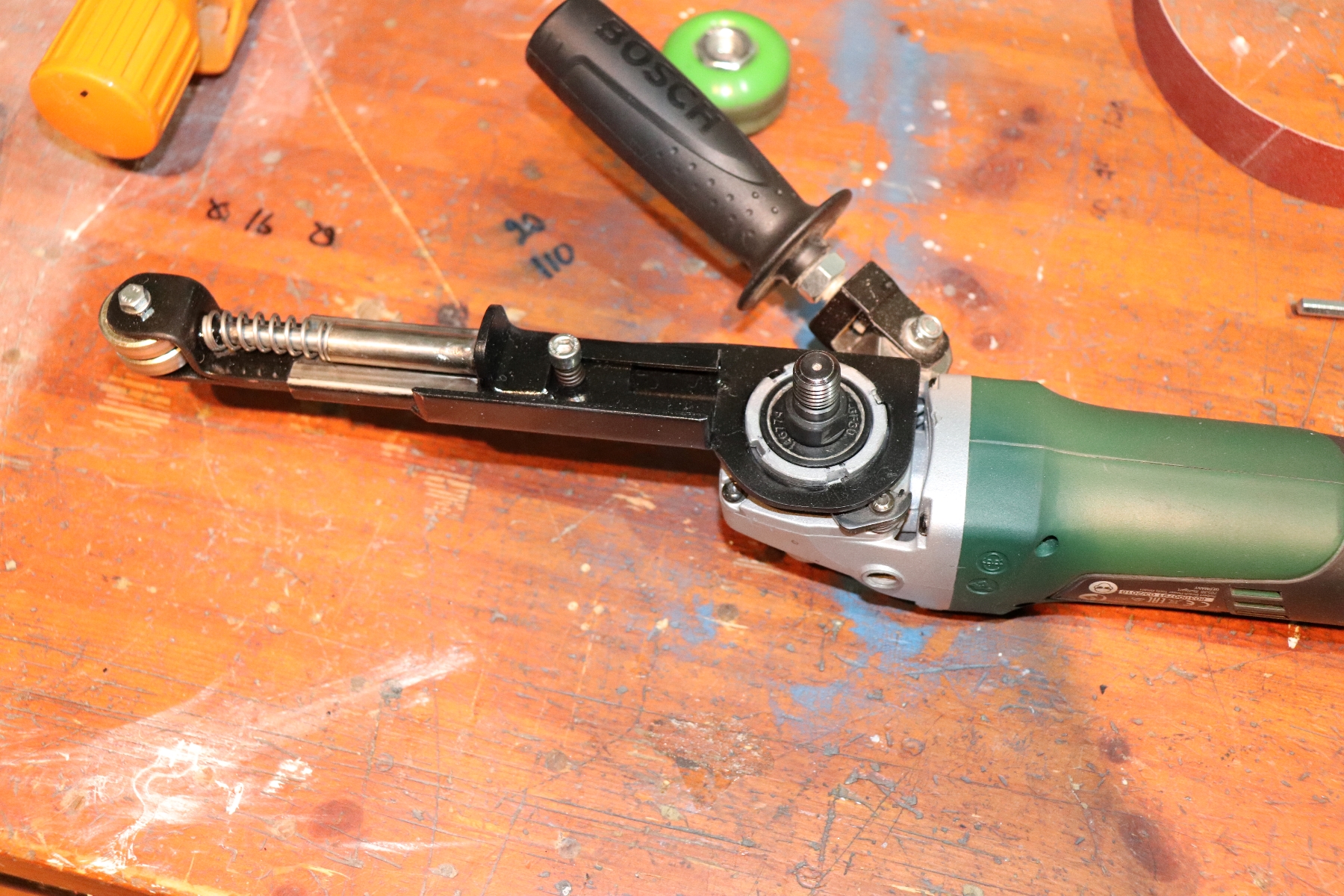

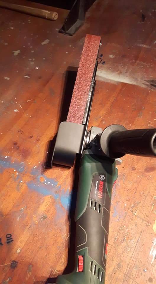

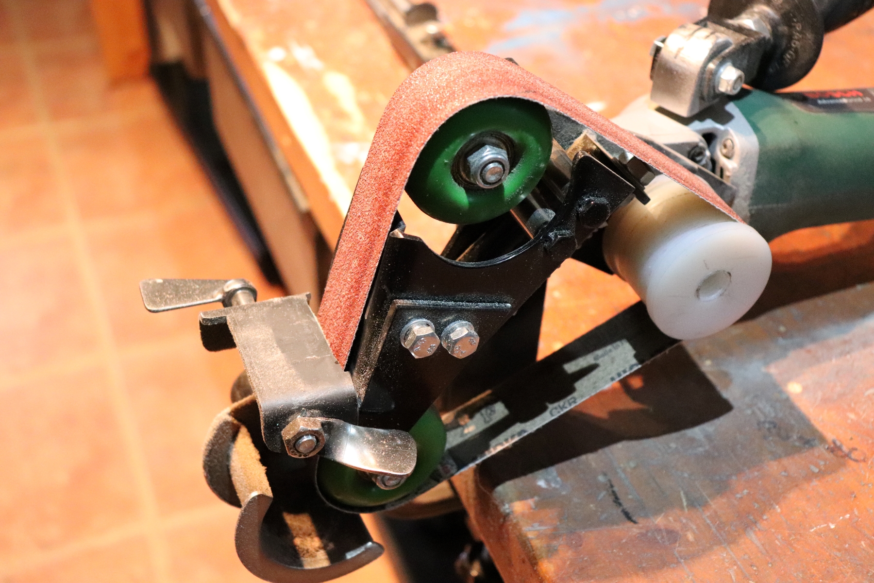

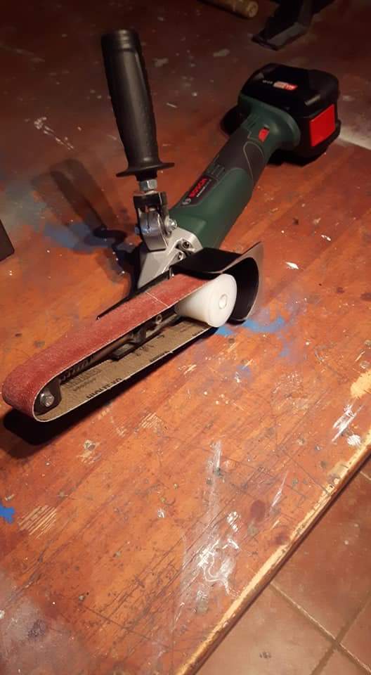

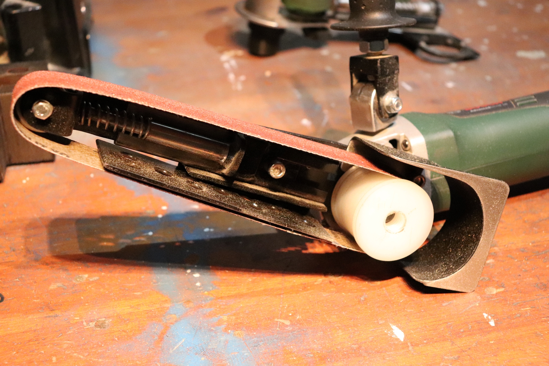

    Turned a new drive wheel..
    Old worked well and nicely.. but this one looks more pro.

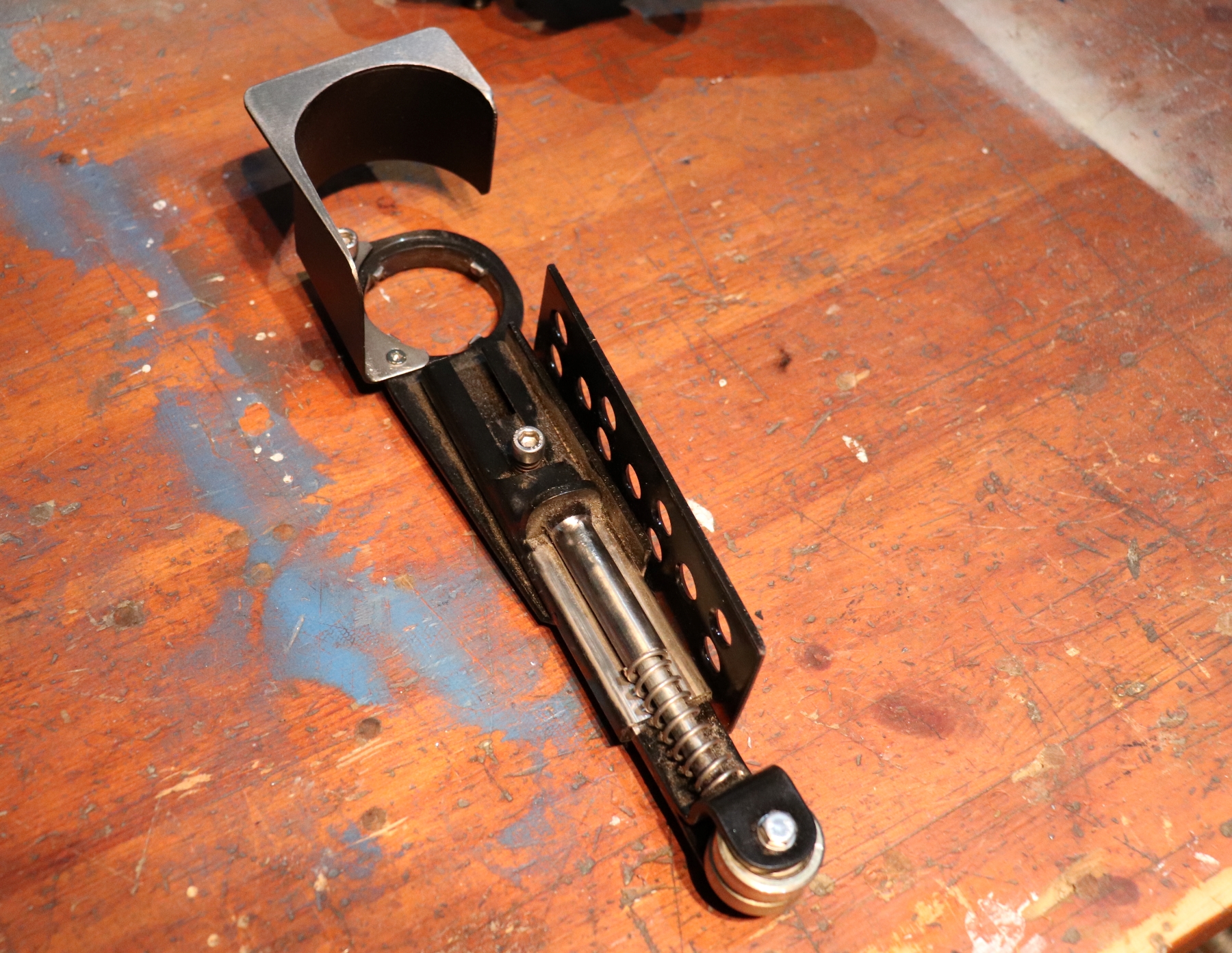

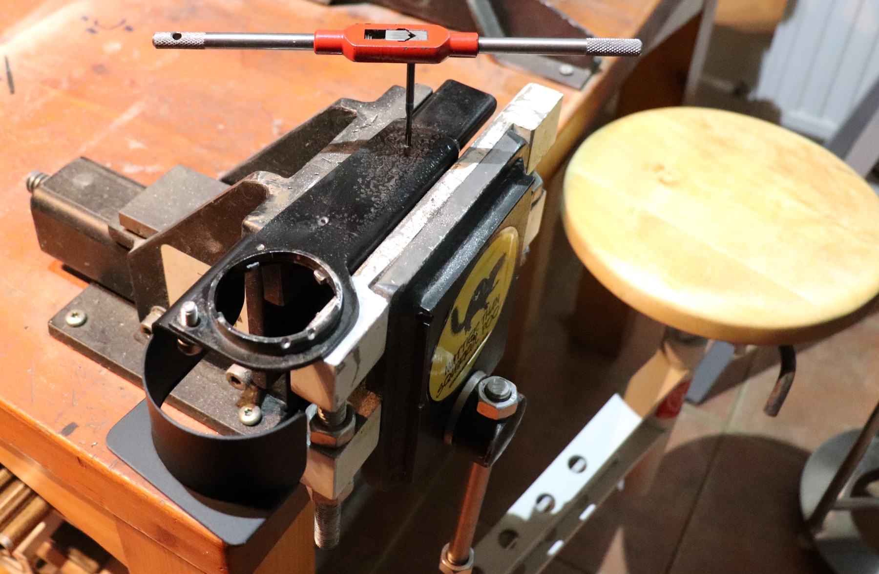

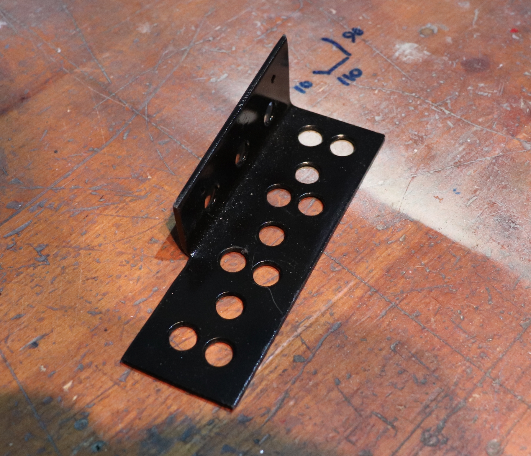

    Dust guard... made big enough to allow easier assembly to the grinder.

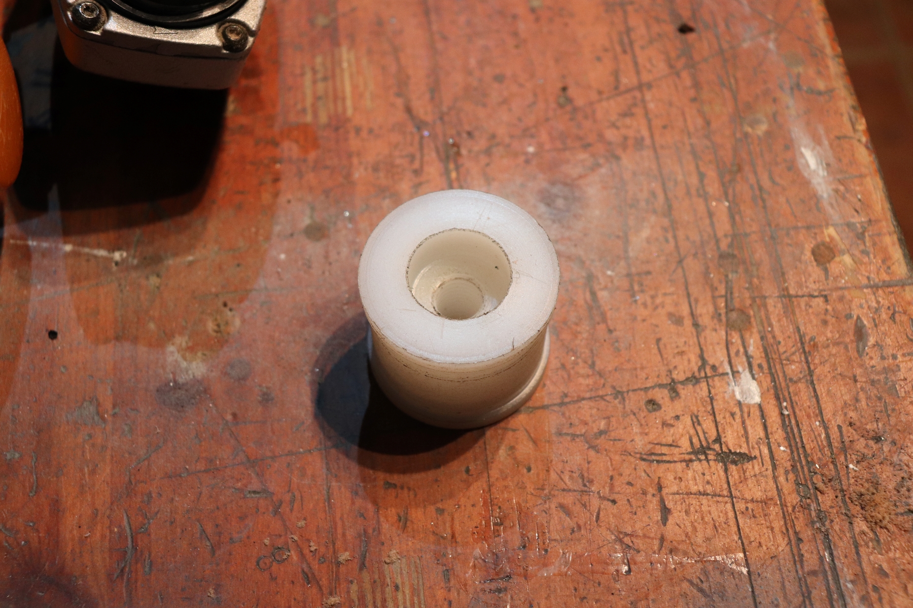

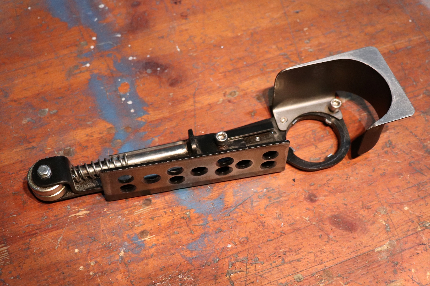

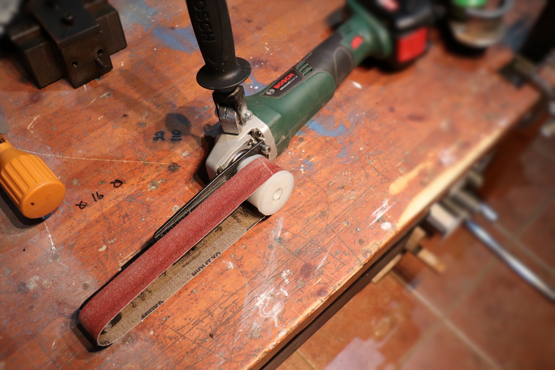

    And the final part..
    Drilled holes to platen, to get it lighter.
    Also i tought holes would reduce friction between belt and the platen.
    M6 bolt that holds the dust guard, also works as a stopper.
    Without it attachment leans to the body of the grinder and slowly scratches it... so, just a little visual improvement.
