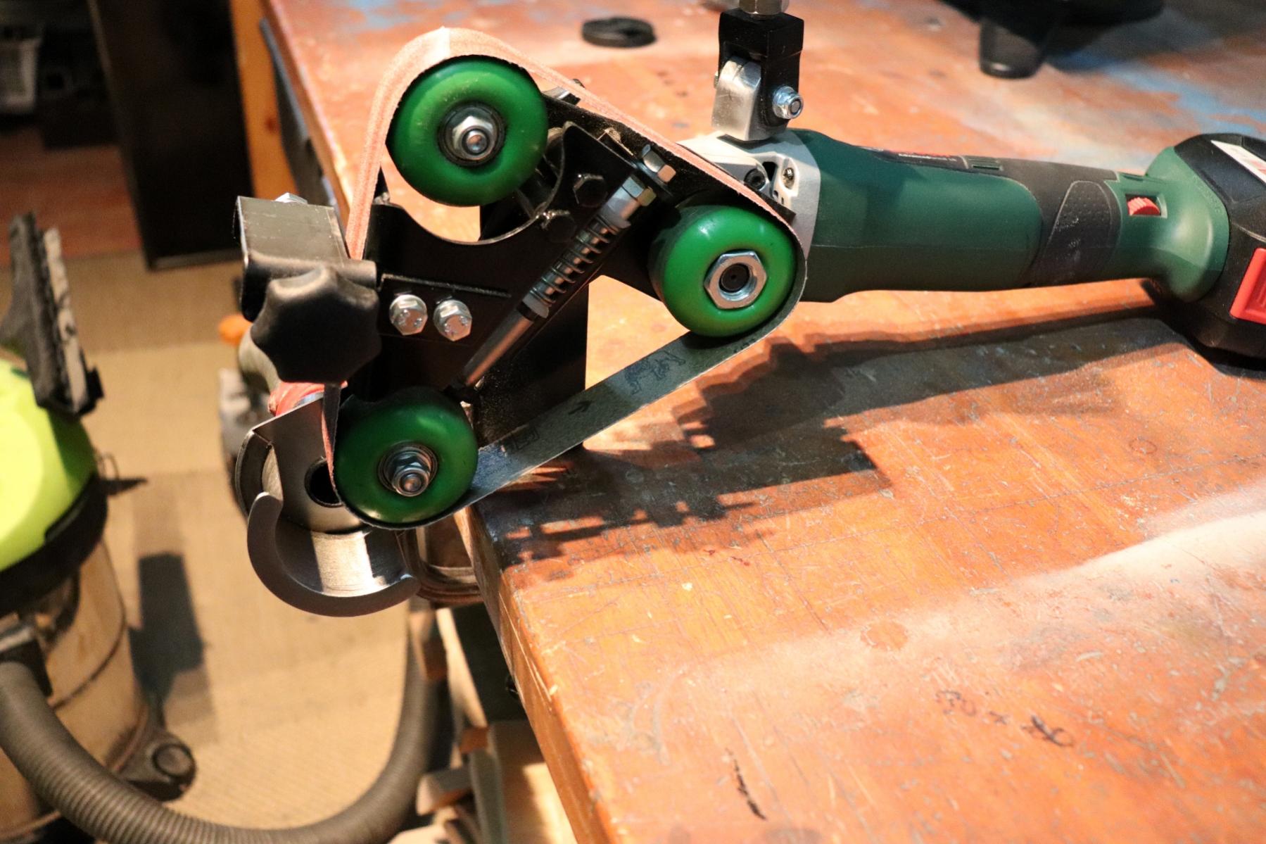

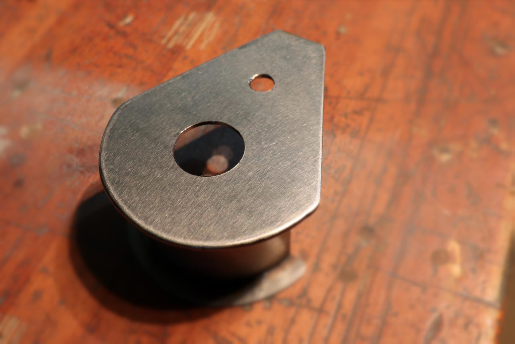

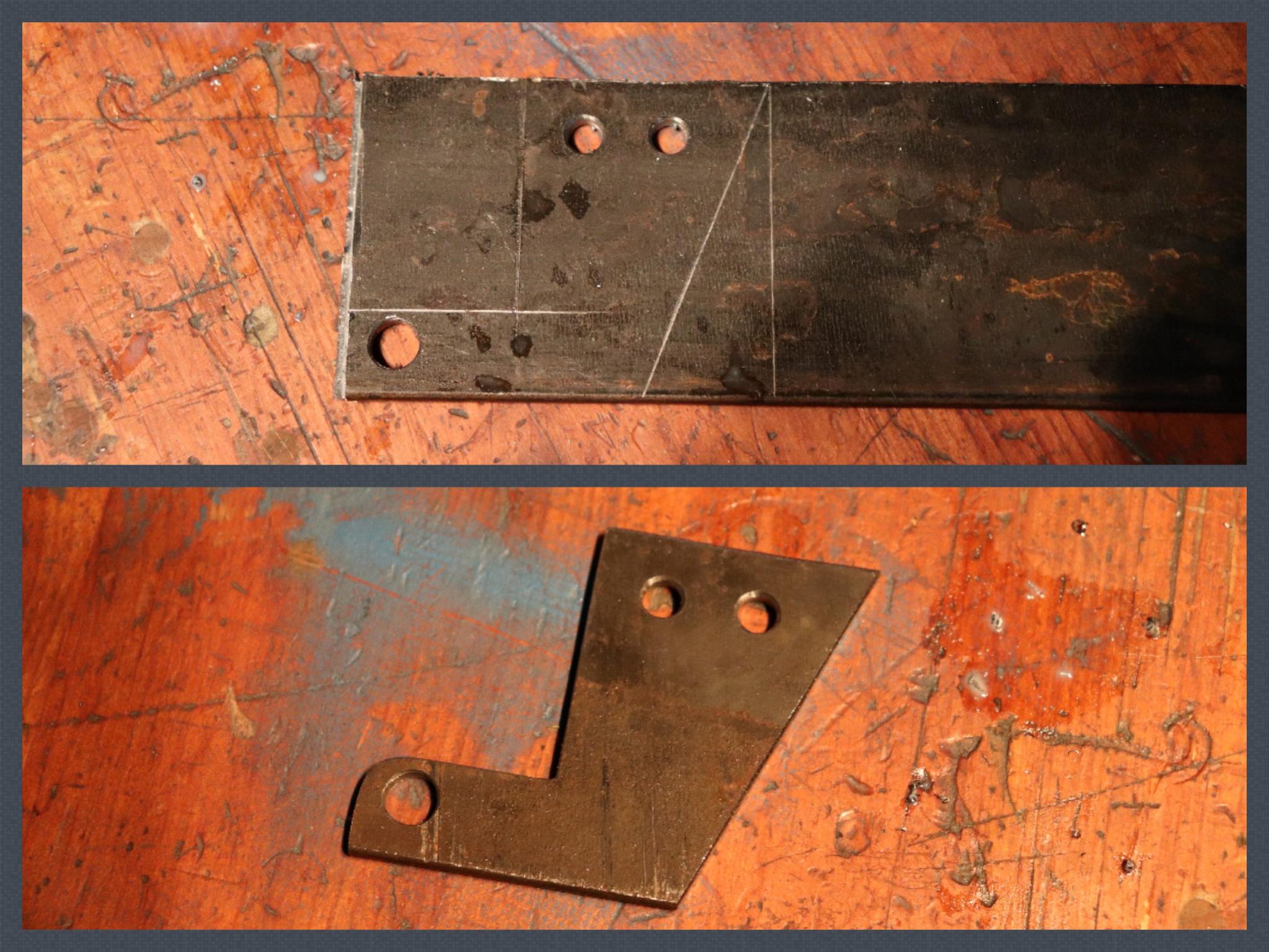

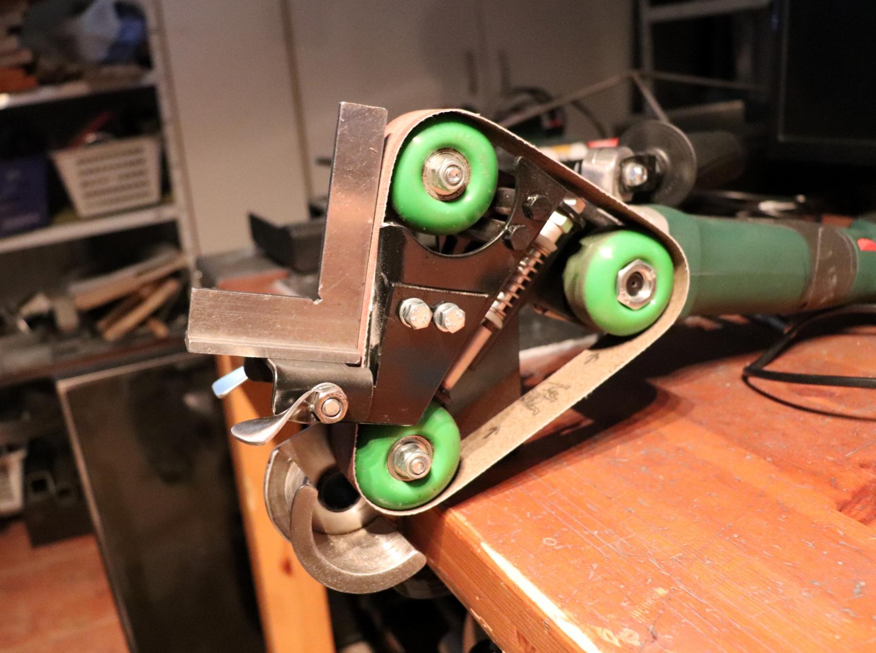

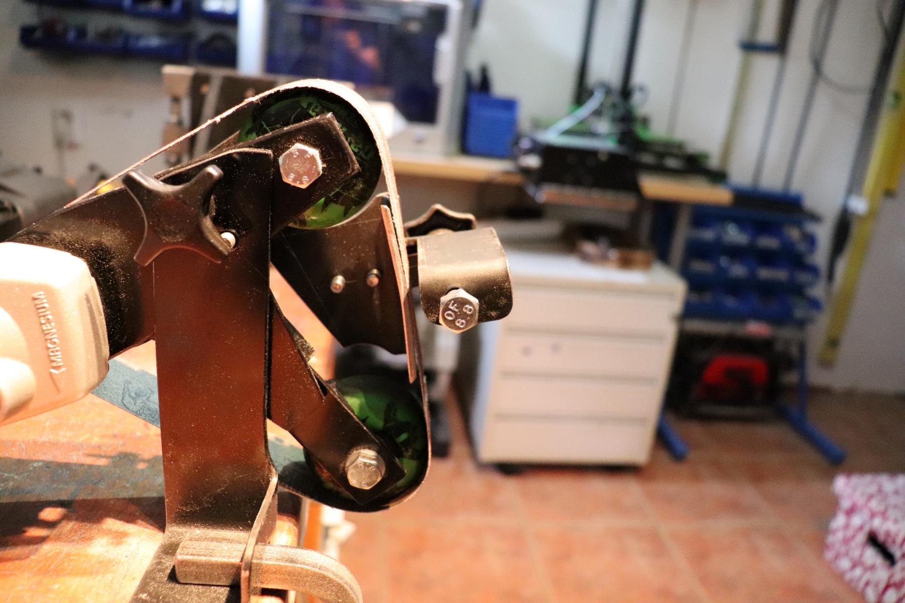

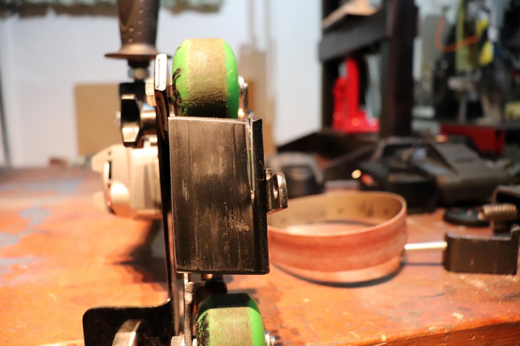

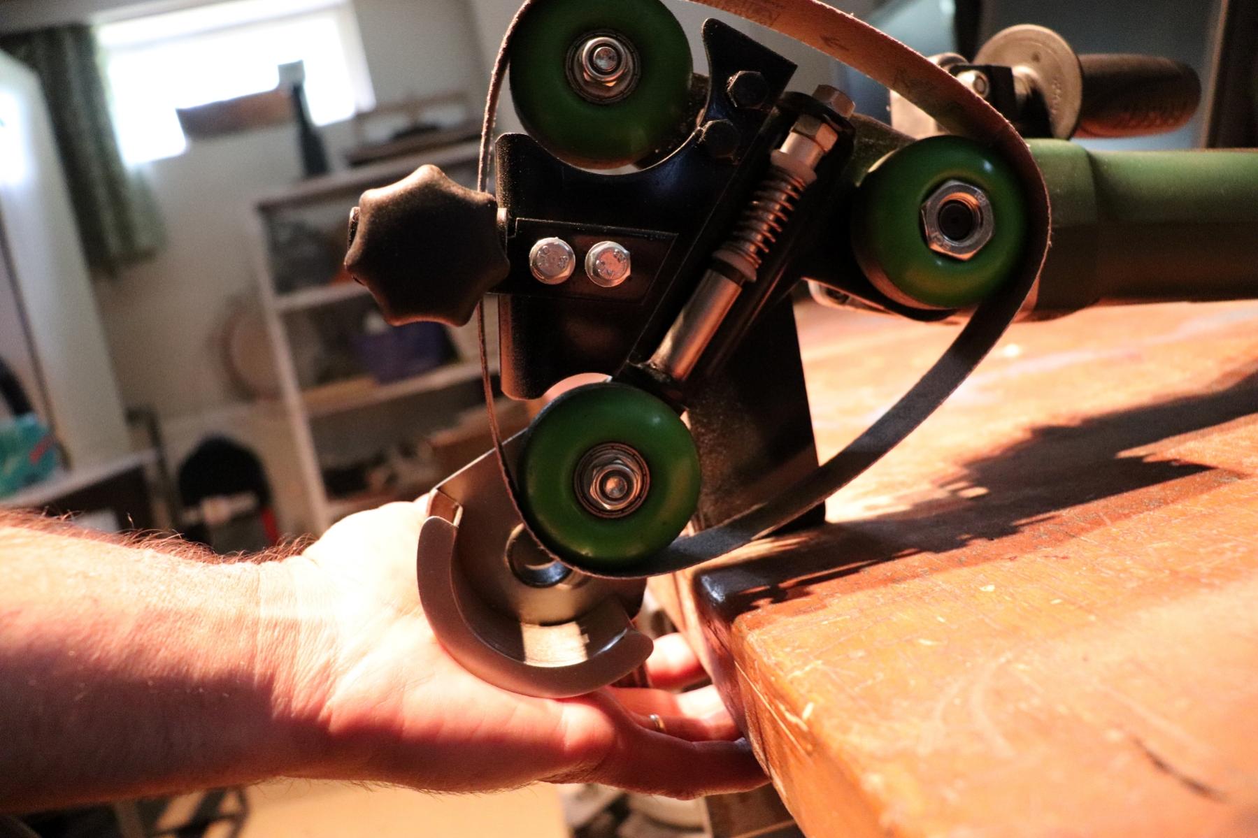

    Little fix..
    Smoother joining between belt and fasing.
    Little cut to the upper part of the facing, then bend.
    Edge chamfered and cut to tilted line.
    Removes claceti claceti noise when belts seam hits to the facing.

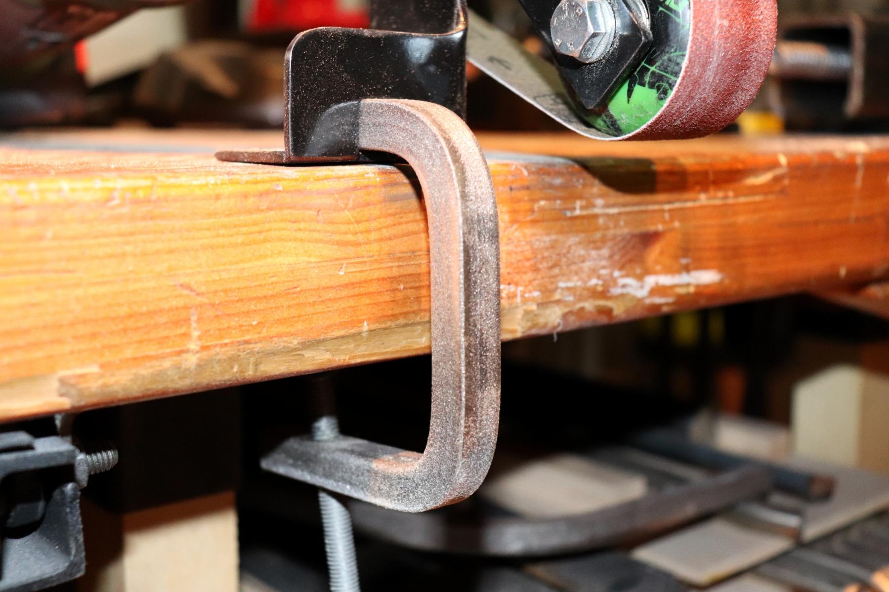

    Also this was asked. How clamp connects to stand.

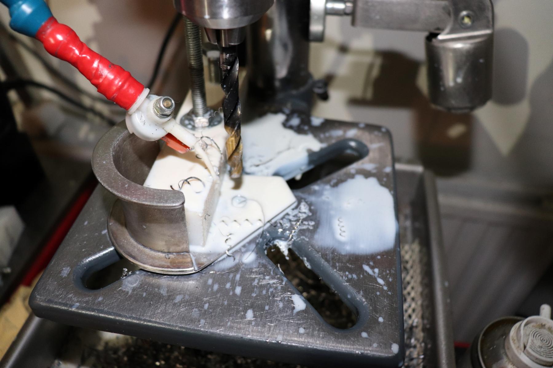

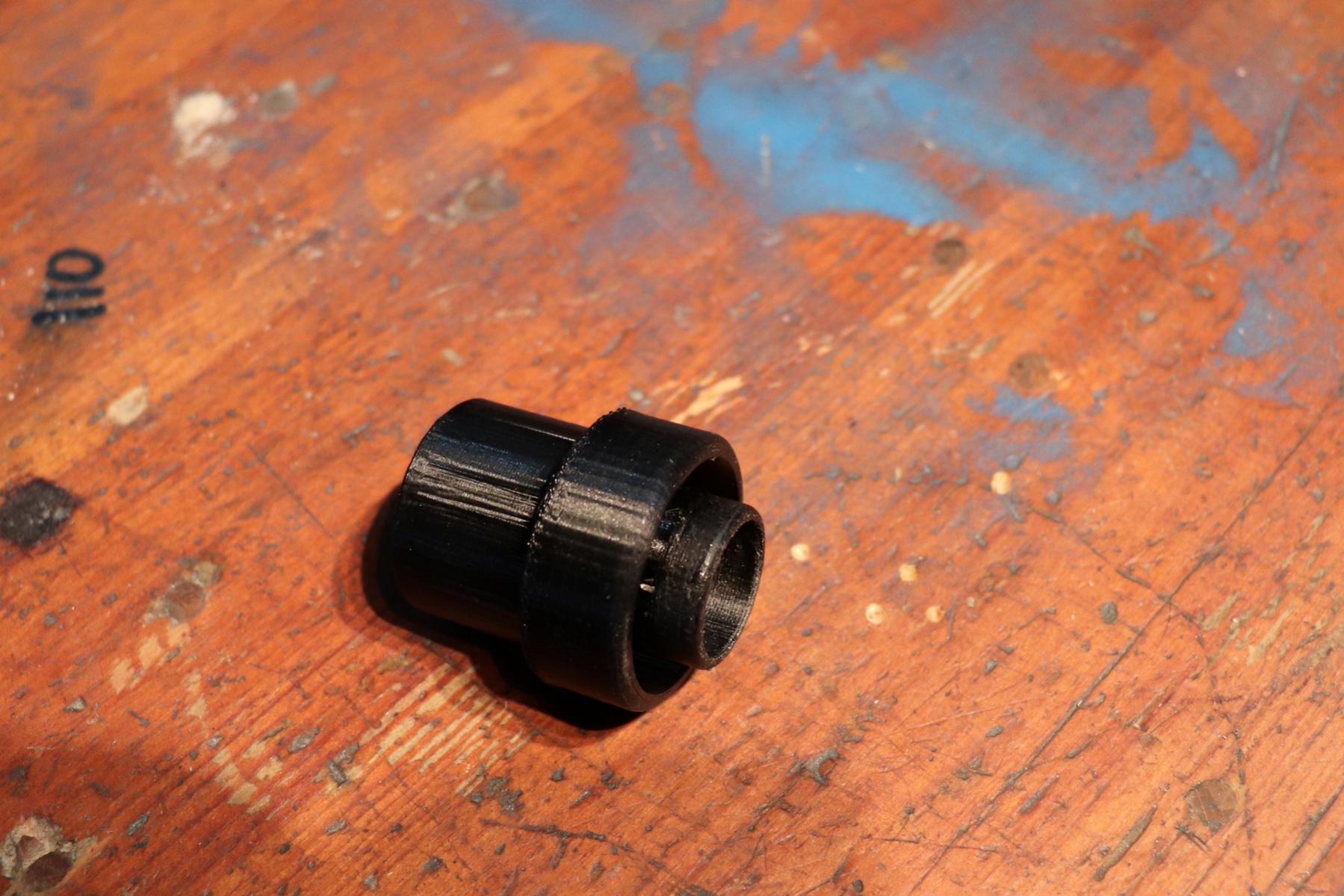

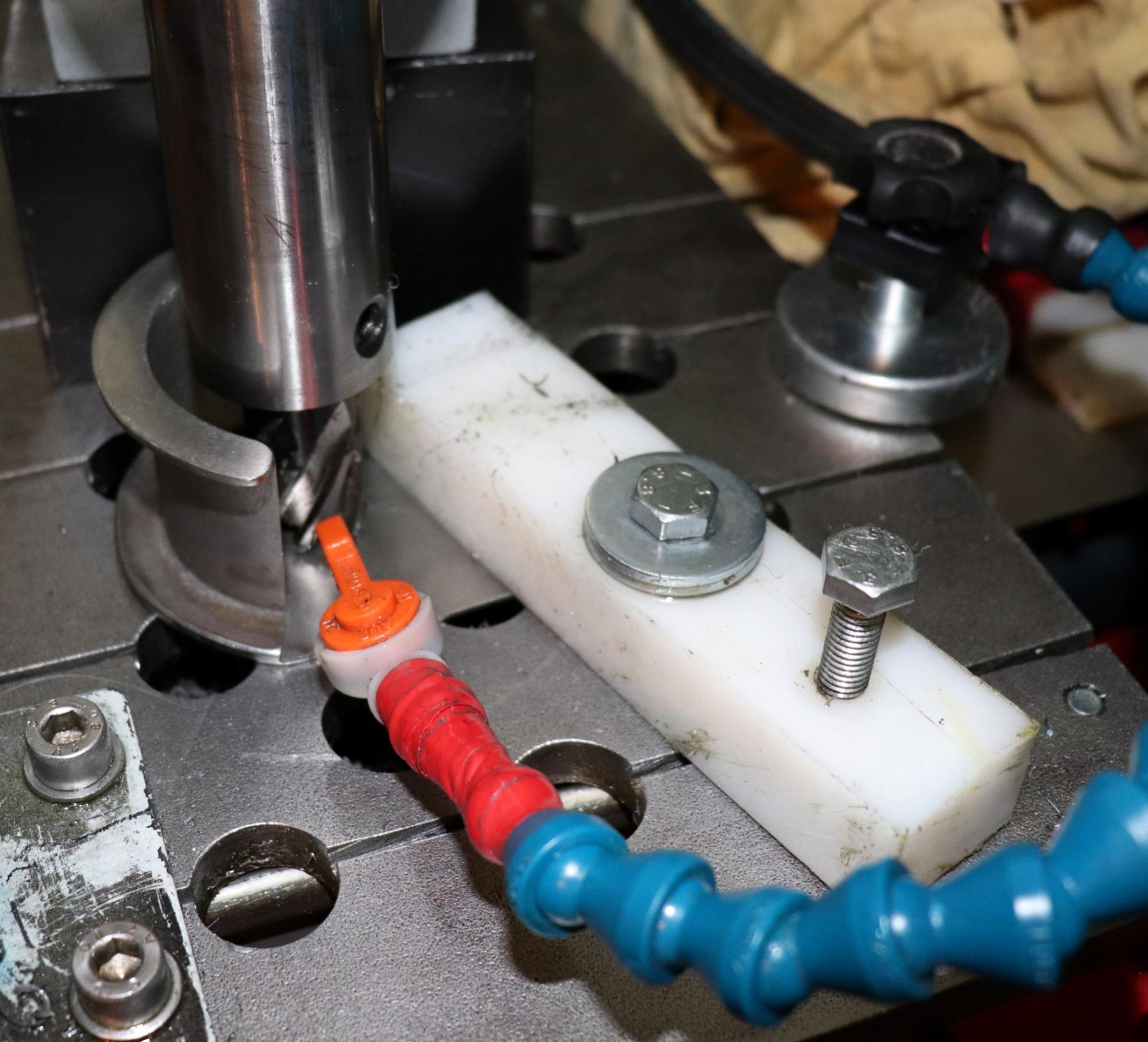

    Dust collector..
    Dust collector is made from stainless steel.
    Curve is cut from the 60mm pipe, three plates are from 2mm thick sheet.
    Welds are made with tig, all welds are placed to the edges, that gives nicer looking final result. ( no disortion )
    Pieces are cut with angle grinder.
    22mm hole at the center point of the curve is drilled with cutter blade.
    8mm hole that connects dust collector to the sander is done with 8mm twistdrill.
    3D printed connector for vacuum cleaner.
    And its ready.
    Shape is designed for to be "nice" for the hand, loosening belt for changing can be done by pressing from the dust collector.

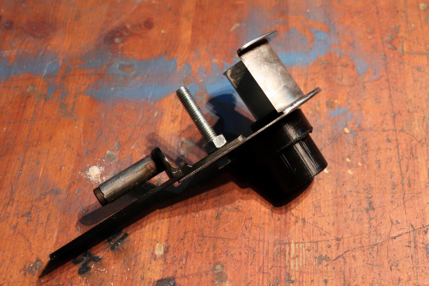

    And last improvements... Now it should be ready.

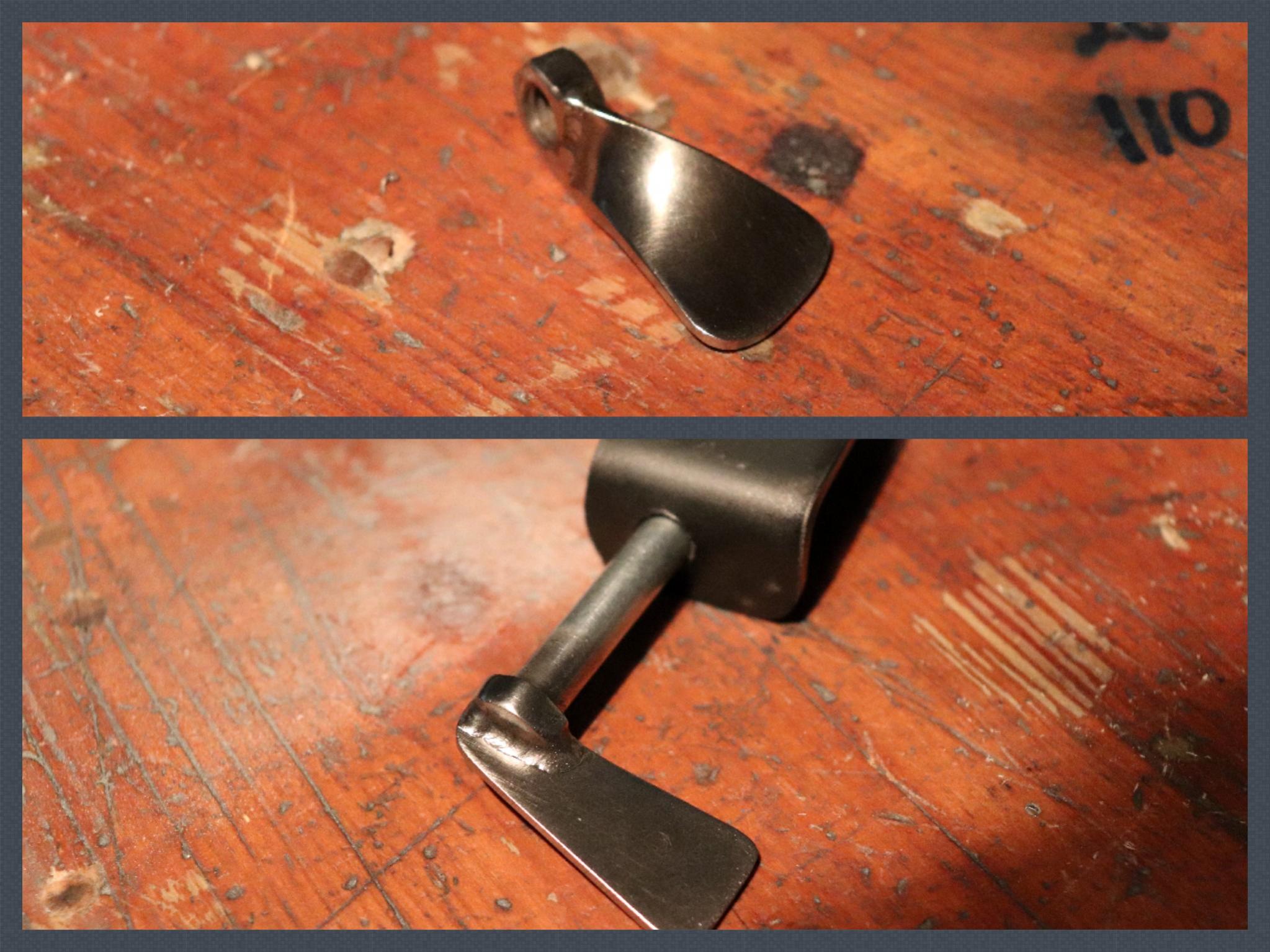

    New holder for the workpiece rest..
    To keep sander tool free, i weld pieces of 2mm stainless steel to bolt and nut that holds the rest.
    I weld little bigger plate pieces to the nut / bolt first.
    After that i shaped wings to desired shape, finally clamped nut to the vise and twisted wing with wrench.
    Then i polished welds with steelbrush.
    Result is larger right angled grinding area and tool free adjust for the rest, keeping sides of the rest clear.
    Thanks for checking this.

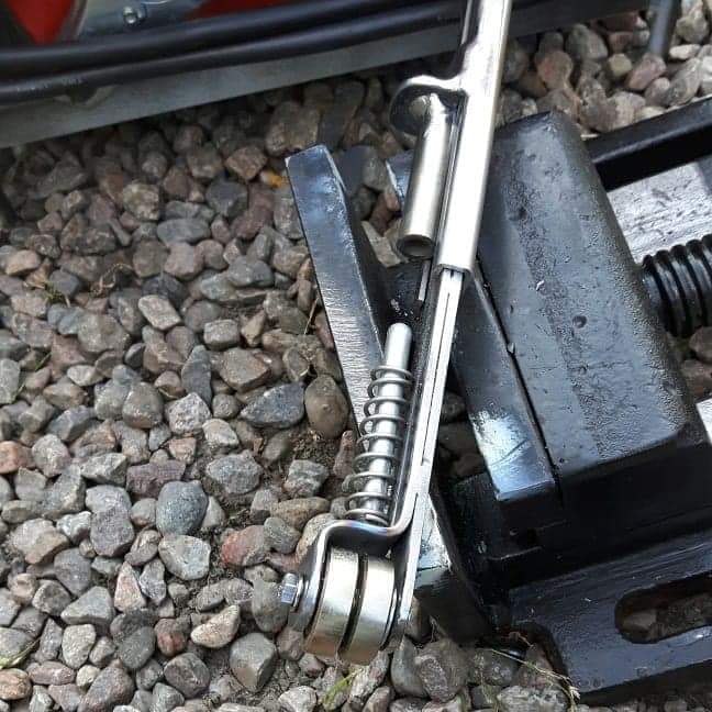

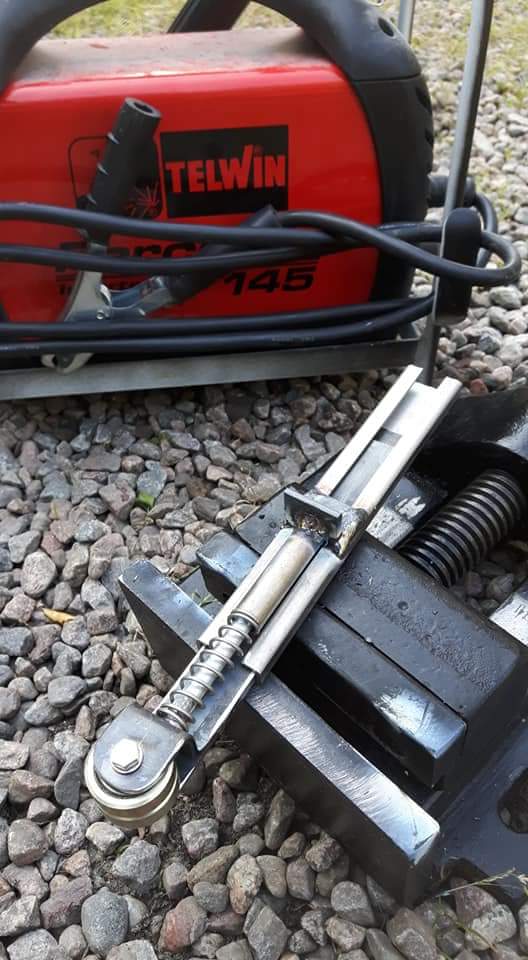

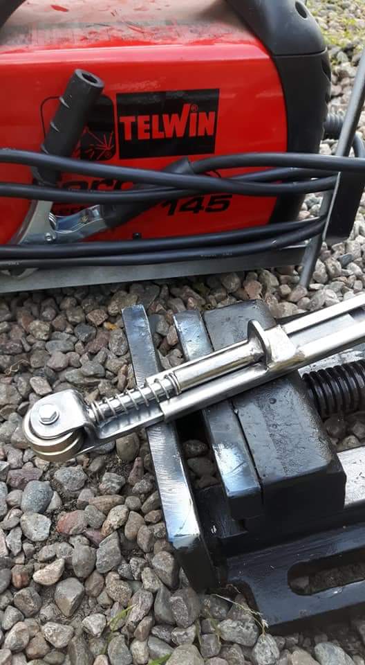

    Tension system for powerfile attachment.
    Mounting for angle grinder will be similar with pipe sander attachment.
    Welds with stick using 1.6mm rod
    Angle grinder pipe sander attachment. - quick mount --fb_img_1533007359663.jpg
    Angle grinder pipe sander attachment. - quick mount --fb_img_1533007366105.jpg
    Angle grinder pipe sander attachment. - quick mount --fb_img_1533007373150.jpg
    To be continued...
