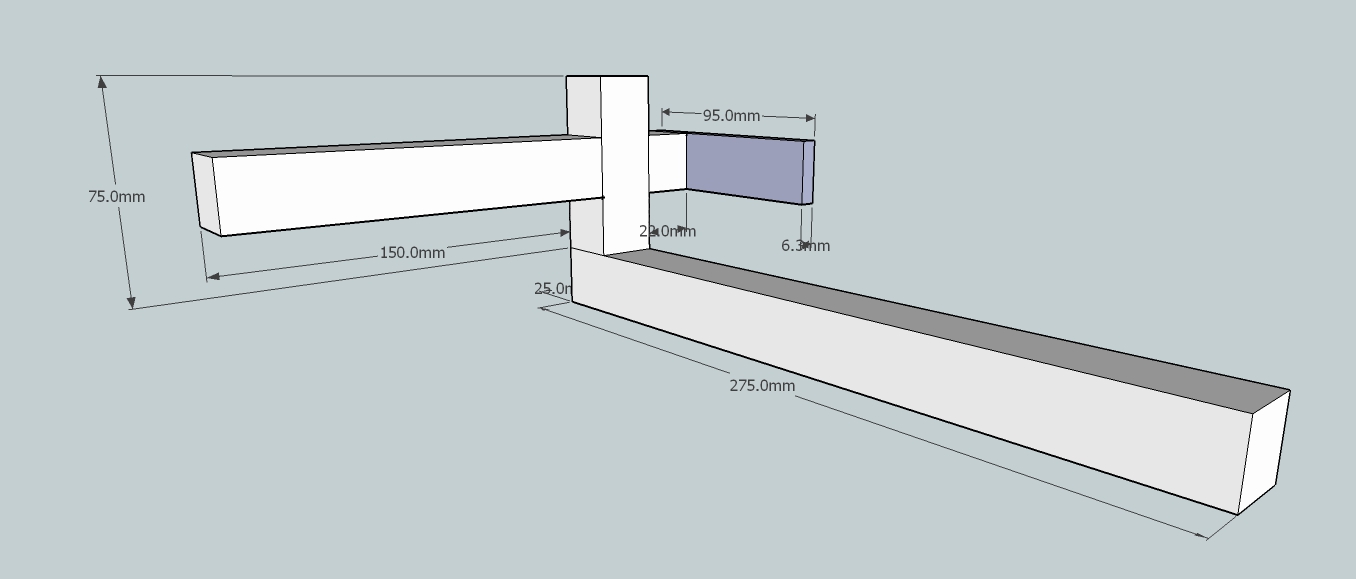

    Last summer I've made, in my opinion, useful bracket for my Kobalt angle grinder
    after using it for a few months I made a small modification
    I would be interested to know if you see any Pro & Cons
    P.S. This is my first post in this forum.

    That bracket looks good, apart from providing a solid mount for the grinder.

    Nice idea, I was wondering about using a sanding disk on my grinder in a similar manner

    Nice Grinder Project
    ok... I gotta hand it to the Russian Dude...
    That's clever as shyt... It is a very cheap Bench grinder, and you repurpose a unit, that is not used very often, unless you're a machinist or a steel working working on a hull
    Very clever indeed. All is needed is a additional bracket, with a pivot point, and you have a mini benchtop cut-off saw...
    ...... nice addition with the cut off plate, I would have probably secured it to the bar, with screws from underneath. Some 1.5" long screws, with large wing nut heads, or nice ones with large handle knobs...would suffice.

    The drawing
    The drawing of the bracket.
    Please keep in mind that this drawing is done for a Kobalt angle grinder Item #: 461797 | Model #: 9815 available at Lowe's store or at http://www.lowes.com/

    Adds some nice and versatility stability to the grinder. Might want to use some locking pliers or a small drilling vise to hold metal parts you are cutting. Your fingers get pretty close to the cut off disc in the second video.

    Quote Originally Posted by kismet gene View Post
    hi i would like to know if there is any way i could purchase a copy of a drawning for making a bracket for a 4"grinder
    simply click on the picture above and save it

    With safety in mind I made a small but an important change
    the opening for the cut-off disk was way to wide so I weld it shot and cut a new opening
