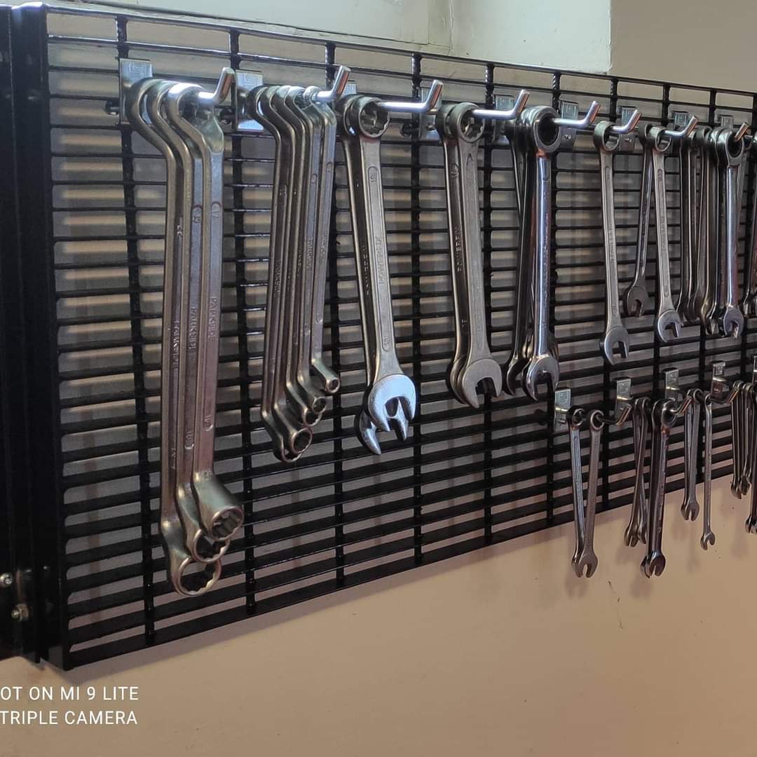

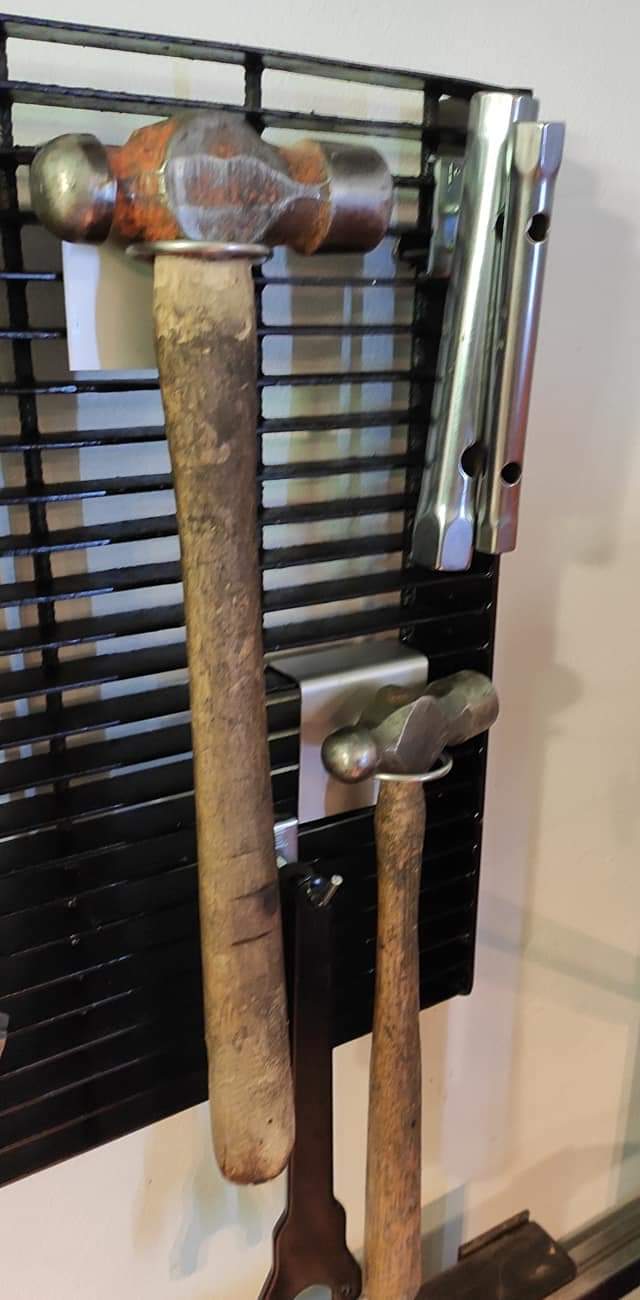

    There is many kind of pegboards on the market.
    Here, most used ones are with a square holes.
    There's many kinds of hooks available with this square mounting system.
    Hooks are somewhat fairly priced, good enough quality too.
    But those pegboards, are somewhat expensive, if you want to get sturdy one. Example: https://m.motonet.fi/fi/tuote/801058...utaulu-1800-mm

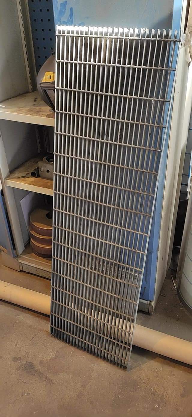

    So i decided to use alternative.
    That is repurposed recycled grate.
    Here its called " stepping grill "

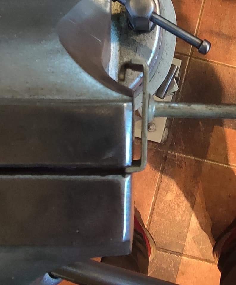

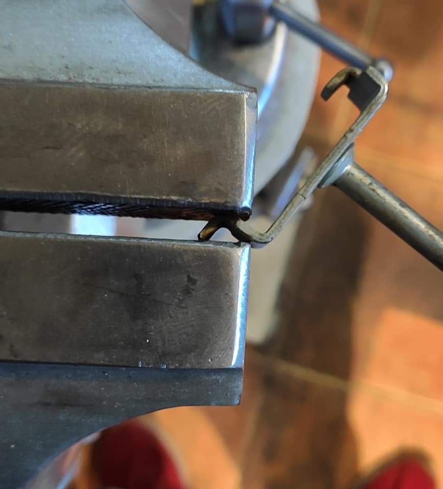

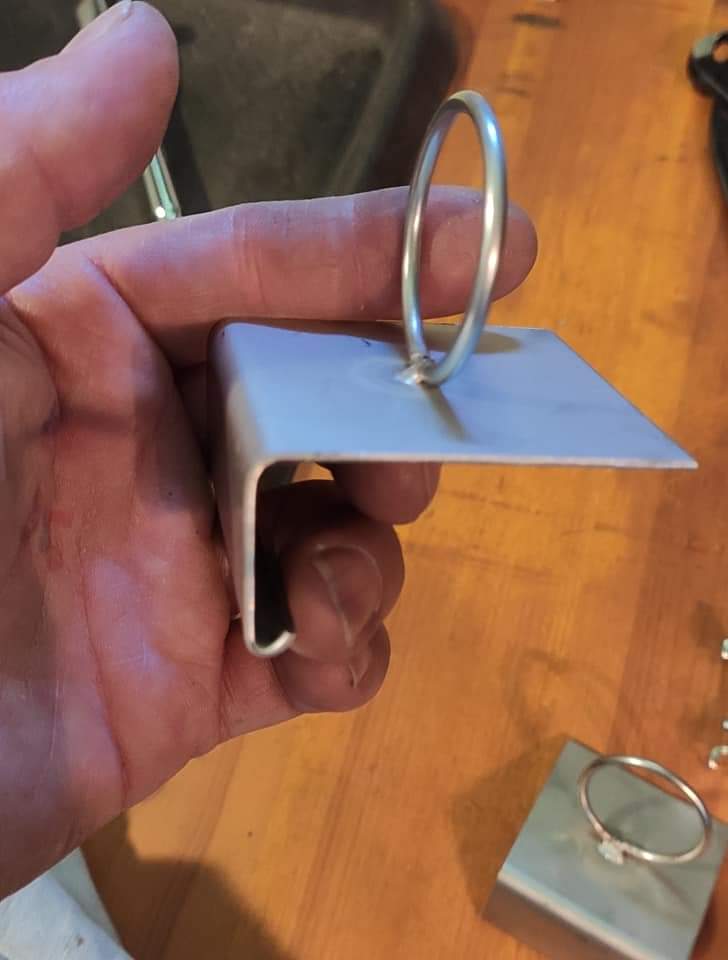

    Simple modification for the hooks.

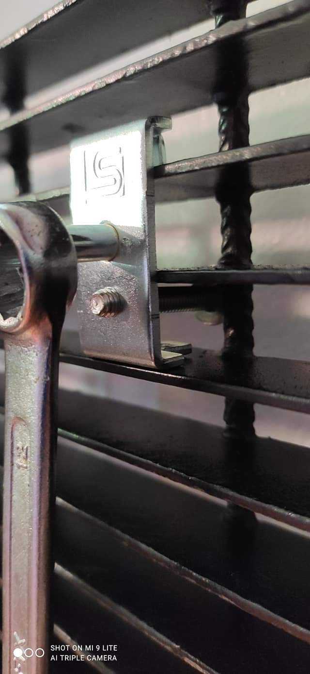

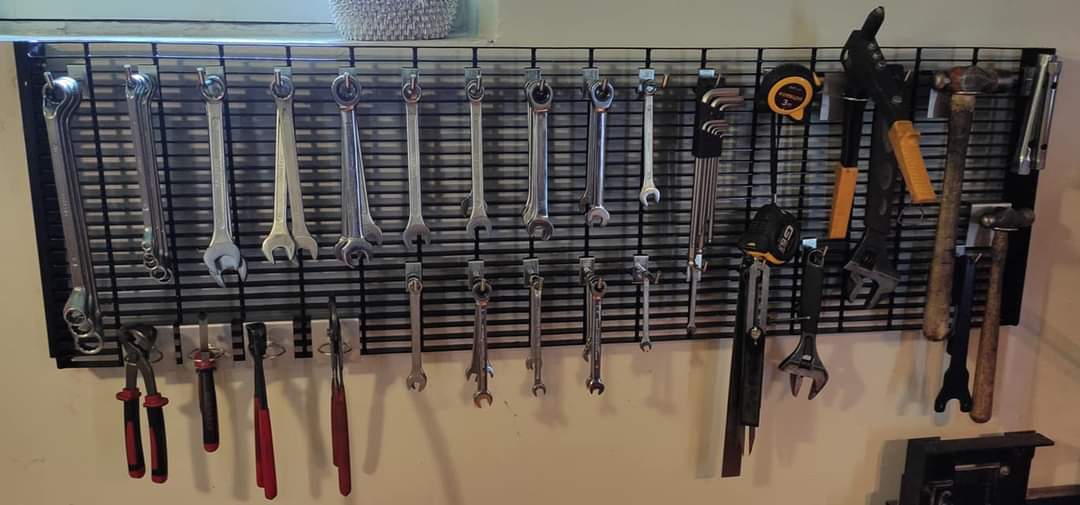

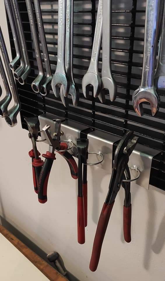

    And some diy ones..
    With 50$
