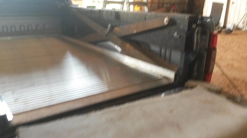

    What is the overall width length and weight of your creation if you don't mind my asking.
    because I have an idea

    Ok thanks I was thinking about my patented telescopic cargo lift that mounts in the bed of a pickup or can be made wider for a flat bed application the platform telescopes out horizontally just like a drawer in a tool box then the platform lowers to the ground remaining flat.
    For an application such as this the operator could ride his Tracked ATV onto the platform then roll his wheel chair right off, raise and retract into a trailer or on the flat bed truck. If his vehicle is similarly equipped for the mobility impaired he can go anywhere any when on his own, dependent upon no one
