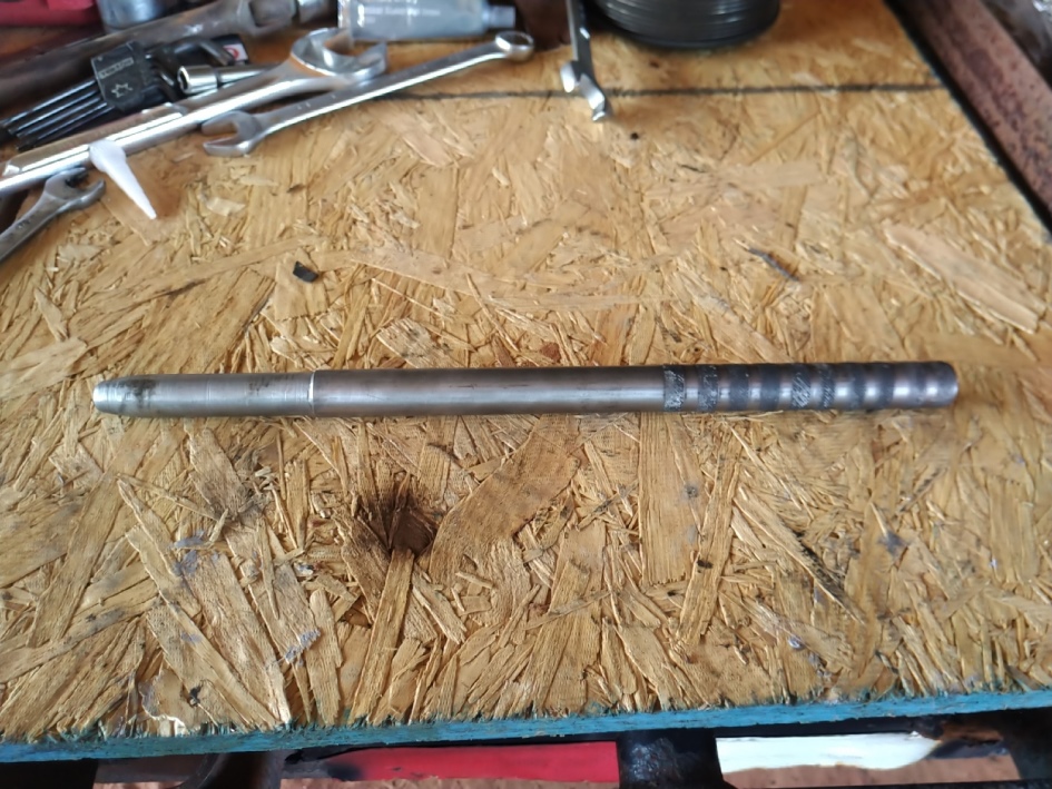

    The other day I was replacing all 3 motor mounts on a Mack truck, there is always a lot of drama involved in doing this, no matter the make of the truck. Some worst that others. With this particular model of Mack the only real drama is being able to get to the mounts or getting the old ones out of the truck once you manage to get the bolts removed.
    Reinstalling them is hardly any less tedious. Once you have one bolted to the frame it is time to lower the engine back onto the mount then drop the 2 long bolts in an tighten them up. However on this model as well as many others there is usually a spacer block to position the engine at the correct height these are doweled to the mount and sometimes to the matting support on the flywheel housing by a single dowel either on top/ bottom or both, During installation these blocks can rotate slightly or the engine can shift just enough to prevent the bolts from passing through all corresponding components.
    To assist in alignment the best thing is to pass a drift through them, the drift needs to have a long enough straight shank near to the hole diameter with a slight short taper to bring everything in alignment, this is especially true when aligning multiple components whether a motor mount or structural steel
    here is my alignment drift for this application.
    I slightly knurled one end to identify it as a tool and not just some machined piece of stock to be later forgotten what it had been made for

    Very nice idea. I’ve rounded the ends of bolts to make them easier to start. It definitely works. Thanks.

    Quote Originally Posted by mdhatter3 View Post
    yep been there as well.
    In this case I actually had to use 2 drifts to get the mount to align up enough to start the bolts, but 1 of the drifts was just a piece of round stock with a slight champer that I drove up from the bottom as it pushed the tapered drift upwards then put the drift in the other hole once both holes were aligned the mount stayed in place.
    After 1,157,980 miles the old mounts were bad enough to have allowed the torque of the engine to shift in the frame about 1/8" and had settled 1/4"
    The mounts hadn't failed and would probably last another 10 years if on a stationary engine mounting like a generator or a water pump, but they were to a point of beginning to allow the transmittal of annoying vibrations through the truck

    When a long taper aligns holes (usually 2) it is a drift pin/ punch, usually termed by mechanics. Iron workers use the idea, but call it a spud. Their heavier version is a bull pin; headed for striking with a hammer. The tool is shifted around so a fastener can be inserted in adjacent position. After one hole receives fastener, the remainder are closer yet to alignment.
    When a near full size pin awaits fasteners, it is a slave pin/ punch. This is a particularity on pivoting members. A drift doesn't achieve very good axial alignment, compared to a cylinder.

    Hence the name drift punch much shorter than drift slave pin or drift slave punch
    Oh yes and you forgot the iron workers weevil bar usually a cylindrical or hex bar about 29 to 36 inches long from 1 1/4 to 1 1/2" in diameter 6 to 12 inches taper on 1 end down to 1/2" with a dog knot or a collar about 8 inches from the other end to keep it from slipping out of the ring on the tool belt.
