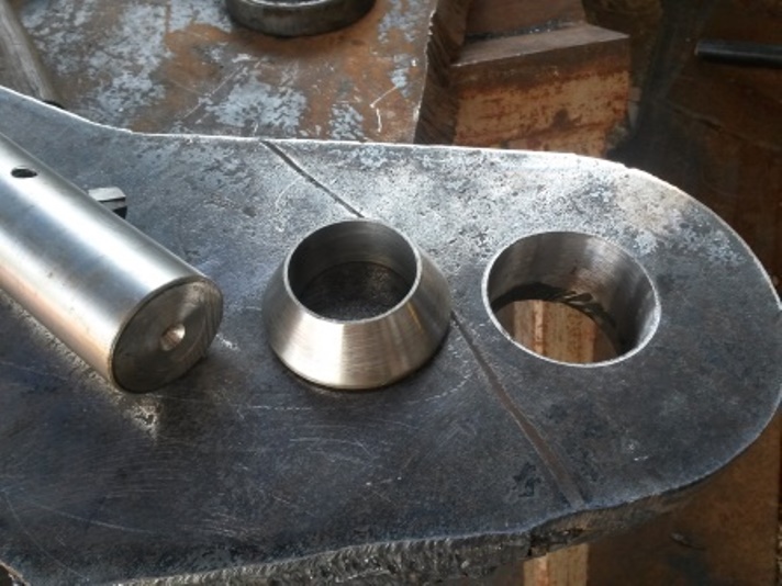

    I am needing to bore the 1" plates I am making for my folding break much larger than I was previously planning on doing .

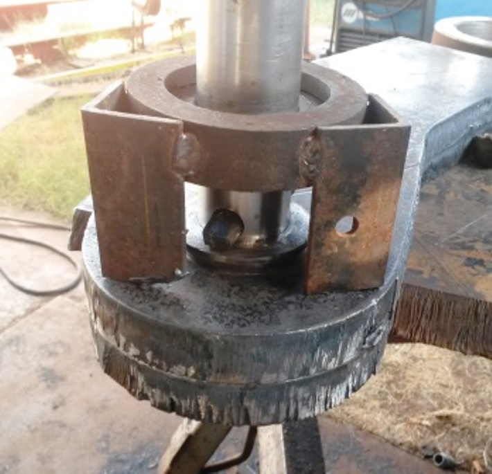

    The boring head for the mill was doing a fine job but I am too impatient to bore at a .005 to .010" at a time through the 2" of hard steel in order to take the bore form 2.300 out to 2.625" this is why I made the boring bar yesterday and today after we got back from town started making a pair of alignment cones. these will be used to center the boring bar to the bores in the plates then I will tack weld the stabilizer bearings to the plates. This will be a little tricky as I need to set this up in the mill get everything square then tack the bearing stabilizers in place to insure the boring bar is perfectly perpendicular to the plates. I will probably do a mock set up on top of a sheet of steel on the mill table to protect it

    That's simple just follow my threads as I post them the next thread http://www.homemadetools.net/forum/set-up-block-63032 shows them in use. They are only needed for setting up and locating the center of a bore to be bored out Since I am only having to bore the 2 plates stacked together set up is fairly straight forward care must be taken to make sure the bar is perpendicular to the plates which would be much easier when dealing with a fabricated part where the plates are say a foot or more apart like those of a backhoe bucket or the bearing locations in the boom but the concept never changes a pair of well fitting tapered cones on a cylinder pased through a bore or pair of bores will locate the center or said bore

    THe alignment cones worked perfectly in assisting setting up the boring bar and stabilizing guide bearing as when I did the set up on the mill there were no adjustments required the quill freely went up and down a good sign that things are aligned up well after the work piece is clamped down I even allowed the quill to raise high enough to lift the boring bar out of the bottom bearing then returned it with no issues
