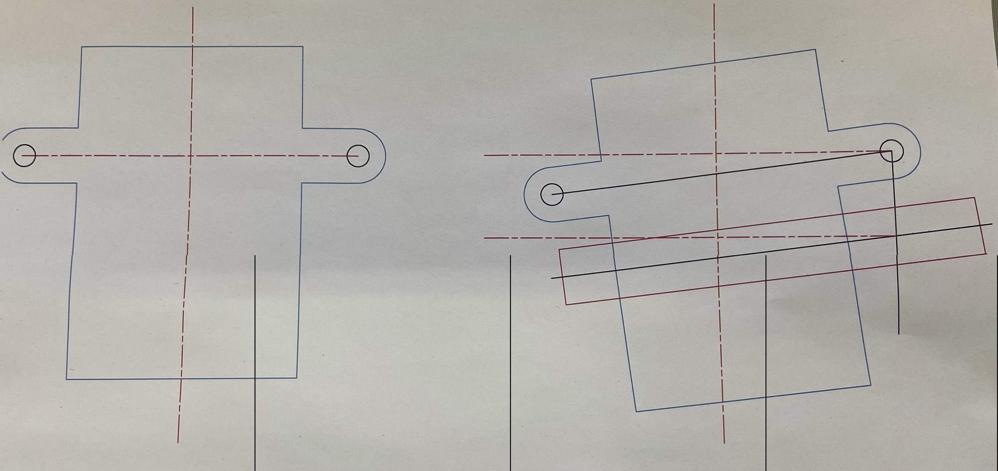

    Quote Originally Posted by thehomeengineer View Post
    Hi Rick
    Thank you for your reply.
    I am unsure of the bolt you mean? "You have the good fortune of having a bolt hole aligned with the front face of that bar." the bolt doesn't effect the method as the angle from the pivot point remains the same no matter where the parallel sits in the vise. The only thing that changes is the starting point of the dial test indicator (DTI) will be further from the pivot, but the vise misalignment angle remains the same.
    The picture below will hopefully clarify this method.
    Attachment 41935
    As can be seen the axis error is constant no matter were the parallel sits in the vice and as long as the DTI is roughly over the centre of the locked down tee nut side of the vise (pivot point). The clock displacement once moved of this point is the amount the vise is required to be moved, to align, to the axis it is being set too.
    Many thanks again
    The Home Engineer
    Sorry, I had assumed your pivot point was on your jaw face. As explained in my article, having it off of this line does cause the left reading to change as you adjust the right reading. That drives me crazy.
    Rick
    Rick

    Quote Originally Posted by rgsparber View Post
    Rick
    As the vice I used in my video is on a swivel base I could have bolted the vice straight to the table and then simply adjusted the vice alignment by placing the DTI as centrally by eye on the fixed jaw.
    As the vice pivot point is directly centred to the base. This makes things a whole lot easier, by moving the table in either direction off this point the error shown on the DTI can be adjusted back to the DTI’s original start position. As this is then moving on a fixed dowel in the vice base there is little or no chance of the vice moving on the table.
    This is my preferred method but not everyone has a swivel base option. As this dowel is integral to the vice base this makes it even quicker to setup as there is no need for a parallel etc. and with no chance of moving on the machine table while adjustments are made.
    This is also very convenient for setting the vice to a known angle using slips and a sign bar. The sine bar and slips can easily be placed against the fixed jaw and as the vice can only rotate on the swivel base dowel the vice again can be quickly set to the desired angle using the same method.
    This seesaw effect about a fixed pivot is so useful for setting up anything on a milling machine and saves precious workshop time. But saying all that this is the only vice I have not put machine dogs on due to how quick and versatile this particular vice is to set up. All my vices with out swivel bases have machine dogs fitted for ease of location.
    To quote our friend Toolmaker51 “ As usual, more vice alignment methods than ways to skin a cat “
    I hope trying to align your vice in the future doesn’t send you crazy and what ever method you decide to use the result will be the same, a vice accurately positioned on the mill table.
    The Home Engineer
    The Home Engineer
    Ah, now it all makes sense!
    Thanks,
    Rick
