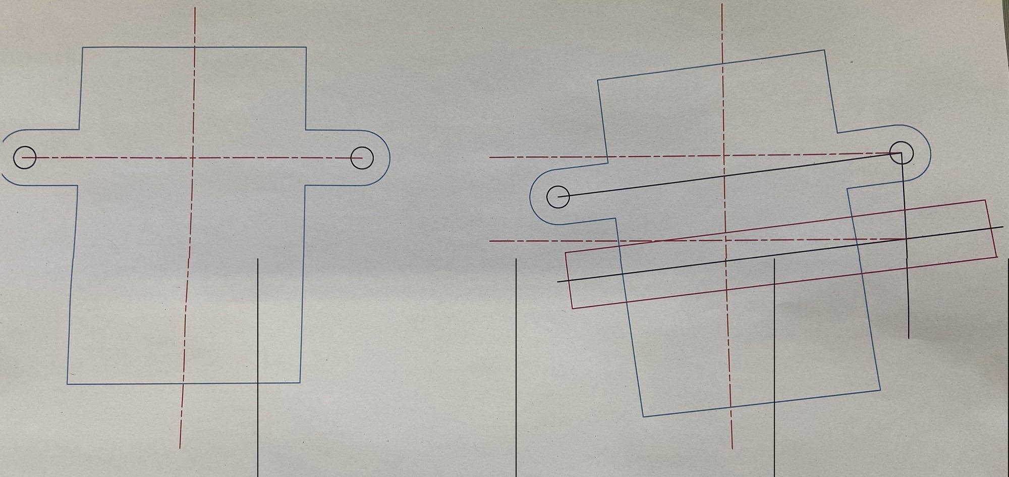

    But being a lazy engineer ( or just always trying to find the quickest way to get the job done ) Clocking up a vise can be achieved in seconds using two tee nuts/bolts thick washers, mallet, parallel and a clock and base.
    This is the method I use to clock up most jigs,fixtures,rotary tables, work pieces and vices. Works every time with next to no setup needed to achieve a perfect alignment to the desired axis.
    https://www.homemadetools.net/forum/quickest-way-i-know-how-clock-up-machine-vice-65939
    Hope this will be of interest and my videos are no way as good as yours but hopefully it will got across the idea

    Simple vise alignment
    Quote Originally Posted by rgsparber View Post
    You have the good fortune of having a bolt hole aligned with the front face of that bar. That makes all the difference. I do see that you picked up 1/2 thou of error from tightening the bolts. John Herrmann, a good friend of mine, suggested using spherical washers to prevent this.
    I have used a similar arrangement and had a problem with the vise sliding around the pivot hole. I added a close-fitting bushing which helped.
    Rick
    Hi Rick
    Thank you for your reply.
    I am unsure of the bolt you mean? "You have the good fortune of having a bolt hole aligned with the front face of that bar." the bolt doesn't effect the method as the angle from the pivot point remains the same no matter where the parallel sits in the vise. The only thing that changes is the starting point of the dial test indicator (DTI) will be further from the pivot, but the vise misalignment angle remains the same.
    The picture below will hopefully clarify this method.
    As can be seen the axis error is constant no matter were the parallel sits in the vice and as long as the DTI is roughly over the centre of the locked down tee nut side of the vise (pivot point). The clock displacement once moved of this point is the amount the vise is required to be moved, to align, to the axis it is being set too.
    Many thanks again
    The Home Engineer
