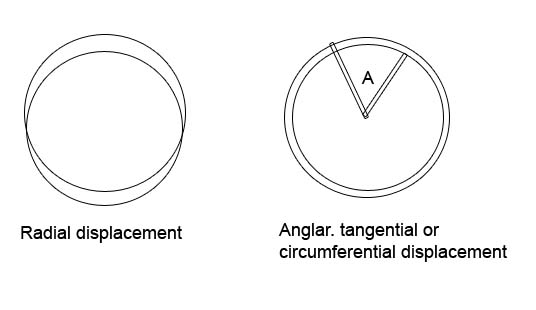

    Rick,
    Maybe this will clarify the usual terminology for the two types of displacement.
    Radially is ALONG a radius.
    Angularly, tangentially or circumferentially is an angular displacement "A" of any radius about the axis.

    Ah, then I am preventing radial displacement.
