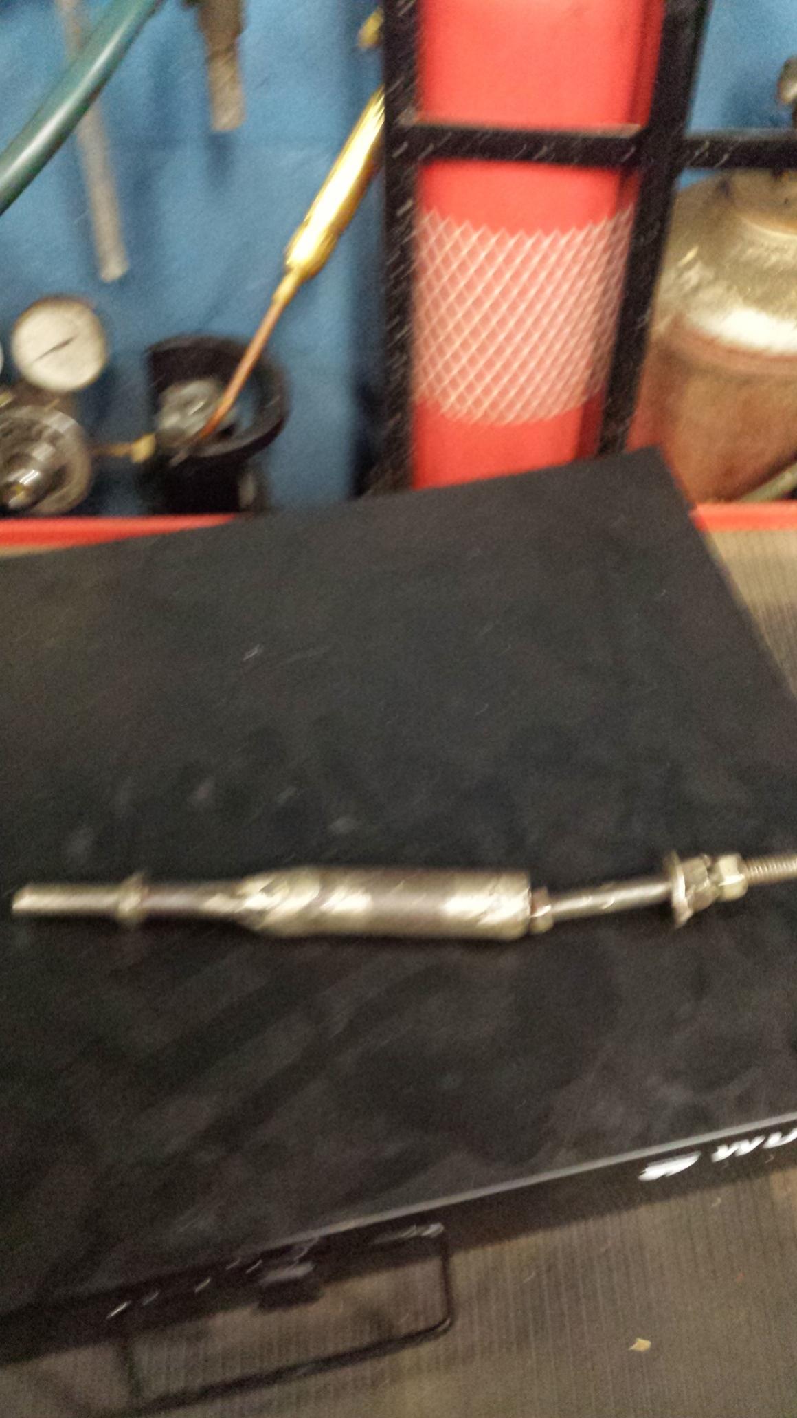

    I made this driver to knock out brake caliper bushings.
    It is simply a bolt nut and washer of the appropriate size welded together.
    It is driven by the home made driver which consists of a piece of pipe welded to an air chisel bit.

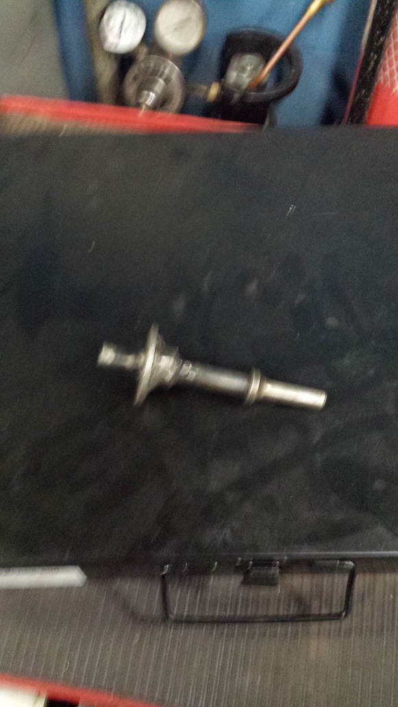

    The other one is a nut and washer welded to an air chisel bit and fits the aluminum bearing drivers, bushing drivers or 1/2" drive sockets.
