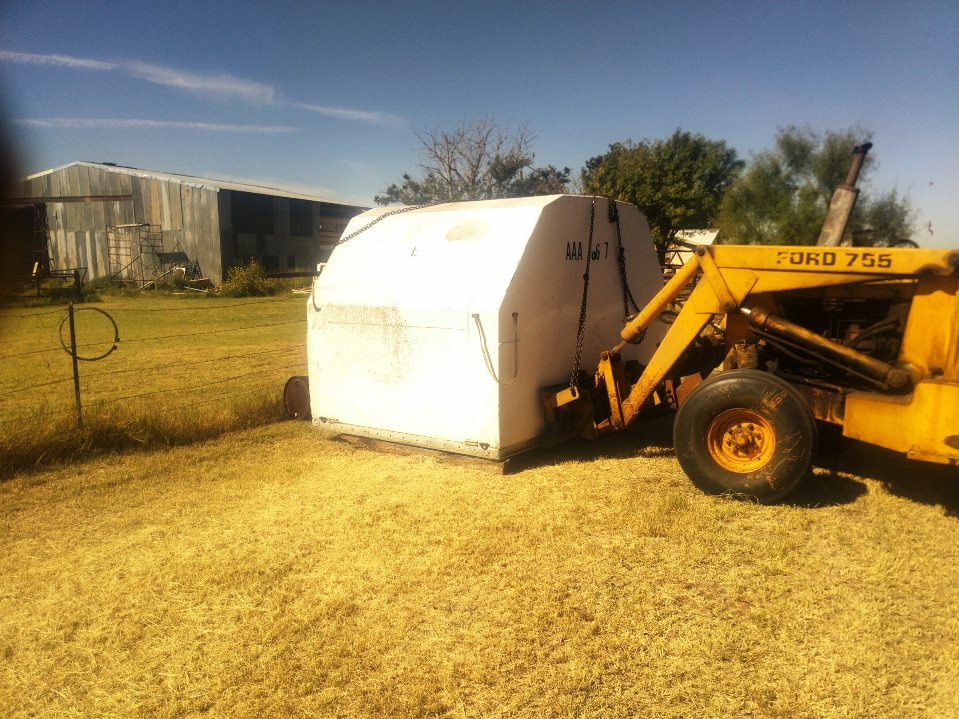

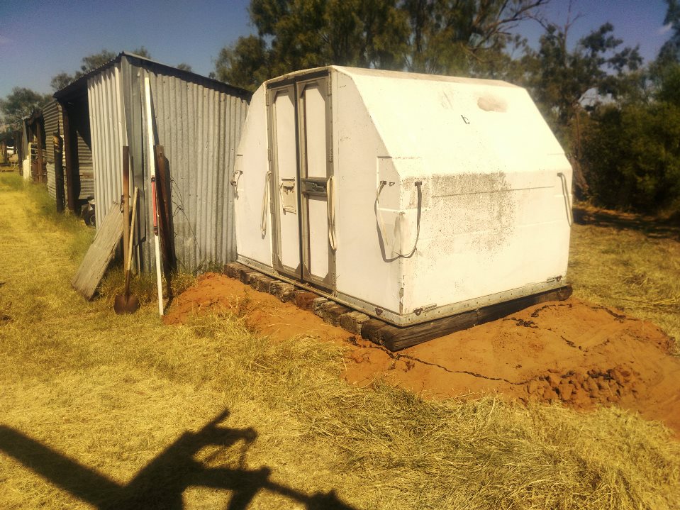

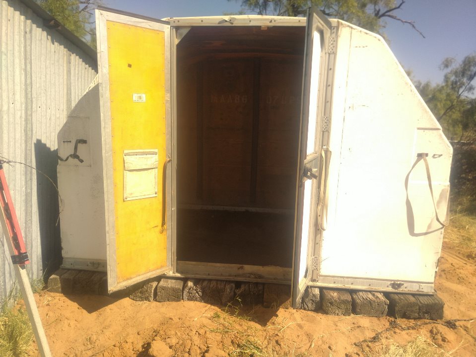

    This air cargo container has been in my way for 6 years. It wasn't much use for storing stuff in because there is no support under the 1/4" thick aluminum floor.
    Also I have part of a refinery set up to convert used motor oil into diesel or to make bio diesel out of vegetable oil but never had a good place to put it all together. the unit will require about 60 sq foot of floor space. So this morning while moving the cargo container out of my way for the umpteenth time in 6 years it suddenly went DING DING in my mind why not kill several birds at the same time

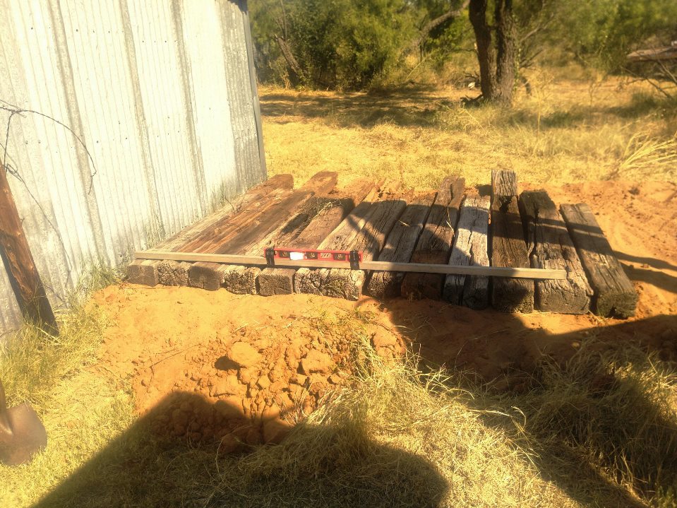

    I leveled of an area at the end of some existing sheds about 200 feet from the house by back filling with clay sand then to get rid of a bunch of useless old cross ties no longer suitable for fence posts from a couple of old fences I tore down yesterday.
    The cross ties were used to make a matt for the air cargo box

    Neil I have no idea what they would sell for this one was bought at an auction where no one had any idea what the potential of one could be I think I got it for a hundred bucks, but would have gladly paid 3 times that.
    The floor is 1 piece smoot 1/4" thick aluminum. Sitting on the cross ties I figure it will be more than suitable for what I intend to do with it since the refinery system will weight about 800 lbs once I refurbish and up grade from what I got with the 600 gallons of oil. The guy had about the crudest set ups I have ever seen undersized centrifuge dodgy filtration and inadequate heating leaky pumps and a very labor intensive way of processing. He could only achieve a dark brown diesel like fuel and in no way was able to make bio diesel out of used vegetable oils since there was no provision for a blending step.
    It might take me another year to put together a system I will be comfortable with to run the diesel in a later model pickup but what he had would run in an older farm tractor just fine or my 90's era pickups
