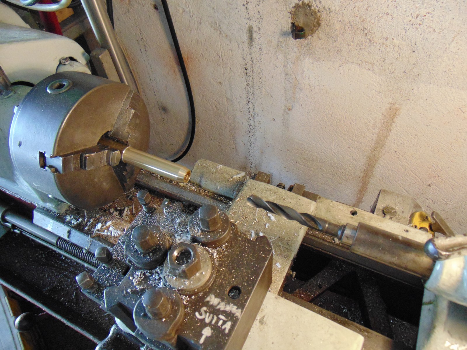

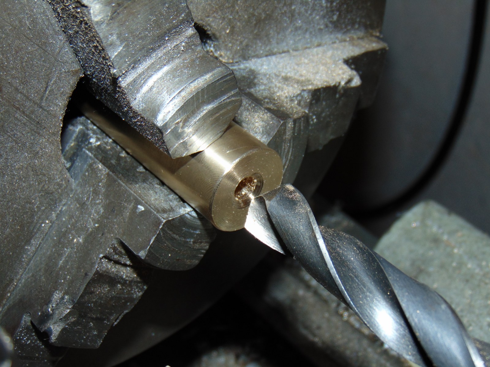

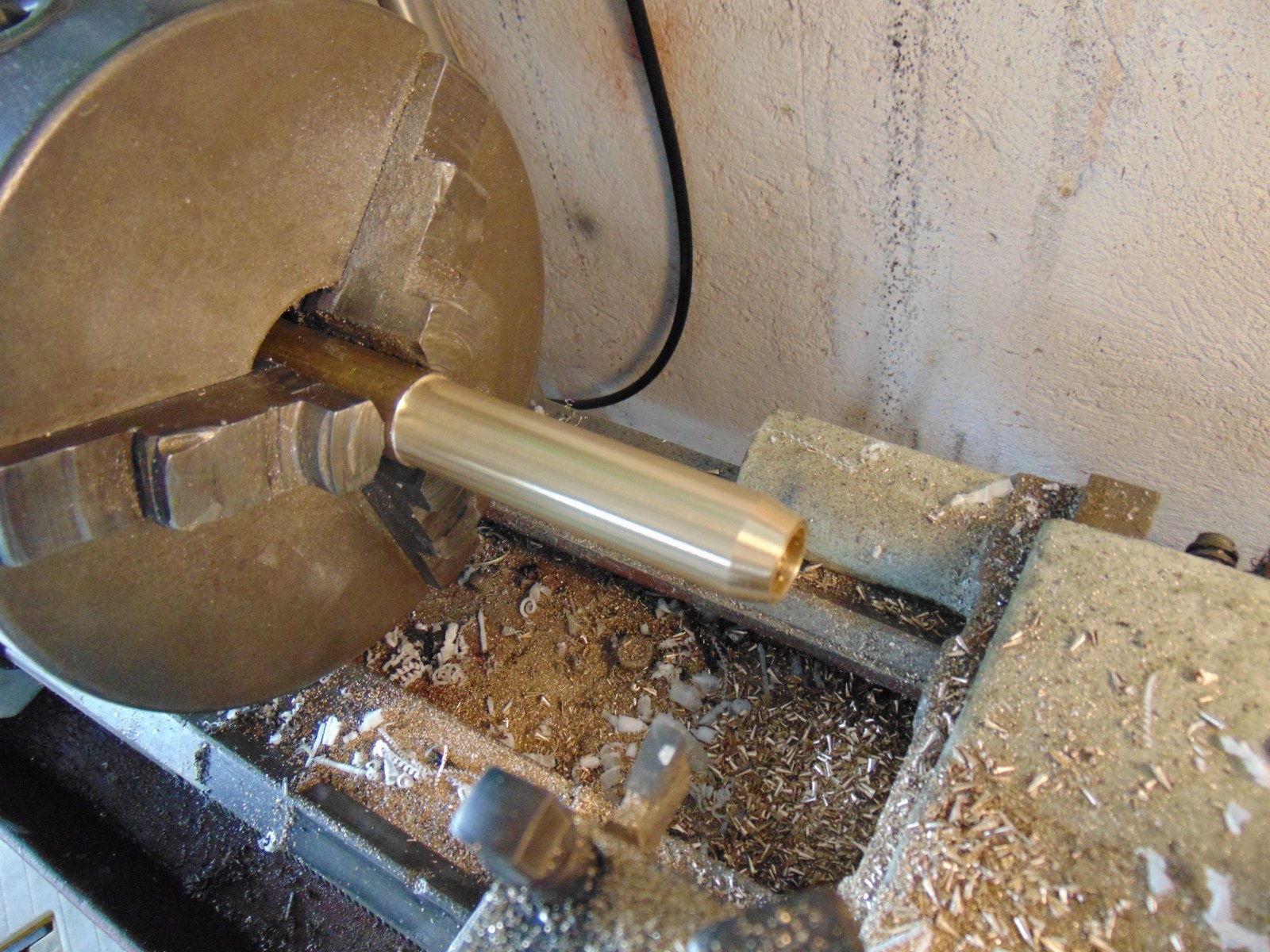

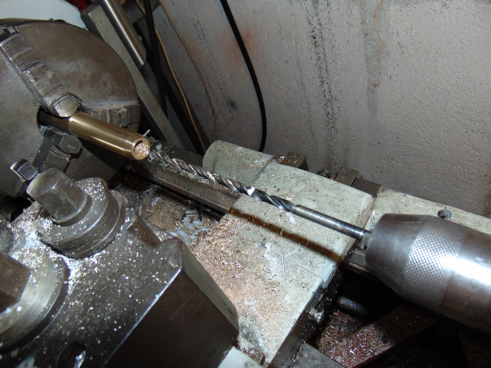

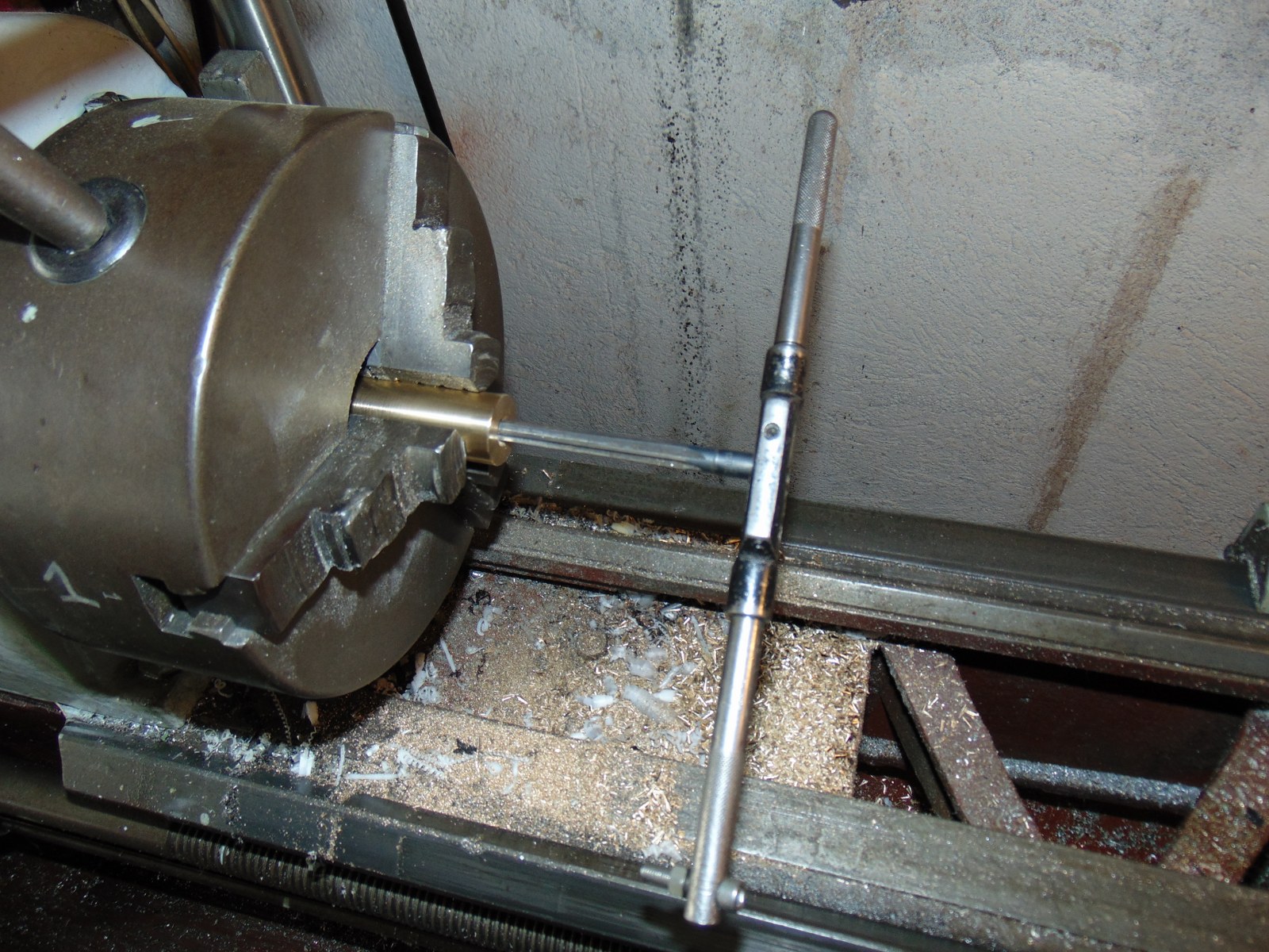

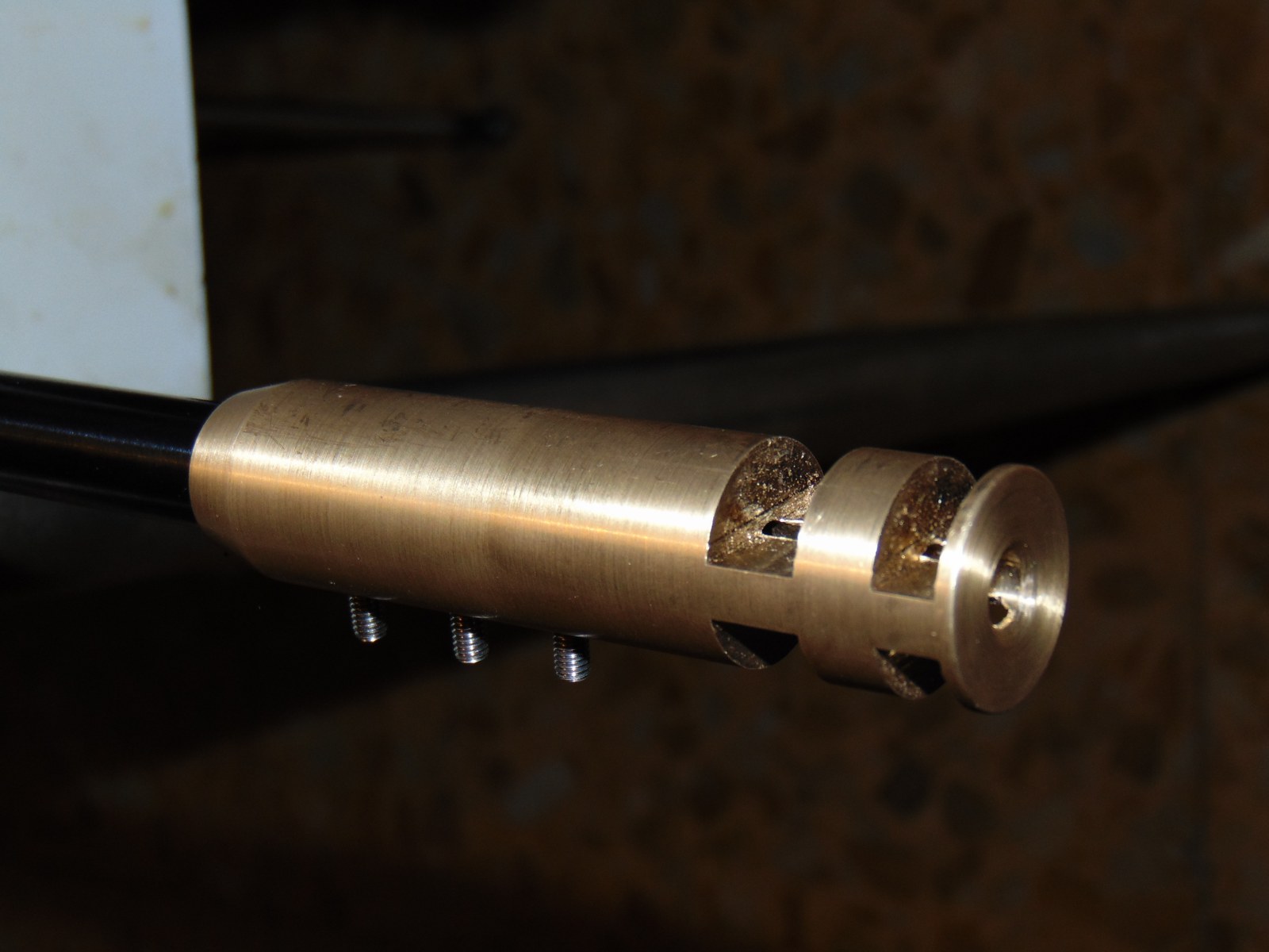

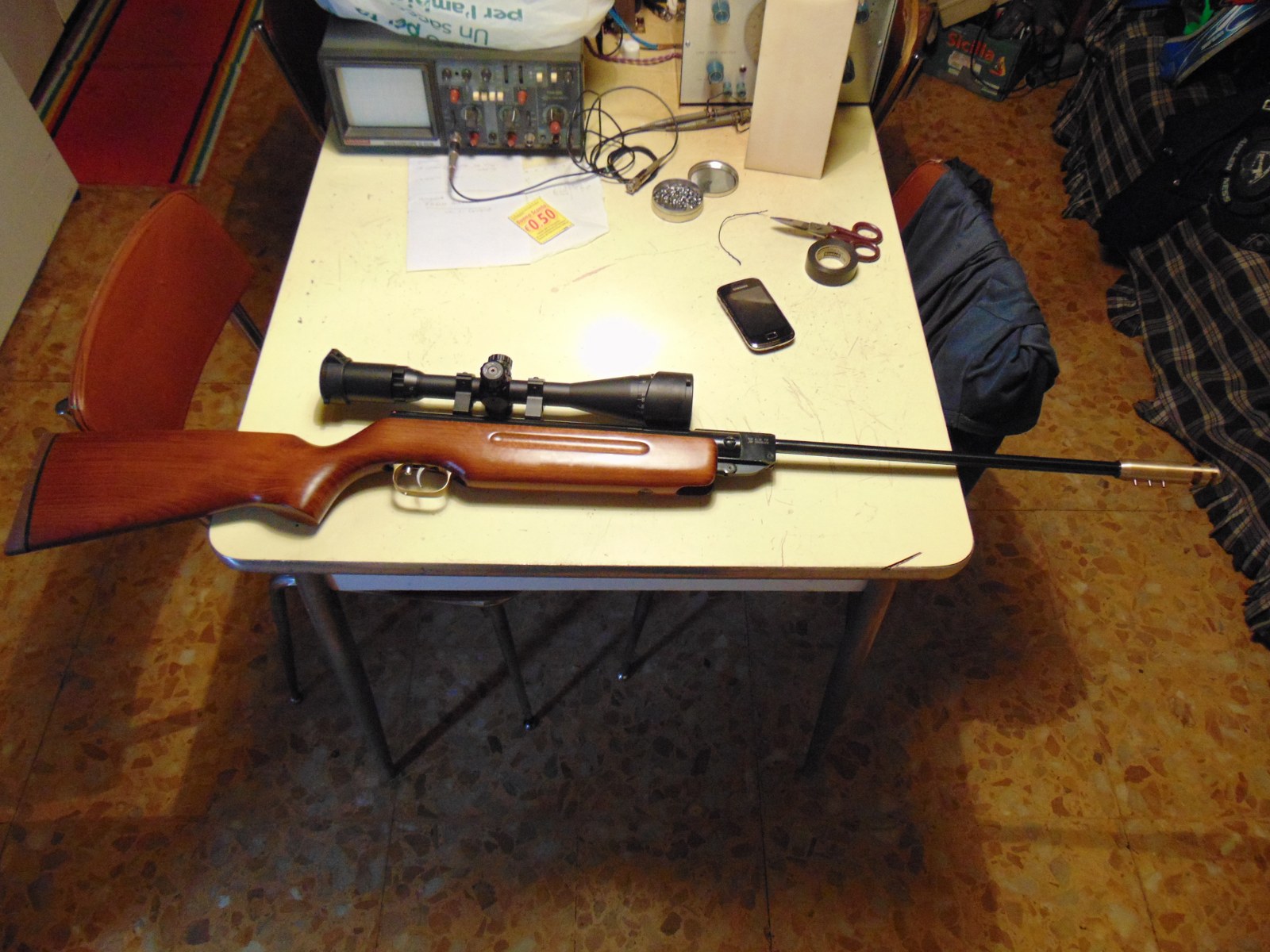

    Hi all
    I built this Muzzle brake for my weihrauch hw35 (I suppose is "Beeman" the american name). I built this because here in summer (thanks to the bad municipal management of the sewers) I got my courtyard paved in porphyry full of cockroaches! No poisons have effect, I use them, I win some days of peace and in few days again. Problem is that if you coming too close with broom they escape in mass! If you hit them with a short caliber (like 4,5mm \177" low powered air carbine from distance) at min 3 meter, they keep the position and don't escape. Plus if you wait some minutes, some new cockroaches come to eat the slain, and you can multiply the score. Jokes apart, I can't leave a single cramb that these beasts invade the house!
    Made from solid brass, with 2 slot, 3 grains that keep the brake in position.
    I'm thinking about to build an ak version, any idea?
    Air carbine muzzle brake-dsc00677_1600x1200.jpg Air carbine muzzle brake-dsc00678_1600x1200.jpg Air carbine muzzle brake-dsc00680_1600x1200.jpg
    Air carbine muzzle brake-dsc00681_1600x1200.jpg Air carbine muzzle brake-dsc00683_1600x1200.jpg Air carbine muzzle brake-dsc00685_1600x1200.jpg

    Normally a brake works on powder fired projectiles to counteract weight, velocity, muzzle blast & rise. On a pneumatic they lessen the report and alter center of balance much farther forward; unbelievably steady aiming.
    Here we shoot hornets and wasps, ground game like yours is not so plentiful, thankfully. There's usually more jokes than shots taken, and no benefit from cannibalistic insects.
    Mine are just muzzle weights, I believe I'll slot one for a brake and see what happens. What do you want to know about firearm brakes amico?

    I got installed on my ak the classic short muzzlebrake, here in Italy we have only semi-auto for civilian market, then no need to keep in position during a blast of full magazine
    I'm thinking about what can do a good muzzle brake in a semiauto firegun for accuracy, and which design can be better. what do you think about ? I only used guns with mb installed, never done one for me.
    Right to speak, I'm thinking another application with powerful revolver, something like compensator but removable

    So, on to your project. This page Muzzle Brakes: Recoil Results for 308 & 300 Magnum - PrecisionRifleBlog.com [not a site I participate in] has a comparison of screw-on brakes, tested on .308 Win you know as 7.62×51 NATO. No firearm brakes are retained by what you call grains. 3 reasons - insecure means of locking - certainly will not install concentric to the bore - inability to insure muzzle crown 90 degrees to the bore. Depending on barrel profile, a lathe turned threaded portion about .5 to .6 long, with fine threads, a relief, and a shoulder to seat the brake against. Hole patterns distributed over the length are rotated so adjacent rows have a solid portion between. The holes usually radiate square from the bore, or at a shallow angle back. Can't find anything about surface area to bore/ cartridge capacity. There seem to be inside diameters barely larger than groove diameter, and others with a larger percentage. I know that either must be axially & radially concentric, square to bore. Some chamfered like a typical barrel, seen a few aren't. A front sight band will be an issue, although it could be fit to the brake itself with some alignment 'insurance'.
