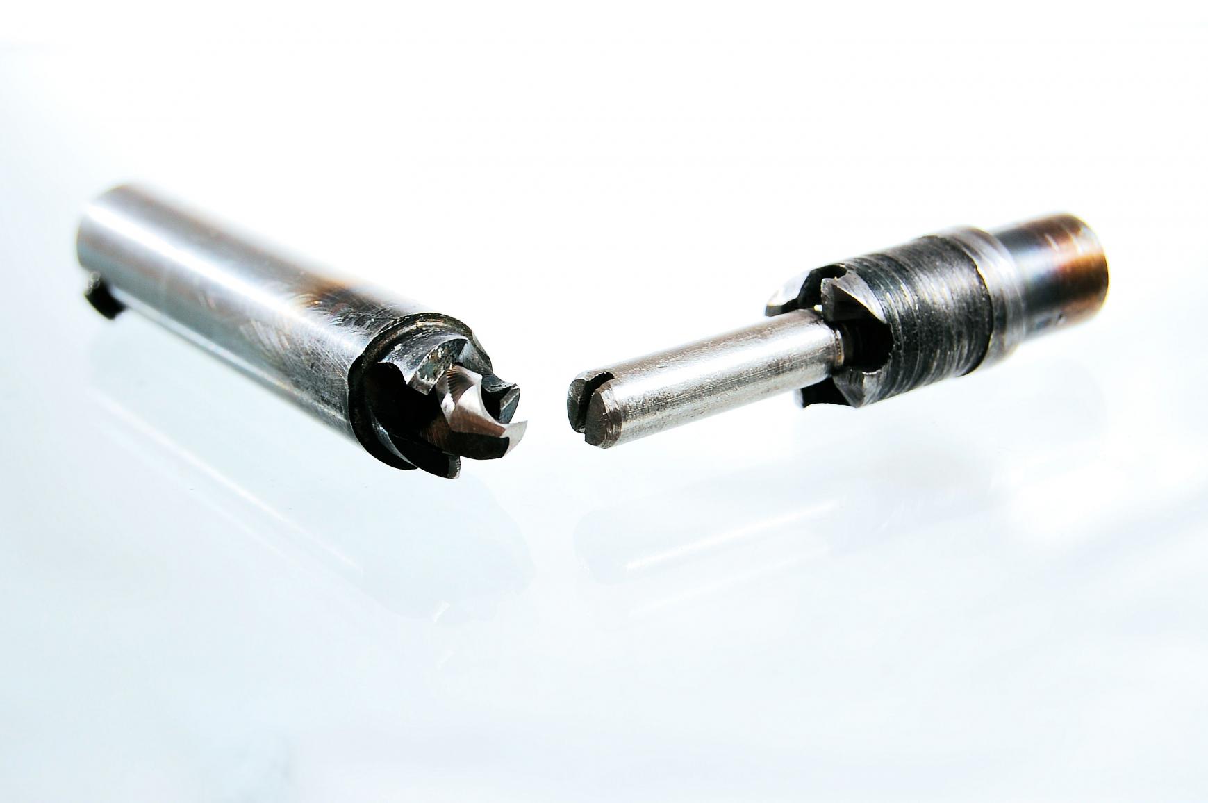

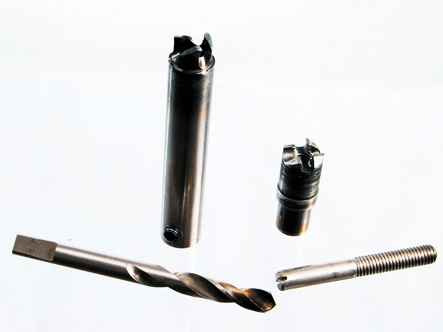

    Hello.
    I present my too step drill.
    Turn and drill steel in round bloc and file the groove use air grinder tools.
    And oil quenching.
    finish manual sharpening.
    For good result in mild steel with a slow rotation and abundant lubrication.
    Thanks and sorry for my bad english.
    adjustable step drill for bolt-dsc_7516.jpgadjustable step drill for bolt-dsc_7518.jpgadjustable step drill for bolt-dsc_7519.jpgadjustable step drill for bolt-dsc_7524.jpg
