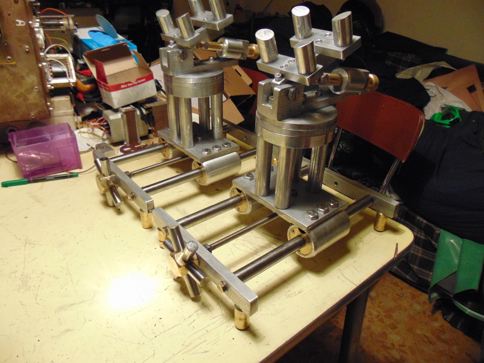

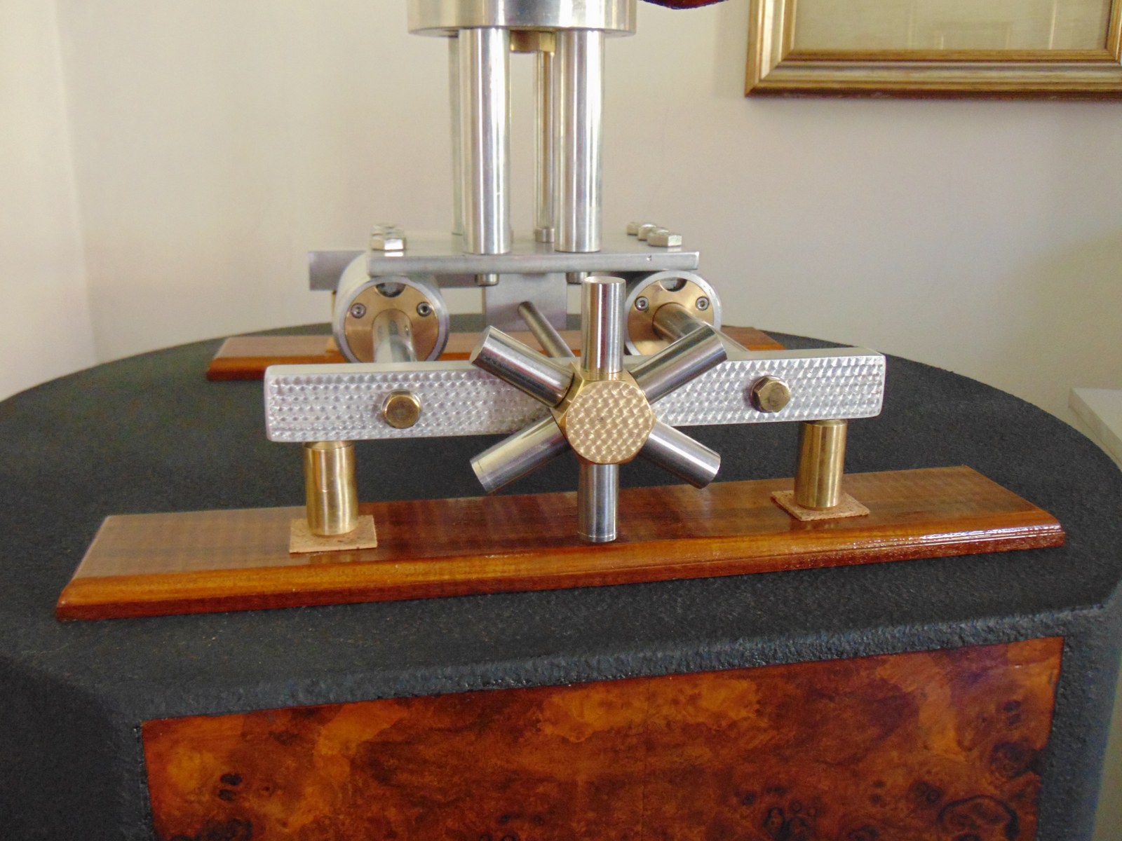

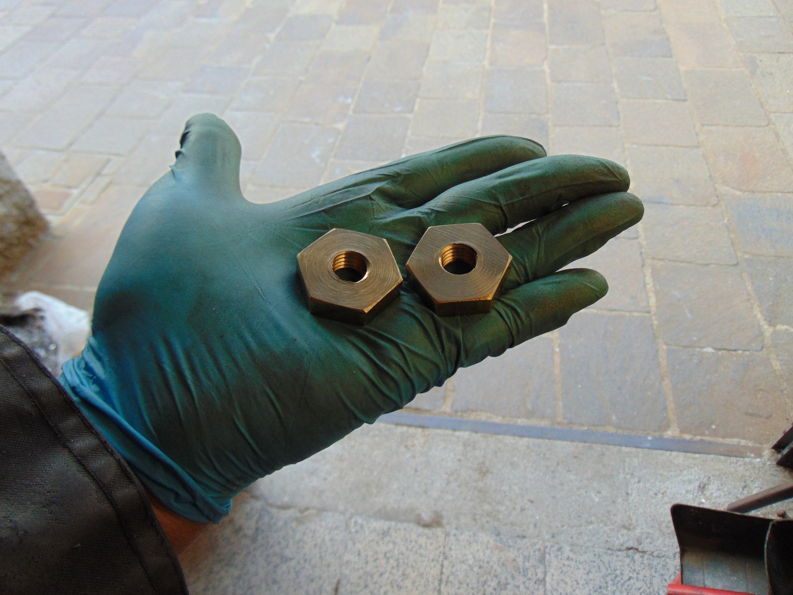

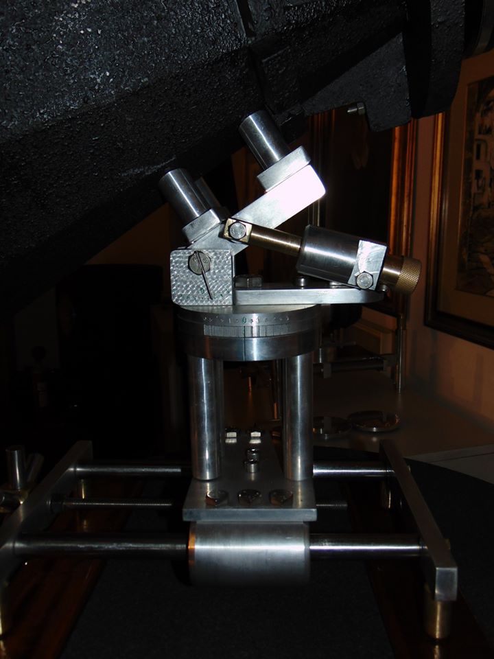

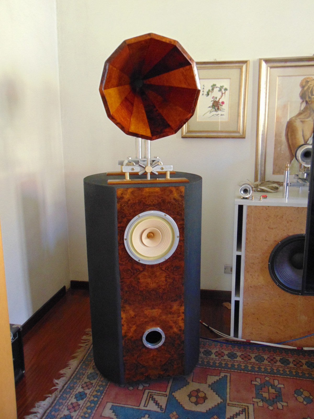

    Hi! Just finished the new horn stand!
    As usual, execpt the screws, all the parts are home made.
    20mm rectified and tempered bars, brass bushings, stainless M10 threaded rod for accurate adjustments. Most of parts are 6061 alloy.
    I used engine turning on front panels, and other parts, in order to give a more refined look.
    Brass solid feet polished. It's possible to set the time alignement, rotation of turret and tilt.
    This stand is intended for horn use in hi-fi home system. Due to its heavy duty construction, this stand could be useful for pointing system or other heavy objects that need the possibility of fine adjustment.

    That is a gloriously designed and built piece of kit. Bravo!
