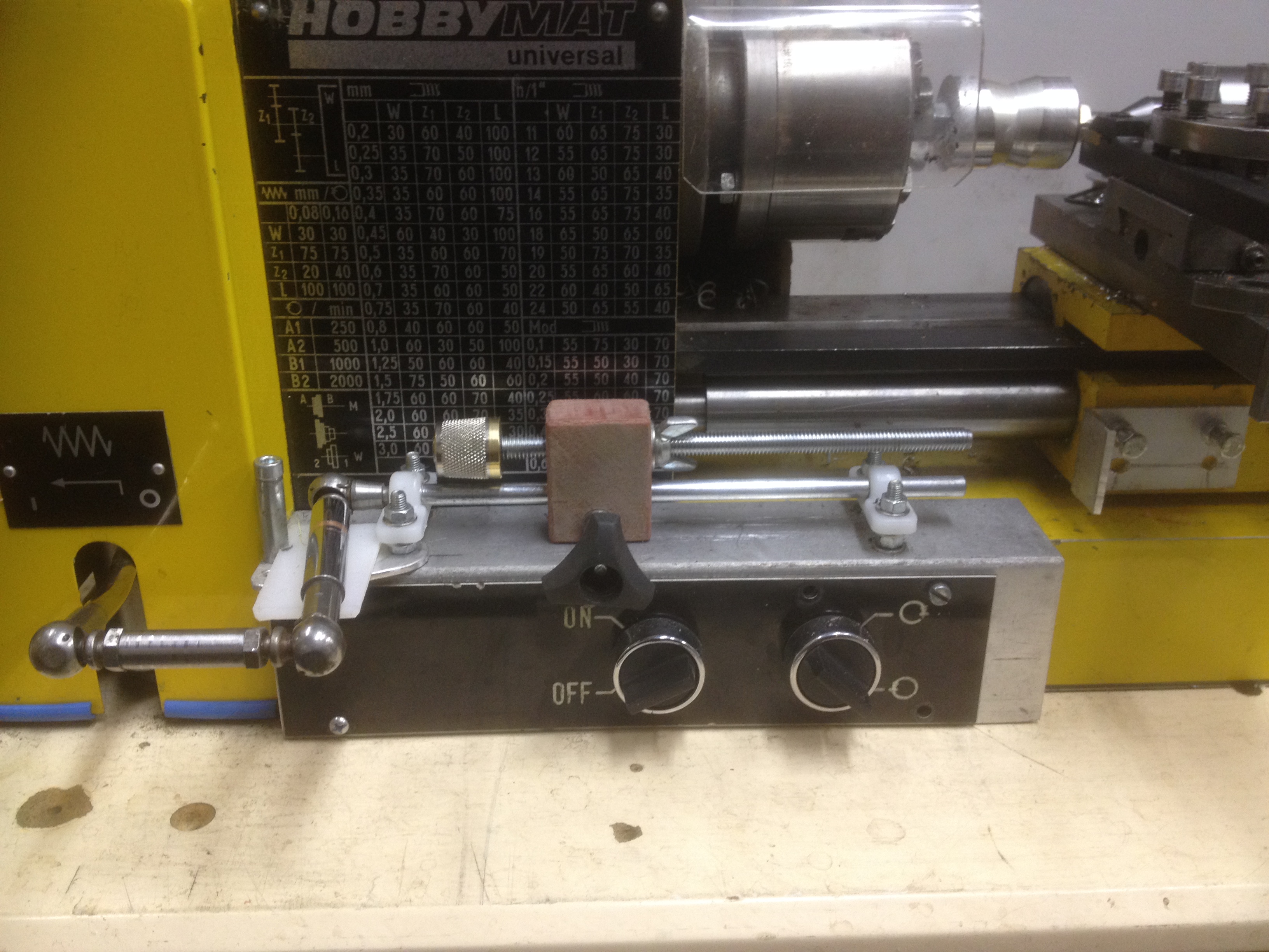

    one day I was to late in switching off te feed of my Hobbymat and had to replace the pin in the main leadscrew clutch.
    So I constructed my ACFS (Adjustable Carriage Feed Stop).
    As you can see in the attached picture and movie an aluminium angle is connected to the main slide and pushes against a rod (the lower one) which 'switches off ' the feed just before the carriage touches the chuck (more or less).
    The upper part (M8 rod) is adjustable by sliding and/or turning the knob at the position I want to switch off the feed at any wanted position.
