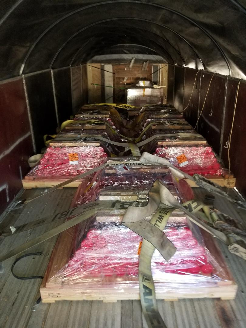

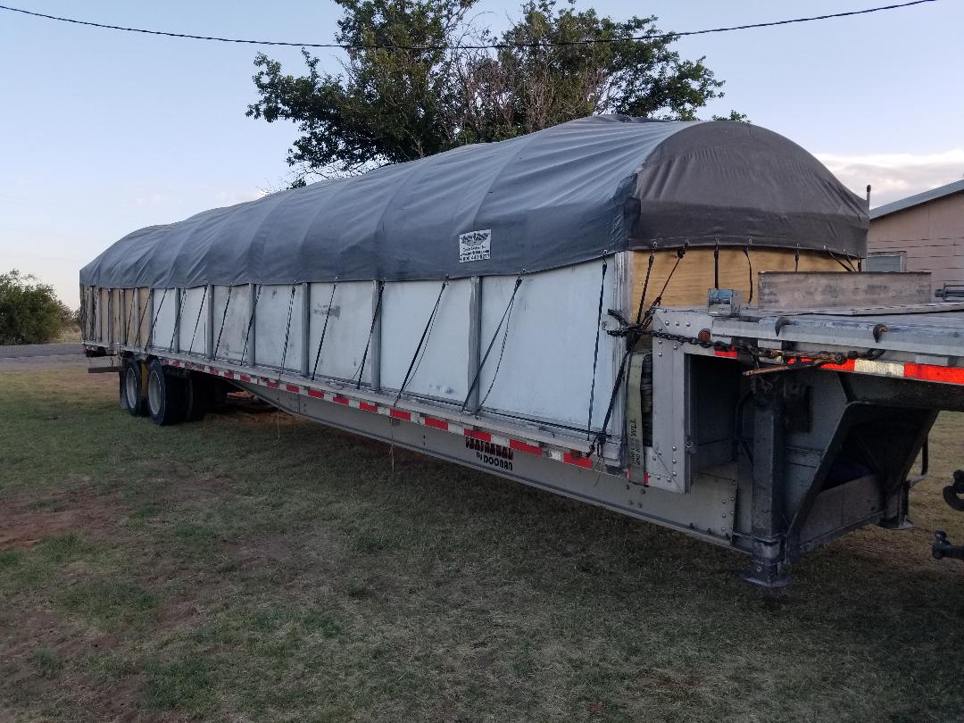

    To do this we needed either the dry van or the Conestoga we had removed from one of the trailers we sold. or a covered wagon side kit, which we purchased used, added a few sheets of plywood to replace the missing panels The kit more than paid for itself over the past couple weeks but is kind of a pain to open the tarp remove some side panels and bows so the pallets can be loaded All because the detonators could not be allowed to come in contact with the tarp. The blast tubes could have been simply tarped down without the need for the sides or bows.

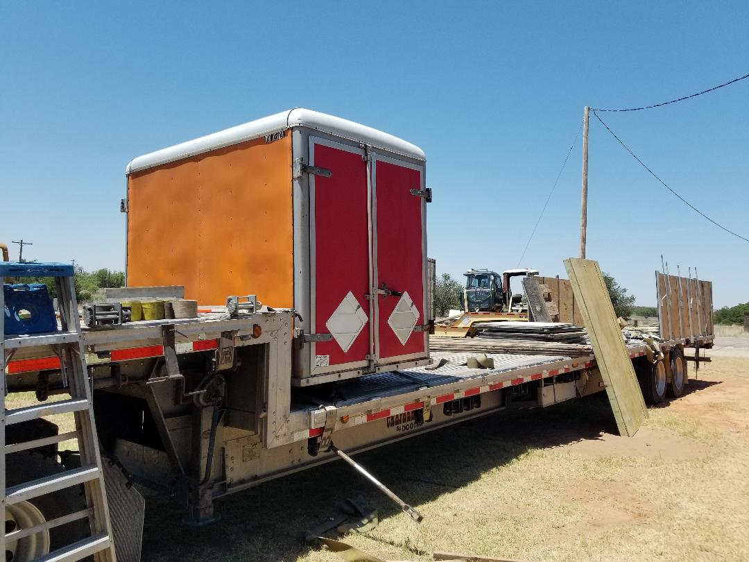

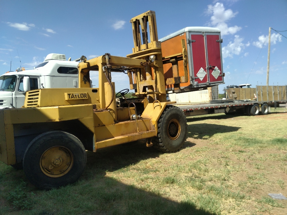

    Since I had a drome box, I had removed from the back of another guy's truck we decided to mount it on the trailer, but make it easily removeable or relocatable.
    I cut fork slots in the I beams under the bottom of the box then we strapped and chained it down
    Adding a watertight explosives drome to our step deck trailer-thumbnail-5-cw.jpg

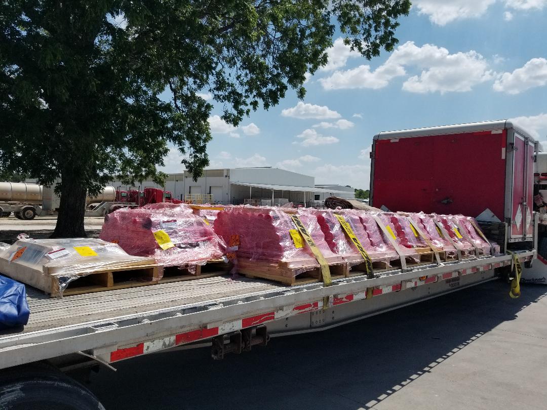

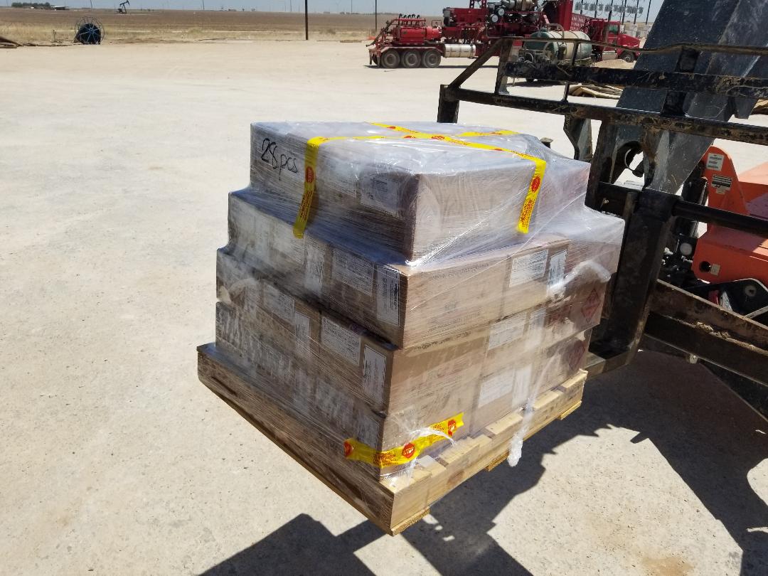

    These are the blast tubes

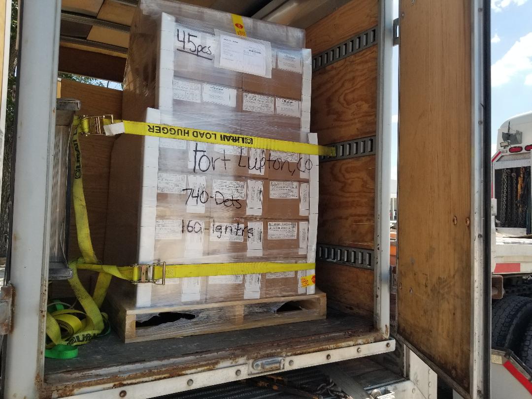

    And these the detonators they must be kept 2 feet or more away from any other explosive charges Generally he never hauls more than 2 pallets of these, but the pallets can be stacked as long as they do not touch the pallet below a simple separator is all that is required so he can actually get 3 pallets in the drome if needed, Now he can strap his tarp down directly on the pallets of blast tubes which will make them more secure

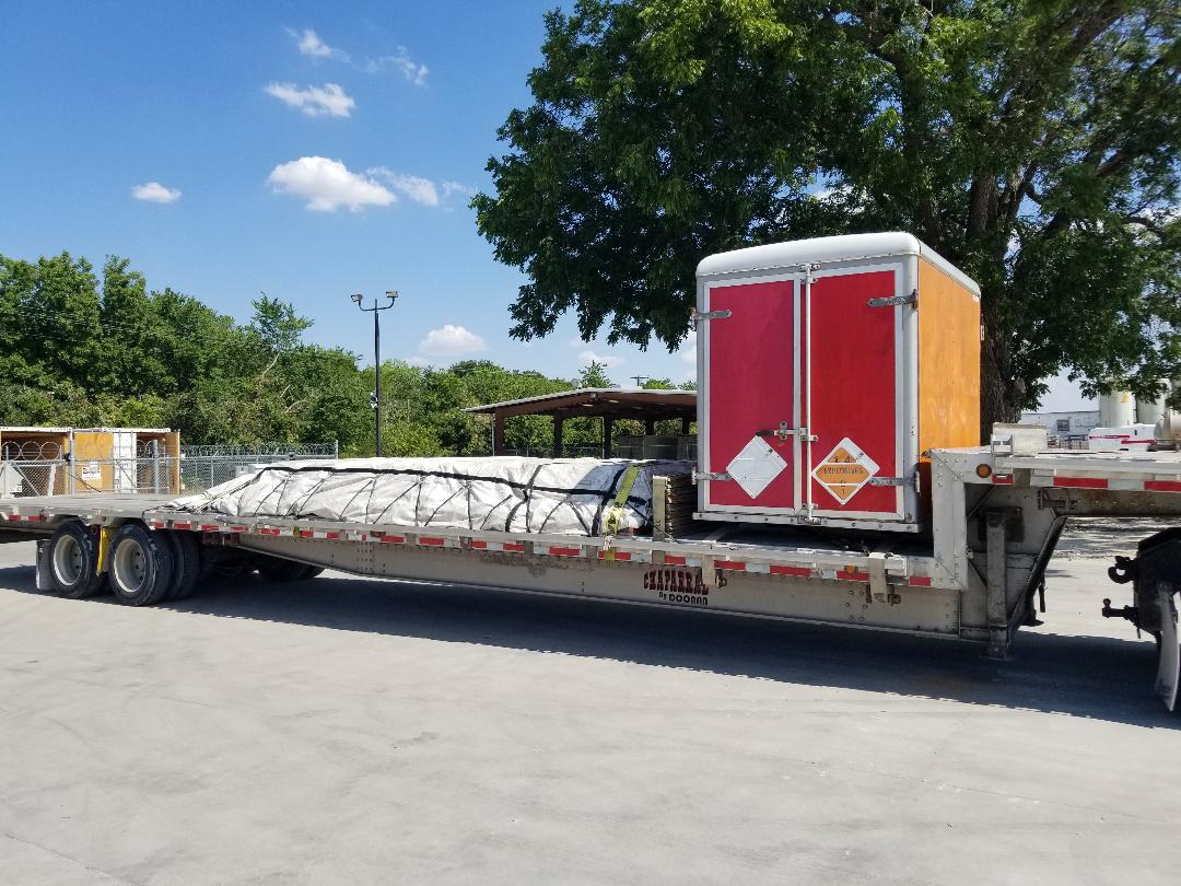

    Here is what the load looked like today. The shipper fell all over himself when he saw the drone mounted on the trailer, thought it was the best idea anyone had come up with yet because it completely separates the detonators from the blast tubes. In a covered wagon IE side kit trailer, or a Conestoga trailer or even in a dry van which they prefer not to load into, The 2 components must be separated by a minimum distance. Proper securement is always a huge concern. The way we now have the trailer set up there is no possibility of load shift
    Now all we have to wait on is the new custom fitted tarp to be made so won't have to fight the 250 lb 4 ft drop side lumber tarp
    the new tarp weighs 96 lbs

    On the drone attachment we mounted I went ahead and added 2 coper grounding straps to ground the drone to the trailer as a preauction against a rumored new requirement being proposed.
