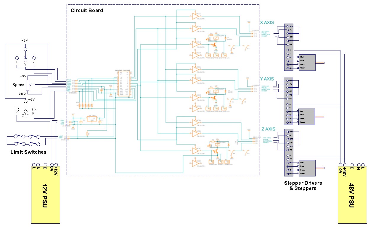

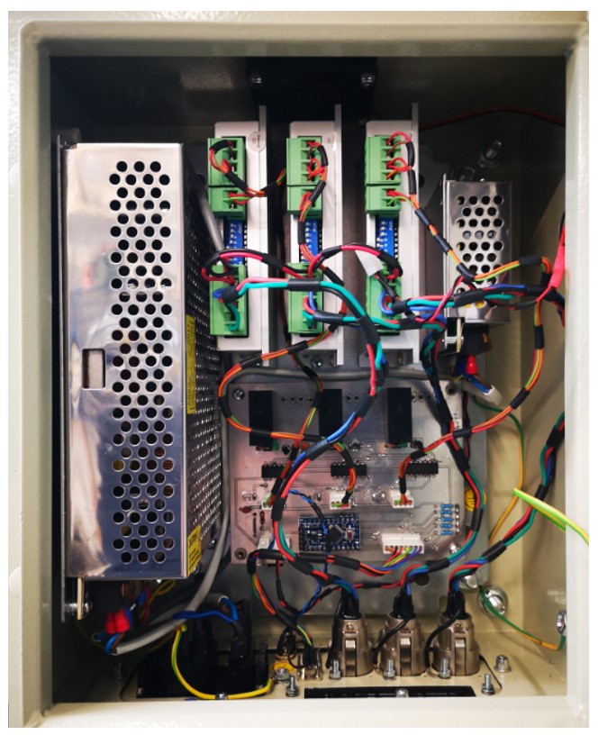

    I grew tired of winding the Z axis up and down on my Myford VMB mill so decided to take the plunge and add stepper motor control. This was not intended to give a full CNC capability but just to add a stepper to each axis and save my arm muscles. The result is an ability to select an axis, select a direction and vary the speed. There is an input for limit switches and emergency stop. Control is via a single Arduino Pro Mini and uses 74LS125 quad state buffers to select the appropriate stepper driver. The write up on the link below describes the process and includes the bill of materials, circuit and block diagram and Arduino code. While focussed on the installation on my VMB, the electronics could be used to convert any manual mill axis to stepper control with appropriate mechanical mounting of the steppers.

    The circuit board was designed in Fusion 360 Electrical module as a double sided board (top side ground plain and tracking on the lower side). The artwork was CNC milled on a Tormach 440.

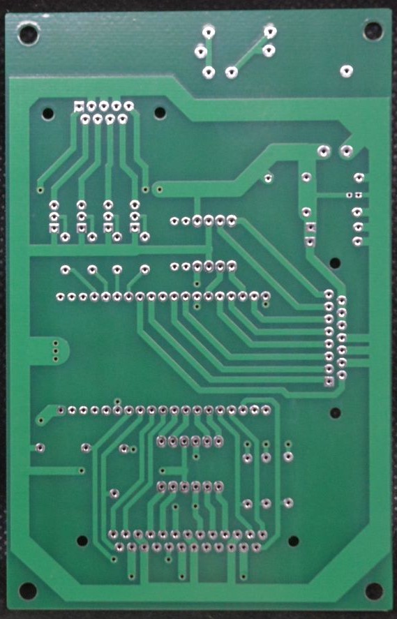

    Following on from my post about the stepper project I have ordered in some production PCBs for the controller circuitry. If anyone would like one please contact me for details.

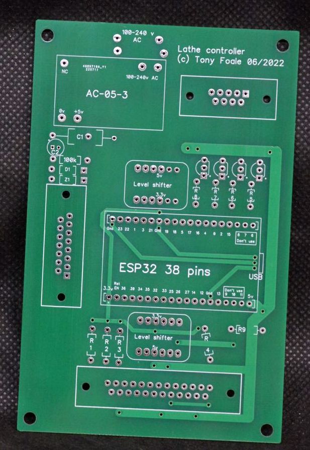

    Quote Originally Posted by cales2021 View Post
    I offered that with my project
    Ball screw and electronic lathe conversion
    and I had two takers before I ordered the PCBs. Since then I have had 100 people asking for them. Such is life.
    Adding stepper motor control to Myford VMB milling machine with wider uses-realthingfront.jpg Adding stepper motor control to Myford VMB milling machine with wider uses-realthingrear.jpg
