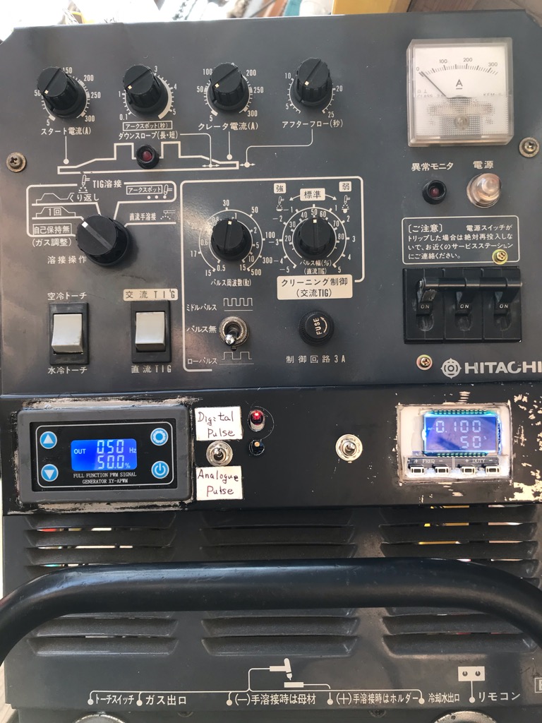

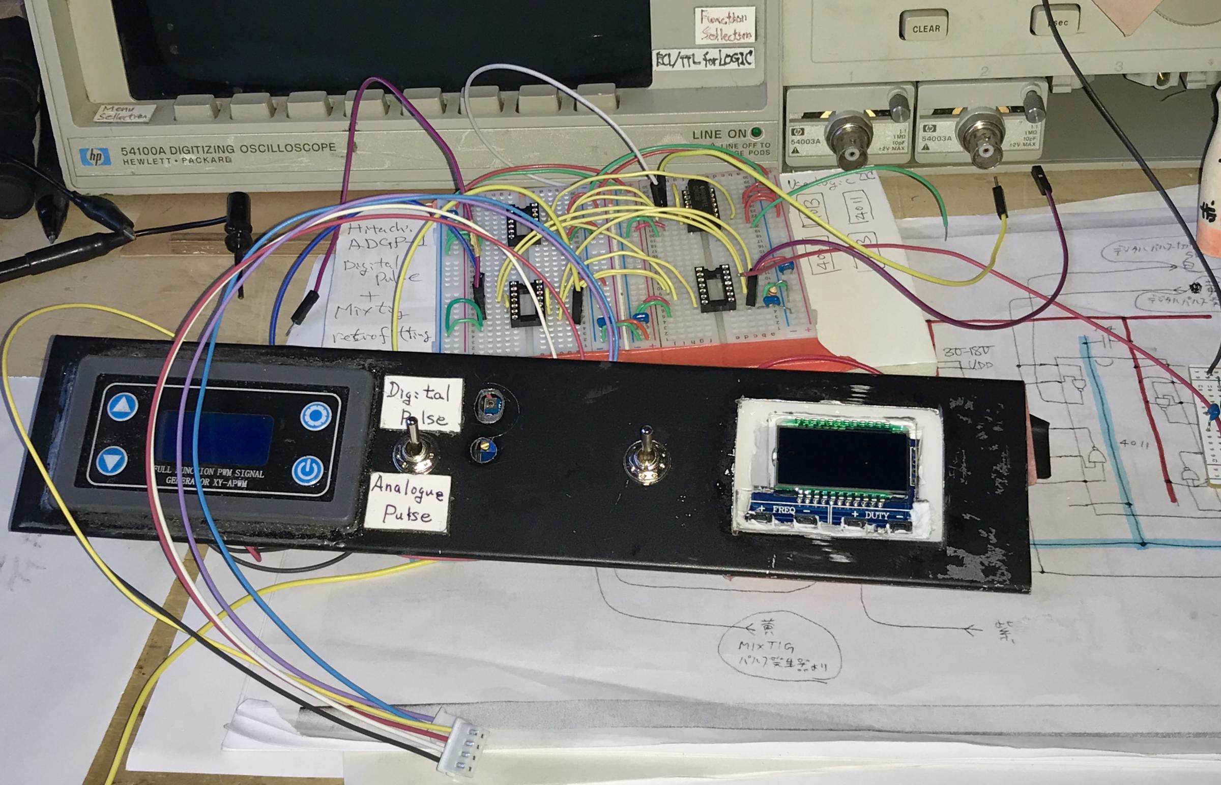

    Adding Digital Generators to an Old Analogue TIG Welder
    Adding Digital Generators to an Old Analogue TIG Welder-digital_mixtig_unit.jpg
    Set up a couple of digital generators to my old analogue TIG welder this spring, in an attempt to optimize its wave forms of welding current, to help my self when I make some butt-welding to thinner aluminium sheets.

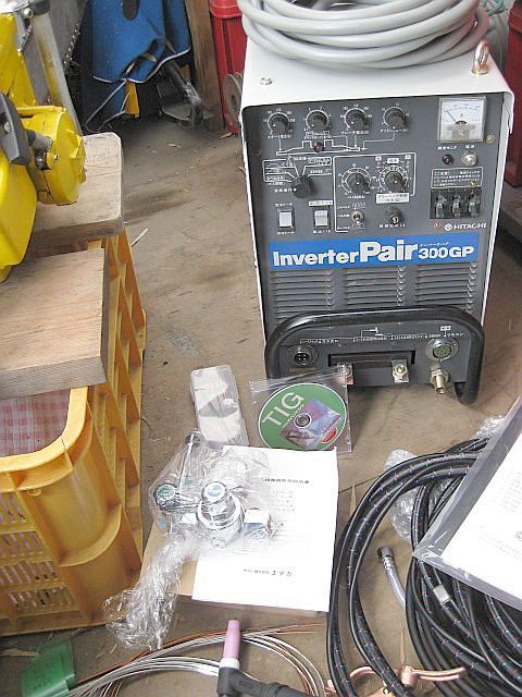

    Here showing my old TIG welder;
    The digital unit above is set up on the front panel;
    Adding Digital Generators to an Old Analogue TIG Welder-digital_mixtig_unit_set_up.jpg

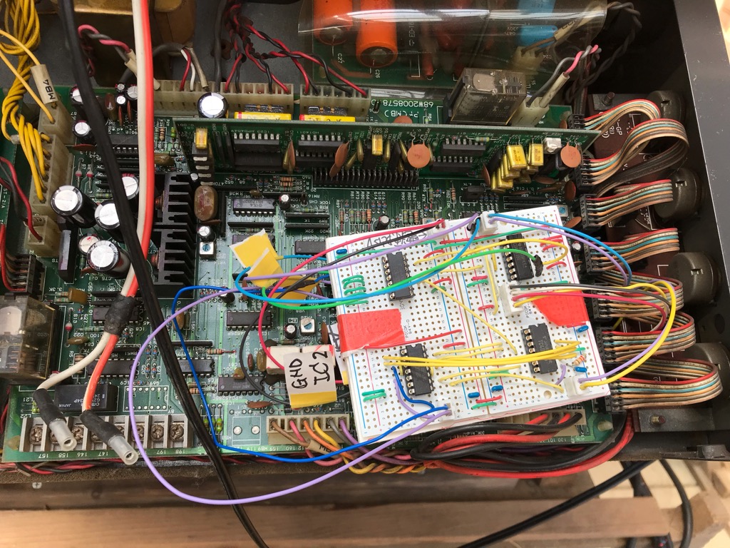

    Several logic-chips are placed on a small additional board, and is placed on the main circuit board of the welder;

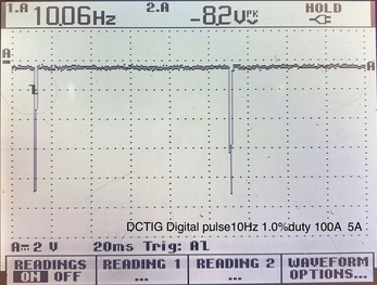

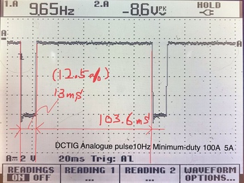

    The default setting only provides the minimum duty ratio of welding pulse as 12.5%
    Adding Digital Generators to an Old Analogue TIG Welder-dctig_analogue_10hz_minimum-duty_100a-5a.jpg
    but I wanted smaller duty as small as down to 1.0% for each welding pulse frequency,
    showing one sample I got after this retrofit;
    Adding Digital Generators to an Old Analogue TIG Welder-dctig_digital_10hz_1.0%25duty_100a-5a_2.jpg

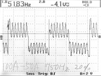

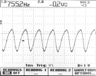

    This old welder has a pulse-range from nearly 0.5Hz up to 500Hz done by analogue frequency generator by default. This old set-up of analogue pulse is not replaced with the new, it can be used if I want.
    One of the features I love is that this new set-up can provide higher pulse frequency from 500Hz up to 900Hz, which I found useful in welding thinner steel sheet.
    The arc sometimes wonders when the welding amperage is set low, like 30A for welding current and 5A for base current.
    But I feel like this problem has nearly gone since I added this new digital generator by applying DC welding pulse frequency higher than 750Hz;
    with this frequency the arc shows somewhat better stability to the aimed point.

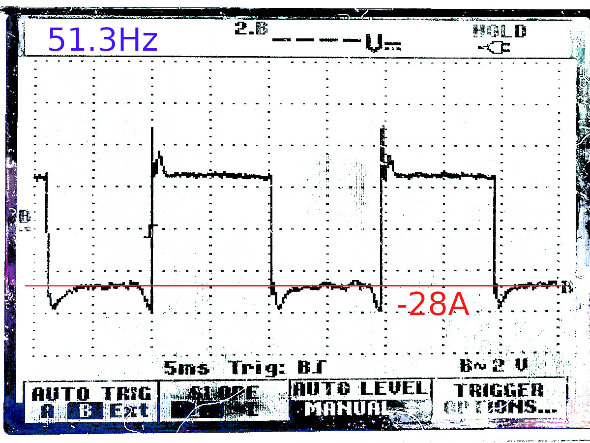

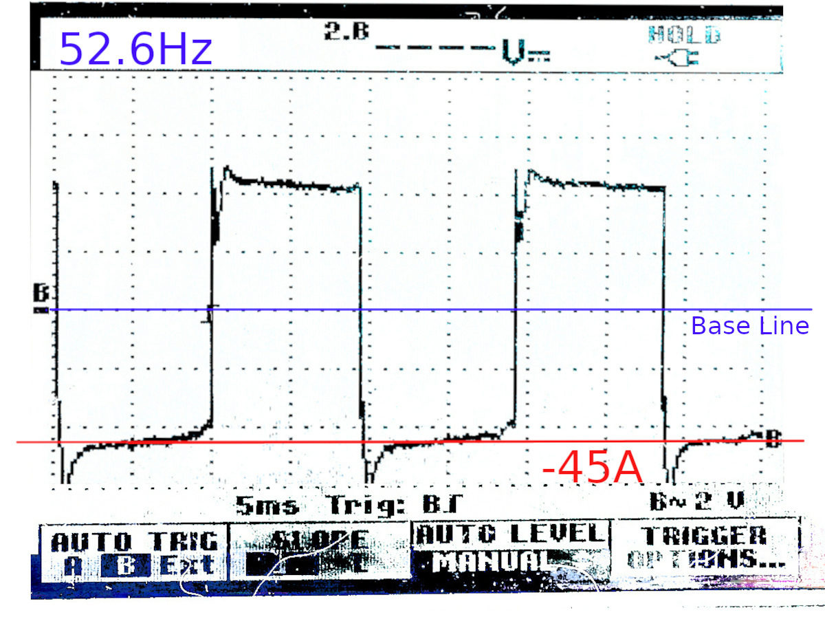

    Below is a default wave form of Alternative Current welding, aluminium for example, showing the minus peak as 45A besides overshoot.
    Output power is set to 50A for welding;
    Adding Digital Generators to an Old Analogue TIG Welder-nopulse_actig_50a-5a_cleaning%3D-5.jpg
    This shows the real welding power is a tad lower than the setting value.
    Here is another wave form attained with the same setting but the output power was set to 30A;
    Adding Digital Generators to an Old Analogue TIG Welder-nopulse_actig_30a-5a_cleaning%3D-5.jpg

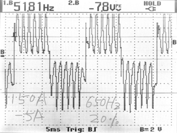

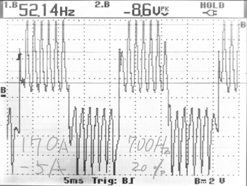

    Now I'm going to replace the rectangular wave forms of the both sides (of plus and minus domains), with a couple of pulses of arbitrary frequencies given by this new addition;
    Adding Digital Generators to an Old Analogue TIG Welder-digipulse_650hz_20%25_mixtig_2hz_50%25_150a-5a_crater.jpg
    Replaced the rectangular wave with 650Hz pulses, setting power 150A for welding.
    Adding Digital Generators to an Old Analogue TIG Welder-digipulse_700hz_20%25_mixtig_2hz_50%25_170a-5a.jpg
    also with 700Hz pulses, setting power 170A.
