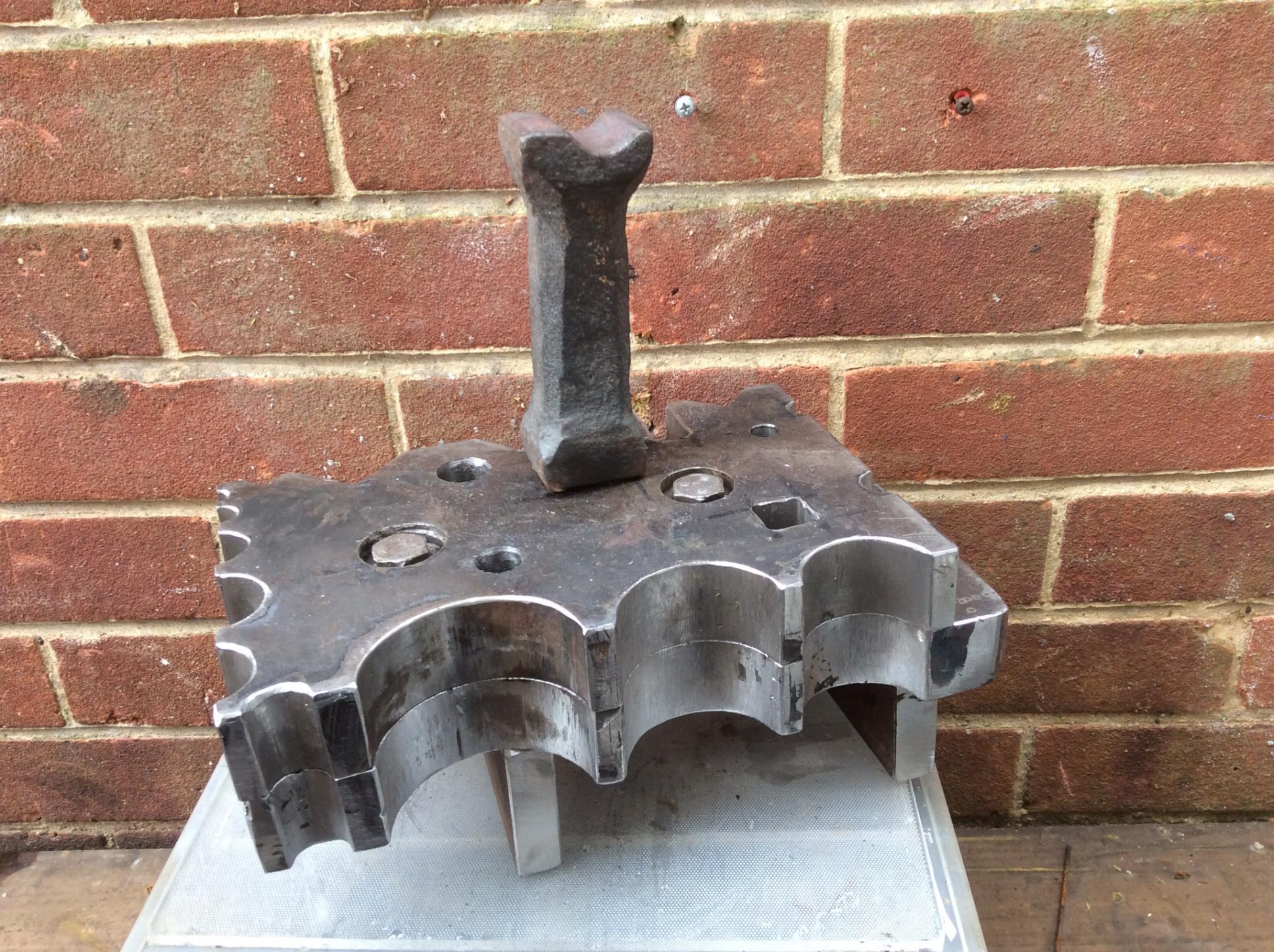

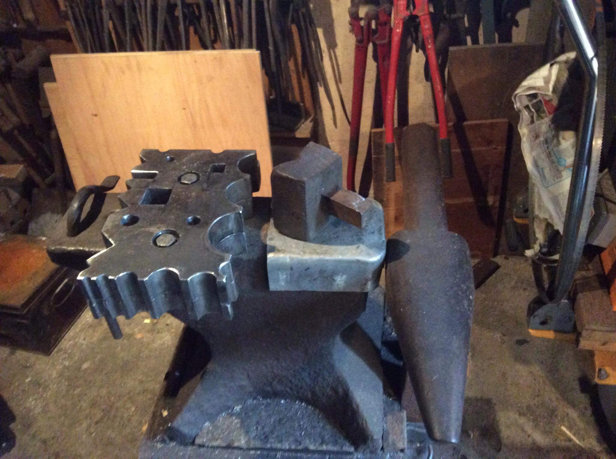

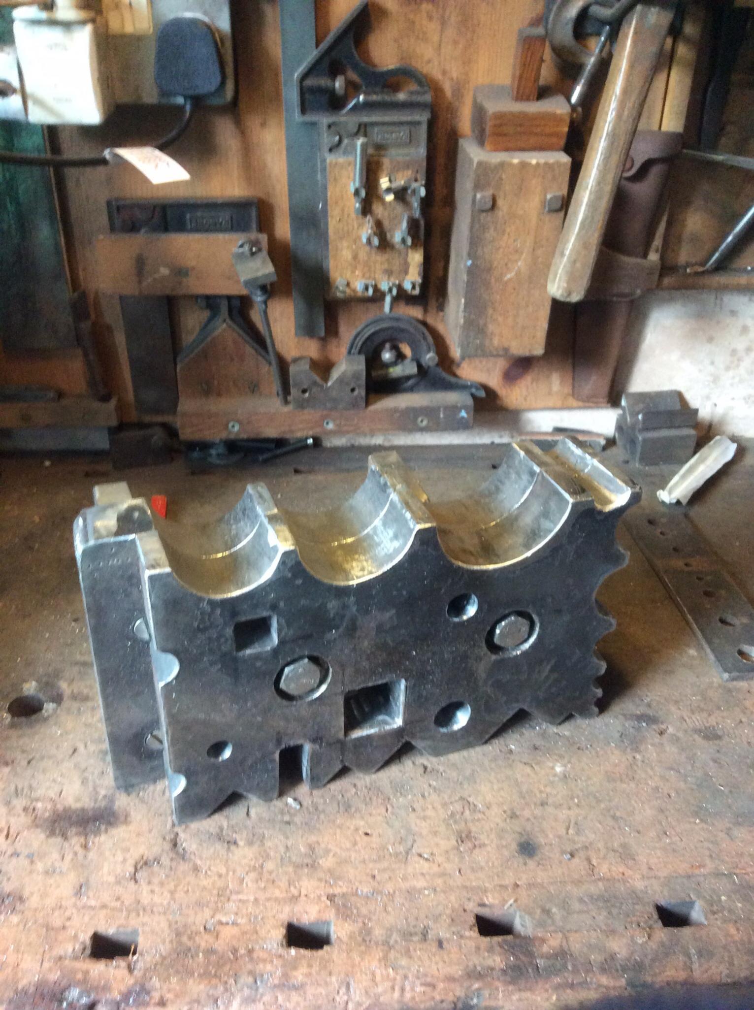

    This is a bench top swage block, consisting of four components, bolted together. It is formed of two plates, cut from a salvaged plate, one and one quarter inches thick. It has been many hours' work, carving it with hand tools (apart from the initial drilling', as a result of which I discovered, too late,that my drill press table is way out of true. Also, I used a disc sander at work to true the edges) . The legs provide a saddle and prevent it sliding about on the anvil. My anvil lost its bick in the remote past; I don't want to break the hardy hole as well. Now I can make some top stages to suit.
    I began it four months ago and finished it yesterday. This has been my main hobby time project during this period. While resting my arms, though, I have been also making other stuff, some of which will be posted in due course, if I am spared.Adaptable SWAGE BLOCK-image.jpgAdaptable SWAGE BLOCK-image.jpgAdaptable SWAGE BLOCK-image.jpg

    Thank you very much. For professional use you are of course better off with a cast iron swage block. There are some excellent new ones available, and you can get stands which enable them to be easily turned. Made in Germany, I think.
    The versatility of mine is that I could insert a plate between the 2 halves for eg collars and also it is lighter to move about.

    Thanks again Seamus. I wanted to say why I chose to do it by hand but the reply has gone into the aether. I wanted to experience for myself the old way of doing things. It is salutary to think that I probably laid 50k hammer blows and in excess of 20k file strokes. I know no-one near with a plasma cutter, and I would not trust myself to cut accurately if I dared to ask for a loan of one. It is mild steel so only suitable for occasional use. But there are easier methods!
