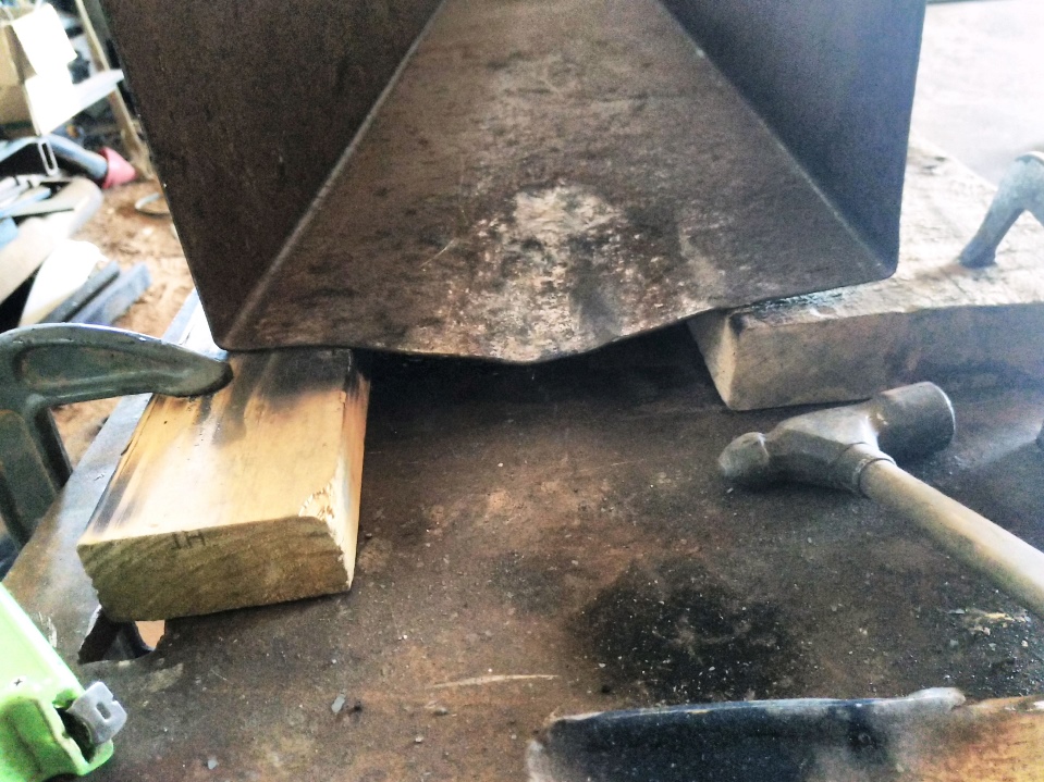

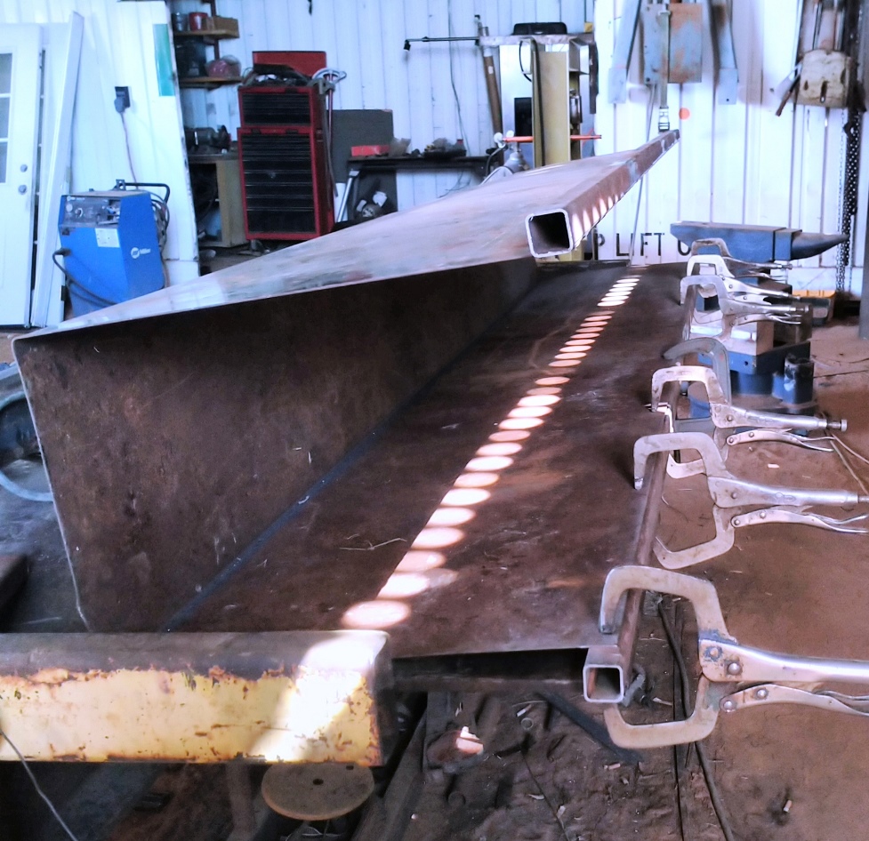

    Made from a full 4x8ft sheet of 14ga Much deeper than I need but better to be too deep than not deep enough.
    trough formed in for draining.

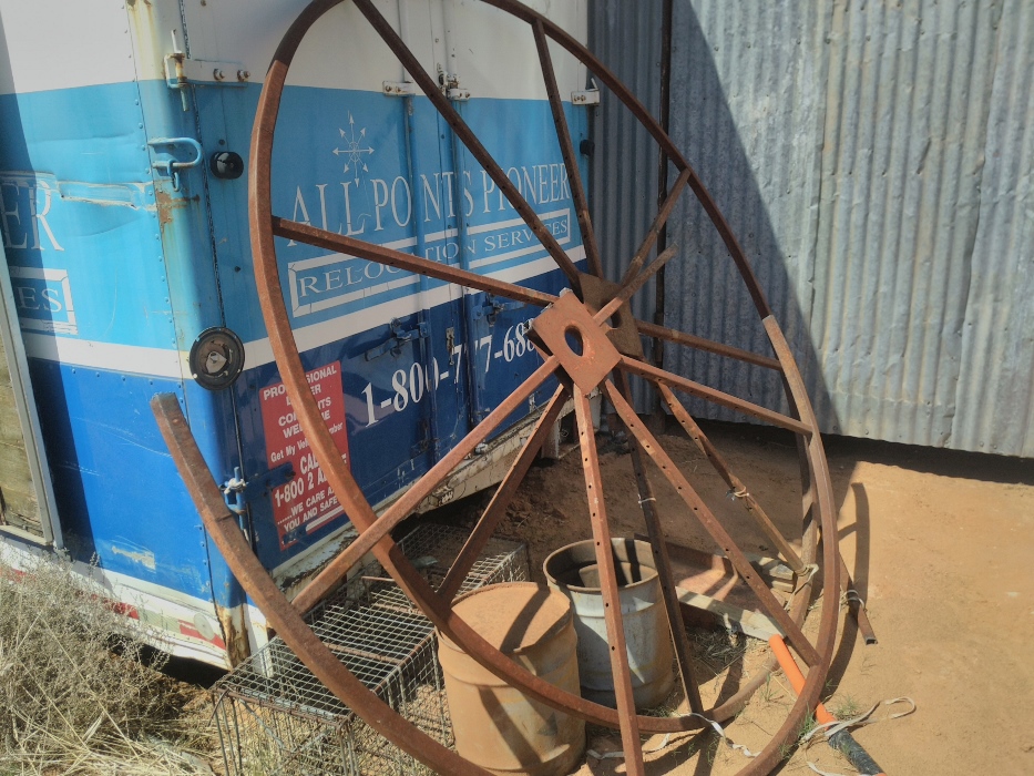

    source of sq tubing for legs and rim the round part I straightened out to a larger radius to make trusses for my green house.

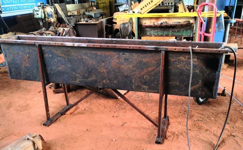

    finished vat just needs painting but that will wait.

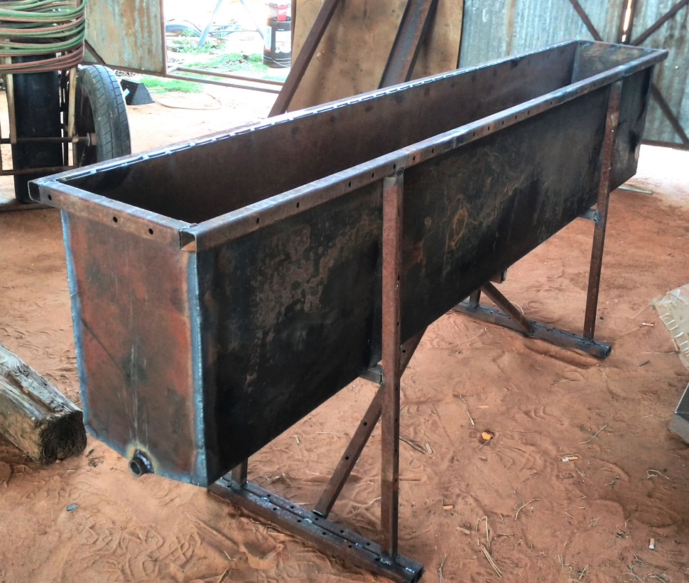

    The brass valve may be a problem might have to replace with one made of stainless

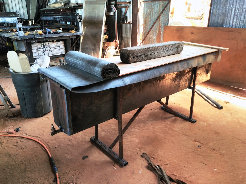

    the acid arrived and the parts are in the vat I covered the vat with a makeshift top using a roll of rubber and a piece of plywood this is to contain any fumes and slow evaporation.
    It always seems that no matter the situation I most always have something in my storage bins to cover what needs to be done. in this case the roll of 3/32" thick rubber that I have had for at least 25 years
